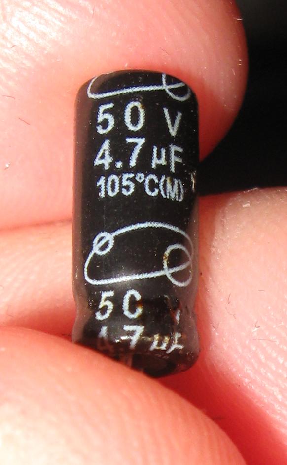

Badcaps.net Forum
Go Back   Badcaps Forums > Electronics Theory and Troubleshooting > General Electronics
Register FAQ Members List Social Groups Calendar Search Today's Posts Mark Forums Read
Thread Tools Display Modes
Old 06-14-2012, 09:11 AM   #41
mariushm
Join Date: May 2011
City & State: Romania
Line Voltage: 230VAC 50Hz
I'm a: Hobbyist Tech
Posts: 2,139
Default Re: Cheap CFL teardown after failure
Nice... reminded me of the two cfl lightbulbs I posted a while ago here.
Now that I have an ESR meter I decided to have a second look at one of them - on the other the glass broke.
So removed the main capacitors from the pcb and the one by the lamp wires - i forget how it's called.
The main ones are 3.3uF 250v, one is open and the other has 15 ohm esr and 2.6uF capacity. The green one is toast, open. Brand is some no-name with letters c and y inside a diamond shape.
Too much to bother fixing, esp. as I don't have the replacements around. And... the other green cap on the board is probably also toast.
mariushm is online now   Reply With Quote
Old 06-14-2012, 03:39 PM   #42
ben7
Join Date: Jan 2011
City & State: Trenton, NJ
My Country: USA
Line Voltage: 240v-120v 60Hz 200A service drop
I'm a: Knowledge Seeker
Posts: 1,992
Default Re: Cheap CFL teardown after failure
Quote:
Originally Posted by mariushm View Post
Nice... reminded me of the two cfl lightbulbs I posted a while ago here.
Now that I have an ESR meter I decided to have a second look at one of them - on the other the glass broke.
So removed the main capacitors from the pcb and the one by the lamp wires - i forget how it's called.
The main ones are 3.3uF 250v, one is open and the other has 15 ohm esr and 2.6uF capacity. The green one is toast, open. Brand is some no-name with letters c and y inside a diamond shape.
Too much to bother fixing, esp. as I don't have the replacements around. And... the other green cap on the board is probably also toast.
Attachment 41768
Attachment 41769
Looks like there is no fuse either!
BTW, what about that smaller black cap?
__________________
Hi-pot test: FAIL
ben7 is offline   Reply With Quote
Old 06-14-2012, 03:53 PM   #43
budm
Join Date: Feb 2010
City & State: S.F. Bay area
My Country: USA
Line Voltage: 120V 60Hz
I'm a: Knowledge Seeker
Posts: 7,030
Default Re: Cheap CFL teardown after failure
20Watts lamp driven by small high voltage TO-18 Plastic MOSFET's and no fuse, enclosed in a seal case while using the lamp with base up? No wonder they failed.
And it has CE?
__________________
Never stop learning or per Greek Pro "when you will update your ID from Knowledge Seeker to a Pro (in 10 years) ,
then I will take you more seriously, for now you are just a kid playing with it keyboard"
Baisc LCD TV and Monitor troubleshooting guides.
budm is online now   Reply With Quote
Old 06-14-2012, 03:55 PM   #44
mariushm
Join Date: May 2011
City & State: Romania
Line Voltage: 230VAC 50Hz
I'm a: Hobbyist Tech
Posts: 2,139
Default Re: Cheap CFL teardown after failure
I didn't bother to check, after finding those two flaws already.
But yeah, just for you i pulled that capacitor out... 4.7uF 50v ... came out as 4.89uF 11.7 ohm esr
No name cap, what would you expect?
mariushm is online now   Reply With Quote
Old 06-18-2012, 08:00 AM   #45
Behemot
Behemot's Avatar
Join Date: Dec 2009
City & State: Prague, 50°4'52.22"N, 14°23'30.45"E
My Country: CZ
Line Voltage: 230 V/50 Hz
I'm a: Knowledge Seeker
Posts: 1,377
Default Re: Cheap CFL teardown after failure
We got one CCFL at home which managed to last something arround 10 years. No kidding…but it cost something back in the 90s
Anyway, CCFLs I have seen got usually failing caps, one even failed Rubycon with some 4000/5000 hours rating. Polyswitch poped in half there. Tried to repair but screwed somehow Will ask here when theres thread
__________________
Behemot is offline   Reply With Quote
Old 06-23-2012, 04:14 AM   #46
ben7
Join Date: Jan 2011
City & State: Trenton, NJ
My Country: USA
Line Voltage: 240v-120v 60Hz 200A service drop
I'm a: Knowledge Seeker
Posts: 1,992
Default Re: Cheap CFL teardown after failure
Quote:
Originally Posted by Behemot View Post
We got one CCFL at home which managed to last something arround 10 years. No kidding…but it cost something back in the 90s
Anyway, CCFLs I have seen got usually failing caps, one even failed Rubycon with some 4000/5000 hours rating. Polyswitch poped in half there. Tried to repair but screwed somehow Will ask here when theres thread
I dont think they usually have polyswitches, I have seen some capacitors which do look like polyswitches though. If one of the diodes or transistors are open/shorted the rest are guaranteed to go pop xD
ben7 is offline   Reply With Quote
Old 06-23-2012, 04:59 AM   #47
Behemot
Behemot's Avatar
Join Date: Dec 2009
City & State: Prague, 50°4'52.22"N, 14°23'30.45"E
My Country: CZ
Line Voltage: 230 V/50 Hz
I'm a: Knowledge Seeker
Posts: 1,377
Default Re: Cheap CFL teardown after failure
Yes, it was polyswitch, I think I even asked here what it is and eventually found it in local shop. But as I said, screwed somehow…
Behemot is offline   Reply With Quote
Old 07-08-2012, 12:09 PM   #48
Th3_uN1Qu3
On my level
Th3_uN1Qu3's Avatar
Join Date: Jul 2010
City & State: Bucharest
My Country: Romania
Line Voltage: 230VAC 50Hz
I'm a: Student Tech
Posts: 3,304
Send a message via Yahoo to Th3_uN1Qu3
Default Re: Cheap CFL teardown after failure
"Moon" brand CFL, 18W. Failed about a month ago, finally bothered to see what's wrong with it. Tube didn't go dark at the ends so this was definitely an electronic failure. 1N4007 bridge, 4.7uF 400v "Hlicon" primary cap. No fuse, but there is a necking of the trace leading from one of the AC wires to the diode bridge, which in the event of a short downstream should act like a fuse and blow out. Hopefully.
I first thought that 1nF film cap in pic 4 looked a bit suspicious (browned), but pulled and tested good, so i put it back. Tried it again, still no go. There was voltage on the main cap, so obviously for a reason the circuit wasn't oscillating. I pulled the switching transistors (13002s made by "Success Technology" in Shenzen ), and they tested good. One interesting thing that happened was that while desoldering the first transistor, i accidentally shorted it C-E with my iron, and the lamp struck briefly from the energy left in the primary cap. Hmm.
The reason for failure was the 680kOhm resistor behind that transistor (pic 3), which tested open. It was wired guess where? Between C-E. It obviously was responsible with the startup of the oscillator. I didn't have a 680k so i used 2x 360k in series. Lamp is now working fine. Due to the slightly higher startup resistor it does take a little longer to strike compared to the other one in the same fixture, but that's fine with me, i can't be bothered to take it apart again.
Attached Images
File Type: jpg SN853268.JPG (503.3 KB, 17 views)
File Type: jpg SN853269.JPG (452.7 KB, 20 views)
File Type: jpg SN853272.JPG (538.1 KB, 20 views)
File Type: jpg SN853273.JPG (425.7 KB, 18 views)
File Type: pdf CY%2013002D.pdf (601.4 KB, 3 views)
__________________
Quote:
Originally Posted by PeteS in CA View Post
A working TV? How boring!
Th3_uN1Qu3 is offline   Reply With Quote
Reply
Thread Tools
Display Modes
Posting Rules
You may not post new threads
You may not post replies
You may not post attachments
You may not edit your posts
BB code is On
Smilies are On
[IMG] code is On
HTML code is Off
Forum Jump
All times are GMT -6. The time now is 06:58 PM.
Badcaps.net Technical Forums © 2003 - 2013
Powered by vBulletin ®
Copyright ©2000 - 2013, Jelsoft Enterprises Ltd.
