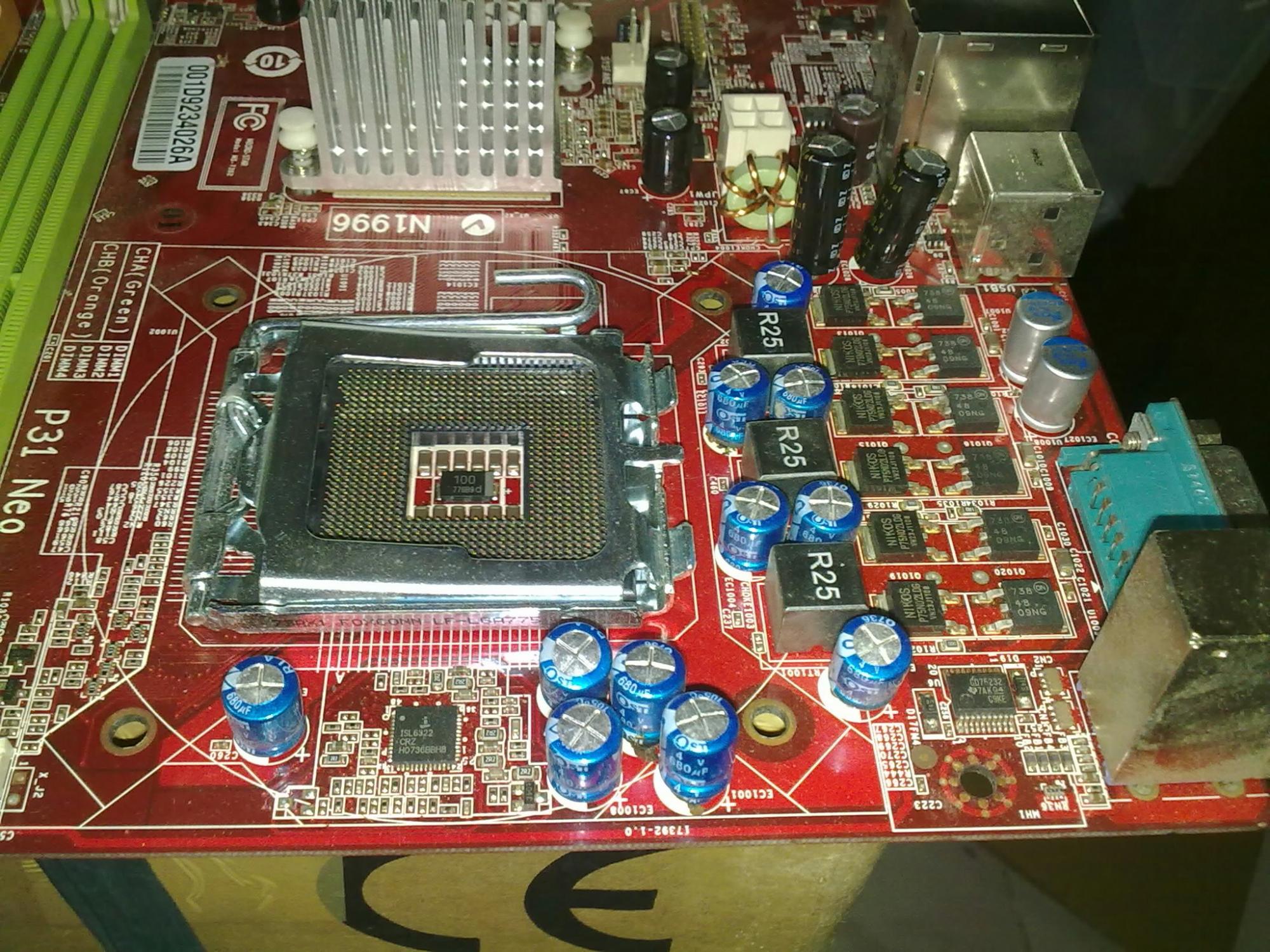

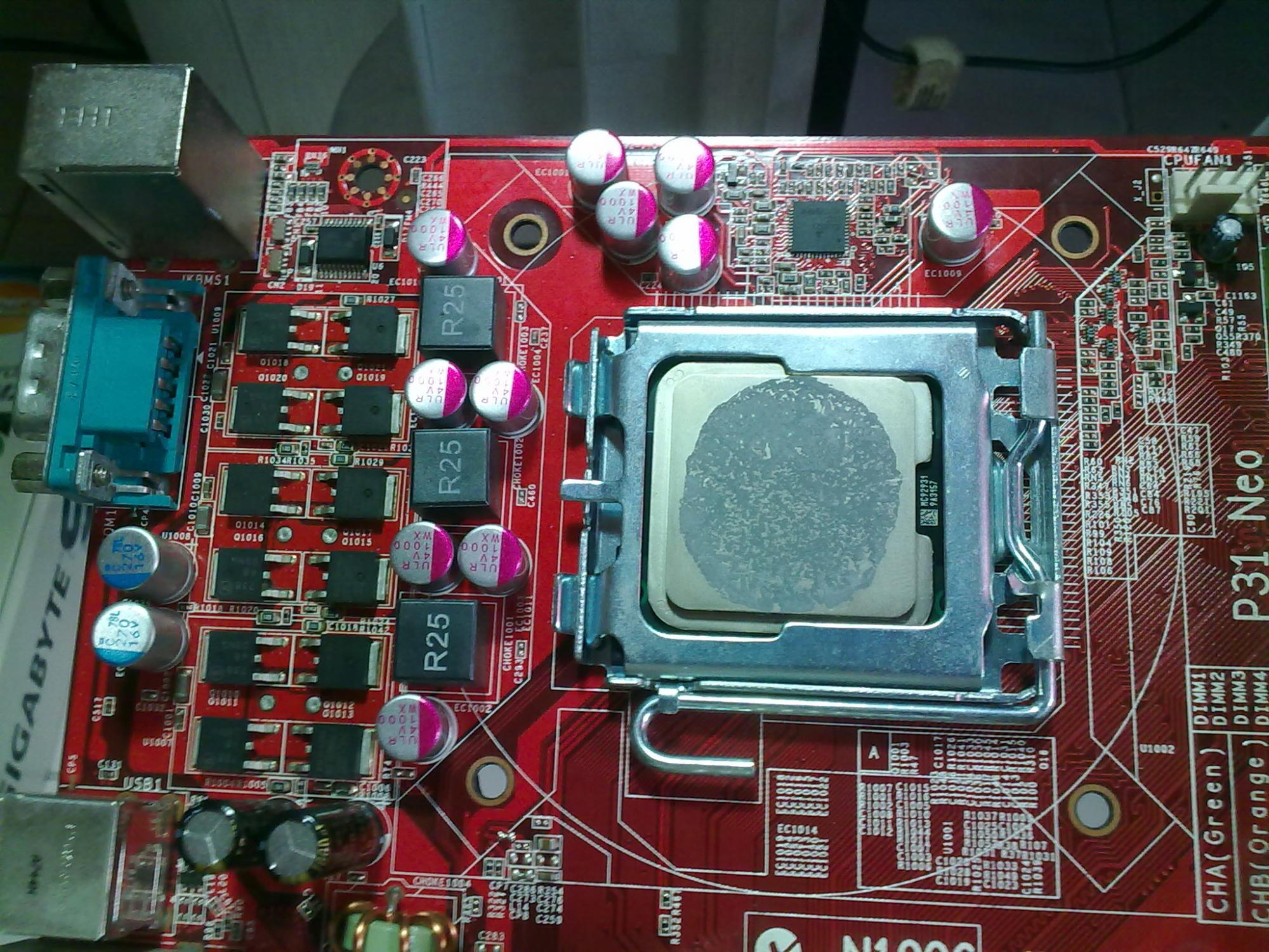

    OST RLA Fail after 2 years on MSI P31 Neo VRM. It's all bulging and leaked from below, making constant reboot in Windows. My customer still got one more MSI P31 Neo and i think i should prepare a replacement caps for the VRM too.
    Replaced it with X-CON ULR Polymer and it run like new again. Is X-CON is a good brand? It only has Polymer though, no Electrolytic.
    I think OST are more fragile if it's used for VRM. Had 2 dead 4+ years ASRock board full with OST and now the board seem got something shorted, the PSU won't run and will make a "short buzz like" sound every time i press the power button. Seen an ECS board still running after 5+ years though, i believe it has OST too. But i won't put OST in my white list.
    Is Samxon good? What type is the good one? Which one to consider when choosing a durable cap; High Ripple or High Lifetime? Isn't High Ripple will make High Lifetime too?
      OST have always been a problem.
      Pretty common on Asus, MSI, Biostar and some smaller brand boards -WAY- after they were known to be a problem.
      I think those brands use OST deliberately hoping the board fails just after the warranty is up.

        LOL - I just now looked at your pics.
        Those little short buggers in Vcore should be replaced with solid polymer.
        Due to the available sizes in good bands of lytics [meaning lack of in cans that short with ESR that low] that is the only practical way to avoid height problems -and- keep the ESR low enough.

          Yup, beside the only 8mm diameter x 8mm height cap that would fit under the CPU fan is 4V 1.000uF X-CON ULR.

          Yup, the only 8mm diameter x 8mm height cap that would fit under the CPU fan is 4V 1.000uF X-CON ULR.
