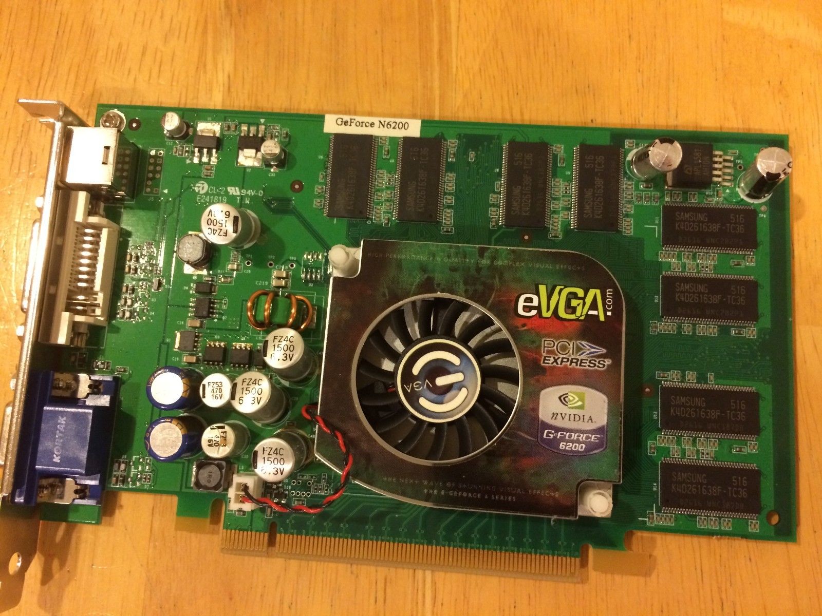

    I was browsing on eBay for broken motherboards and video cards (as usuall) until I saw this:
    https://www.badcaps.net/forum/attach...1&d=1398563913
    YES, those are indeed vent-less Sacon FZ electrolytic capacitors!
    I guess they wanted to add insult to the injury... as if their vented caps weren't enough crap already!
    I do recall c_hegge buying some new ones on eBay that were like that too.
    Seems like the seller of this video card is clueless here, as suggested by the "Works Great!!" in the description. I pity whoever buys this even more! Maybe I should instead? It's not much of a video card, but should be a fun recap (and maybe even more fun if I dispose of these caps c_hegge-style )
    Here's the link, by the way:
    http://www.ebay.com/itm/Nvidia-EVGA-...s&hash=item4ad
    Also, any clue what those silver caps with the vents are (upper right-hand corner)? Evercon perhaps? (not like that would make a difference then.)

    Is it me or do the vented caps in the upper right corner look bulged?

      I never seen any recent eVGA with crap caps like that!
      And it looks a lot like the only ones left, for cards from eVGA, were the GeForce 8400s and 8600s (Who wants those things??)
      GeForce 7 series was the last confirmed eVGA usage of Sacon caps on their top end versions and middle end versions.
      It honestly looks like eVGA knew they F-ed up and stopped using those caps on their top end and middle end versions.
      (Starting with 8 series, except for 8400 and 8600.)
      My eVGA GeForce 9500 GT has Fujitsu polymers.

        That's terrible How have they not blown up? How could that thing "Work Great!!!" ?! Maybe idling at the desktop The caps in the top right look like regular Sacon electrolyitcs

          Yup. I've seen those vent-less Sacons before. see https://www.badcaps.net/forum/showthread.php?t=19521
          Were those ones fun to over-volt or what...
          EDIT: I probably could add that I haven't been seeing Sacon on any new products from the last year or so. I wonder if manufacturers are waking up to how horrible they are.
              I had the same thought, but it could just be a reflection of the photographer/camera.
              I wonder how long this card was in service, and how many years it's been since it was last powered on - the fan looks surprisingly clean to me.

                        Re: Another instance of the shameless Sacon FZ... with a twist!
                        I've looked at the pictures a few times now and I think they are.
                        But we will see. I actually did end up buying the video card mentioned above. Yes, it's not much of a good video card these days and definitely not worth the price by itself... but those ventless Sacon FZ caps are priceless! Must have at least one in my "dead collection" . So when I get it, I'll post more details. I just emailed the seller yesterday and asked if he can ship it in a cheap padded envelope to keep shipping costs down. He's okay with it, so I am just waiting to see how we should proceed before I pay for it.
