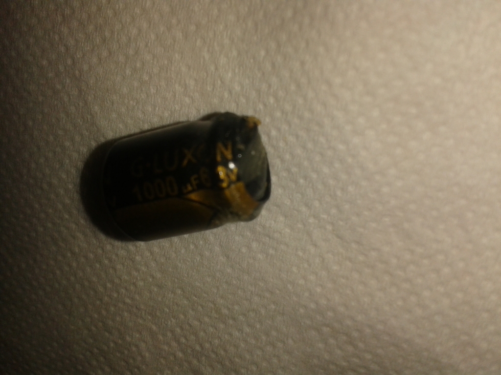

                Bad capacitor from my motherboard MSI 845 PRO.
                1x G·LUXON 1000 MF 6.3V.
