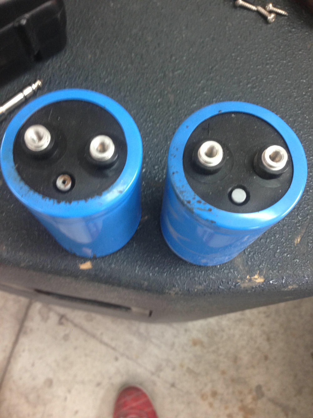

                        My contribute..... Facon 10000uf 100 VDC from Montarbo w20a amplified speaker
                          Re: The Hall of Shame - Badcaps Photo Montage
                          Hahah, good one!
                          "Facon"
                          Fake-capacitor? xD
                          I bet it made a mess though :S
                            Originally posted by ben7 View Post
                            Hahah, good one!
                            "Facon"
                            Fake-capacitor? xD
                            -Ben
                            seems to be real http://facon.com/
