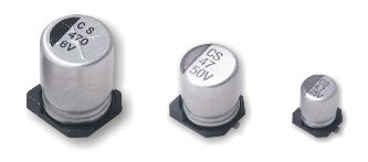

    Next we have "JB" Brand CS series caps. They are generic Chinese SMD electrolytic caps and not polymers, and they're found in Uniden phones (Good phones otherwise, they just need their caps swapped, unlike VTech which is garbage).
    There is one lone cap in the cordless phone itself, and one or two in the corded base unit. The rest of the base unit electrolytics are all radial through-hole.

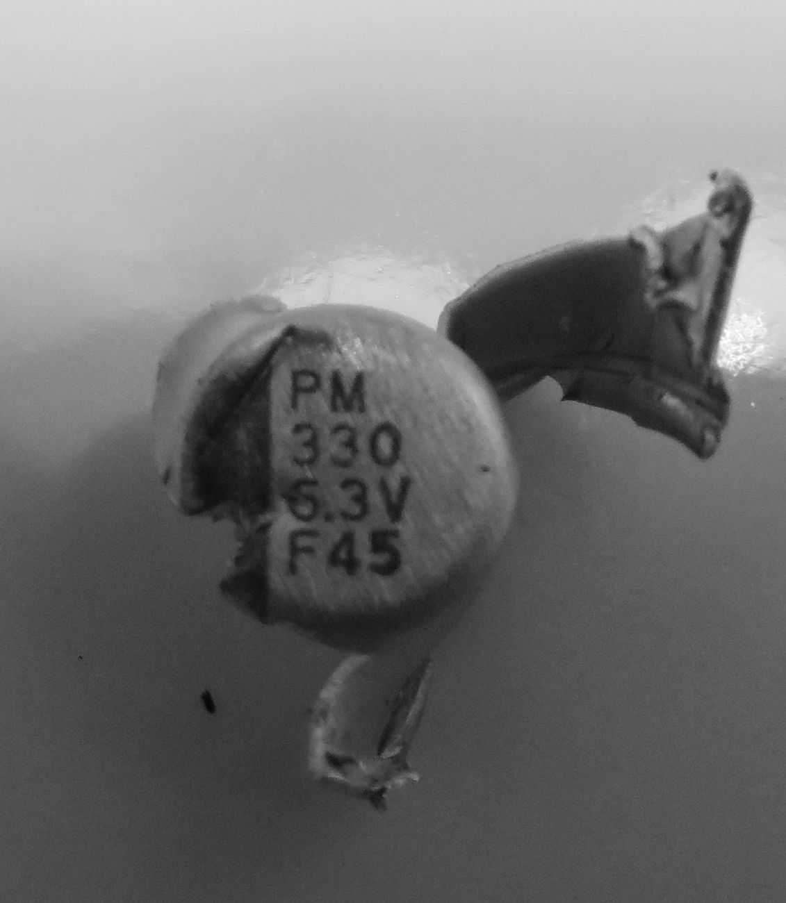

      Up next is the Gemcon PM series polymer capacitor, with a 5000 hour endurance rating:
      The capacitor looks ok on the inside, I would rate this brand as adequate.
