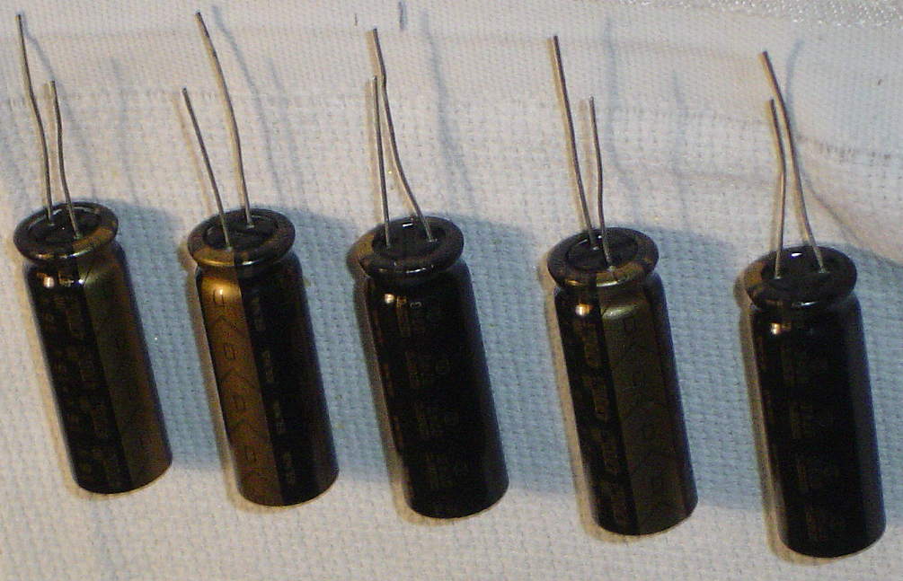

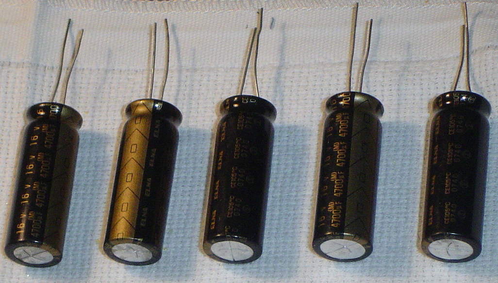

    I just bought ELNA 4,700uF/16v
    my camera has no battery now, the picture will upload later, sorry.
    here are it's details,
    case size: 12.5x35mm.
    gold printed on black sleeve
    16 v
    (M)
    4700uF
    ELNA ELNA
    CE105'C
    0735
    (S)
    top vent mark is --)-
    bottom look like
    (o)||(o)
    I've download ELNA catalogs 2004, 2006-2007, 2007-2008 and 2008-2009
    and not found any matched of spec. 12.5x35mm. 4700uF/16v
    I would like to know it's series and specifications.
    please help me find it's datasheet.

    gold on black elna's i have here are special audio caps.yours were made week 35 of 2007.

        Yes. I think Black-Gold says audio.
        All their 'normal' ltyics have white writing.
        Might be a special order size.
        Most of their audio caps are 85c.
        I think only one audio series is 105c.

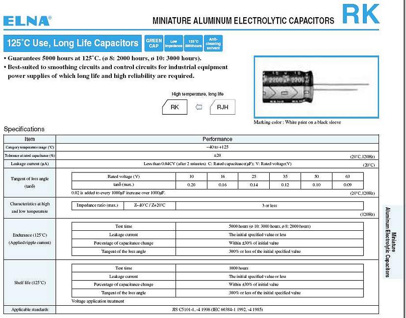

          It's look like RK series very much, just 105'C and gold printed.
          Could be possible to get exactly datasheet of it, or Is it fake?

              Yes, text ELNA printed bottom of negative band, look same as the photo of RK series, no series name also.

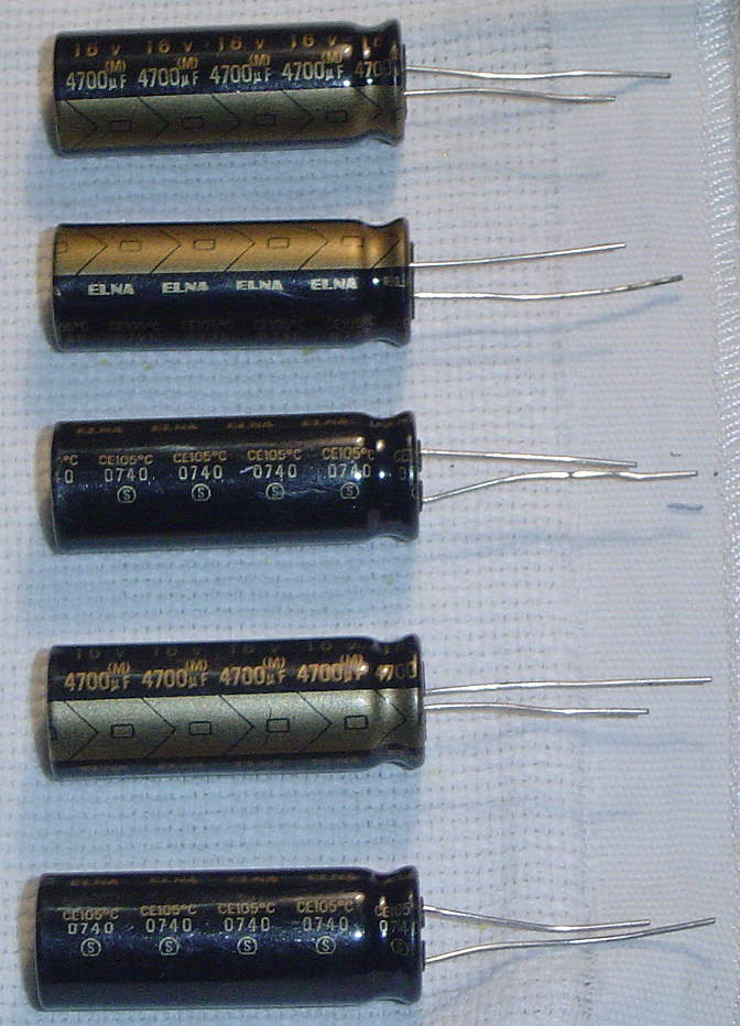

                update the pictures

                  Those are genuine ELNA capacitors (custom made) for car audio application. Not RK or low ESR series, just 105oC ... maybe equivalent to Panasonic NHG or Chemicon KMG, KME

                    Those aren't RK simply because the temp is wrong.
                    That circle-S in place of a series designation suggests to me they are special ordered caps but that is just a guess.
                    They are either fakes or special order.
                    They aren't using the el'cheapo bungs so my best guess would be special order.
                    Short of sending samples to Elna for validation there is no way to know for sure.
