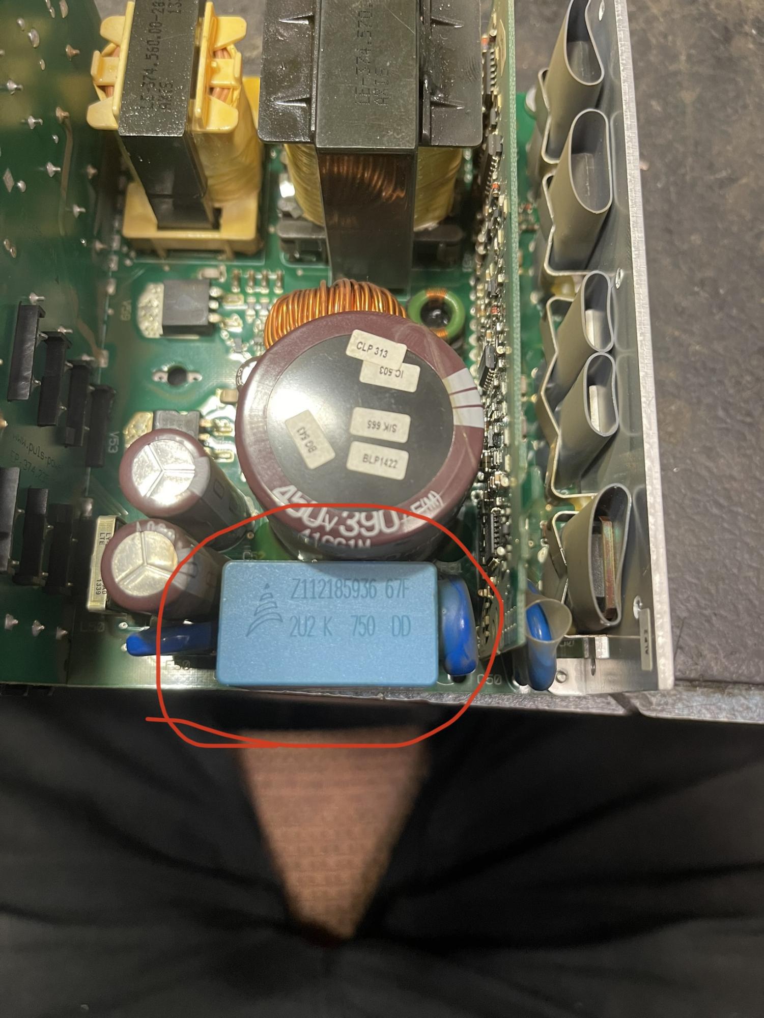

                                      Can’t seem to find this manufacturer datasheet
                                      Z112185936 6/F
                                      2U2 K 750 DD
                                      Stamped on top of cap.
                                        #99
                                        Re: Post help identifying capacitors here
                                        2.2uF, +/-10%, 750V?
