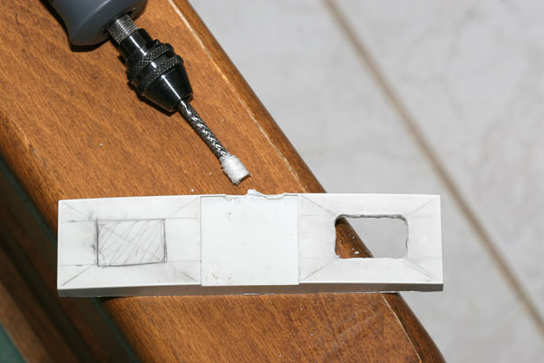

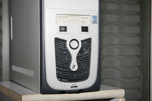

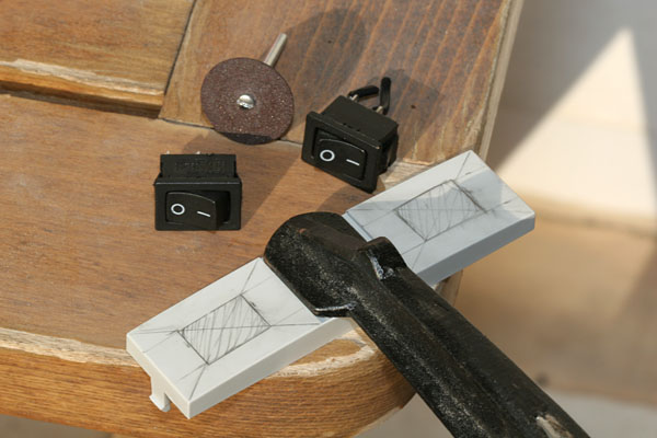

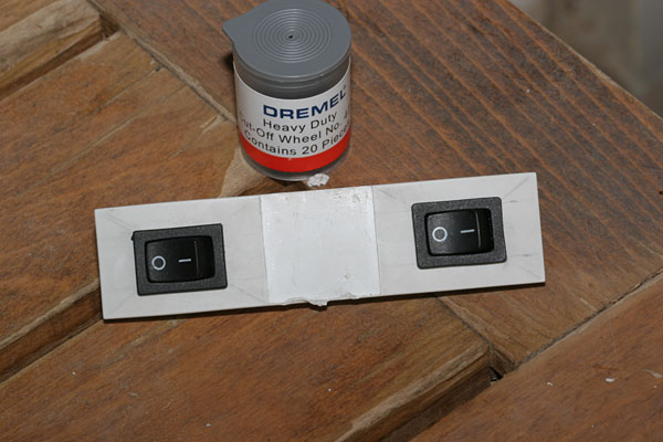

    dont throw away them old psus. L&C actually have some uses. here's one.
    fan switches, its not a very advanced mod at all but i needed this and i had to make something at least before the weekend is out. otherwise i will feel lazy.
    heres the 3.5 bay plate marked and clamped. i was intending to use the dremel cutting wheel but it was too big. you can see the psu switches have two points, we are just gonna split the 12v yellow wire to each fan and put a switch in between.
    i decided to donate a routing bit to plastics only. it worked well but i guess i will have to burn the plastic off the bit in the end to clean it.
    finished and the switches inserted. the clamp made a small damage to the bay plate in the middle because it had a slightly raised lip, i just cut that off with a knife later and looks nice.
    and then inserted in the case and looks nice. one switch for each fan. you can see also the crappy vents i cut into the grey part of the case, they really help airflow but look like shit. so i will chop that out when i get some mesh and then it will look nice.
    oh yeah and i would like to congratulate myself that i did not get injured much this time or make a mess of it. of course i did burn my thumb again but it doesnt hurt so the future is looking brighter.
    warning : wear eye protection when using a dremel. i am serious about that.

    if you didn't draw blood, you didn't work hard enough.
    i know what you mean about uses for dead stuff. I just don't have a collection anymore. When I moved to VA, a lot of stuff got thrown out.

        That does look Good Will.
        Had a Dremel jump out of my hand and got my arm.
        Big scar from that ER visit.

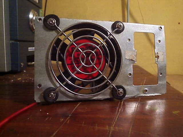

          Even a cheap fan might be useful as a test bench fixture.
            instant solder fume extractor with an old 12v supply

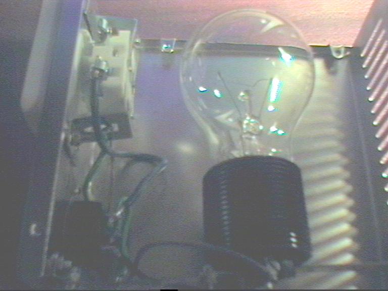

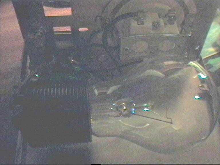

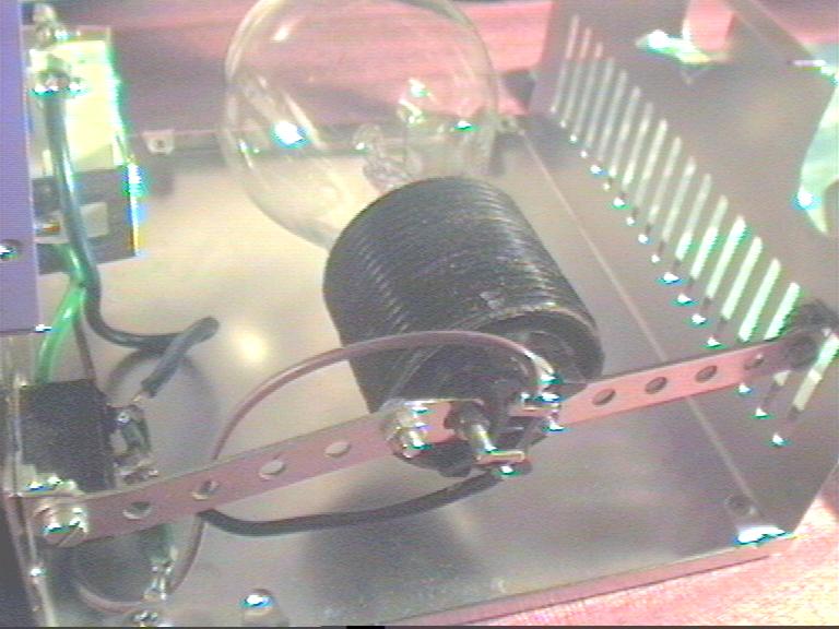

                  I've made a current limiter in a PSU case - a light bulb connected in series. Good for PSU repairs - if something shorts on the primary side, the bulb will limit the current (and light fully), protecting the PSU and also preventing the circuit breaker from turning off the power.

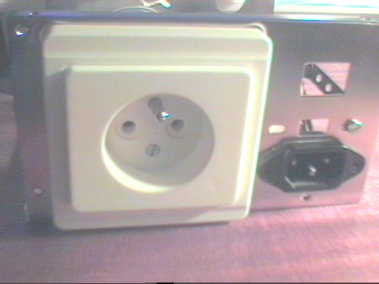

                    Another simple, but useful part is the ATX connector (and wiring) itself! As long as you have a male connector lurking around, such as one desoldered from a motherboard, you can easily make power adapters for such unfortunate pseudo-proprietary machines as Dells or Compaqs.

                      I used the connector two times - once for building molex->ATX12V adapter (to test P4 boards with older PSU - cut out the 4 pins from the middle of the connector) and once to replace burnt connector on another PSU - replaced it completely with cables.

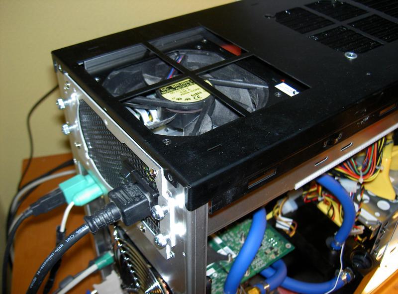

                          On some cases, i like to put the PSU outside (ontop the case) because somehow the system run cooler that way. I add another fan to the rear (the space where the psu been there before), feed with 7V.
                          Maybe you've seen a thing like this:
                            Most important will be that the PSU will run cooler that way! Why, it's the most vital 'part' of the PC... and for some of us, the most expensive too.
                            (img)
                            A little 'ghetto' but certainly effective!

                              Very true! I dont like the idea that PSU should move hot air from inside the case to outside. The PSU should run as cooler as possible (close to temp room). I even think they should be separated from the PC case..
                              The viable solution is to build a psu intake duct/vent: http://forums.silentpcreview.com/viewtopic.php?t=8450
