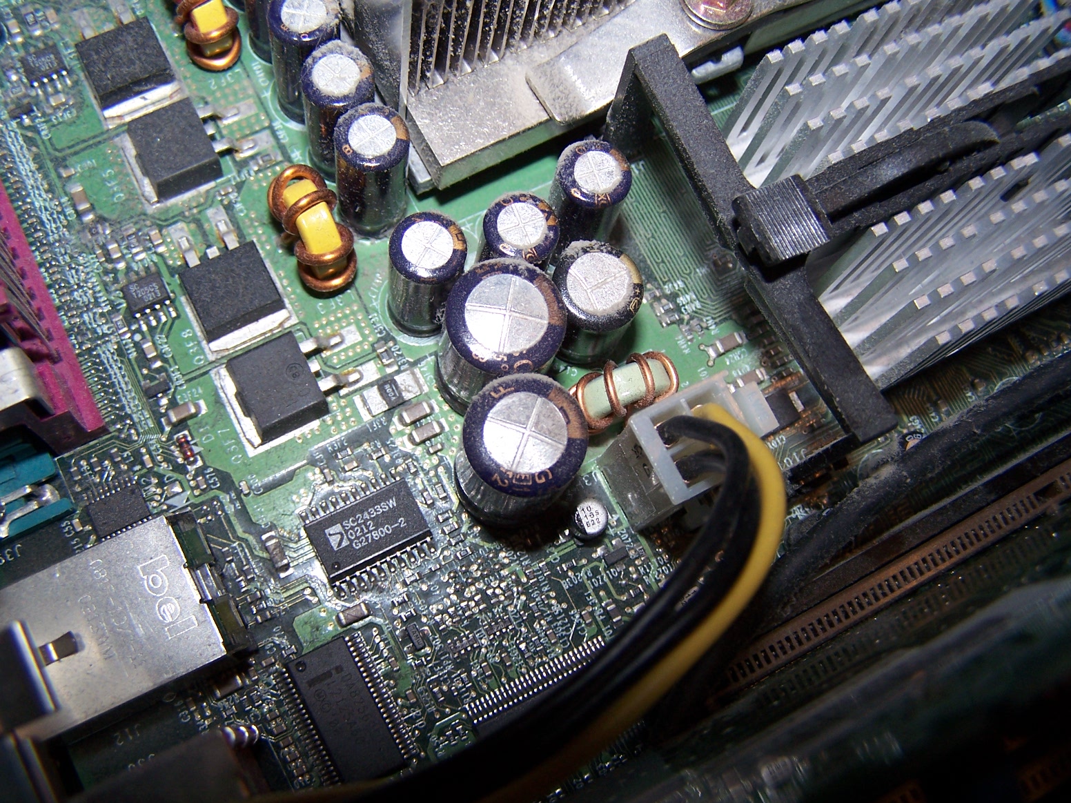

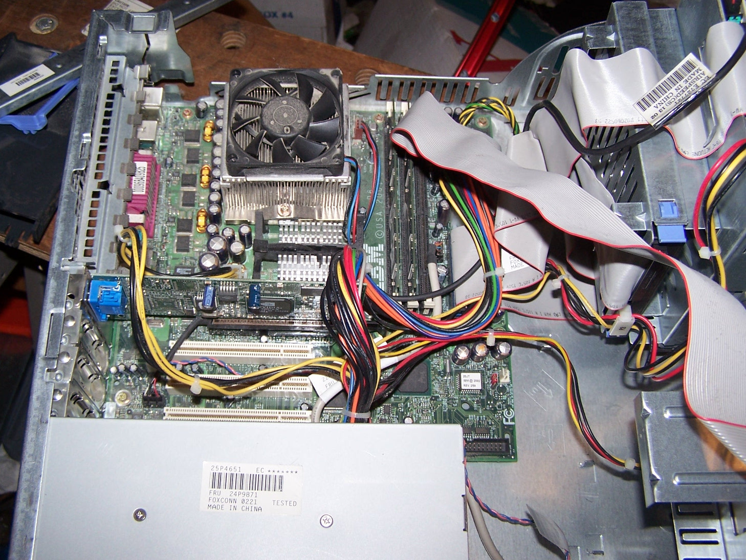

    I bought a complete IBM Netvista 6790 today... for $10.
    I did a quick power-on test and saw that it the pwr LED and the HDD led came on, no beeps (no monitor to test it on).
    Specs:
    Pentium 4 Williamette 1.8ghz
    256mb RAM
    40gb 7200RPM ATA-133 HDD
    CD_RW drive
    Nvidia graphics of some sort.
    Got it to my old house and took some pics:
    (if you are using 56K, hit the stop button NOW... lots of inline pics ahead!)
    All of these pics are internals or the like... who cares about front bezels; there are palenty of those online already.
    General overview (partially disassembled, these pics were not taken in order):

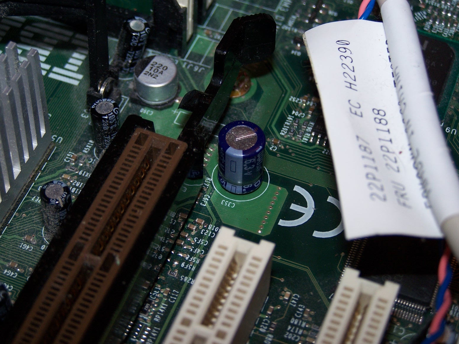

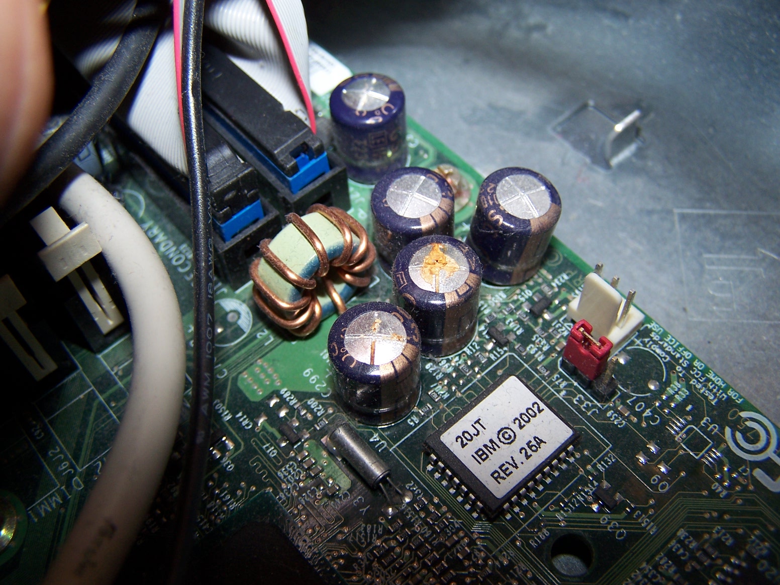

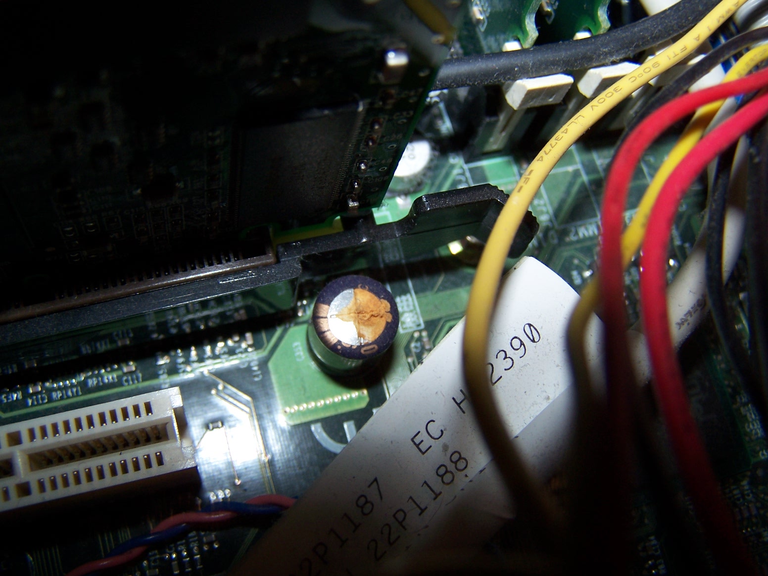

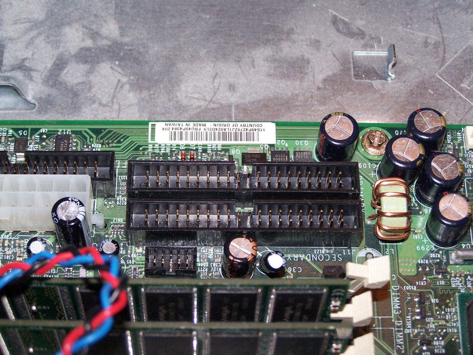

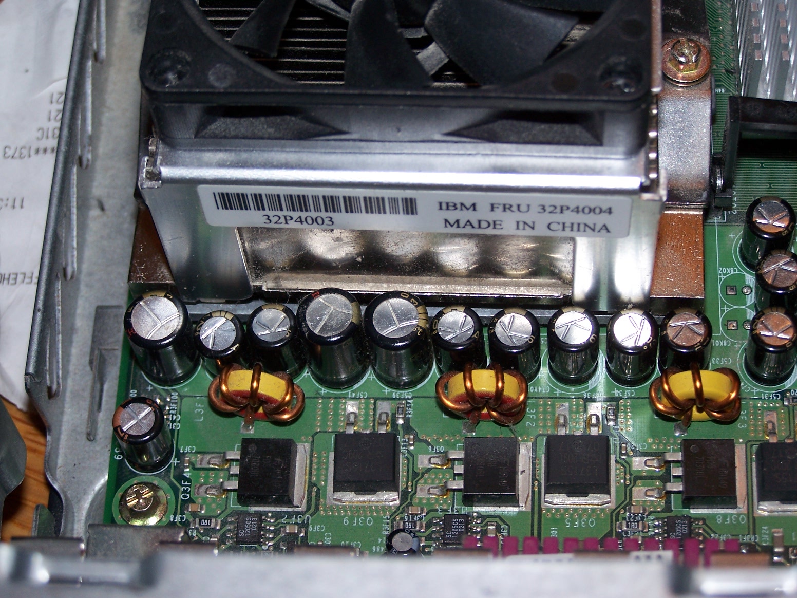

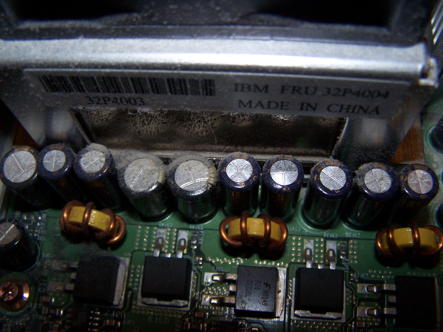

    The good news: there are pannies on this board. The bad news: most of the caps happen to be choyos, most of which are toast:

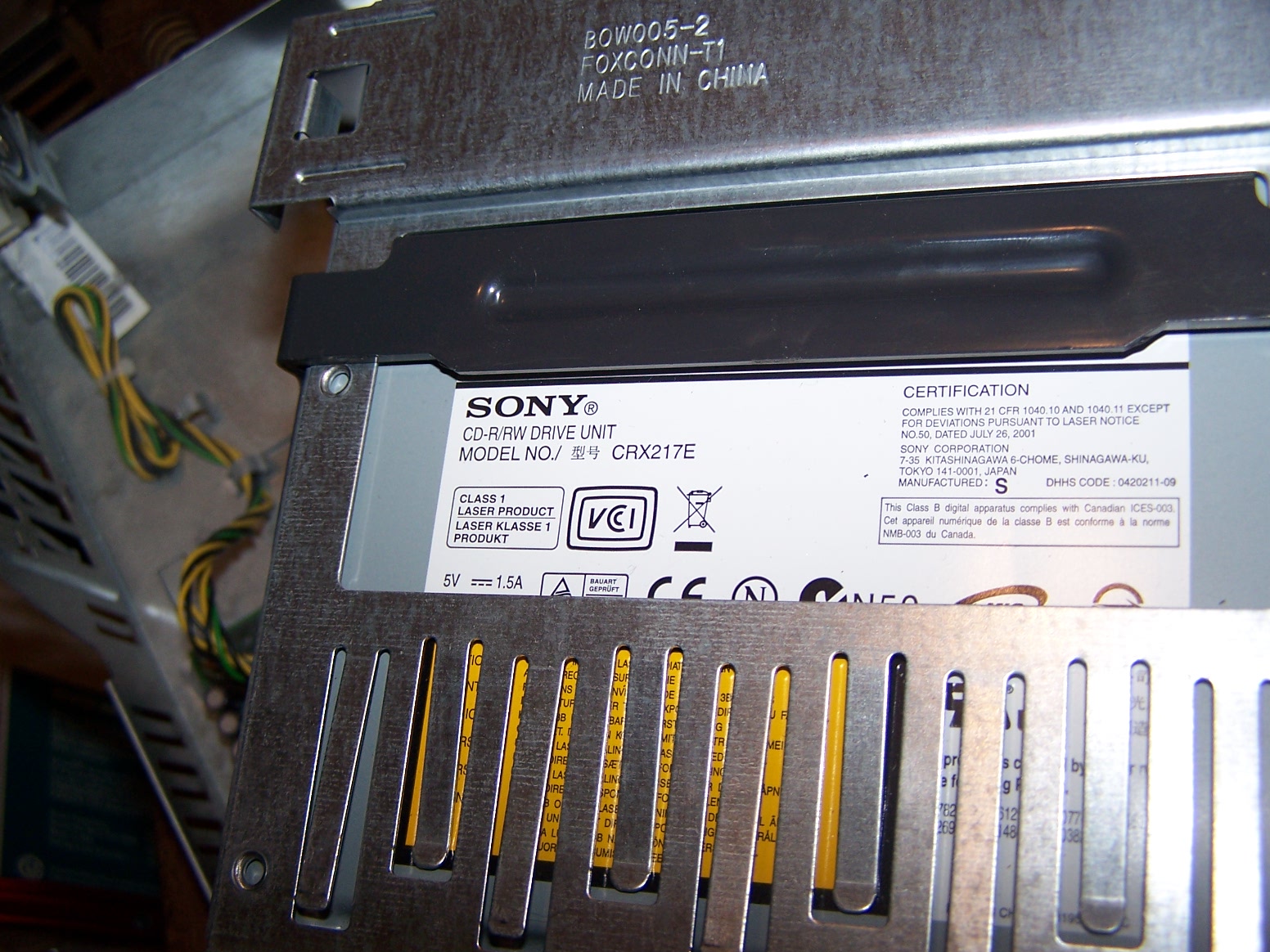

    Aside from that, I am actually impressed by the design. everything is easy-acess; it was designed to be repaired and maintained.

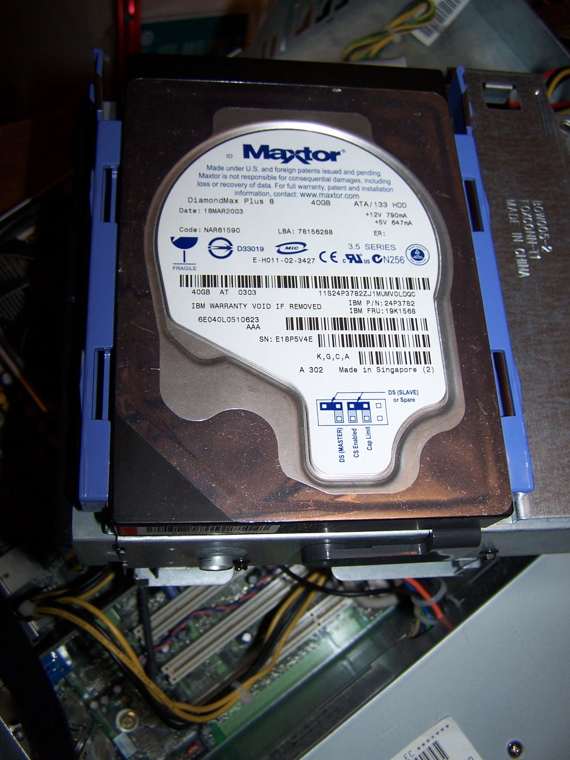

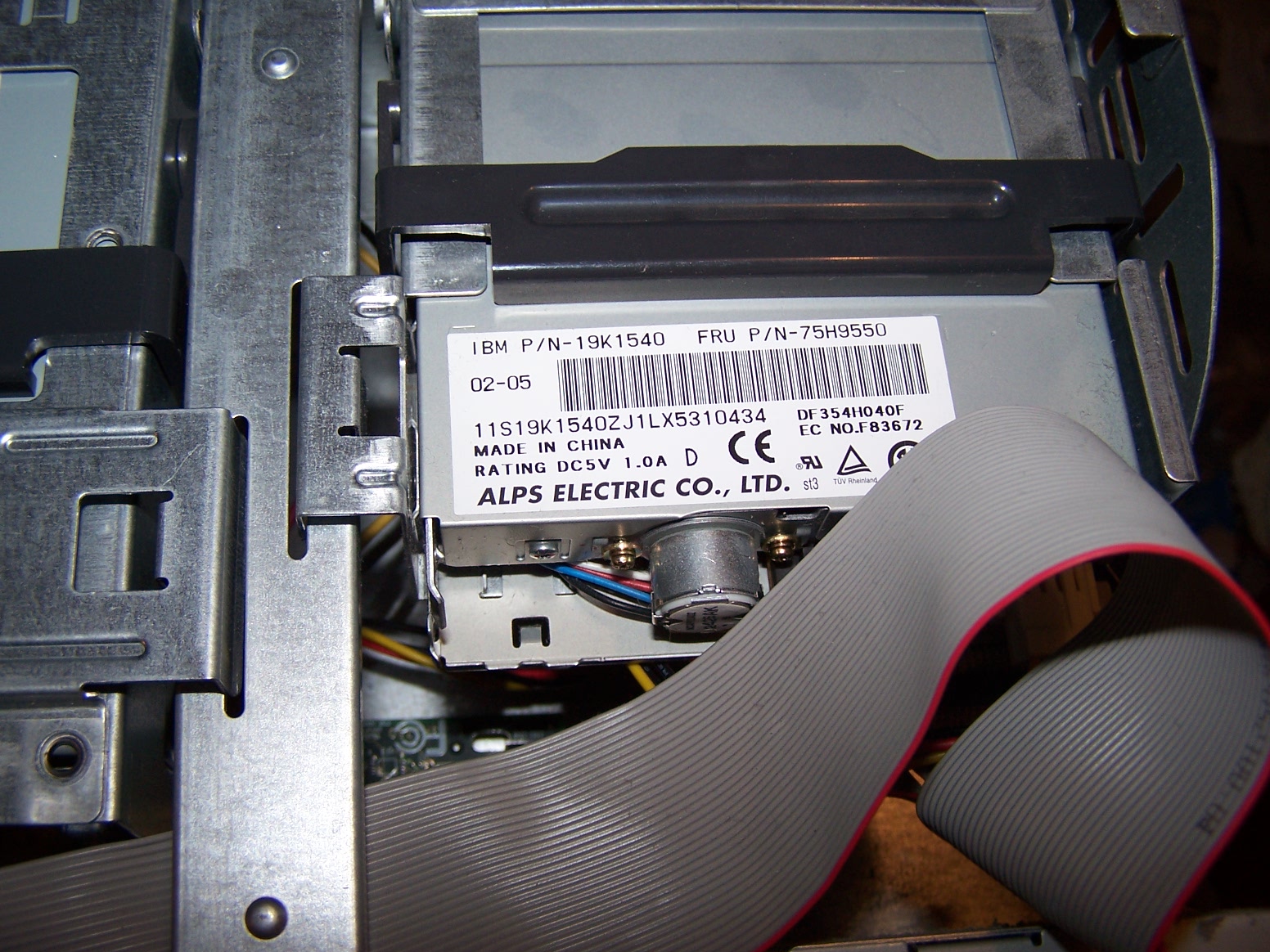

    The drives:

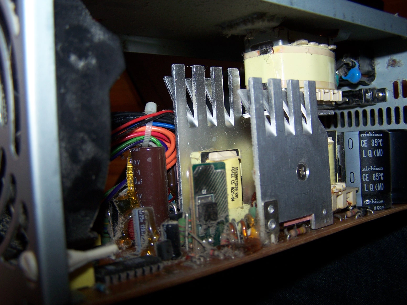

    The PSU:

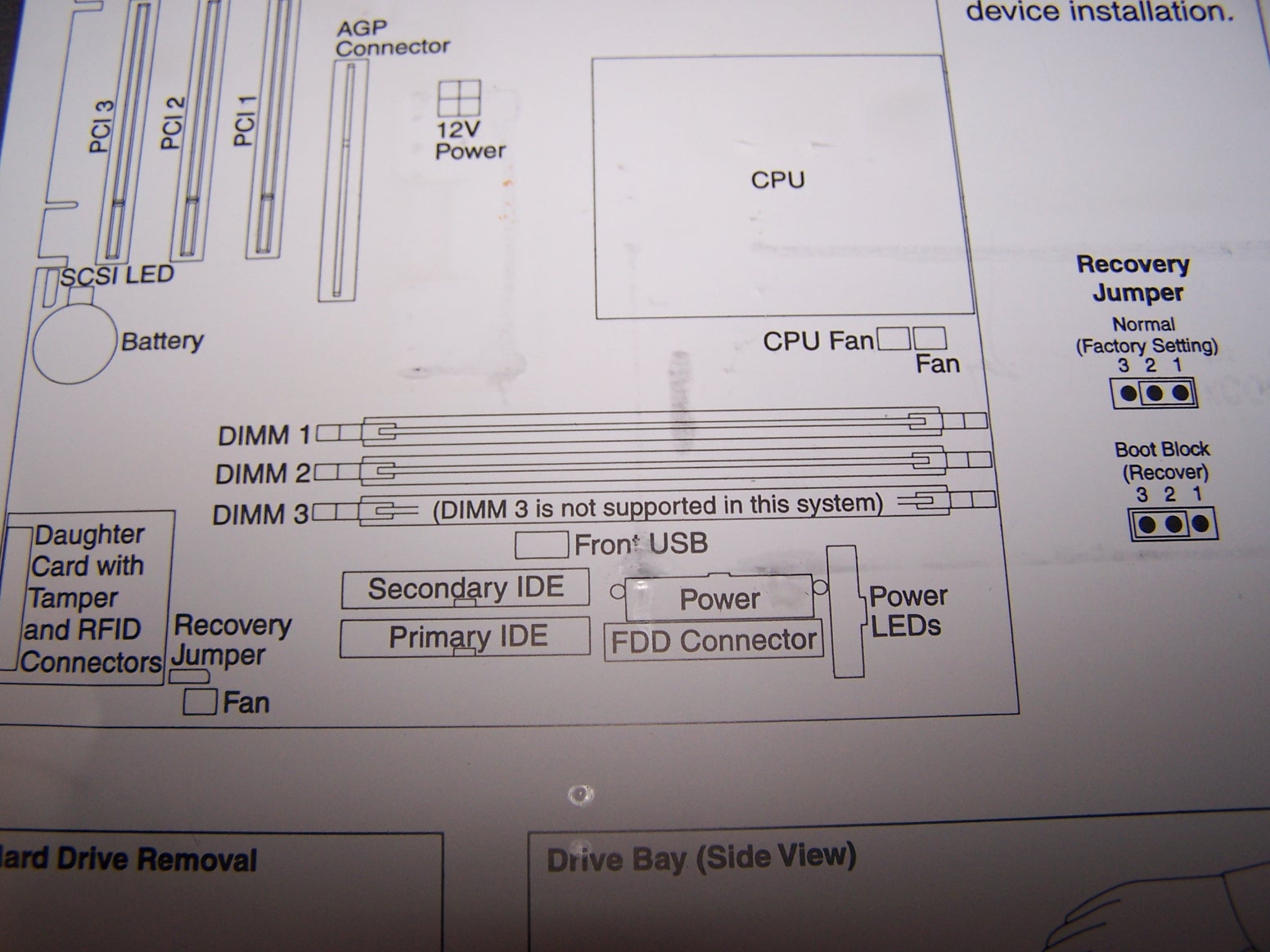

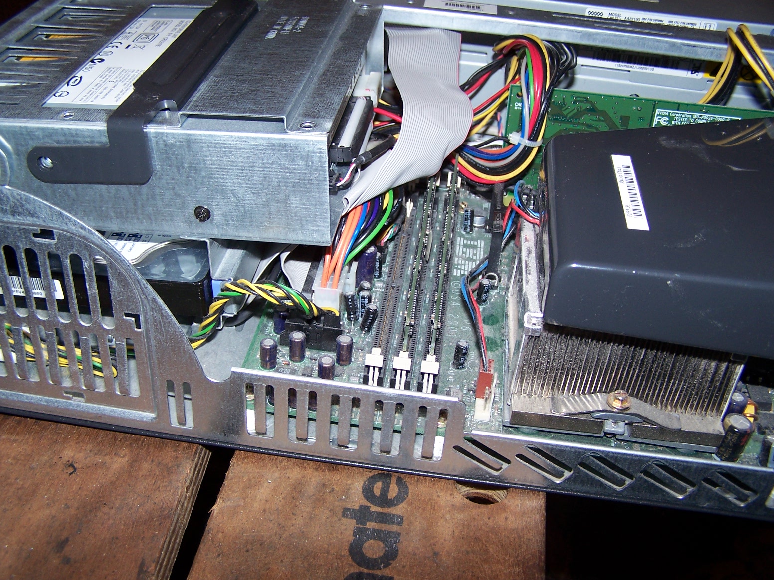

    Here is soemthing weird:
    That's funny, all 3 slots have plenty of clearance:
    I didn't feel good trying to power it up again due to the blown caps, but I wonder if the RAM slot is disabled in BIOS? I checked, unless one is using ECC modules, the CD-ROM bay clears the 3 RAM slots... and the HDD is transverse mounted, so that's not it...

    "6E0xxxx" is a bad Maxtor series.

      i had one die on me before... i feel a tad dumb, as when i bought it i was hoping to at least get a hdd out of the deal... i am short a couple drives as it is.

          The recap seems to be successful... It fired up just fine.
          Pics of the recap to come later...

          The 3rd SDRAM slot is indeed disabled... I wonder if the minitower version's BIOS could be flashed to reclaim the 3rd slot...

            Re: IBM Netvista 6790
            According to your chipset's datasheet it does support up to 3 DIMMs and a total of 3GB. However there may be electrical issues (it being the farthest from the chipset, has the longest traces) that prevented it from fully working so instead of risking data corruption the engineers decided to disable the 3rd slot, although the design was already too late to change. Enable it at your own risk.
              Lenovo says that it is due to the form factor... they also made a minitower version using the same board (my middle school had some).

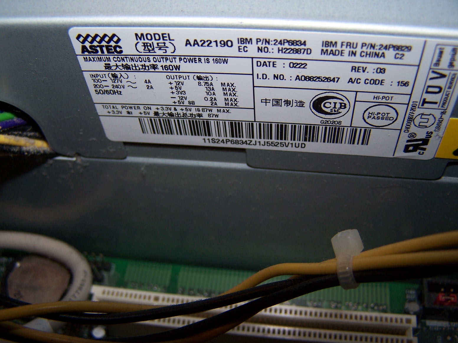

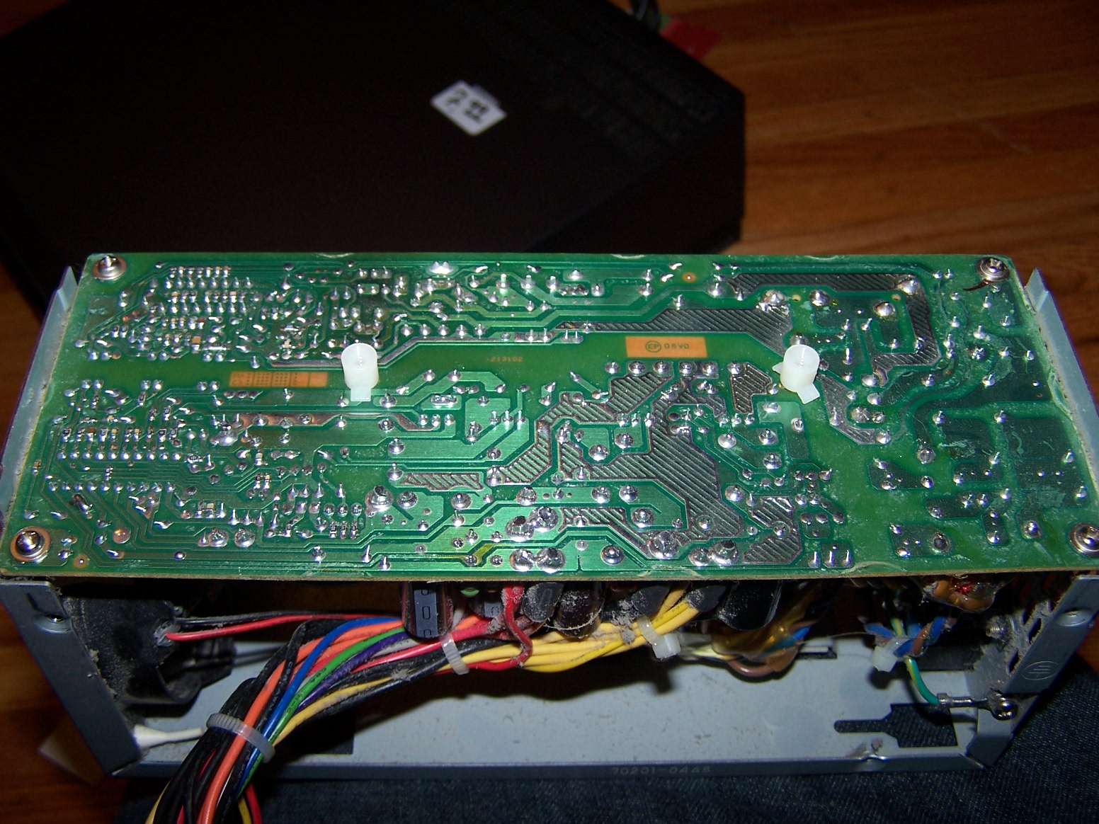

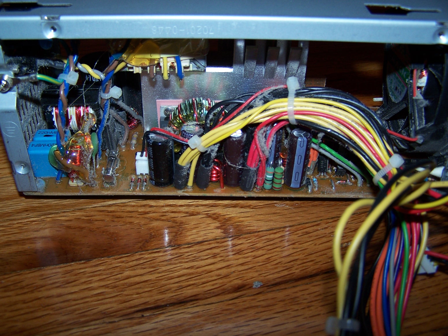

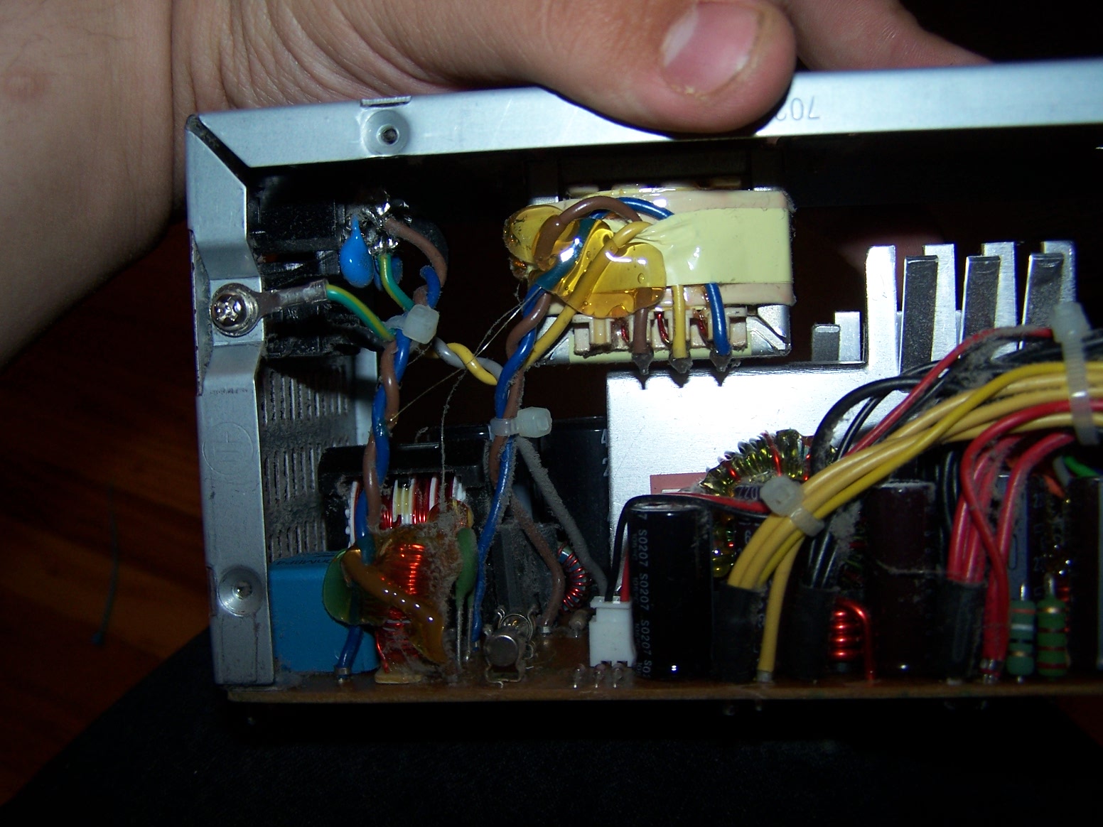

                First, a few of the PSU:
                All of the secondary caps are either UCC or Rubycon.

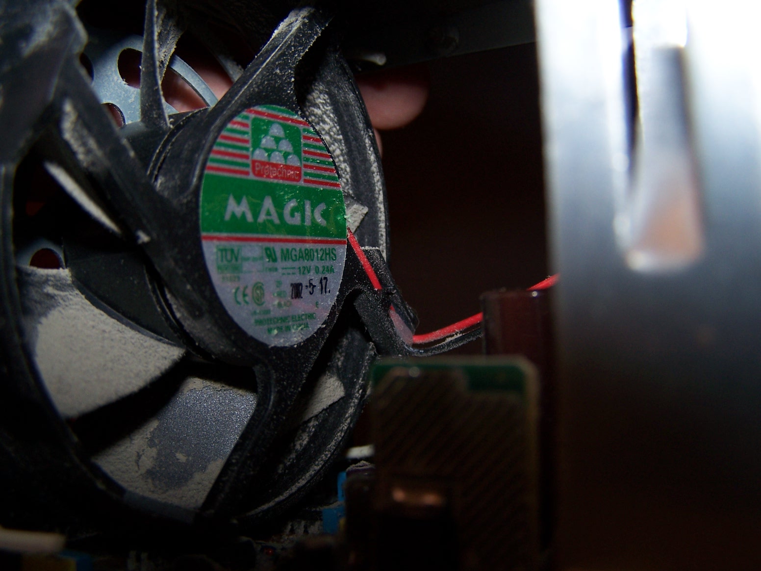

                The fan.
                Plenty of primary guts.
                Decent heatsinks. Also, the only design fault, 85C primary caps... granted, they aren't bulged.
                The soldering is excellent.
                The new caps:
                Look good?
                sigpic
                (Insert witty quote here)
                  Looks great after the recap.
                  That 1.8 GHz Willamate has a TDP of 66W and tops out at 83W - kind of on the hot side for the amount of processing power it posseses. If you have a spare Northwood P4 CPU, it will run both cooler and perform better.
                  The PSU also looks very well made. Is the fan loud on yours by any chance? So far I've had 2 Astec PSUs from old computers, and both run the fans way too high and sound like jet engines. Kind of disappointing on Astec's part. Hope yours is nice and quiet.

                    The PSU fan isn't too bad... the CPU fan is nice and quiet due to temp based speed throttling.

                              I temporaily installed Xp pro to it so I could use the WinPlash utility to upgrade the BIOS
                              Turns out that another Netvista M41 submodel, the 6794 Mini-tower, uses the exact same mobo and bios utility, only it has all 3 RAM slots enabled. The utility had an option to also update the DMI to user defined settings int he advanced settings window. Under system, I chaned the model from "679021U" to 679431U" (a valid numer) and manually copied over the serial no. ; as I found out, you have to do it, or else it gets an "INVALID" string sent and the BIOS bitches about the serial not matching the model (if you do mess up, re-run the utility with the "Update DMI only" option).
                              After some more bios bitching over settings and finding out some of the RAM in the pile might be wasted, I got it to boot and accept 3 sticks of RAM... MOD SUCCESSFUL!!!
