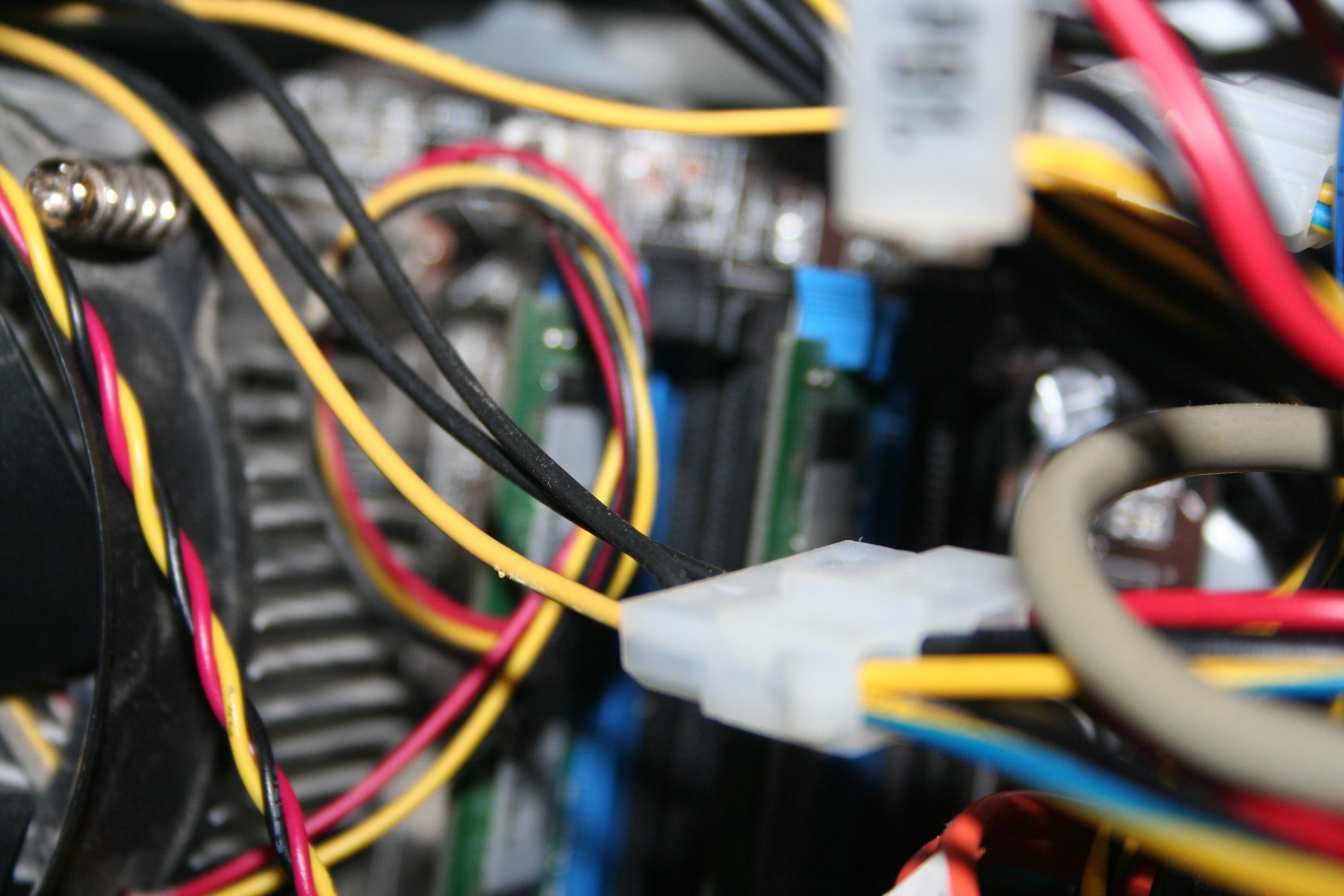

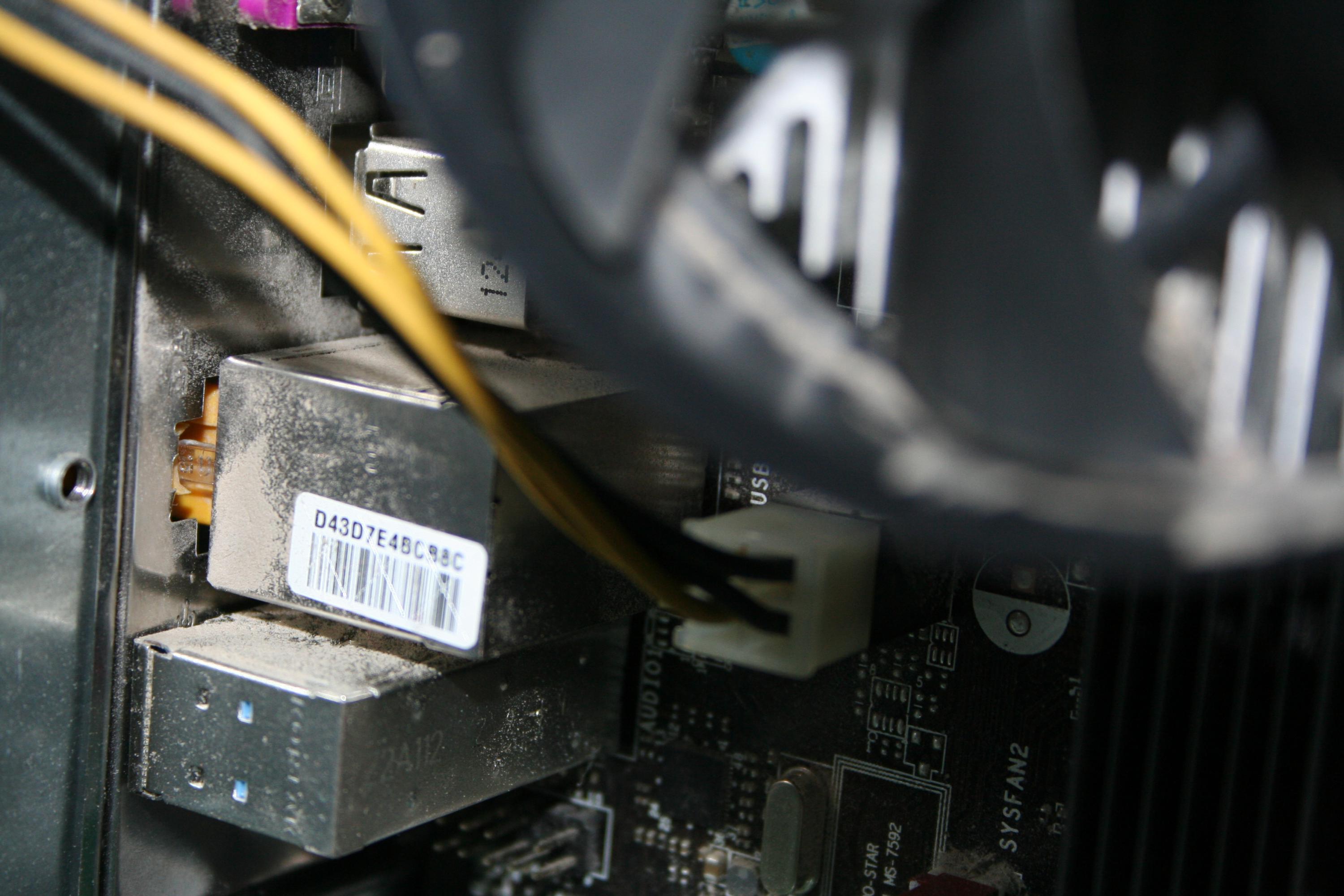

        8-pin power supply + 4 pin mobo = problem. Wait, what's this?
        Aha! A spare 4-pin chopped off an old power supply shoved into a spare Molex connector!

          I don't like to swear, but oh shit dude!
          PLEASE wire that up properly, you will get a fire in your computer leaving the wires shoved into that molex connector. Solder them onto the wires coming out of the PSU ... PLEASE!!!

            I'm going to fix that right now. Although this thing has been running 24/7 with no problems and no smoke, it's better safe than sorry!

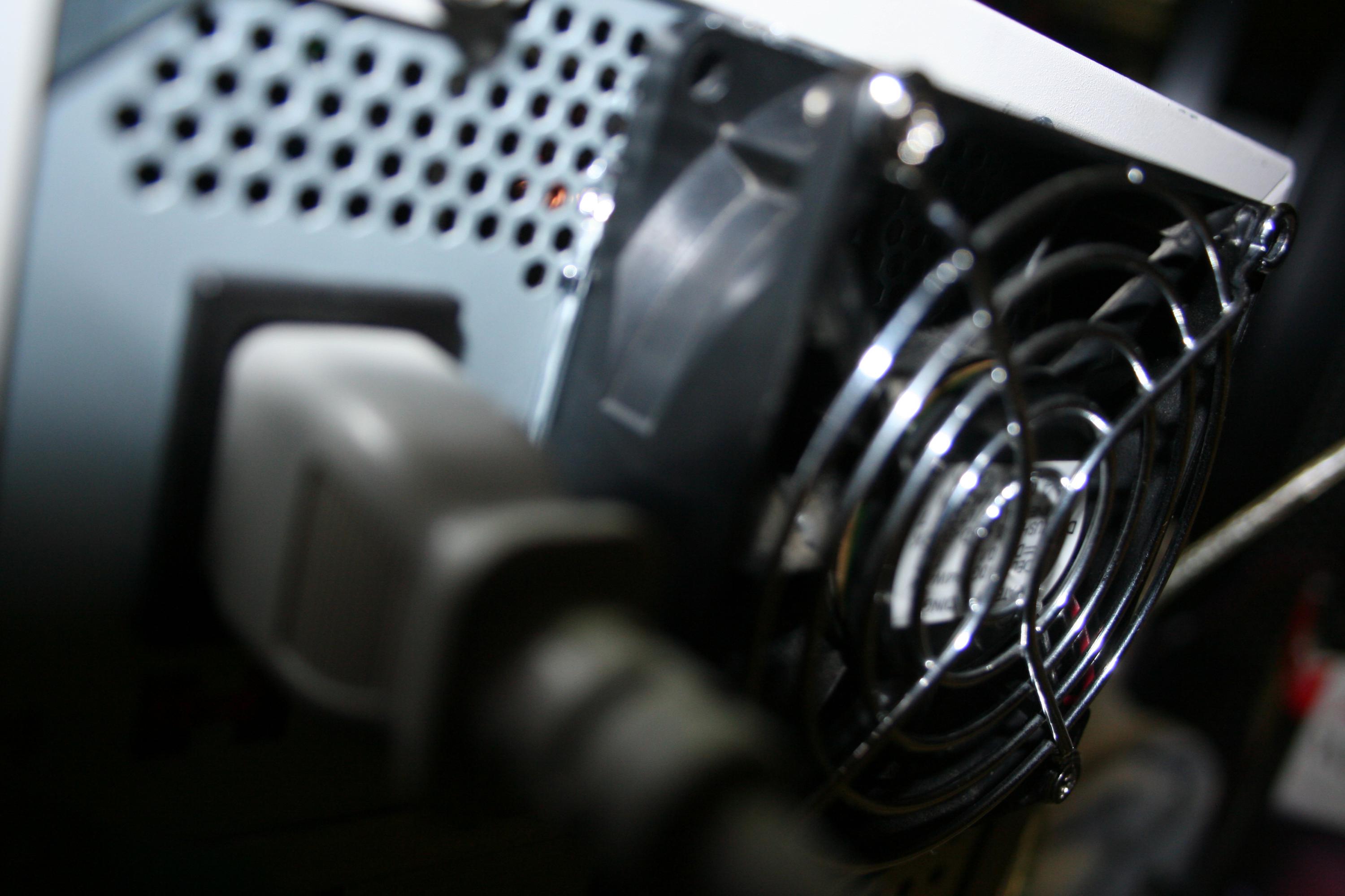

                Okay. Fixed the "P4 power lead tapped off Molex connector" mod, although I had to sacrifice 250 watts of power. So, to boost cooling with my new power supply, I decided to fire up the ol' hot-glue gun and add a fan to the outside (in addition to the built-in fan which is located above the CPU and partially blocked off by a metal piece protruding from the case.)

                      ... to boost cooling with my new power supply, I decided to fire up the ol' hot-glue gun and add a fan to the outside (in addition to the built-in fan which is located above the CPU ... ) ...
                      Coincidentally I'm just perpetrating something similar (alas with good ole screws).
                      >Expand . . . >Expand
                      The extra 80mm blows longitudinally on the tiny heatsinks. Cool .

                        TELVM, Nice Looks awesome! How fast do those fans spin?
                        I'd be curious to know how much that extra fan helps. What I would do is load it up to say, 200W with the 80mm fan unplugged and let the PSU get nice and warm which would probably just take a few minutes, and then measure all the voltages and the temperature of the heatsinks. Then, plug in the 80mm fan and do the same thing to see how much of an impact that extra fan makes. I know that when these half bridge PSU's start to get hot their voltage can drop quite a bit.

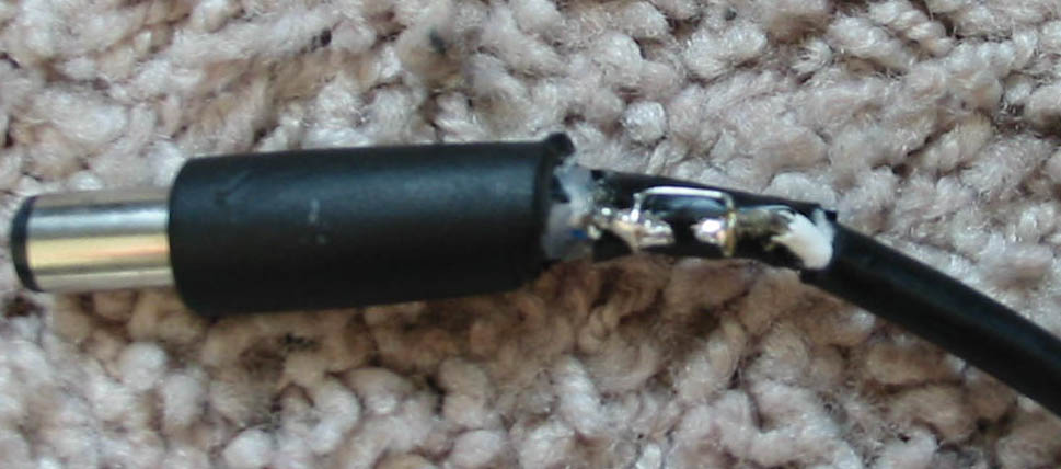

                              I haven't done that much "intriguing" ghetto-modding lately. Just fixed my roommate's power adapter for his laptop. As usual, one of the wires in the adapter's cord frayed and snapped right where the jack plugs into the laptop. I cut off some of the rubber jacket on the jack and also stripped some of the wire, then soldered a staple to join the broken wire.
