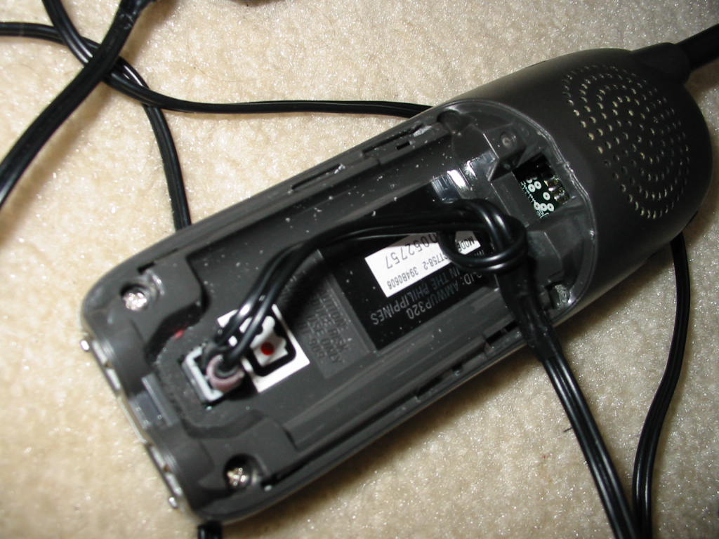

                Here's my latest one: Unided BT-909 cordless phone gutted from its 3.6V 3AAA rechargeable battery pack and hooked to a BlackBerry 5V, 0.7A charger.
                https://www.badcaps.net/forum/attach...1&d=1388367107
                So far so good. Battery is always showing half full (or half empty - take your pick ), but other than that, the phone is working fine and has been in service for over a week now. It saw 4 or 5 one-hour long sessions this week due to the holidays.
                I modded it because I was just plain tired of dealing with dead rechargeable batteries. I think my family has gone through 1 or 2 cordless phone sets over the years. On the weekends, the phone regularly sees several 1-hour long sessions. The original batteries lasted about 3 years. Last summer, I bought some cheap replacement rechargeable batteries from eBay, but their capacity dropped quite a bit within 6 months (nothing unexpected here, though - I knew exactly what I was getting). Micro Center and Radio Shack sell some replacement batteries too, but I suspect those won't be as good as the originals. Plus, at close to $10 a pop when a new phone set can be had for not much more, I decided enough is enough. Ghetto mod time again .
                And oh yeah, why the green tie on the BlackBerry charger?
                - A friend of my mom gave me that charger because the cord was snapped where the cord goes out of the charger. I had to crack it open to fix the cord. Closed it all up with hot glue, but decided to put a green tie just in case.
                By the way, the mod is completely reversible. The wires that are going to the phone have connectors at the end that I made out of thin steel sheet. They plug in right where the battery plugs in. If I ever get a battery again for this phone, I can just take out this mod and put back the new battery in .

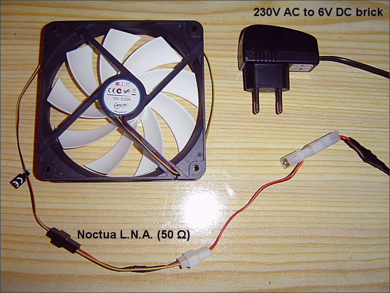

                  ^ Reminded me about my melting-modem-ghetto-cooling-systemâ„¢ :
                    Re: The ghetto mod thread
                    Nice!
                    That's one big fan on that modem. Downloading too many torrents, perhaps?
                      All I did was to add 2 24V 60mm fans salvaged out of an old copier, along with another 2 larger fans (80mm) also salvaged out of the same copier. All run from the 12V rail, and run silent, plus as they are nice ball bearing fans with around 15 years operation on them with no noise they are likely to last a good few years more. The small fans move air along the bottom of the case, and the larger ones move air on the top and there is a 50mm one directed at the HDD bay. Currently sitting at 34C and has been that way for a long time ( highest recorded is 47C) so it seems to be working.

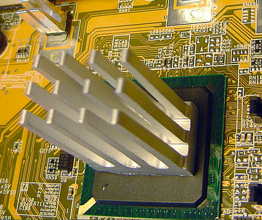

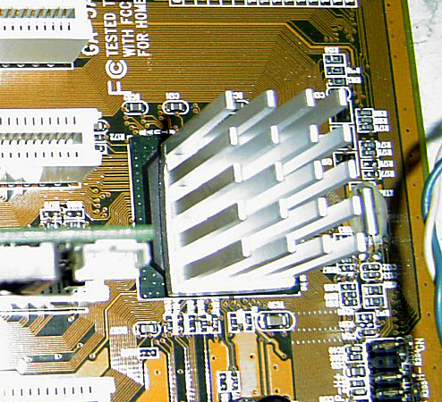

                                I don't really mind bare chipsets, but when they run so hot that you can't touch them even for a split second, you know a heatsink is needed. These were running about 50 to 55C when the system is idle and PC case opened!
                                (Before) bare Southbridge (SB400) of an ASUS A8AE-LE motherboard:
                                https://www.badcaps.net/forum/attach...1&d=1391897638
                                (After) covered with a simple copper heat spreader from a PS3 GPU chip.
                                Temperatures? About 5C lower at idle. Yes, that's not much of a difference (it would help if I soldered some fins on it). But at least it takes a while to build up to that temperature, so the chipset temperature is a little more constant (always better for the BGA). Now, with a small 60 mm fan blowing just a little bit of air over it, the temperature dropped to about 40C idle and 45C max under full system load.
                                Here is another one I did (this time with a PS3 CPU heat spreader):
                                It's a SB450 Southbridge on a MSI MS-7191 motherboard. The temperatures with and without the mod were similar.
                                The metal "bracket" that holds the heatsink on the ASUS board is just a paperclip bent to shape. The second one is made from those metal handles from Chinese food carry out boxes since they are a bit more springy and thicker than paperclips.
                                Don't worry, though! Those heatsinks are pretty secure . I dropped the PC case on purpose a few times from a small distance (without the CPU heatsink, of course) to see if my ghetto mod would hold. And it did. Good enough for me .

                                  I can't believe I've never thought of holding on a chipset heatsink like that before. I always use thermal epoxy and stick in in position (and use a real heatsink with some fins).
                                    Like c_hegge I stick it in position, never thought to use the holes in the mobo. in such a genius way. You were lucky though, the 2 holes are in the middle of the chipset and facing each other. Most motherboards don't have holes nicely placed around the NB/SB. This is my spare router Dlink Dir-600 after it had the WAN port burned, opened it up just to find the ralink rt3050f IC get so hot, so a little copper penny did the trick.

                                      Originally posted by momaka View Post
                                      ... (it would help if I soldered some fins on it) ...
                                      Yup, a lot. A flat plate means a thick boundary layer and hence poor heat exchange with the air. Heatsinks need fins, the taller the better.
                                        Genius? lol, okay, thank you .
                                        The only reason I did it that way is because I just couldn't think of any other way. I mean, I know about thermal adhesive pads, but I always forget to buy some when I'm shopping online. Plus, they aren't the best for thermal transfer and I wanted to get this done the same day. Also, my local Micro Center carries Arctic Alumina Thermal Adhesive, but that stuff is $10! No way I'd spend that for a ghetto mod! Heck, I got the whole motherboard for like $15.
                                        Speaking of which, what do YOU all use to glue heatsinks to chipsets and MOSFETs? (especially you TELVM - I've always been amazed by your CPU VRM cooling mods).
                                        Wow, you have a thermal camera?!
                                        Well, at least my "heatsink" is spreading the heat evenly on the chipset. Hence why it's called a heatspreader on the PS3 GPU/CPU .
                                        Maybe I can solder some pennies as the fins. That would be funny IMO . (but probably effective, nonetheless).
