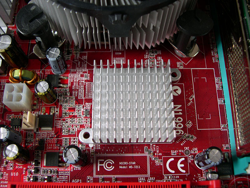

    While the mobo is perfectly stable in normal usage, gaming is a problem. I working hard to make the mobo stable, it is not stable in 3D games. In the end of making it stable it is not stable even in 2D Windows... lol.
    To cut long story short - at first, it was just a mobo full of known bad caps that sometimes refuse to boot and losing clock AND bios settings when power is cut off. Sometimes it also crash during SoF2 _LOADING_ (never gaming), but that it is. Very rare crash.
    So I replaced all the caps, put even these that aren't there back in action and used hi-grade caps. For example the best polymers that even exist Nichicon LE for Vcore and for voltage supply there are Nichicon HZ caps - the best elyte caps even made - king in terms of ripple current, only Samxon GA is "par to par" with them, but that it is. Sourced from Digikey, so, originals.
    Result - still not stable. So I blamed the Radeon 9100 with questionable caps and added 120mm fan blowing on it.
    Still no help, rare crashes of game. Fast Writes disabled, AGP 4x (R9100 cannot go faster), 1 WS Write/Read used, Calibration ON.
    So I replaced the Radeon 9100 with GeFroce 6800GT, that have only 3 caps (Chemi-con polymers) and worked well for me before. Truth is a years ago... http://www.techpowerup.com/forums/sh...d.php?t=189594
    Problems get worser. Even exiting SoF2 or Quake3 is impossible now. It always freeze on exit...! It get reasonably stable for playing, yet try save screenshot and it crash ASAP. So I try lower the AGP rate (allow me to choose only 8x or 4x), disable Fast Writes, disable AGP Master 1 WS Write/Read and even disable AGP 3.0 Calibration Cycle (one by one). No help.
    So I toyed with the voltage, raising from 1.55 to 1.70 and no help either.

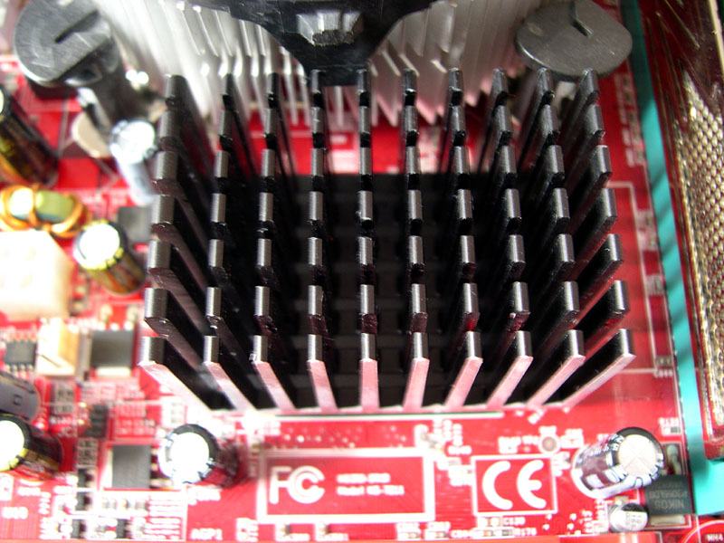

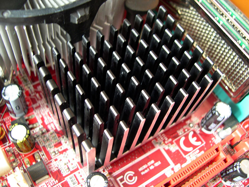

    Another thing that I added a huge nice heatsink on the NB, because the original one was pretty small and useless. And I discovered beneath it, that there was just a dip of white paste widely off center and that was it. Most of the heatsink did not even have contact with the chip...!
    So I tought - I got this! Laped a BIG heatsink, Arctic past used and screwed it tight on the NB... and again no help.

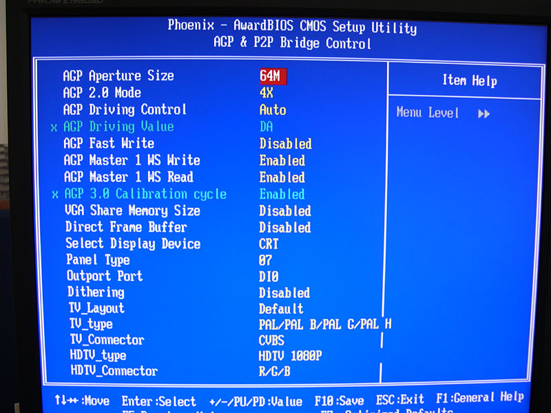

    So the last thing to toy with is the AGP Driving Value. It can be changed from 00 to FF, defaut on Auto show DA.
    Dunno what will happen, but I run out of ideas right now.

        /current situation - get back to AGP voltage 1.55V, disabled only FastWrites, having AGP 8x speed AND - pushed AGP Apetrure size to 256MB and - probably most importantly - changed the AGP Driving Control from auto and AB value (171) to 00 (0) value. Seems surprisingly stable in gaming - till I hit the screenshot save.
        The BSOD, paging fault in non paged area - read in the AGP place...

                What about the small caps near the northbridge and especially the memory slots? -WHICH- PSU are you using and what kind of a re-cap job did you do on it?

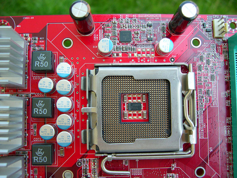

                  I saw the full size pics you posted at xtremesystems... So the small caps are Nichicon and Samxon (Looks like Samxon GC)... Only two more things:
                  1) I assume you also changed the small filter caps near the memory slots, correct?
                  2) This could be a transistor problem. Check for faulty FETs on the board. This can be very tricky since FETs can look seemingly fine in normal tests but then show weakness when driven to their required spec. Someone before claimed that it has been stated that "either a transistor works or it doesn't". I'm no expert, but I have seen examples in videos of transistors looking like they work in circuit but then being unable to deliver their full rated current when tested out of circuit.
                  The reason I bring this up is because I see NIKOS brand MOSFETS on the board. I have a very strong suspicion that NIKOS specs or has in the past spec'd their transistors well above their actual capability. At this point I have to ask who in the world would continue to invest in such an old board, but if you're up for it, replace the FETs with higher quality parts.

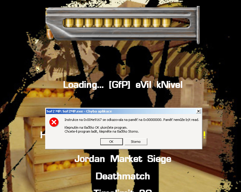

                    Freeze of the game(s) on exit is the issue there. No background software is running, believe me. And yes, I can play the game. And it rarely crash in it, but even that happen, sometimes. But mostly during loading of a level, witch is weird.
                    Also is very veird, that everytime I try screenshot the game is guaranted to crash. And that was not happening before, not with the Radeon 9100 crap card. It "only" sometimes crash with the loading and that it is.
                    Got plenty of screenshots to back up that claim. Seems VIA chipse it oversensitive to the settings or did not like my PNY 6800GT?
                    mockingbird - I choosen 15 pictures and soon build a recapping thread about the mobo. However be sure I exchanged EVERY CAP on the mobo. And added caps where they are omited. I used caps that I mentioned in the thread about it there:
                    https://www.badcaps.net/forum/showthread.php?t=26130
                    ...except the 1000uF 16V HZ Nichicons for Vcore input that are not stock (d8). Managed to squeze there a d10 Panny FM that I had home, HZ ripple is 2500mA, FM is 2100mA, so it was not all that bad. Also now there are 4 caps in the input filter and full load on the output and with Nichicon LE polymers I think I done the best I can.
                    http://s15.postimg.org/dgl956yqz/MSI...3_V_caps15.jpg
                    ...the two big ones in the back are Nichicon HZ 3300uF 6.3V - so best elyte caps ever and best polymers ever existing are used there for the Vcore output. How the mobo can complain?!

                      I started today with the bios v1.5. So I updated the bios, let almost the default settings (all default for AGP) - 8x, Aperture size 128MB, all on, Fast Writes Off.
                      However no help. The SoF2 game works well - untill I hit the screenshot button. Then in crash:
                      So bios are no help and my bios tweaking is not responsible for any failures.

                              Sparkey55 - No, no USB keyboard. Just PS/2 keyboard and mouse. Complete disabling of USB ports? This could never help (USB is on Southbridge, no reason to interfere with GFX card), but I can try that.
                              The BSOD error is quite alone, however. Changing the AGP settings cure it and now it (after the screenshot attempt) just crash, as I show in previous post. But I leave the memtest running to satisfy this test...

                                RJARRRPCGP - pictures are of a 800x600 resolution, used thumbnails for them from PostImg - now I realized that just on BadCaps one cannot click on these to get the full images, lol.
                                Dunno what to do with this.
                                Gotta ask Topcat or try something... I'm clueless. Everywhere it just works fine. Sometimes too much big images would be chaotic, so I opted for thumbnails...

                                Have you replaced the OST caps near the AGP slot? Have you installed the latest driver for the graphics card? Also do have the latest patches or updates for the games you are running? We need to figure out if this is a hardware or a software problem, otherwise we could be barking up the wrong trees.

                                  Agreed that if the OST caps by the AGP are still there, replace 'em. I've seen them left and still run (I have a shuttle box where that was done by the Previous owner) but if I'm recapping, I'm perhaps a bit too anal about making sure everything with a vent and a crap brand is replaced.

                                    You're missing the point, and I did credit you with the fact that you added the cap where there was no cap before. What I'm saying is that the ESR of the VRM IN and VRM OUT should match. If you have Ultra-Low ESR polymers in the VRM low then you should have caps matching their ESR in the VRM high... Also, MSI doesn't use fake caps as far as I know. I don't quite understand you when you say "because Digikey did not know about any Panny FL caps". Maybe there's a language barrier here, but MSI most likely sourced Panasonic caps directly from Panasonic when they did use them.
                                    Regarding the PSU... c_hegge's results speak for themselves, and your Liberty ECO 620W doesn't look like it would tolerate low ESR caps, judging from the pictures of the internals (Although I'll admit I'm nowhere near an expert on this matter). The PSU shouldn't be so easily discounted here.
                                    Yes, he already has. Those are stock photos he posted.
