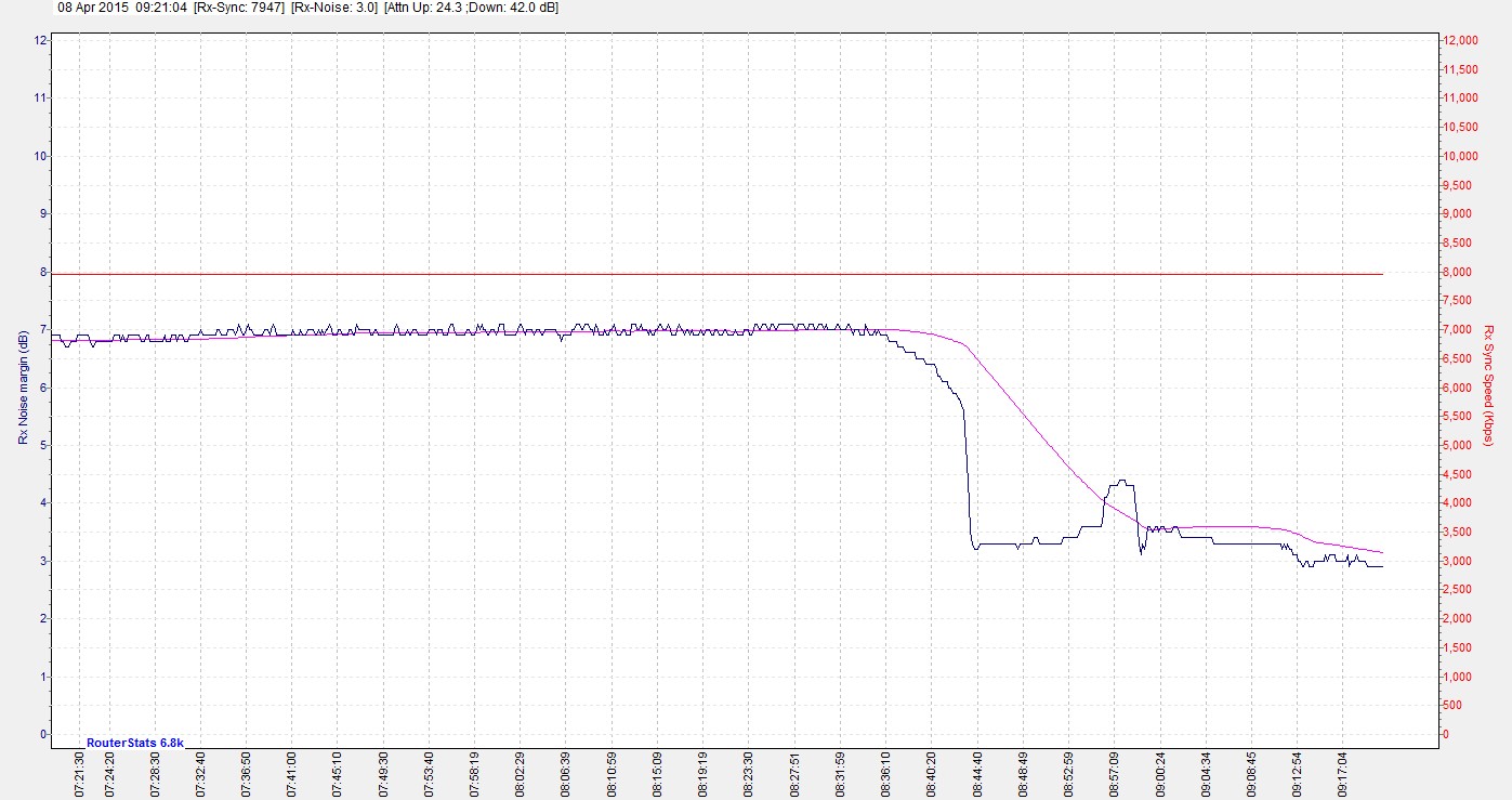

    Hi
    I am having a bad time with my internet - it has never worked great and recently decided to do something about it. I have joined my ISP forum and they are trying to help. I have installed a program to track what the router is doing and some improvements were made. Then after the Easter Bank holiday it all seemed a lot worse.
    Trouble is I dont know how long the problem has been there.
    Tend not to do gaming or streaming or skyping so speed doesnt really matter but having opened a can of worms I am trying to follow it through.
    One suggestion is part of my wiring to the master socket is not twisted pair making it more likely to pick up interference. I am OK with that.
    Please look at the attached graph showing the snr margin when the problem starts. Usually starts at the same time but has finished at odd times on four consecutive days. (wasnt on on the holiday weekend or today Saturday
    The unusual question is: the graphs have a similar pattern and I was wondering if anyone had seen anything like them and had discovered what might cause it. Thoughts are some heavy machinery starting up but I am in a residential area with a few shops and only big establishment with a km is the hospital. Long shot I know but badcaps is a bigger forum than my ISP one.
    and there is vast amount of knowledge out there.

    interesting time 8.45 ish.
    opening time.
    any shops or schools near you ?

                  if it always takes a hit at 08:45 am, when does it come back up?
                  the specific times will help you track it down.

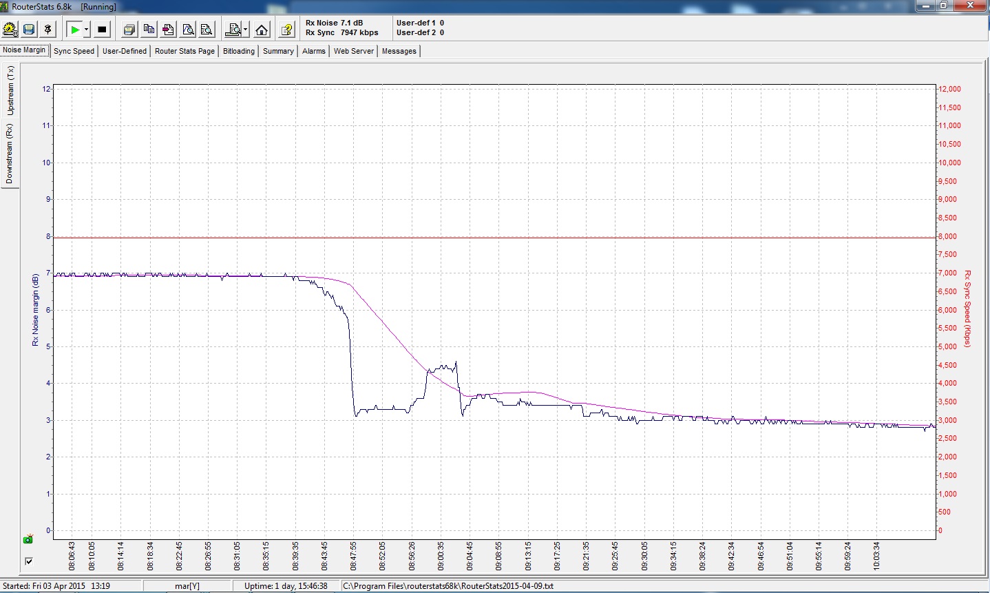

                    Yes I started a table after day 2
                    DATE ..................................ON....................................OFF
                    Mon 6 April Bank Hol - -
                    Tue 7 April ......................... 08-34 .............................. 19-01
                    Wed 8 April ......................... 08-36............................... 17-11
                    Thu 9 April ........................ 08-40 ...............................12=51
                    Fri 10 April ....................... 08-34 ...............................16-10
                    Sat 11 April ok ok
                    Sun 12 April
                    Mon 13 April

                      so weekdays only.
                      fixed start, but not so fixed that it's an electronic timeswitch.
                      friday was before 5 so it's probably not a shop - probably.
                      thursday is interesting.
                      is it half day on thursday in your area?

                        Yes Thursday is a half day for some but I checked the shops nearby and they were all open. Favourite of the shops has to be a computer repair shop!!!
                        at least if that appears to be a problem area he will have some clue as to what I am talking about. I may even go in for a chat and see if he has had any problems. He will likely try to sell me anew router.
                        Daft as it seems I am now hoping the problem is back tomorrow so I can try a few more things. My car radio may show up the noise and as I can scan through the MW band on that it if it finds anything it will show the khz on the dial then I can go out with a portable set on that and try and find where it comes from.
                        Did wonder about trying some ferrite rings on the downwire if I can make loops in the wire. Think they are normally used on mains cables to stop interference from a dodgy appliance infecting the mains? might also try that on the router cable.
