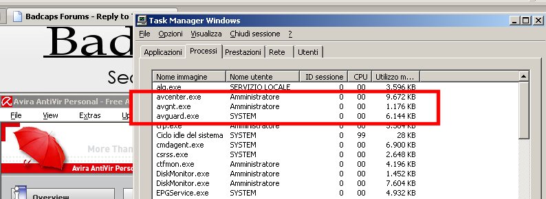

                @ Gianni:
                I use Avira Antivir Classic too, but it requires too much ram for Stevo's notebook: roughly 60 MB in idle while Nod32 runs on about 35 MB. BTW Nod is faster too: Avira was pretty fast until version 7 (2007) when the interface was redesigned and the scanner got a bit slower.

                                @ zandrax: I checked now on my PC how much RAM Antivir eats, and if I'm not wrong, it is around 8MB (avguard.exe + avgnt.exe).
                                If I open the GUI it takes 10MB more (avcenter.exe).
                                Am I missing something?

                                    @gianni
                                    I just happened to be reading your post when my avira antivir started updating. As with other software packages, this is when things get interesting RAM-wise.
                                    I have my task manager configured to show the maximum used ram too.
                                    normal use
                                    avgnt 1MB
                                    avguard 12MB
                                    maximum memory used
                                    avgnt 48MB
                                    avguard 60MB
                                    updating
                                    avgnt 47MB
                                    avguard 14MB
                                    But to tell you the truth, I don't quite get how to read these numbers. I found out the memory usage reported by task mananger doesn't add up. If you find yourself bored someday, try this
                                    - add the memory usage of all the processes reported by task manager.
                                    - compare this with the page file usage reported by task manager
                                    You'll find that the page file usage is much higher.
                                    I have not found a web page explaining this phenomenon.
