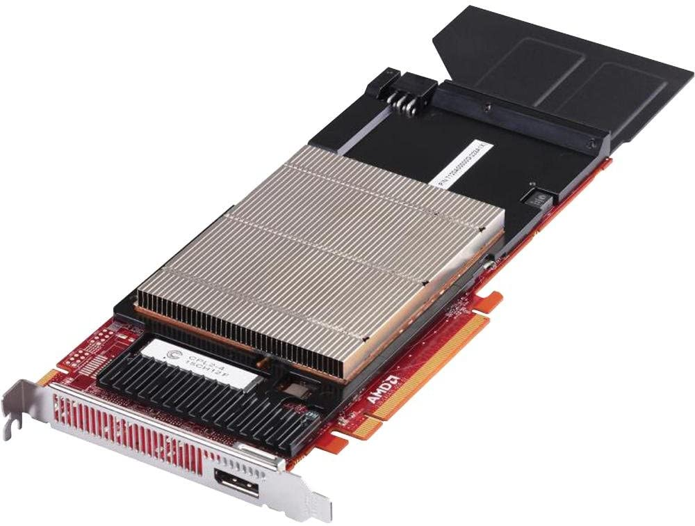

    Got these for a very attractive price, my problem is they are passively cooled and I need to find a way to cool them. The S7000 is pretty much identical to the FirePro W7000, except that it has less DisplayPorts and it's meant to be used in rackmount servers with noisy high CFM fans running at full blast all the time.
    I was thinking laptop CPU fans but most of them are 5V and I was hoping for 12V so I could control them via software.

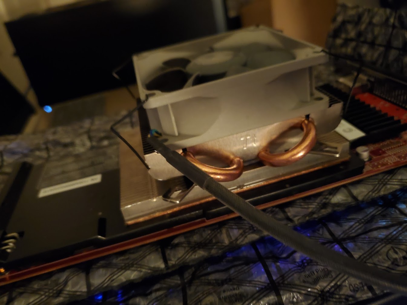

                    Well, the laptop fans were fine in terms of cooling but way too loud at 5V :/ going to try a new approach...
                      Re: Best cheap way to cool AMD FirePro S7000?
                      That's actually a nice fit.

                        I know, it is definitely quite nice looking. Unfortunately it was just too noisy. I left that pretty but whiny solution on one of my cards and put it in one of my servers where it will be useful but noise doesn't matter. The one in my PC where noise does matter got this ugly solution. I JB-Welded some random old CPU cooler to it. The Noctua 80mm fan even at full blast is very quiet. Some fan noise is audible through the case but it's barely noticeably vs the screaming noise of that laptop fan. The downside is it now uses up four slots so not really useful long term as I had to ditch my USB 3.1 type-C card and my sound card.
                        Now that I have proof of concept and the dual displays work in a sort of hybrid GPU/passthrough setup through my Intel iGPU I'm going full steam on a better graphics card. Unfortunately I kinda failed to do my research beforehand (like usual, I seem to never learn) and the AMD S7000/W7000 doesn't support everything I need so I'm going with a Tesla M40 instead. The good thing is I can just put the ugly S7000 in my server and sell the other one I didn't hack up back on eBay or something.
