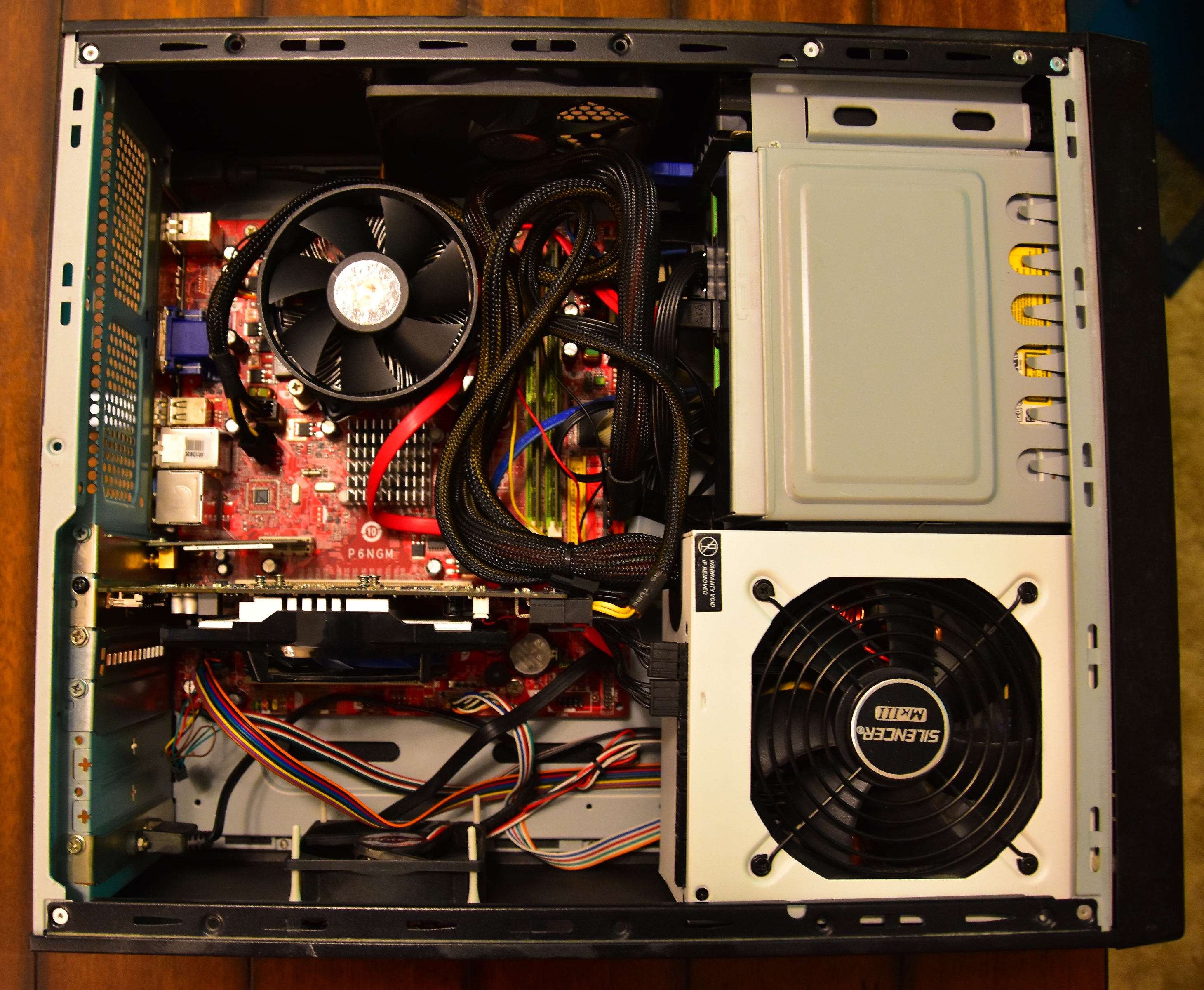

      The old nForce 610i (MCP73) equipped MSI P6NGM (MS-7366) board in my media center PC is still alive and kicking, but that is likely the exception to the rule.
        well, first off, it has quite a tall and beefy heatsink for the mcp with lots of fins on the heatsink, plus its quite tall and close enough to catch some breeze from the intel stock cooler so that it can receive some cooling from the cpu fan as well. so both factors may have helped in its longevity.

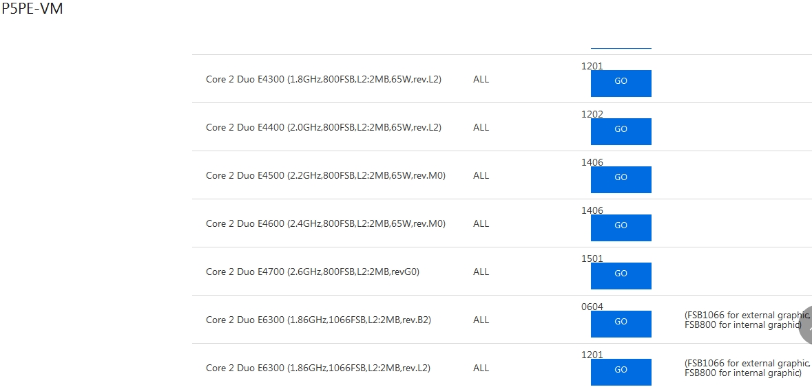

          Speaking of 775 and old... just got hold of a ASUS P5PE-VM... i865G. It supposedly supports as far as E2xxx Pentiums, but I haven't been able to test that yet - the only CPU I've run on it is a P4 631. Neat lil' board, and if by magic people did run better CPUs (even as far as early C2Ds), I'd be more than happy to do a "retro" build with it. Gotta put my HP OEM'd Audigy 2 ZS to work somewhere.

            Yes, I imagine good cooling (both MSI putting a decent heatsink on it and being in a case with plenty of airflow) as well as always being used with a dedicated GPU is probably what has kept it alive this long.

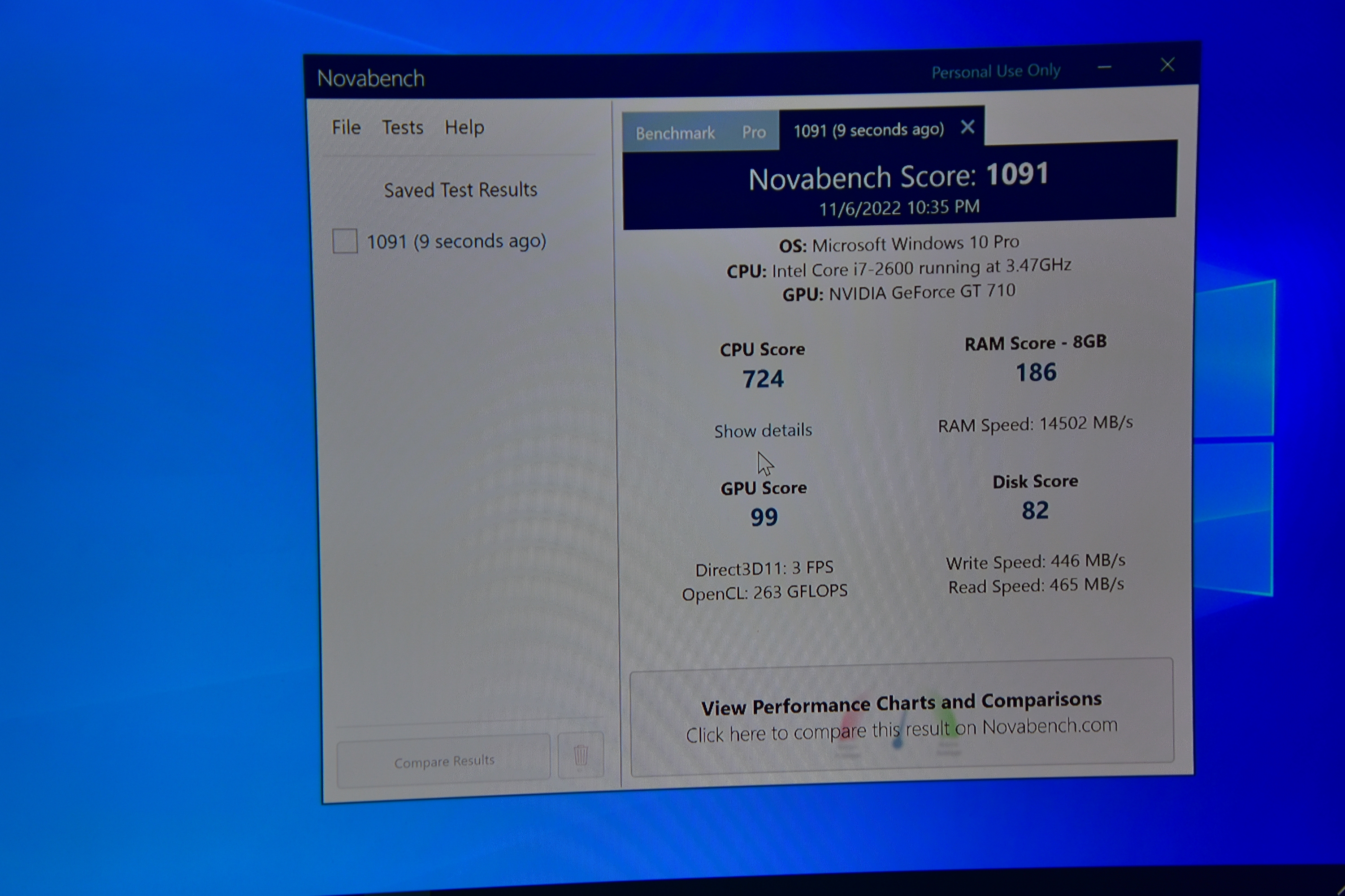

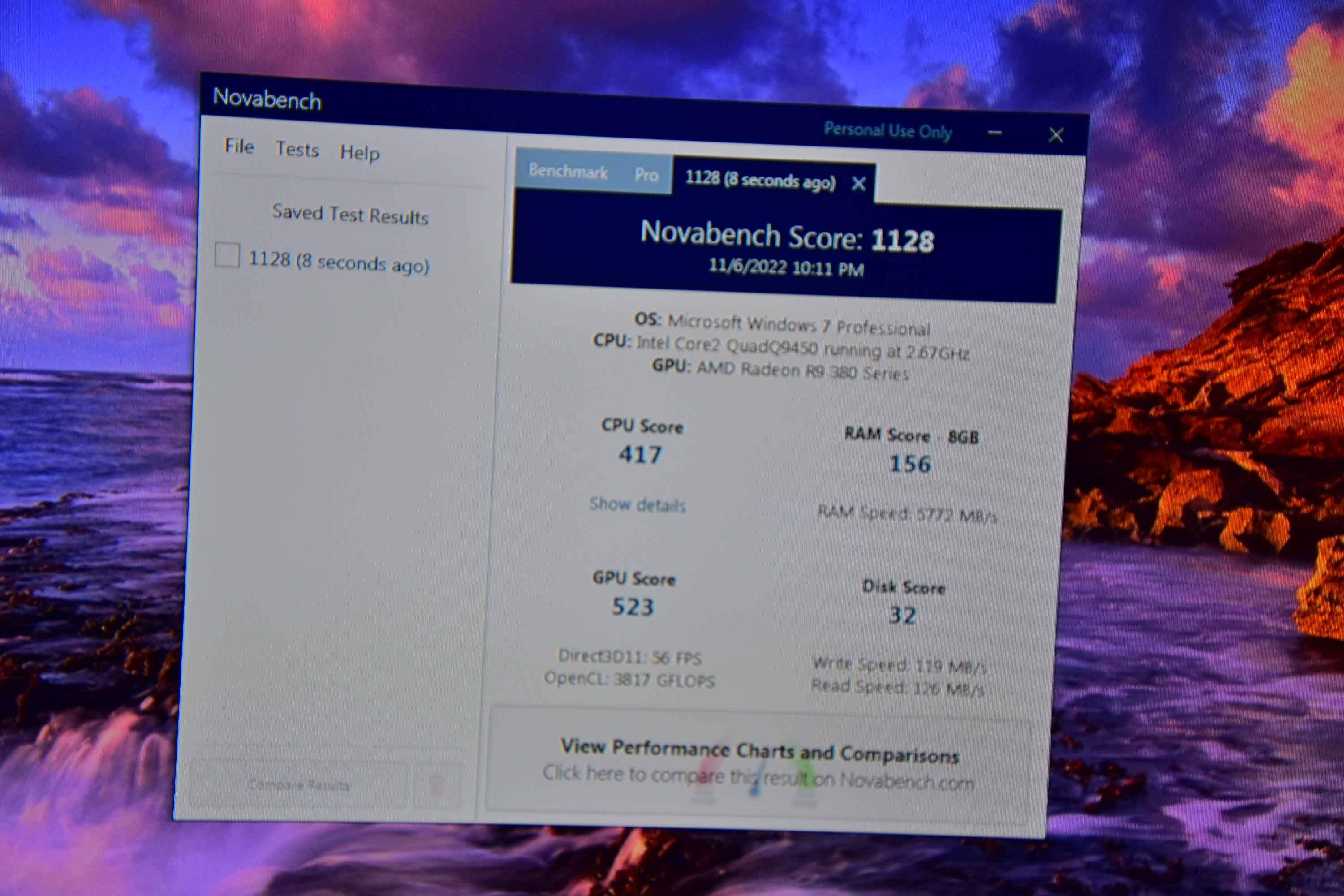

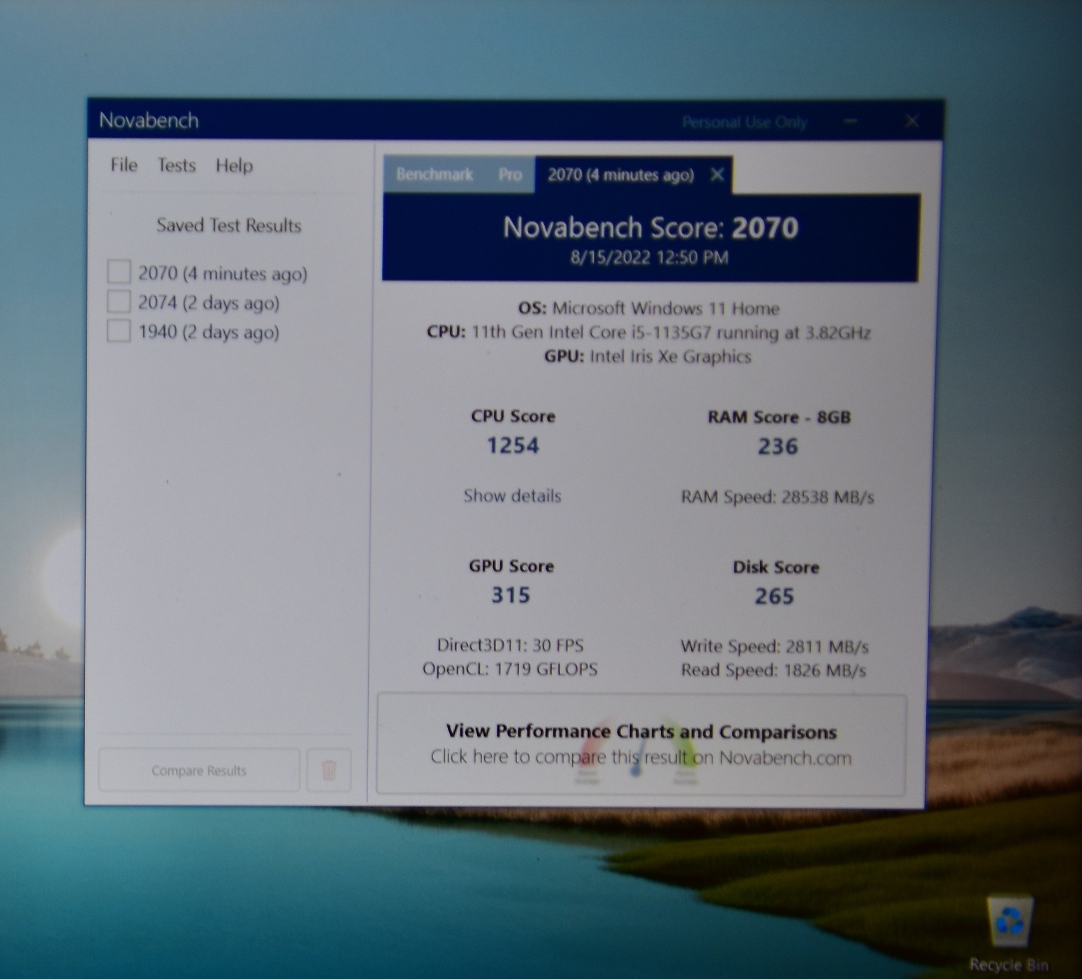

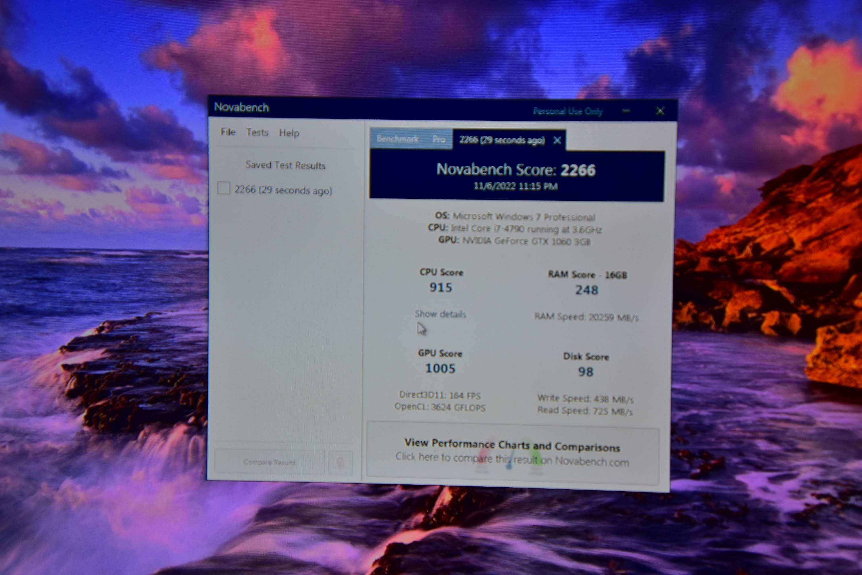

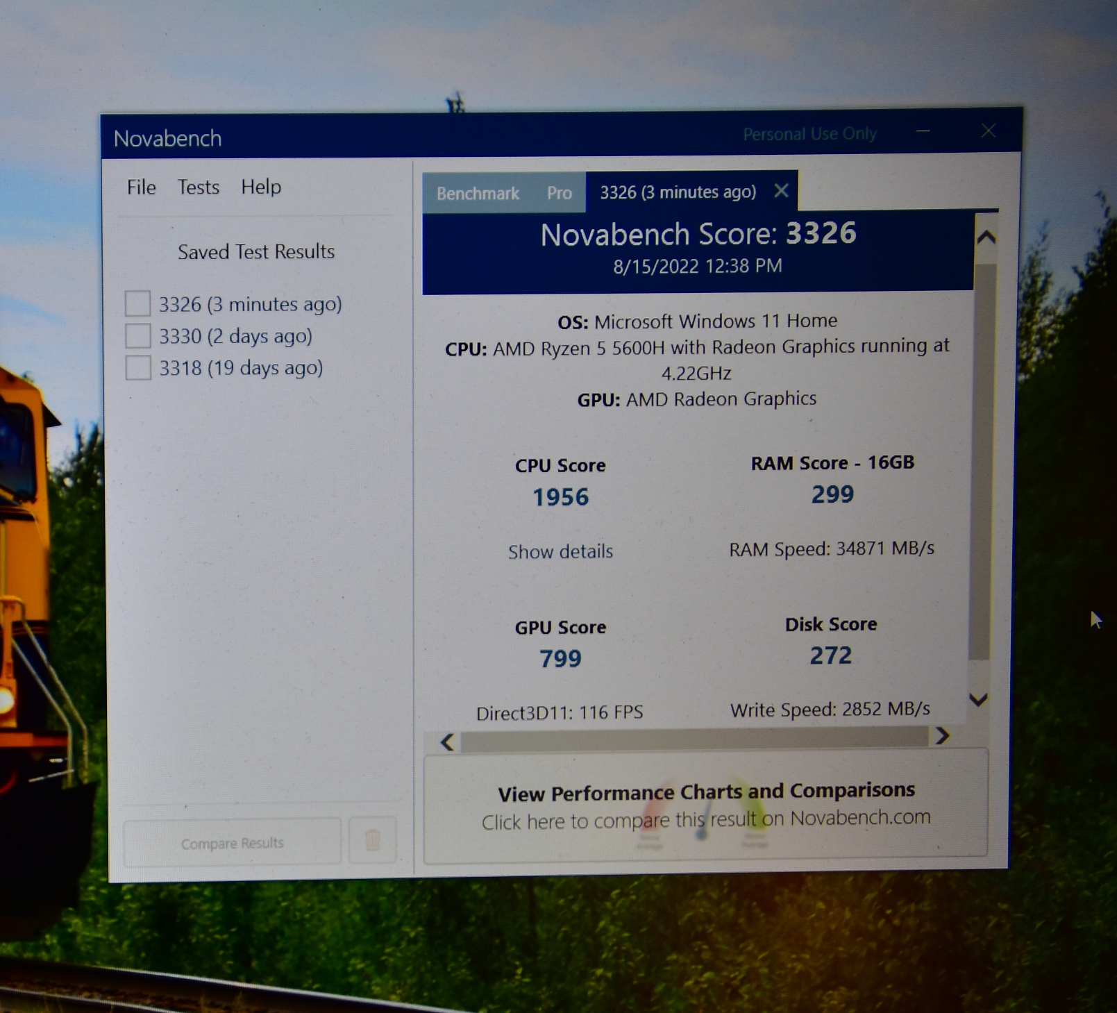

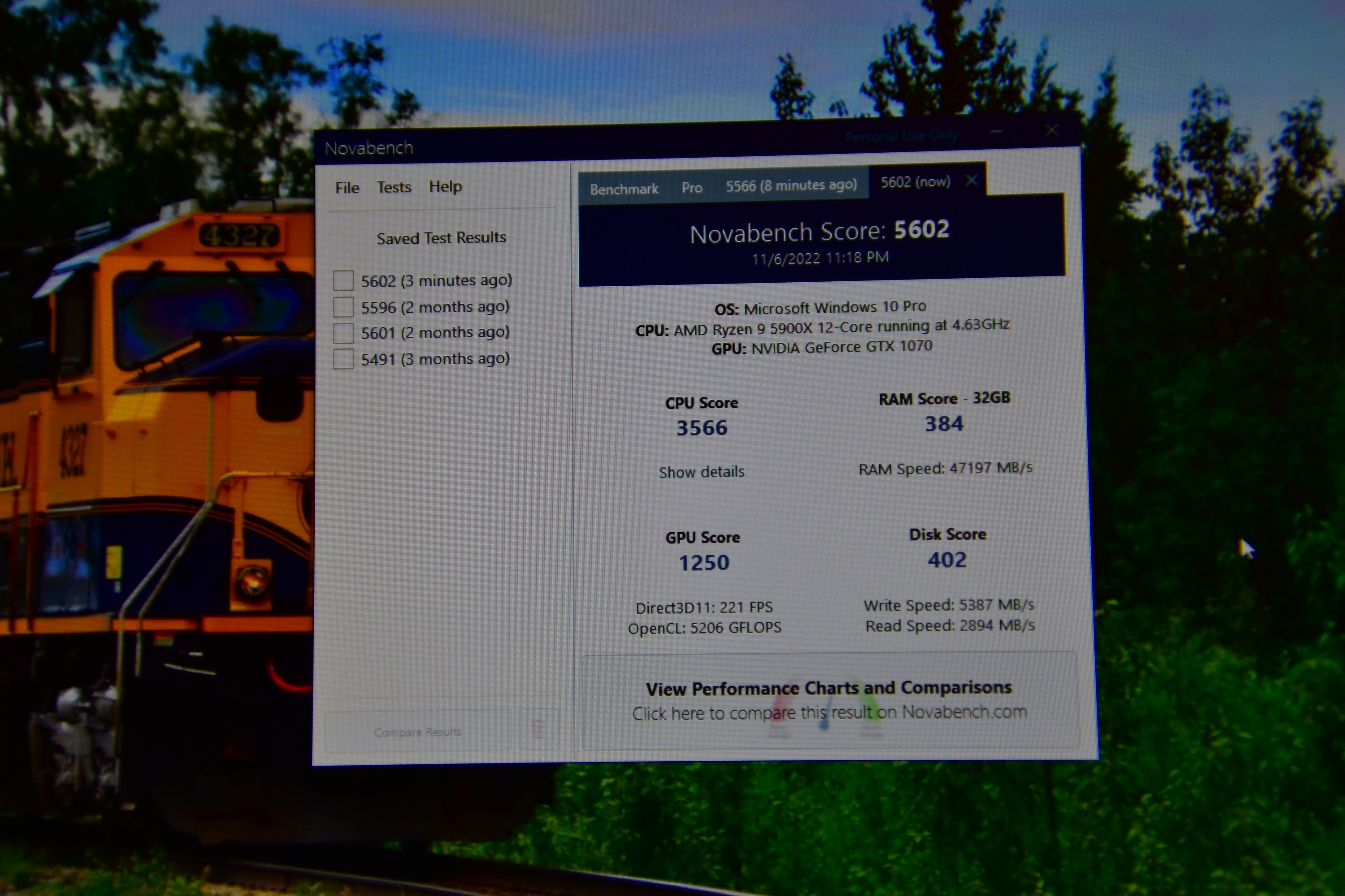

              Elaborating on this I dug out some old hardware to do some comparisons:
              Specs:
              CPU: Intel Core2Quad Q9450
              RAM: 8GB DDR3-1333
              Boot Drive: Western Digital Velociraptor 160GB 10k RPM SATA HDD
              GPU: AMD Radeon R9 380
              Motherboard: Gigabyte EP45C-UD3R
              Chipset: Intel P45
              OS: Windows 7 Pro
              Specs:
              CPU: Intel I7-2600
              RAM: 8GB DDR3-1600
              Boot Drive: Team Group AX2 256GB SATA SSD
              GPU: Nvidia GeForce GT710
              Motherboard: OE Dell Optiplex 790
              Chipset: Intel Q65
              OS: Windows 10 Pro.
              (this takes a pretty big hit on the GPU, but CPU easily beats the socket 775 system)
              Specs:
              CPU: Intel I7-4790
              RAM: 16GB DDR3-1600
              Boot Drive: Crucial P3 500GB NVMe SSD (note: the slot on this motherboard runs well below what the SSD is actually capable of)
              GPU: Nvidia GeForce GTX1060 (3GB)
              Motherboard: Gigabyte Z97X-Gaming 3
              Chipset: Intel Z97
              OS: Windows 7 Pro
              Specs:
              CPU: AMD Ryzen 9 5900X
              RAM: 32GB DDR4-3200
              Boot Drive: Western Digital Black SN850 2TB NVMe SSD
              GPU: Nvidia GeForce GTX1070
              Motherboard: MSI MPG X570 Gaming Plus
              Chipset: AMD X570
              OS: Windows 10 Pro.

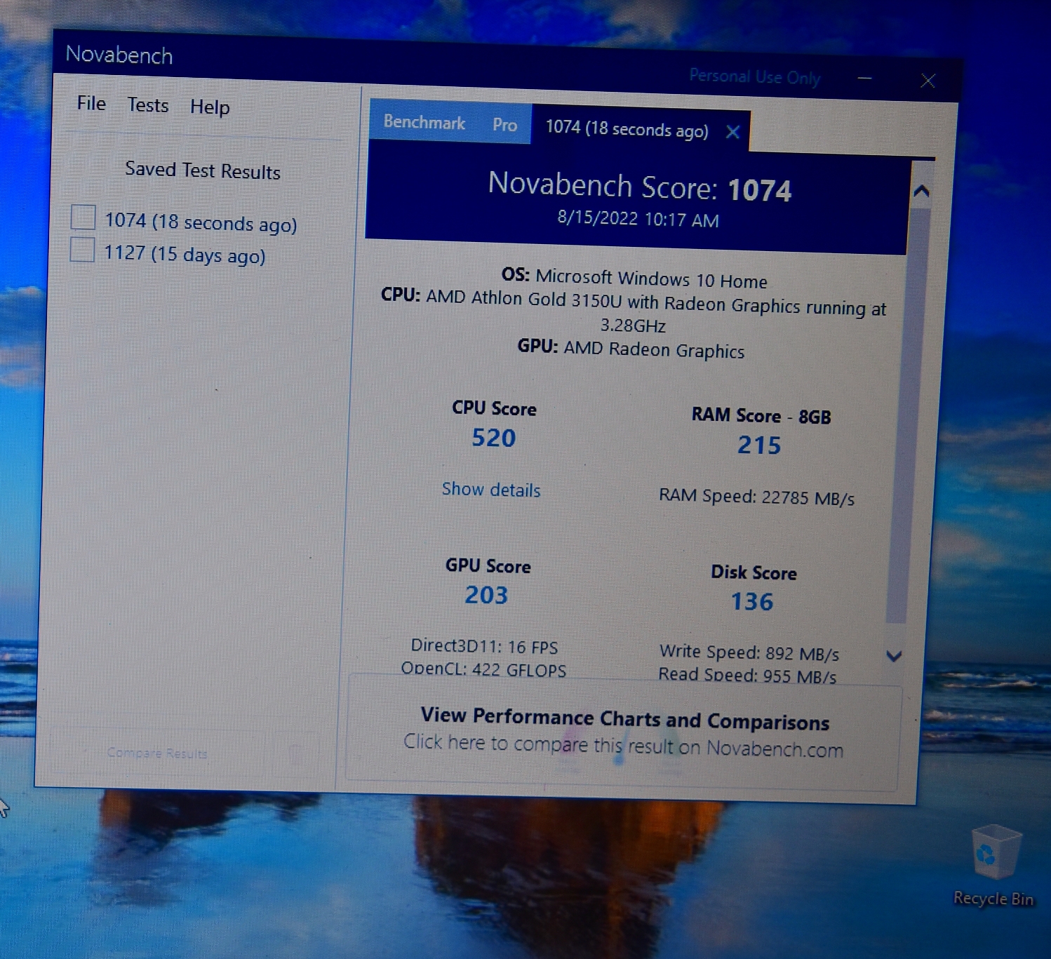

              Now Lets throw some modern Laptops into the mix:
              Entry Level:
              CPU: AMD Athlon Gold 3150U
              RAM: 8GB DDR4-3200
              Boot Drive: Samsung PM991a 256GB NVMe SSD
              GPU: Integrated Radeon
              OS: Windows 10 Home.
              (even the ~$250 MSRP entry-level laptop blows the Socket 775 system out of the water on everything but GPU)
              Mid Level:
              CPU: Intel I5-1135G7
              RAM: 8GB DDR4-3200
              Boot Drive: Hynix PC711 512GB NVMe SSD
              GPU: Integrated Intel Iris
              OS: Windows 11 Home.
              Entry Level Gaming:
              CPU: AMD Ryzen 5 5600H
              RAM: 16GB DDR4-3200
              Boot Drive: Crucial P5 Plus 1TB NVMe SSD
              GPU: Nvidia GeForce GTX1650

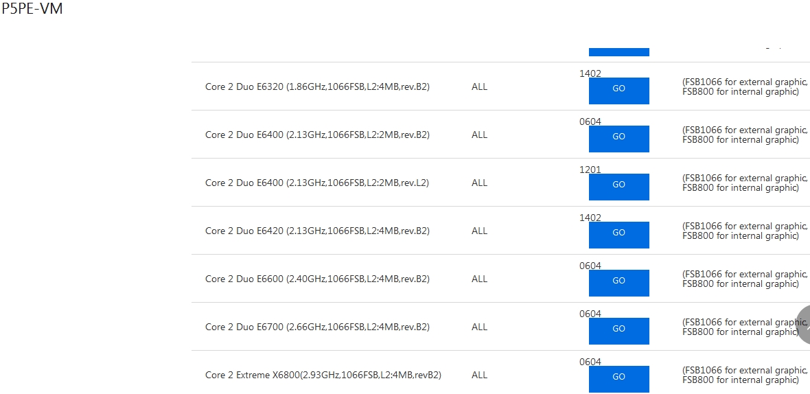

                ok... helped u look it up and do your homework for u. it can support up to the e6k series of 1066 fsb c2d chips but u probably need to do a bios update to the latest version first with the p4 first then u can switch over to the c2d u want. however, there is a caveat with using the 1066 fsb cpus. u have to use a discrete video card to run the fsb at 1066 mhz. if u use the onboard igpu, the fsb has to run at 800 mhz and this downclocks the cpu and cripples it somewhat.
                so go for it, the audigy 2 zs is also the best sound card that works on win98 so u'll have a blazing fast c2d agp win98 system even tho only one core will work. win98 is a single threaded os and cant recognise the two cores or hyperthreading p4 cpus, only one.
