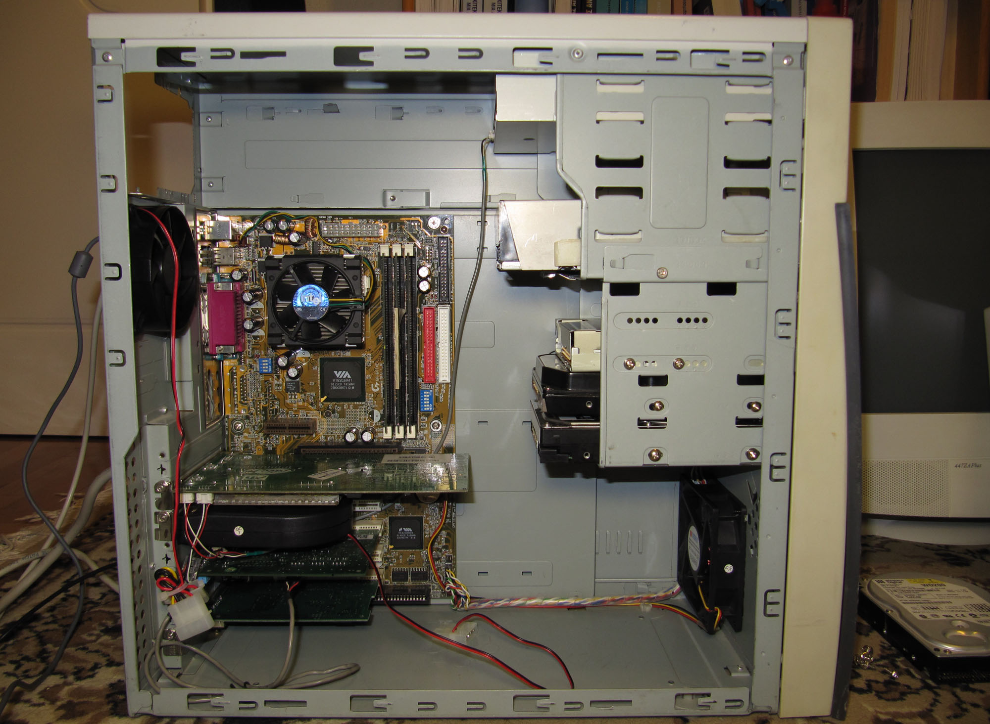

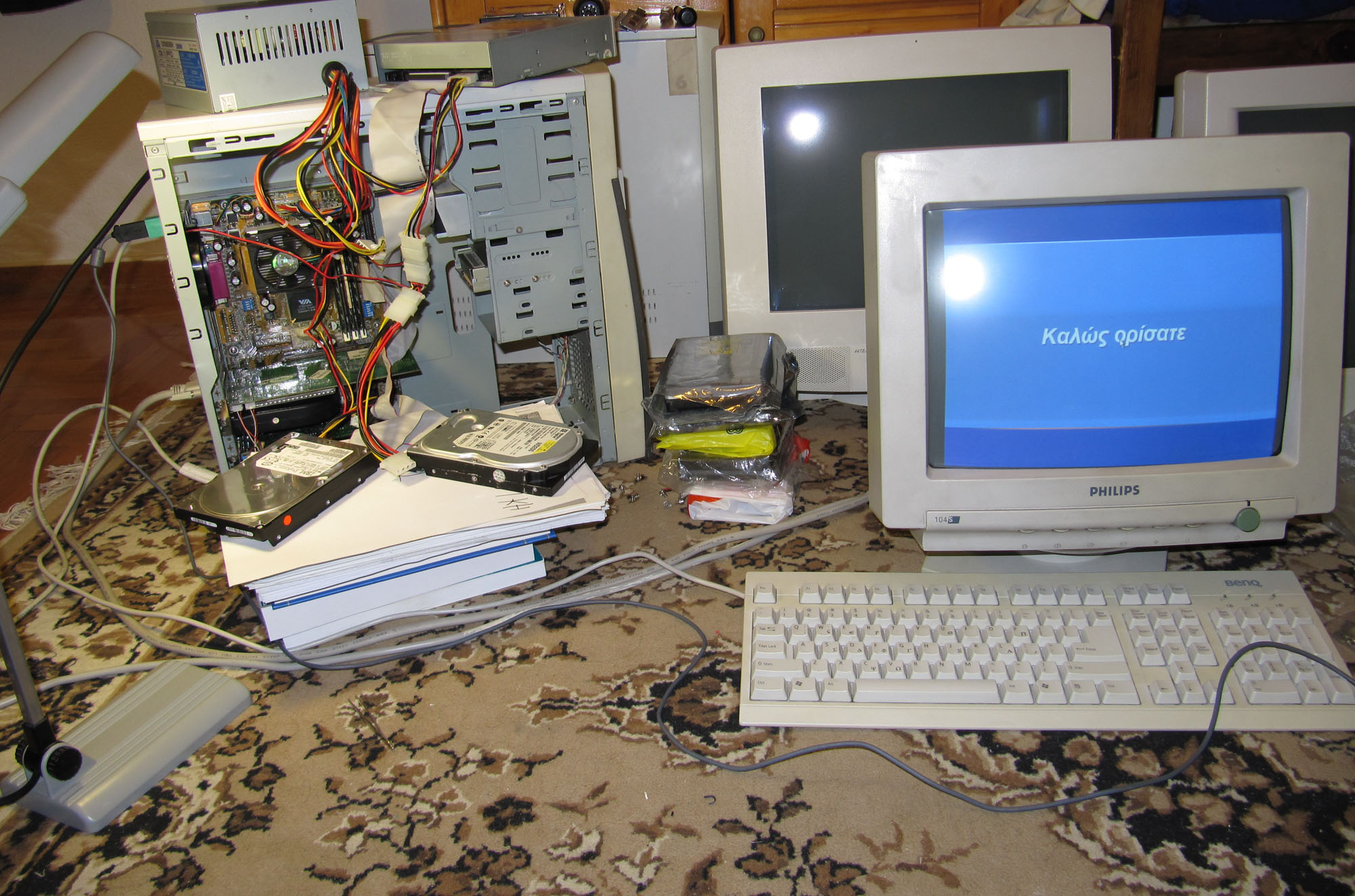

                                I have an Intel Pentium 3 Celeron Tualatin 1300MHZ @ 1456MHZ, 3xSDRAM 112MHZ 640MB, ATI All In Wonder Rage 128 Pro AGP, 2xHDD IDE 7200 20GB WD & 5400 40GB Samsung, BTC DVD ROM & Yamaha CD RW, lan PCI card and Soundblaster 128 PCI running windows XP service pack 3.
                                I use it mainly for TV and testing computer parts that I get for free.
                                It can be used for surfing the web too, only drawback is it can't play youtube videos without dropping frames..
                                I attach some photos I took of it 9 months ago.
