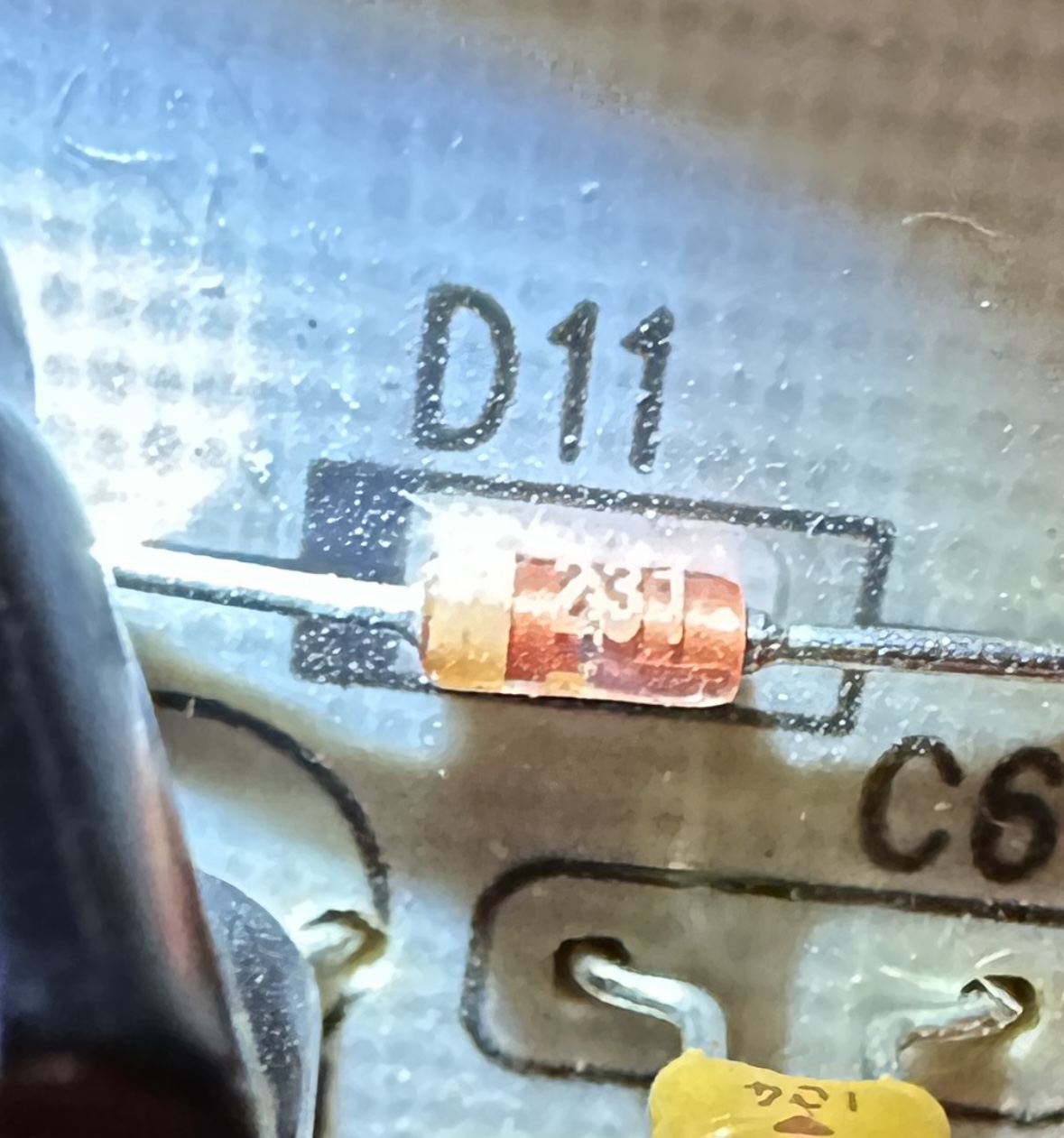

    This diode is mounted on a Frigidaire electronic oven control PN:316131600. This diode runs hot enough that the PCB is showing slight burn marks (black soot looking area on PCB above the diode). It looks to me to be coming from the body of the diode.
    The oven control is 22 years old and still works, but I can't get a new replacement, so I'm doing preventative maintenance and replacing a few parts on it that I think could fail - and this is one of them.
    Can any of you identify this diode (see pic) and suggest a replacement that can handle more heat - or if not, can you identify this one and tell me what to order to replace it? There is no other writing on it other than "231." It is actually very small - I zoomed in on it quite a bit.

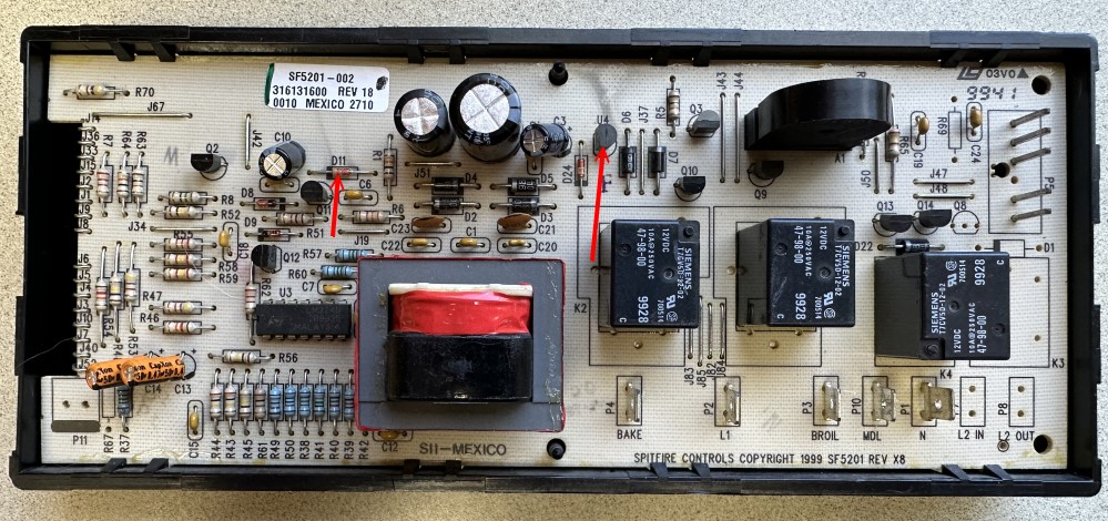

    it may be getting hot because of another part - show the full board

      Re: Need Help Identifying This DIODE
      5.1v zener ..measure voltage across it to confirm

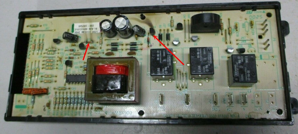

        stj: Thanks for the suggestion! There are many of this model of oven control board for sale on eBay. All of them show this diode and a TO-92 size "78L08" IC appear to run hot and cause "scorch" marks on the PCB. Mine is has fainter scorch marks, but these marks are there only at these two component locations. I don't think my oven control has a bad part (yet). It still works fine. I'm trying to prevent it failing if possible by replacing these two parts that appear to run hot. I ordered the 78L08 IC from Mouser as well as a TO-92 heatsink. What I want now is to get a beefier version of that diode that can handle the heat better - or maybe put two of that diode in parallel so each shares the heat.
        Next is a picture from eBay of one of these same oven control boards. I put two red arrows so you can see where these parts are and you can see what looks like scorch marks above. This one looks like the entire board overheated (notice the coating on the transformer looks like it reflowed). Mine is nowhere near this bad, but it does have fainter marks in the same 2 spots.
        Next is a picture of my oven control board. You can see the same two scorch marks.

            i am not sure of anything but measuring the voltage might make me somewhat sure or not .
              If the zener diode failed, you won't get a voltage, it'd (usually) be shorted.
              If you get a voltage then likely it's still good unless it's open...
                Coming to the same conclusion, 5v1 zener.
                Part # 1N5231B looks to be a match. Onsemi at Digikey is available.

                  Re: Need Help Identifying This DIODE mounted on a Frigidaire oven control PN:31613160
                  I agree it's a 1N5231 zener 1/2W 5.1V
                  They're not scorch marks, it's just soot buildup on the board due to convection air currents around hot running parts, after many years. It would wipe off or a q-tip and IPA can clean the board.
                  The diode is not easy to cool as most of the heat is dissipated through the leads to the PC board. Even putting in a 1W part it would run near the same temperature.
                  For the age, I would replace all the 6 electrolytic capacitors esp. CapXon ones.

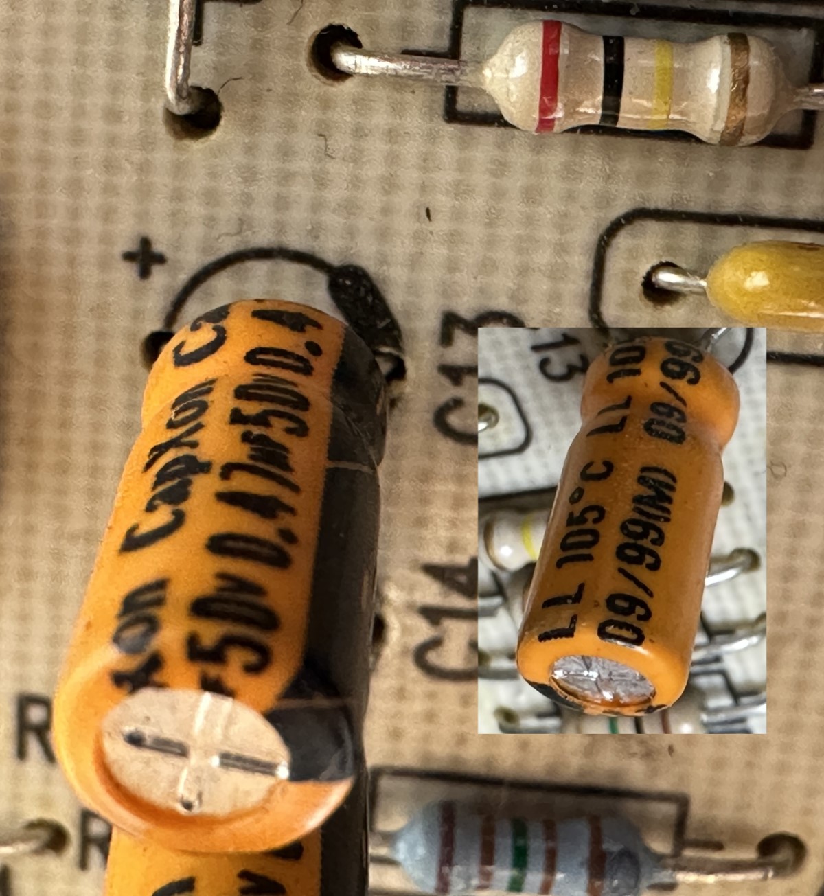

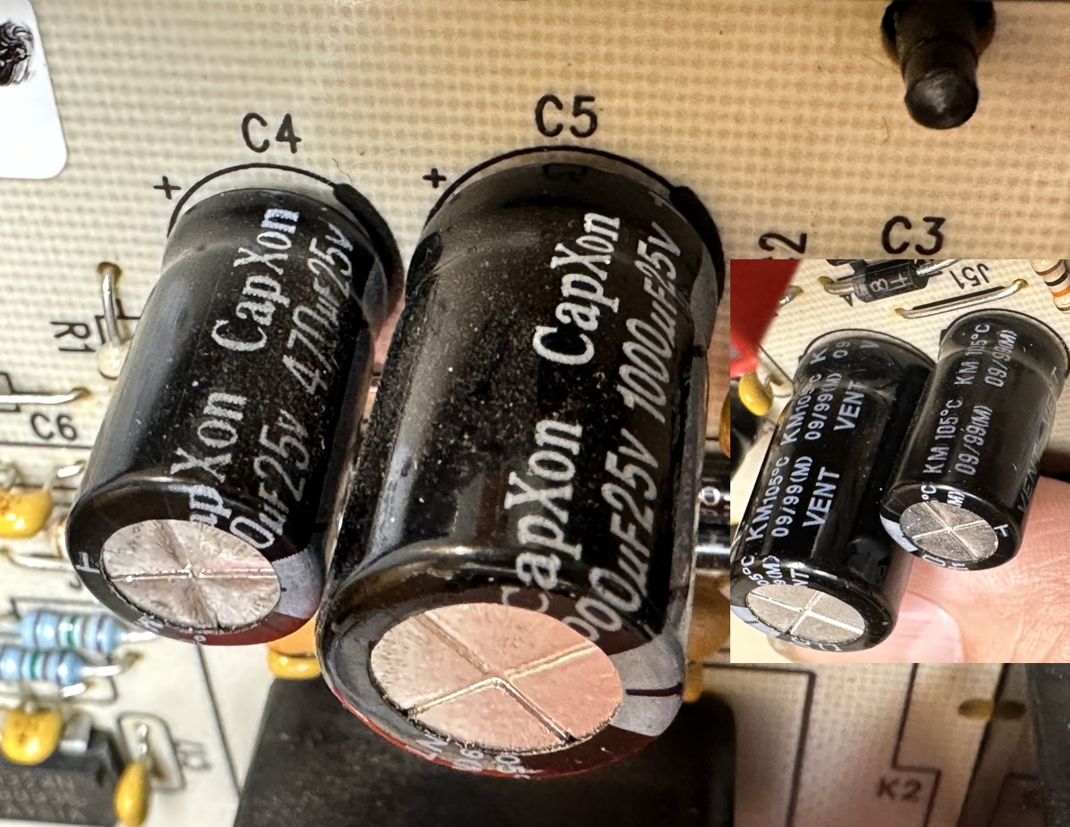

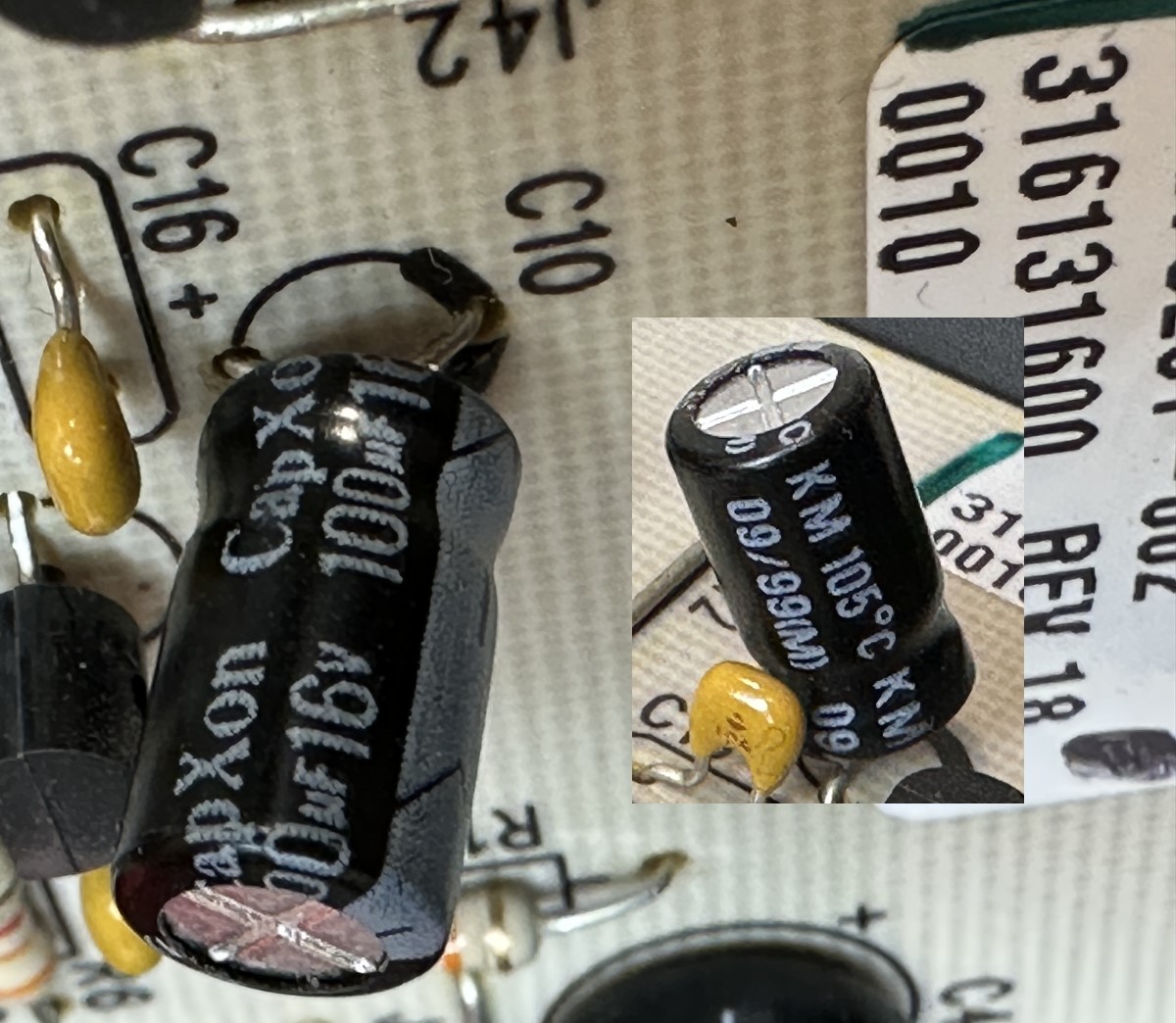

                                Can I get help from one of you in picking replacement caps? I don't know if it's as simple as getting one with the same voltage, temp rating and farad rating as I see choices like "Audio Quality" or "General Use" and the cap details talk about different ripple current ratings - which I don't know anything about.
                                If you can help me find replacements, here's pictures of the caps and last, a picture of the entire board.
                                The first pic shows one cap, but there are two identical ones on the board (side by side).
                                Here's the pic: https://www.dennishunt.com/CAP12.jpg
                                Here's the second pic (there are two identical caps like this): https://www.dennishunt.com/CAP3.jpg
                                In the third pic, I'm show two different caps that are mounted side by side. Here's the fourth pic: https://www.dennishunt.com/CAP56.jpg
                                Last, here's the entire board pic: https://www.dennishunt.com/BOARD.jpg
                                Thanks!
                                  0.47uf is obsolete,
                                  i would use a 470nF 63v polyester/polypropylene film cap
                                  the larger caps, i would use panasonic FR series.
                                  if you can get them cheaper then rubycon ZL are also good quality

                                      C3 and C10 are identical, and are 100uf, 16V, 105 degrees C, about 1/4" dia.
                                      C4 is 470uf, 25V, 105 degrees C, about 3/8" dia.
                                      C5 is 1,000uf, 25V, 105 degrees C, about 1/2" dia.
                                      C13 and C14 are identical, and are 0.47uf, 50V, 105 degrees C, about 3/16" dia.
