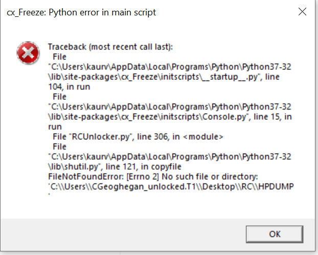

                    Re: RCUnlocker
                    Anyone point me in the right direction to fixing this error please.
                    i am dragging and dropping the .bin to the exe.

                      Re: RCUnlocker
                      Is your file name HPDUMP?

                        #371
                        Re: RCUnlocker
                        Yes it is mate

                          #372
                          Re: RCUnlocker
                          So it's not *.bin file if you have not added the extension.

                            #373
                            Re: RCUnlocker
                            It is a bin file windows saves it as a bin. i also tried to add the bin so it was HPDUMP.bin but still the same error

                              #374
                              Re: RCUnlocker
                              Your computer username has a dot in it aswell. Might be because of that. Move the file to some non-user folder.

                                #375
                                Re: RCUnlocker
                                tried it on a fresh pc new win 10 install same error dont understand why

                                  Re: RCUnlocker
                                  The bios could be corrupt.Post your backup

                                    #377
                                    Re: RCUnlocker
                                    I have 1000s off locked hp none off them work am dumping the 16mb chip also tried a few 32mb chips gives same error.
                                    here is one of the dumps.
