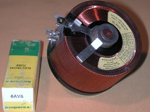

                                  Re: Vacuum Cleaner Speed Controller issues...
                                  i have the solution ....[/IMG]
                                  Nah, all you gotta do is rip that Confuser out and put on of these in its place.
                                  As a bonus you also get a 10v overclock setting for those high-pile carpets!
                                  Follow the white rabbit.
