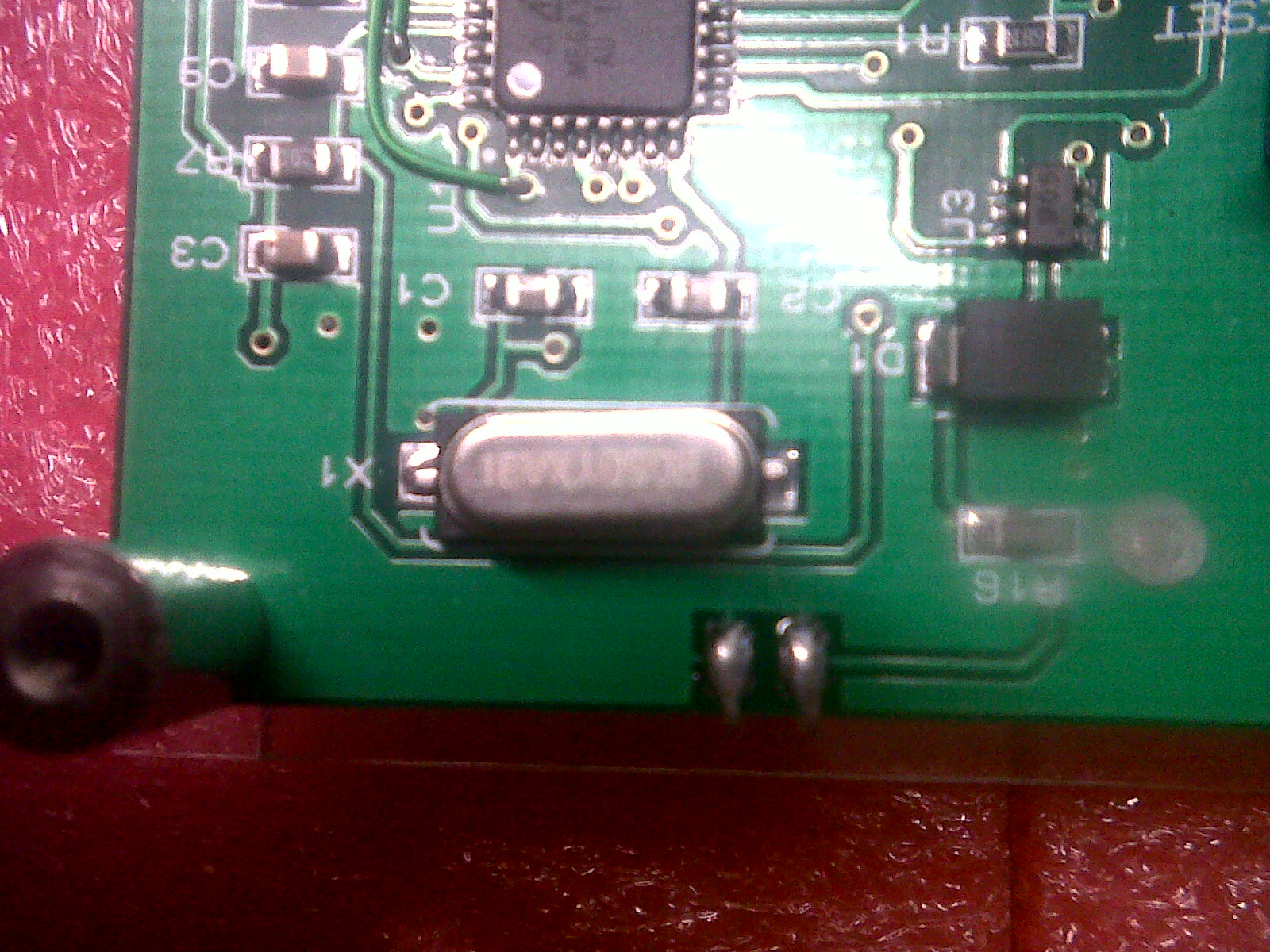

                                        i got my 16MHz xtal fitted - works great.
                                        it even i.d.'d the original crystal i took off as 8000KHz
                                        i also upgraded my voltage reference from a TL431 (1% drift) to an LM4040A (0.1% drift)
                                        **one thing you cant see in the foto - i had to cut the top pin off the LM4040A to isolate it from the board.
                                        where can you order from with free delivery?
                                        btw, about the small cap thing.
                                        i'v seen a guy on a different forum fit the cap under the socket through a reed-relay.
                                        i'm looking into that.
                                        he switches it with a switch though - i'd rather use a spare pin on the Atmel.
