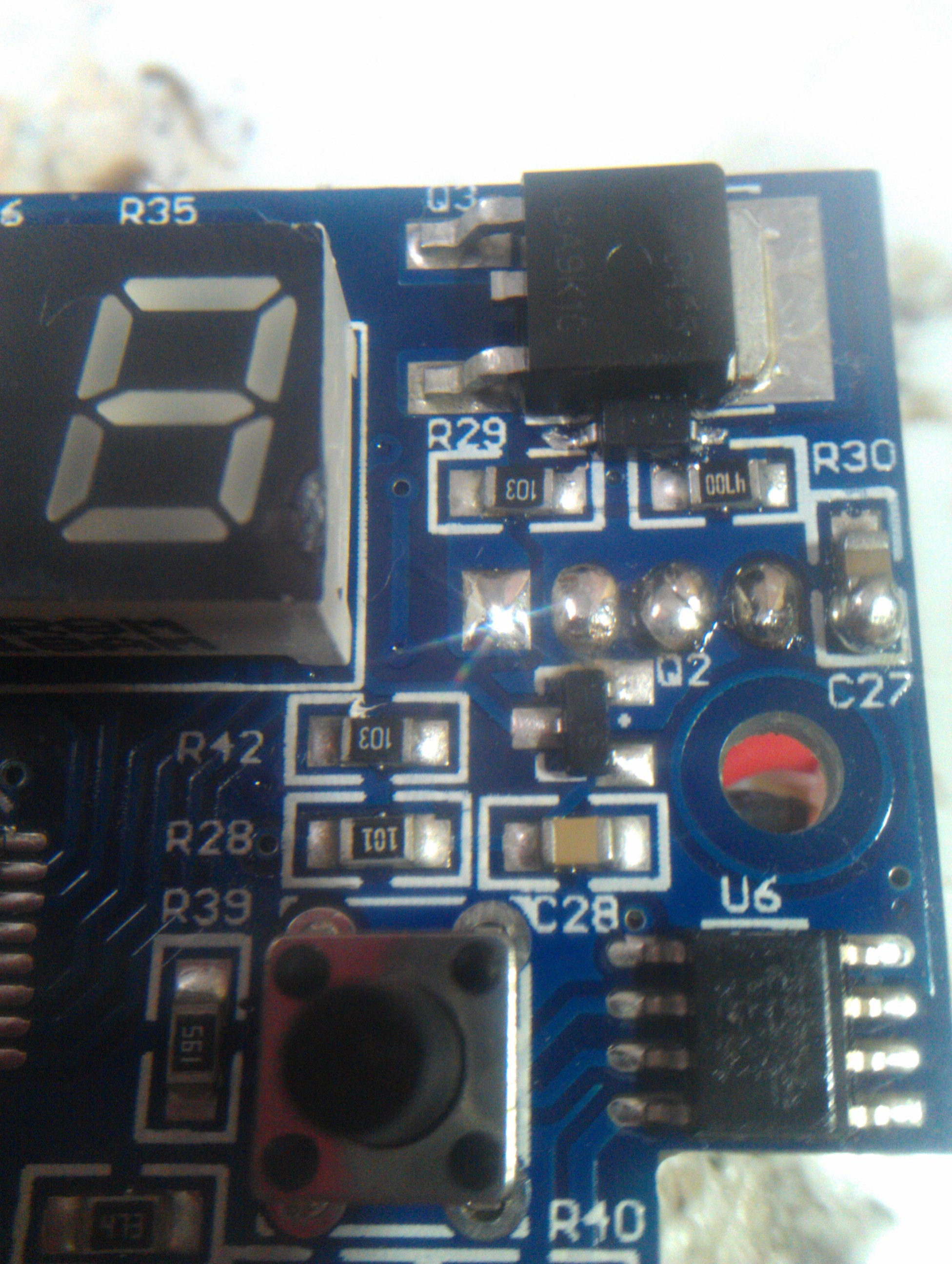

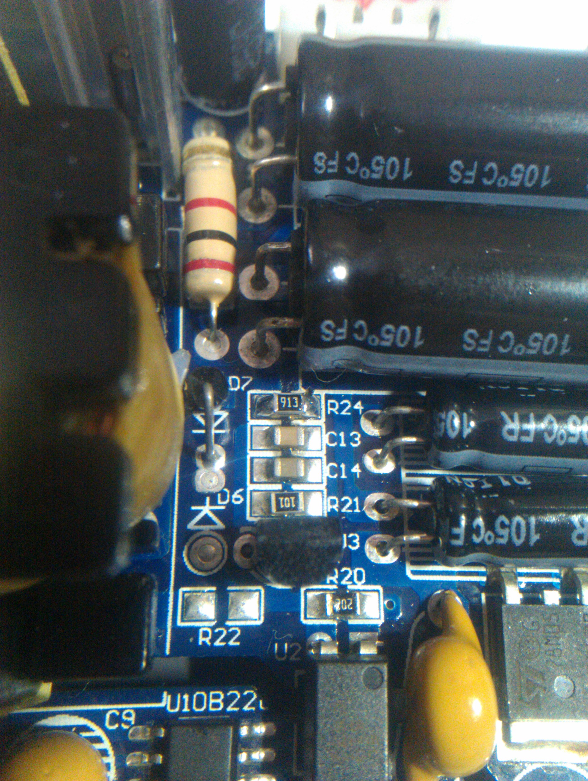

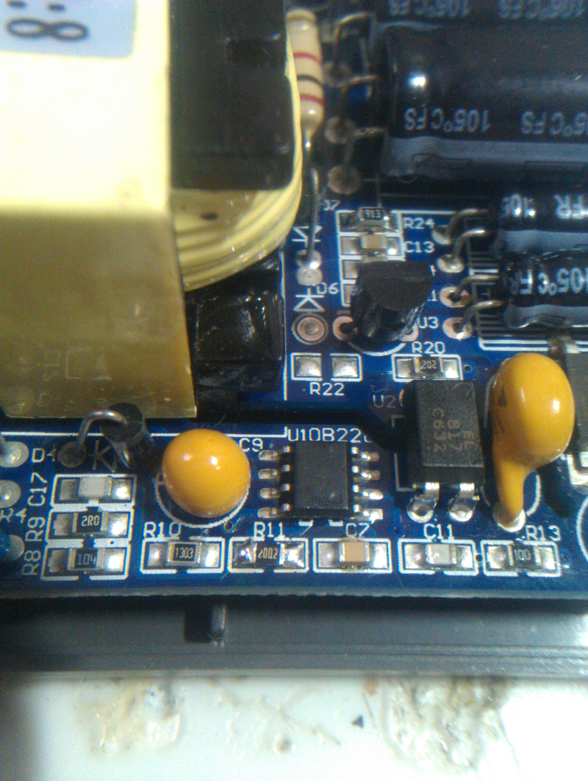

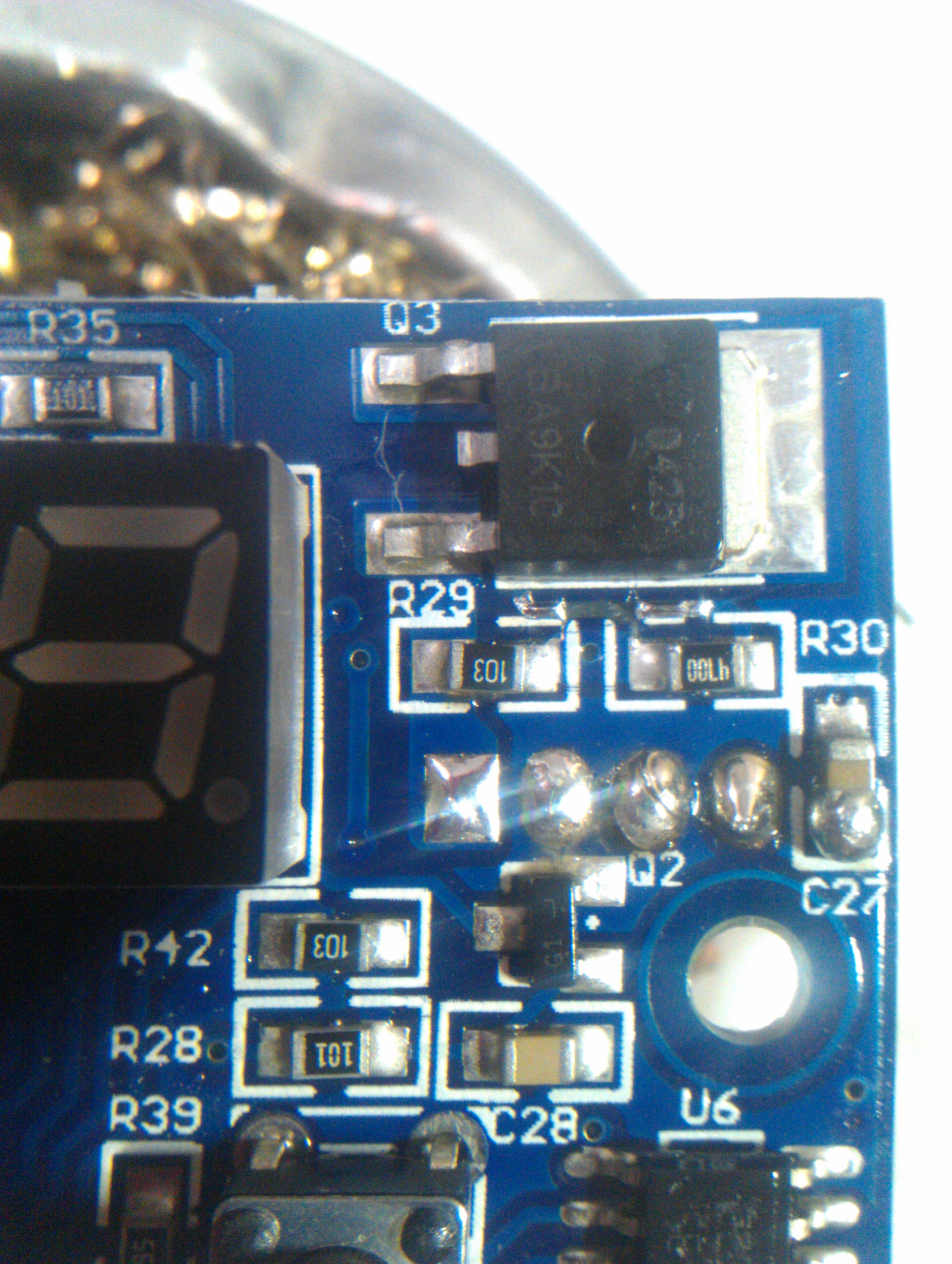

Re: Bakon 950D "Extra Crispy" mod (19->24 Volt)
That's all? is this enough to reach 24V?
Bakon 950D "Extra Crispy" mod (19->24 Volt)
Re: Bakon 950D "Extra Crispy" mod (19->24 Volt)
6 pads, 6wires used to program the AVR controller.
Leave a comment:
Re: Bakon 950D "Extra Crispy" mod (19->24 Volt)
Did this mod today with my Yaxun YX-8034, it looked identical to the bakon 950d inside except the yaxun one has a way simpler power supply, no OVP, just had to put a 10~k resistor in parallel with another resistor close to a SOT-23 package no-name component (can't find the part number anywhere on the internet), which was connected to the optocoupler on the output side to get the PSU up to 24v.
After that i just did the 5v1 zener diode modification to the controller board since this one *is* identical to the one on the bakon 950d
Working perfectly after recalibration!
Might put a little fan inside to keep it cool since i can feel it get warm from the outside, and also might mod it to turn off/go in standby when in the stand later on, since the controller board has an atmega8 that might be easy to program
Also noticed the controller board has a row 6 unpopulated through hole pads, considering one of the pins on it is connected to one of the buttons (can't see where the other tracks go), i'd assume it's made to be fitted with a rotary encoder, the case has a hole in there and everything right in front and above the pads so a module could fit in perfectly, might look into that.Leave a comment:
Re: Bakon 950D "Extra Crispy" mod (19->24 Volt)
Yep, the full bridge rectifier is kaputLeave a comment:
Re: Bakon 950D "Extra Crispy" mod (19->24 Volt)
120V and yes, but sadly the PSU is now dead lol.
They miswired the hot and neutral on the plug, so the switch was only cutting off the neutral.. I had it plugged in while working on it (to ground the tip), the controller was powered by another PSU and was planning to try replacing R10 with 100k but then I touched it and it shorted it to ground and it took some traces and D4 with it, I tried to bodge wire the missing tracks but no go, it's blowing the fuse now and there's a short somewhere.
Maybe the rectifier bridge is toasted? I'm now just tempted to use an external PSU and call it a day lol or maybe buy an off the shelf open frame 24V PSU, but it's not economically sound, may as well upgrade to an STM32 OLED T12 station instead hahLeave a comment:
Re: Bakon 950D "Extra Crispy" mod (19->24 Volt)
whats your mains voltage?
and about that buck convertor, did you but the track for the pot and bridge the pads for 5v?Leave a comment:
Re: Bakon 950D "Extra Crispy" mod (19->24 Volt)
Just to lower the overall heat inside the enclosure lolDon't do that again. The 78xx series have been around longer than I've been, and they're super stable and super reliable. There's gotta be a reason why they're still in active production.
Everything else looks good, but you had no business messing with that linear regulator. It does the job it was intended to, no issues.
I'm running into the problem where it shuts off after a while and I have to wait for the capacitor to discharge before I can turn it back on, is that the OVP kicking in? Should I try to lower R11? Or an issue with the optocoupler? It might have done that even before I did the 23V mod.
I have been powering the iron/controller board with an external 24V supply and it works fine (with the same MP2315 buck converter).
I've swapped the TL431, put in a Y cap and the 35V capacitors so far lolLeave a comment:
Re: Bakon 950D "Extra Crispy" mod (19->24 Volt)
Don't do that again. The 78xx series have been around longer than I've been, and they're super stable and super reliable. There's gotta be a reason why they're still in active production.
Everything else looks good, but you had no business messing with that linear regulator. It does the job it was intended to, no issues.Leave a comment:
Re: Bakon 950D "Extra Crispy" mod (19->24 Volt)
It's what was feeding the 7805, at least according to the schematic.
The MP2315 appears to be a good modern IC, went into protection mode at 40V and died at 45V, so there's plenty headroom haha
https://www.youtube.com/watch?v=4iAgaBzpOCE&t=230sLast edited by Daijoubu; 10-17-2022, 11:30 AM.Leave a comment:
Re: Bakon 950D "Extra Crispy" mod (19->24 Volt)
why touch r26 or d7??
good luck with the buck convertor if it's max input is 24v - it may last but who knows.Leave a comment:
Re: Bakon 950D "Extra Crispy" mod (19->24 Volt)
I swapped the 7805 for a switcher, it's an OSKJ board based on the MP2315 (max 24V lol)
The caps I have are Rubycon ZLH 25V, hope they don't blow up, I'm gonna order the FS-A eeufs1v102L as spares
I had some 20k 0805 SMD resistors so I used those
R11 swapped for 20k
R24 20k parallel (found out I had some 362 afterwards, oh well)
Measured 23V output.
To fit the board underneath, I had to trim out the bottom wall mounting keyhole flush
Converter have 20uF on both input and output, so I just added back the 22uF on the output (notice the orientation C16 + and C15 -)
Ripped off a trace, the Weller I borrowed wasn't such a joy to use lol
Trace have been cut
As for the R26 2ohm resistor, can it be removed or not? How about the D7?Last edited by Daijoubu; 10-17-2022, 09:47 AM.Leave a comment:
Re: Bakon 950D "Extra Crispy" mod (19->24 Volt)
the 7805 is fine, you dont need to upgrade the y-class either.
all i remember doing was the 2 resistors and the electrolytics + the zener on the other board.Leave a comment:
Re: Bakon 950D "Extra Crispy" mod (19->24 Volt)
First thing I did was to replace the caps, I had some spare ones from previous recapping job, wasn't planning on getting SMD resistors, I just placed 2 orders with Digikey but your mod looks so neat haha that I may end up spending another $100 for free shipping, could use some extra PSUs...wife is going to kill meso,
R11 - 27k(OVP) change to 20k 0805
R24 - 4.42k(voltage reference) change to 3.4k 0805
i'v been running 24v for several years and not damaged the optocoupler
the caps you need are panasonic eeufs1v102L
you need a 5v1 zener diode on the control board,
here is a couple of photo's - with a track cut and then bridged by the diode
What should I be looking for the Y class cap?
What about the 7805? Have you done anything to it?
I think i'm gonna swap it for a small switcher and get rid of the R26 2R and VD7 zener diodeLast edited by Daijoubu; 10-13-2022, 05:48 PM.Leave a comment:
Re: Bakon 950D "Extra Crispy" mod (19->24 Volt)
the tant was factory.
i upgraded the Y class on the right.Leave a comment:
Re: Bakon 950D "Extra Crispy" mod (19->24 Volt)
I see upgrades to Panasonic FR/FS but what's with the tantalum lolLeave a comment:
Re: Bakon 950D "Extra Crispy" mod (19->24 Volt)
so,
R11 - 27k(OVP) change to 20k 0805
R24 - 4.42k(voltage reference) change to 3.4k 0805
i'v been running 24v for several years and not damaged the optocoupler
the caps you need are panasonic eeufs1v102L
you need a 5v1 zener diode on the control board,
here is a couple of photo's - with a track cut and then bridged by the diodeLeave a comment:
Re: Bakon 950D "Extra Crispy" mod (19->24 Volt)
Dead thread revival, plan on doing this mod myself
R11, either replace with 20k or put 100k in parallel (21.25k)
R24, going to put 20k in parallel to get 3.6k ~23V/62W output
The 2.7 (2-3ohm) is for the R1 shunt, to reduce it down to 0.2-0.24V
Someone said to also swap R19 to 1k as to not kill the LED inside the TL431 optocoupler
Use Google Translate and look at the comments below
https://mysku.club/blog/china-stores/40868.html
https://mysku.club/blog/discounts/44292.htmlLeave a comment:
Re: Bakon 950D "Extra Crispy" mod (19->24 Volt)
Old thread, I know, but one can always hope for a reply
I plan to make this change: I really like my 950D, but it's a bit anemic for some of the soldering I do, and I'm forced to keep cranking up the temperature, which is a bad idea
I live in the USA, so 110V mains here. Which one is the current limiting resistor, and what values should I try to use?Leave a comment:
by tmks2I have a problem with the Bakon 950d soldering station. It worked for many years without a problem, now it warms up to the set temperature and displays the error S - E. I noticed that the MOSFET AOD425 reaches a very high temperature. Where could be the problem?...
This specification for the Lenovo ThinkPad T16 + Extra 8GB memory Notebook can be useful for upgrading or repairing a laptop that is not working. As a community we are working through our specifications to add valuable data like the T16 + Extra 8GB memory boardview and T16 + Extra 8GB memory schematic. Our users have donated over 1 million documents which are being added to the site. This page will be updated soon with additional information. Alternatively you can request additional help from our users directly on the relevant badcaps forum. Please note that we offer no warranties that any specification,...09-07-2024, 06:21 AM
This specification for the Lenovo ThinkPad T16 + Extra 8GB memory Notebook can be useful for upgrading or repairing a laptop that is not working. As a community we are working through our specifications to add valuable data like the T16 + Extra 8GB memory boardview and T16 + Extra 8GB memory schematic. Our users have donated over 1 million documents which are being added to the site. This page will be updated soon with additional information. Alternatively you can request additional help from our users directly on the relevant badcaps forum. Please note that we offer no warranties that any specification,...09-07-2024, 06:21 AM
This specification for the Acer Chromebook Acer Chromebook Spin 713 CP713-3W - (Intel Core i3-1115G4, 8GB, 256GB SSD, 13.5 inch QHD 3:2 Touchscreen Display, Google Chrome OS, Iron) Chromebook can be useful for upgrading or repairing a laptop that is not working. As a community we are working through our specifications to add valuable data like the Acer Chromebook Spin 713 CP713-3W - (Intel Core i3-1115G4, 8GB, 256GB SSD, 13.5 inch QHD 3:2 Touchscreen Display, Google Chrome OS, Iron) boardview and Acer Chromebook Spin 713 CP713-3W - (Intel Core i3-1115G4, 8GB, 256GB SSD, 13.5 inch QHD 3:2 Touchscreen...09-07-2024, 03:10 AM
This specification for the Acer Chromebook Acer Chromebook 514 CB514-1W - (Intel Core i3-1115G4, 8GB, 128GB SSD, 14 inch Full HD Display, Google Chrome OS, Iron) Chromebook can be useful for upgrading or repairing a laptop that is not working. As a community we are working through our specifications to add valuable data like the Acer Chromebook 514 CB514-1W - (Intel Core i3-1115G4, 8GB, 128GB SSD, 14 inch Full HD Display, Google Chrome OS, Iron) boardview and Acer Chromebook 514 CB514-1W - (Intel Core i3-1115G4, 8GB, 128GB SSD, 14 inch Full HD Display, Google Chrome OS, Iron) schematic. Our users...09-07-2024, 01:30 AM
- Loading...
- No more items.
Leave a comment:
