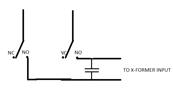

      Re: DPS5020 dual power supply build
      Oh right, forgot about the power switches. I should place an X cap across them like I've seen in other devices which use a physical switch to switch transformers (see audio amps).
      So I should keep the resistor/cap idea after all.
          Yes, I believe on just about every device I've seen so far around here that uses a mechanical switch for the mains it's going to be a DPDT to "cut" both wires going to the plug. Makes perfect sense, since you want to isolate BOTH wires. The plugs are not polarized so L and N can be flipped around at the luck of the draw - you have a 50% chance of inserting the L into the N when plugging the cord in
          Would THIS be a good way to connect the X-cap ? Or should it go across the switch and not the load ? In that case, I imagine I'd need two: one for each set of contacts. I also have no idea what value it should have - I'll probably just trash-pick one from a drill or some SMPS
            I would have a cap across each switch contact. But I am not knowledgeable on the European usual method. I think 10nF is minimum and I use 33-47nF for larger transformers to 1500VA.
            My boss yelled at me - "the {DPST} switch contacts are never identical. One opens first and another closes first". So the power off arc could occur at either contact.
              your boss was almost right.
              it would be more accurate to say the tolerances are such that you never know which contact will move first.
              the mosfets may be for rectification/reverse protection.

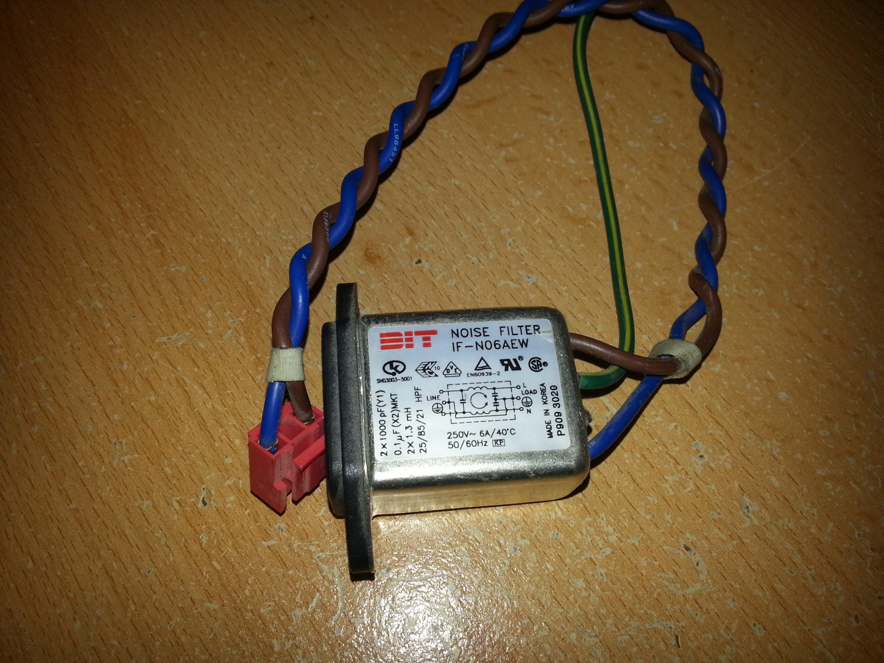

                I swiped THIS from "The Key Master" today when he wasn't looking It's the 230v input filter I was talking about.

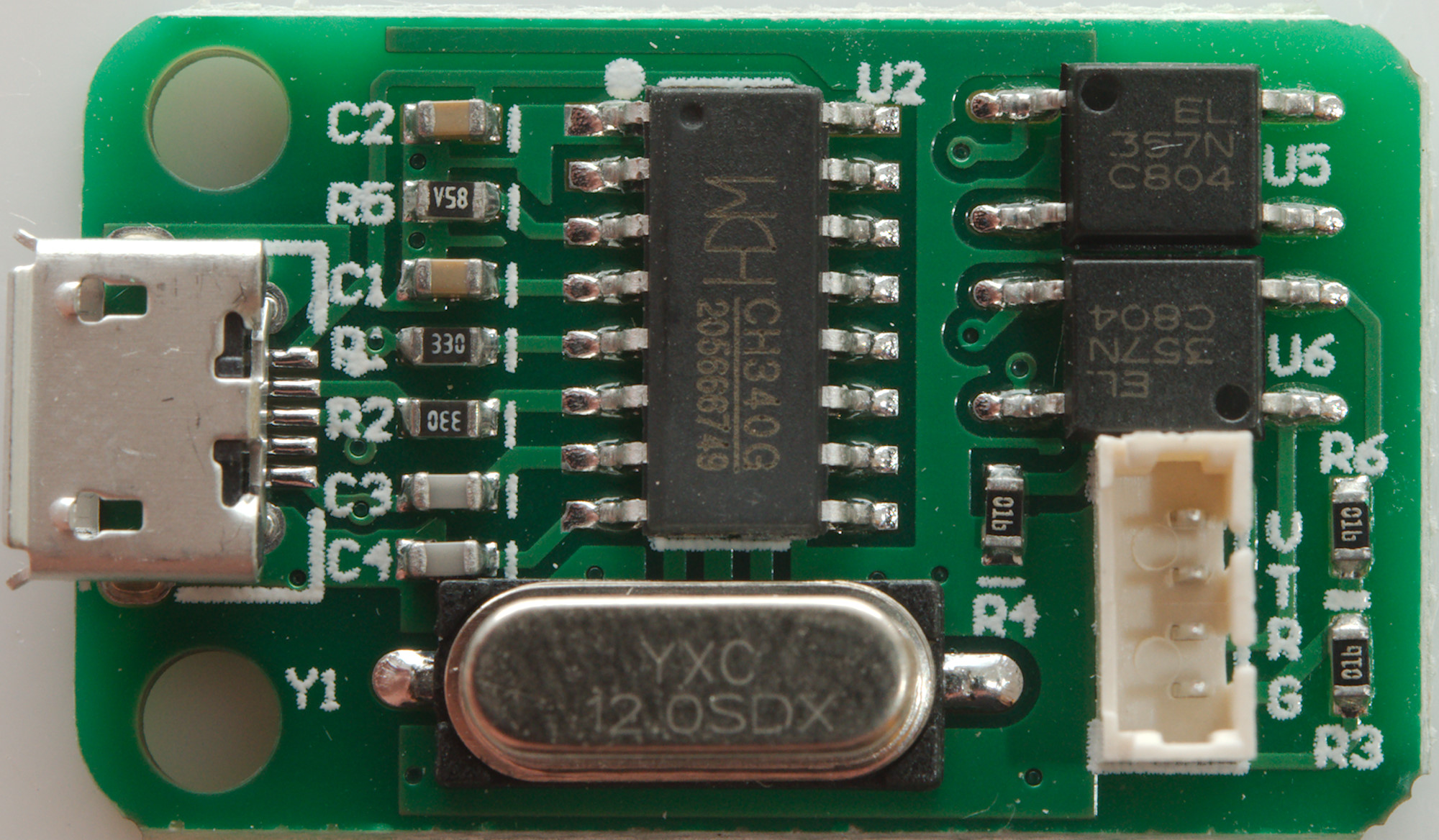

                  Originally posted by stj
                  the interface is a serial>usb adapter with a WinChipHead chipset (a damned good chip)
                  now here is the interesting bit, in the picture it looks like it's already opto-isolated!!!!!
                  Confirmed:
                  CH340 « serial to USB conversion (standard application configuration)
                  EL357N « phototransistor optocouplers (2 pcs: Rx & Tx)

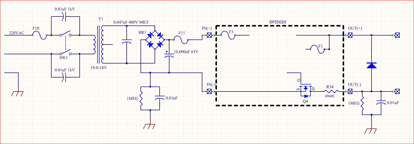

                      My worry is not damaging the DPS module due to the output on/off mosfets. What is weird about the modules is the low-side ground switch they have.
                      Stray capacitance on the power transformer means things can float with noise and hum, so I suggest adding a 10nF and 1MEG to give leakage currents a path to earth ground. If things floated say to 50V it would damage the DPS mosfet when the PSU output was switched off. Output switched off -> (-) floats
                      The DPS5020 has a couple fuses on the PCB. I don't think you need an input fuse - it has F3 on the pcb. F1 I think is for the MCU and display.
                      This is the circuit I might try.
                        Why is the on-board FET a cause for concern here exactly ? The way I understand it is when Q4 in your schematic (which I'll kindly ask you to remind me which software you used to create since I keep asking and keep forgetting ) "opens" (gate goes low) it causes a spike on the input side of the module which can exceed the rated 50v input ?
                        I see TWO sets of resistor+capacitor: one on the input, one on the output. These act as "quenching" devices so to say ?
                        Also I believe there's an error with the symbols for the X caps across the switch, as they're shown as electrolytics
                        Like I said in my original post, I already built a similar unit and I now realise there's a LOT of room for improvement and I'm probably running it improperly there: no arc-suppression on the AC switch, no zener diode across the input terminals of the DPS, no caps on the input and output the way you suggested....I'll probably open it up again and improve it as well, especially since this one is a single transformer setup and don't have to worry about keeping anything separate.
