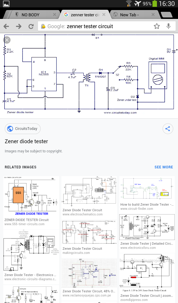

          lotas yes, i removed it already and measured stand alone. Also have tried to inject voltage to check if it is a normal diode or zener diode. But it seems that it is a normal diode because the voltage drop i read versus the voltage supplied is still same even i injected up to 6VDC already.

              I dont know, probably not shuld be any catastrofic risk... but, if you tested your diode out from circuit, and it is good, I suggest you that you put back like it is be.
              If on pcb find only one mark ZD or symbol of zenner on silk screen, that mean that for sure your diode is not zenner. Zenner diode in glass package often have colored ring or two, like yellow, green or so...

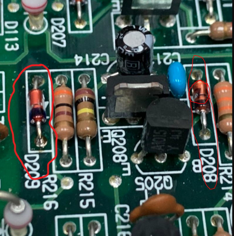

                  • dennis_elx33
                    • May 2019
                    • 32
                    • Malaysia
                    Thank you so much guys!
                    To make things clear, I attached herewith the images of the faulty diode (channel 1) versus the good diode (channel 2).

                      Originally posted by lotas
                      Not all companies designate zener diodes on boards with the symbol Z, ZD.., they can all be designated D (in my opinion, a 7.5v zener diode is designated as D.
                      This is correct. I noticed that a long time ago as well.

                        • harp
                          • Jun 2022
                          • 642
                          • Planet Earth
                          Yes, the diode is faulty. Have you noticed what Lotas pointed out, that on other diode is marking "7.5", so if you check with supply, voltage must be higher than 6v. Normaly zenner tester have about 50v and 1 or 10mA on probes.
                          Check, maybe your faulty diode has marking oriented to pcb side?

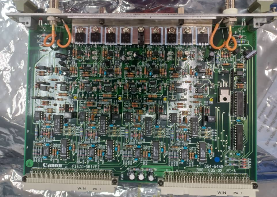

                          • R_J
                            • Jun 2012
                            • 9602
                            Any chance that you could provide the Make and Model ? or what equipment this board is used in?
                            • dennis_elx33
                              • May 2019
                              • 32
                              • Malaysia
                              Hello R_J, attached herewith is the photo of the board.

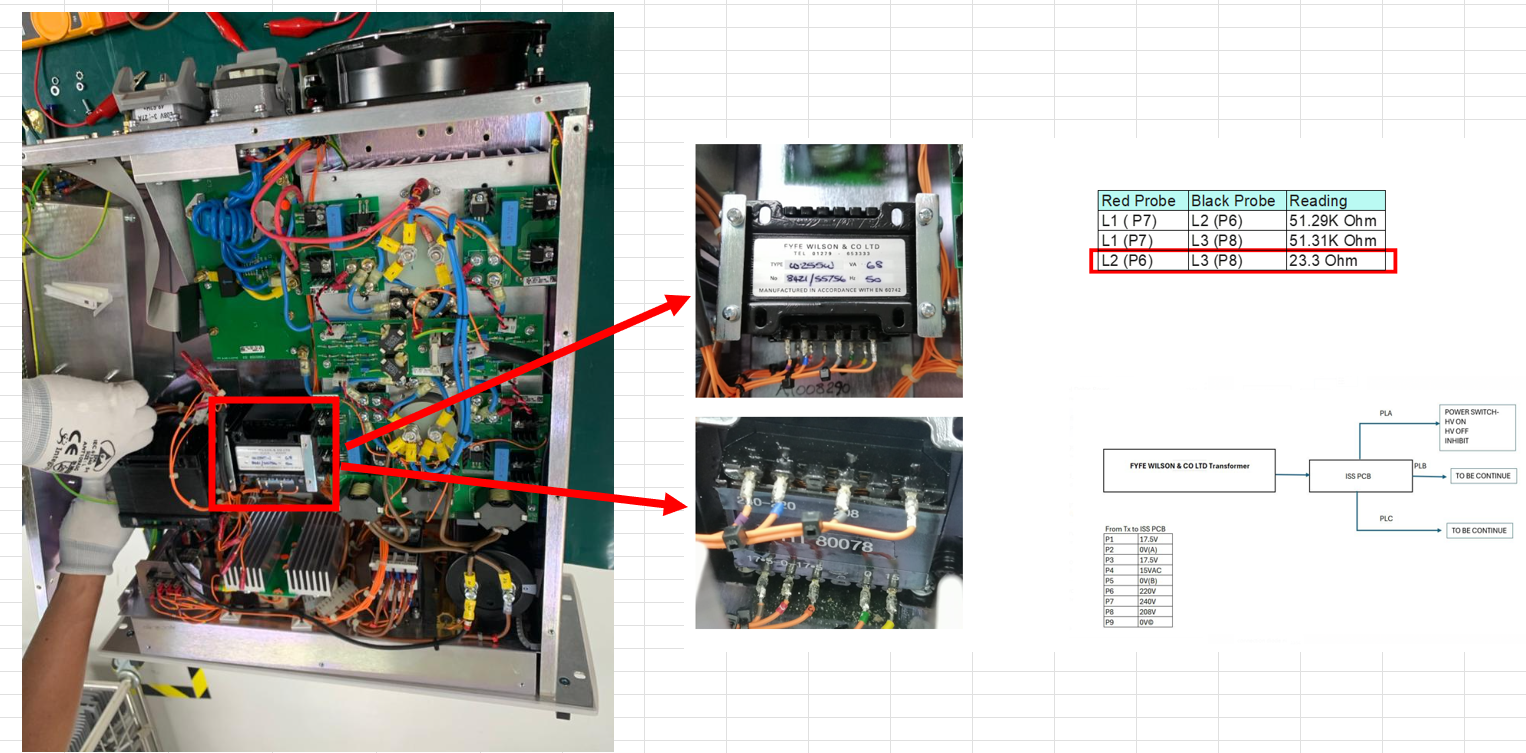

                                Hello All,
                                I was trying to post a new thread but i couldn't find the button for a new thread.
                                Anyway, i would like to post an interesting topic regarding 3-phase stepdown transformer which we suspect to cause an overcurrent (138A) which caused the High voltage power supply to tripped off.
                                Problem statement: Power tripped with inrush current of 138A.
                                Initial findings: low ohm L2 to L3 input voltage (25ohm)
                                Defects: IGBT and Diode shorted
                                Question: is this a normal resistance reading for the transformer at L2 to L3 reading?
                                Red Probe Black Probe Reading
                                L1 ( P7) L2 (P6) 51.29K Ohm
                                L1 (P7) L3 (P8) 51.31K Ohm
                                L2 (P6) L3 (P8) 23.3 Ohm
                                • R_J
                                  • Jun 2012
                                  • 9602
                                  The DC resistance of transformer windings can be low resistance.
                                  It looks like a single tapped primary, so it will be connected across one phase of the three phase likely between L2 and L3, I suspect there is a line voltage select switch somewhere as well to switch between 208, 220, 240 input
                                  one phase should connect to 0 on the transformer and one of the other phases should connect to one of the taps on the primary depending on the a/c voltage of that phase (likely 240 in your country)
                                  Maybe a mod can move this to a new thread for you
