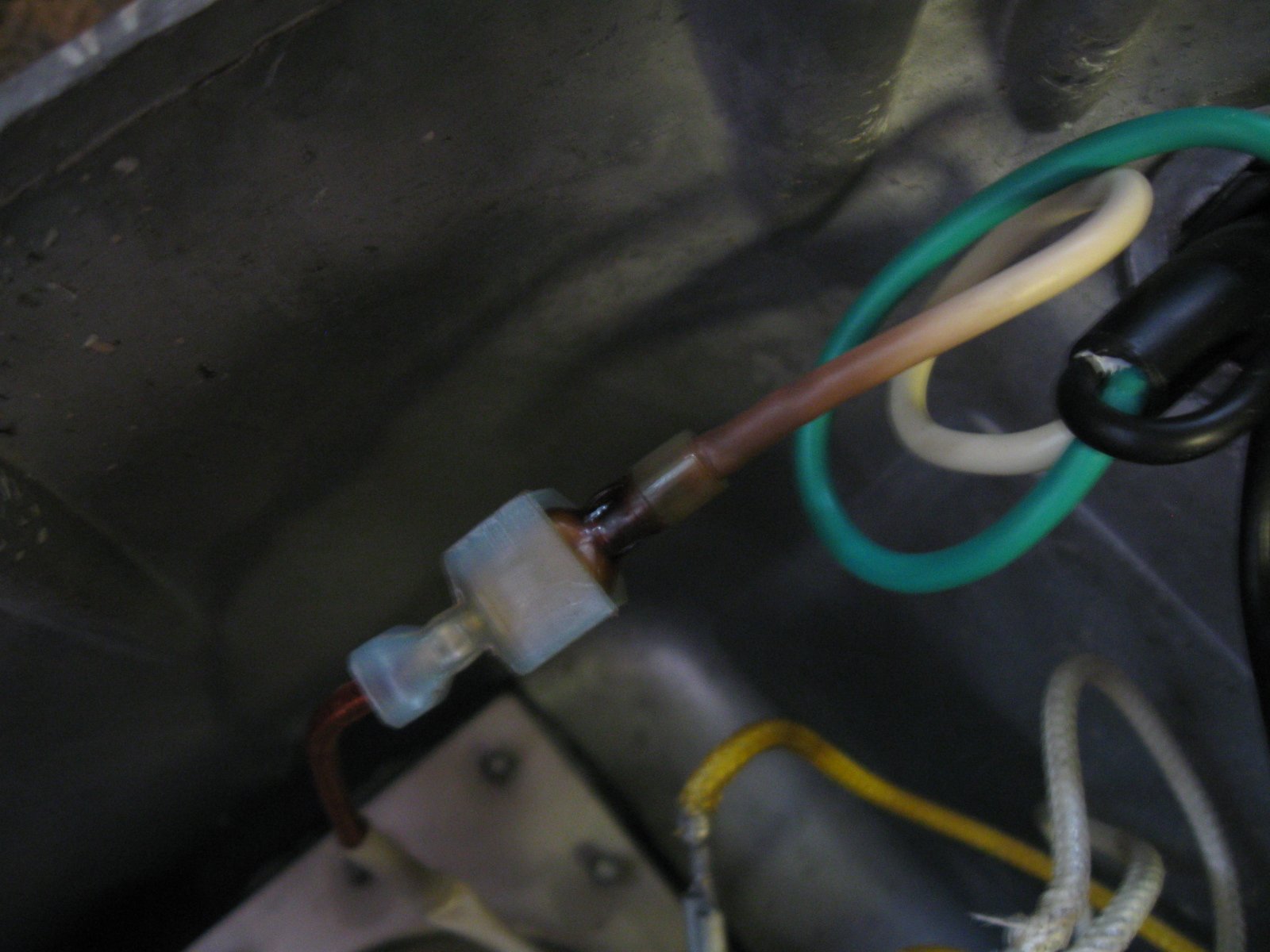

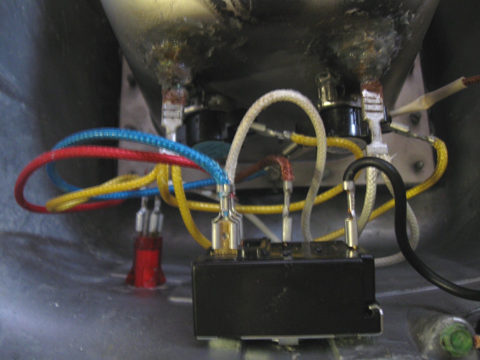

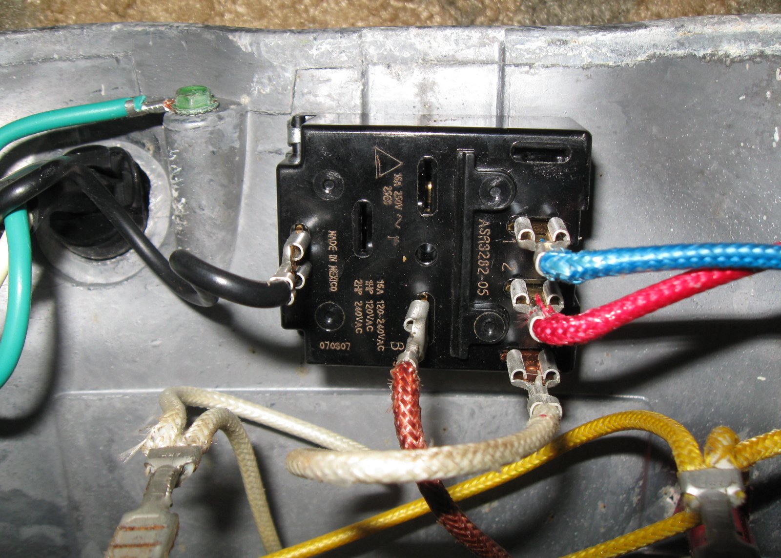

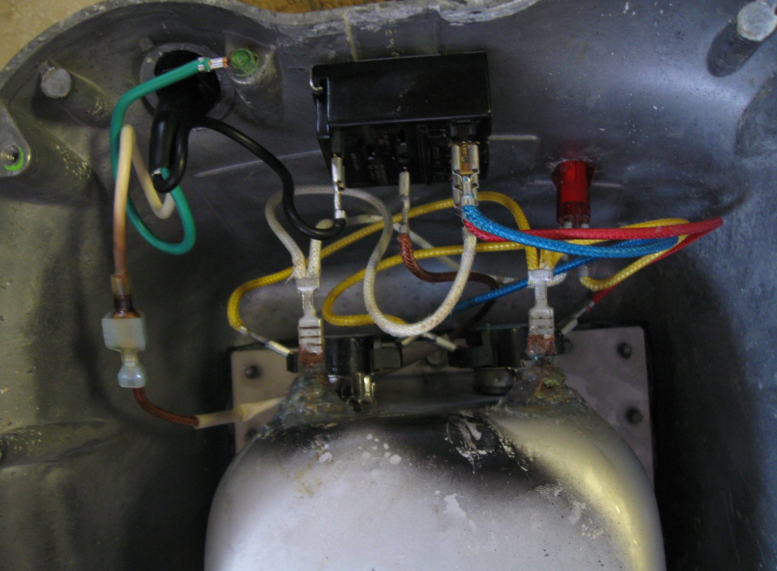

    Need help to pinpoint why my Streamer tripped my outlet.
    I plug it it and bam loud pop followed by tripped breaker.
    Next I reset breaker switch, turn streamer on hear pop and burning but did trip breaker for the 2 sec I left it plug in.

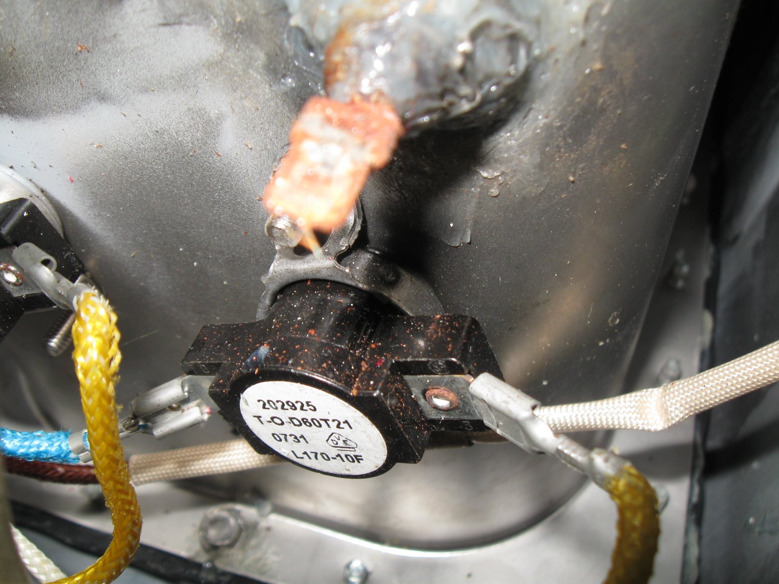

    I have pics, most likely the cause of problem is the heating elements that are leaking and caused the problem.
    Now how Do I go find out if it's only the element issue or some other component failed as well.
    Re: Jiffy Garment Steamer Model J-4000 Tripped power outlet
    Slight update, streamer appears to be working. I remove tank and inspected heating element and get 9.8ohms which is about right for this 1500 W heating element.
    Only problem is it leaks at fitting so time to replace it.
