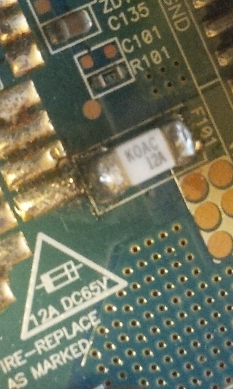

    I need to replace a fuse on a philips lcd inverter board.
    The component in question has KOAC 12A printed on it.
    I found KOA Speer - CCF1N12TTE I think this is the correct part that is on the board, but is this really a 12AMP fuse? Such a high current rating?

    so what blew the fuse?
      Re: Help identify fuse
      Good question.
      There were a lot of blown caps on the power supply board and also two on each inverter board. There could be more problems.
      When it got it there was a blink code and it wouldn't start up. It starts up now after recap, with no blink code but was only illuminating one side. I hadn't checked the fuses before, but noticed the slave side fuse was blown.
      I should order a few, in case it blows again and I have to replace the IC or the fets or both?
      Funny how I never saw that 12A DC65V annotation on the board until I zoomed the pic in.
