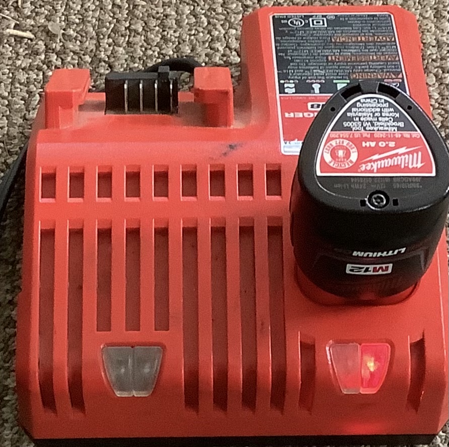

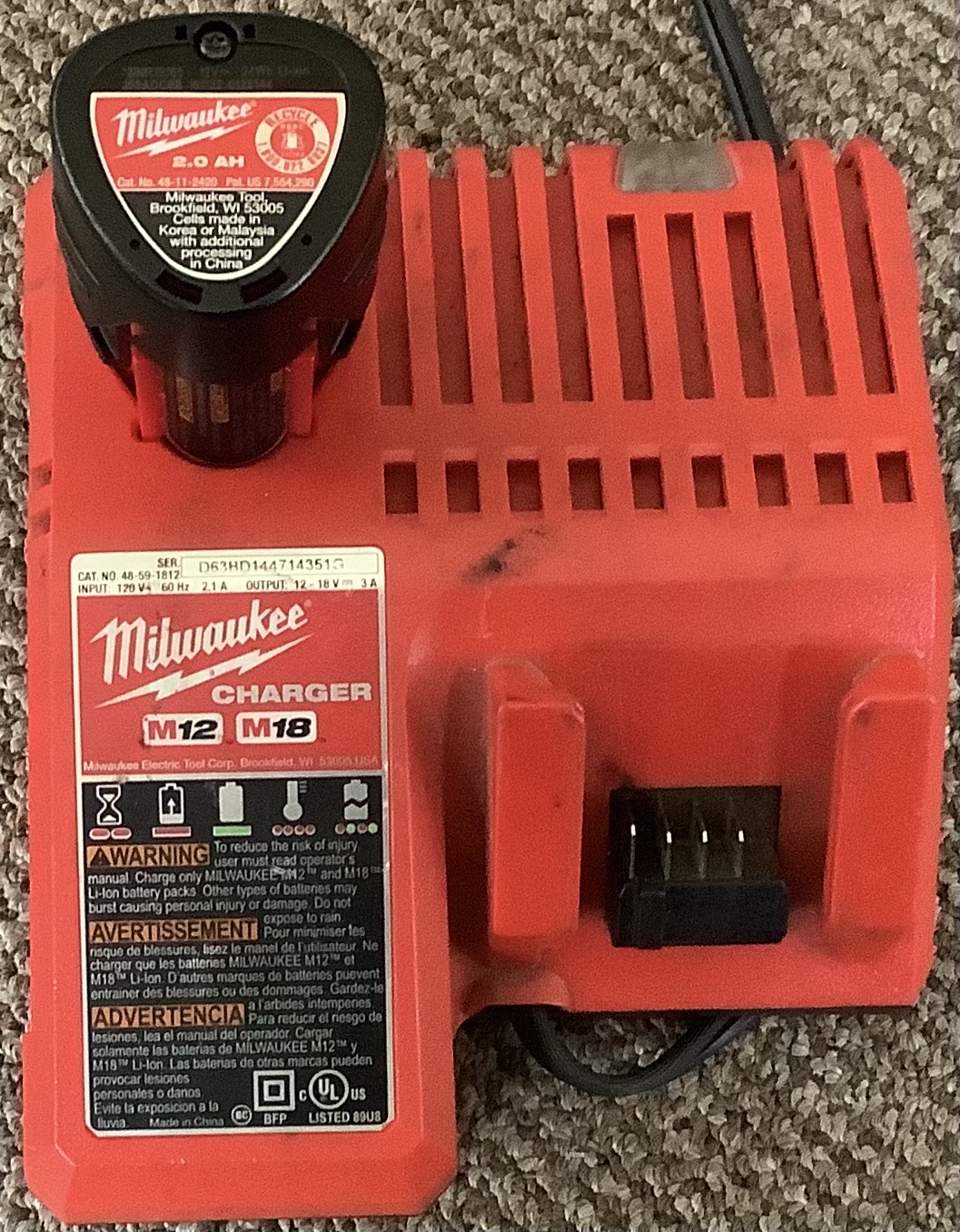

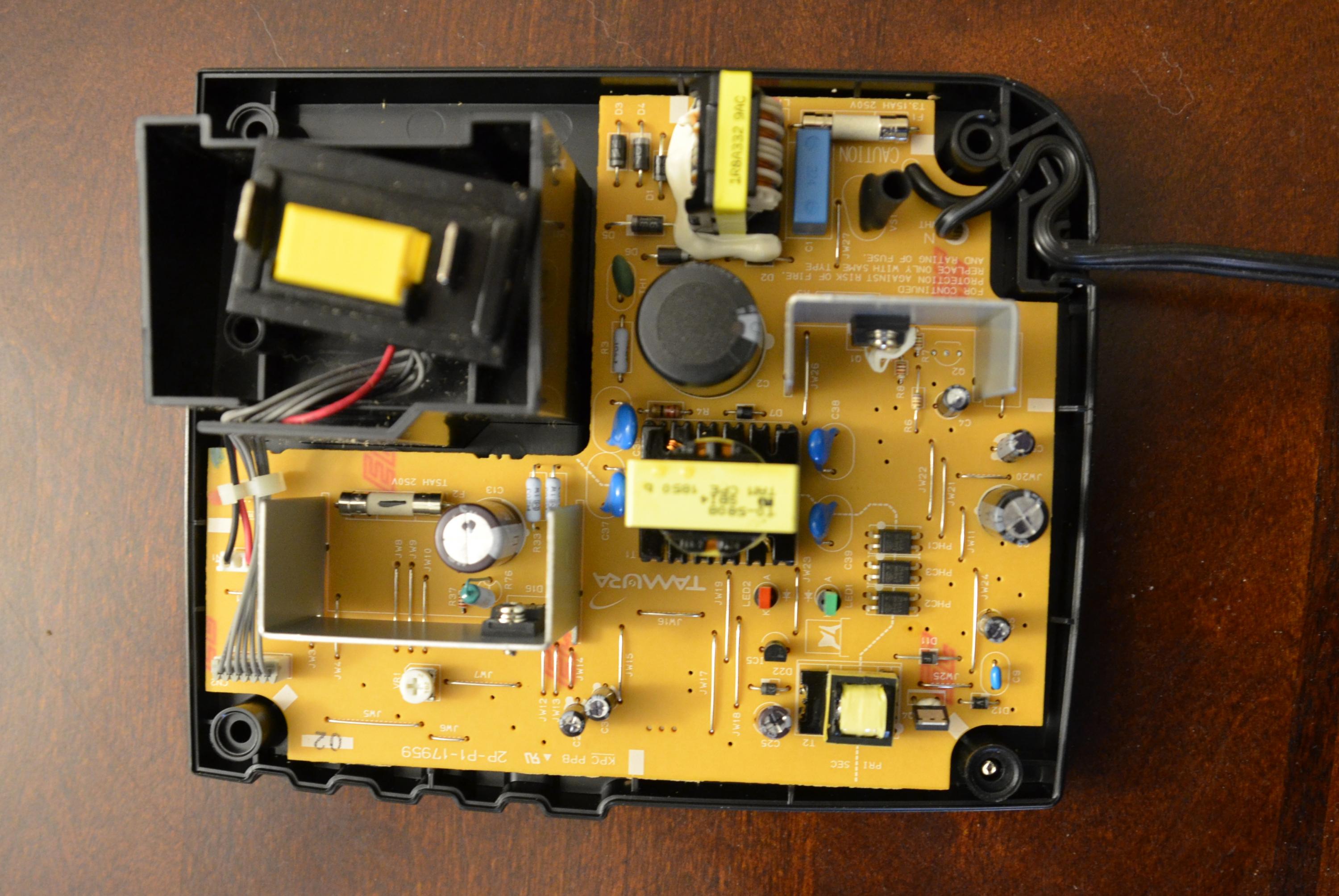

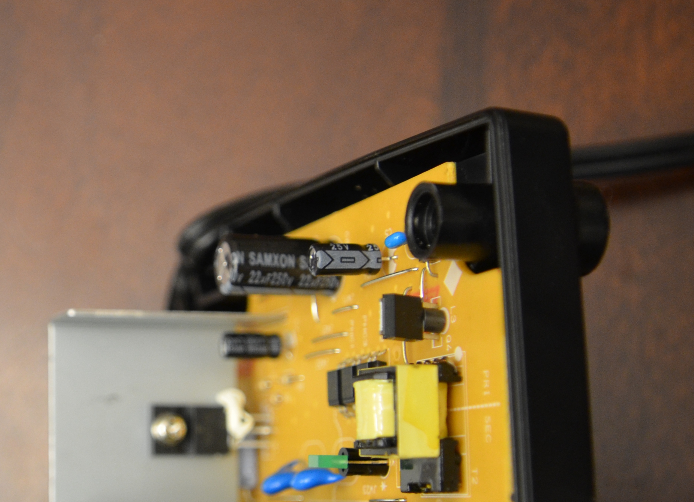

    Here we go again with tool battery pack chargers not wanting to charge because of one bad 10uf@50 volt capacitor and a 47uf@50 volt questionable ESR value
    10uf = 1.3 new 0.34
    47uf = 0.25 new 0.35
    The two capacitors replaced between the transformer and the heat sink
    A couple of days ago I put a battery on to charge and the red LED light was on when I went to go put the battery in the tool yesterday the fuel gauge showed one light out of four so I said what the hell is going on here the LED light is red or green it is not on at all so I open it up and checked the two capacitors that have gone bad on another Milwaukee battery charger I have same exact model so I been through this crap before but this one has lasted the longest time this is one of first battery chargers when they first start having the the “M” series I still have some of “V” series the ones that were nicad batteries
    One note on the “M12” battery pack these batteries are not the best batteries because the majority of them are made Korea and there quality is hit and miss some time they last for a long time and some of them only last a year or so the cells become unbalanced and the charger does not know how to deal with them and become useless if you try to put new batteries in it they will not charge correctly for some reason which I have not been able to figure out what is the issue with them but I think it has to do with the protection board in the battery

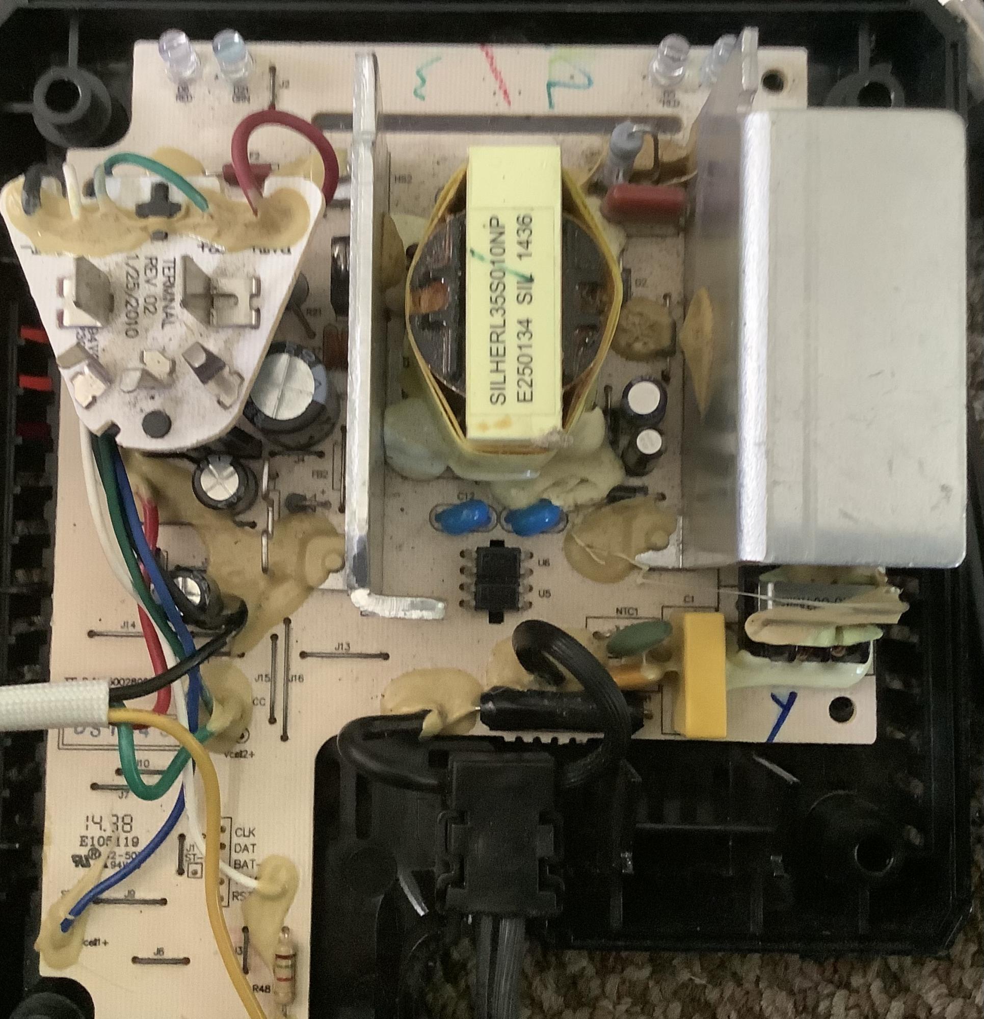

    pictures pls - not seen in a milwauki one yet!

      I just post the pictures of it if you need to take a picture of the bottom of the board I will but the small board that is for the “M12” battery pack board is a pain to put back on it two plastic post
        • 31139
        Re: Milwaukee Battery Charger M18/M12 Dual battery charger Dead no light during charg
        oh shit - that construction looks a lot like the Riobi ones i fixed.
            It's got a pound of glue inside, going brown at the snubber I would scrape that off before it conducts more.
            I would just shotgun it, replace all the electrolytics.
            I thought these chargers get hot for a short time, so it is not heat but the 10uF and 47uF parts are not that stressed out- unless that heatsink is too hot?
            Or are these simply cheap caps? This Milwaukee charger looks like a cheaper build.
            I hear many American companies go to china to get products made there for cheap, and they screw up. If you don't specify everything in the documents, such as quality and lifetime, temperature etc. the chinese will swap in the cheapest parts they have, undersize the caps etc.
                Captions or something similar in name they are shit capacitors when I see them I replace them I did not have a 470uf@50 volts to replace the big one so I did not replace any of the other ones I will keep using the way it is until quite-s again I have several of them and like I mentioned before this is first one that I bought
                I have it in my garage on a table where I can charge batteries that I use for work so I not very concerned about it taking a shit again then I will probably give it a total recap

                      Problem is the capacitors failing can then cause the SMPS IC/mosfet to blow up. It's like an auto-destruct just outside the warranty period.

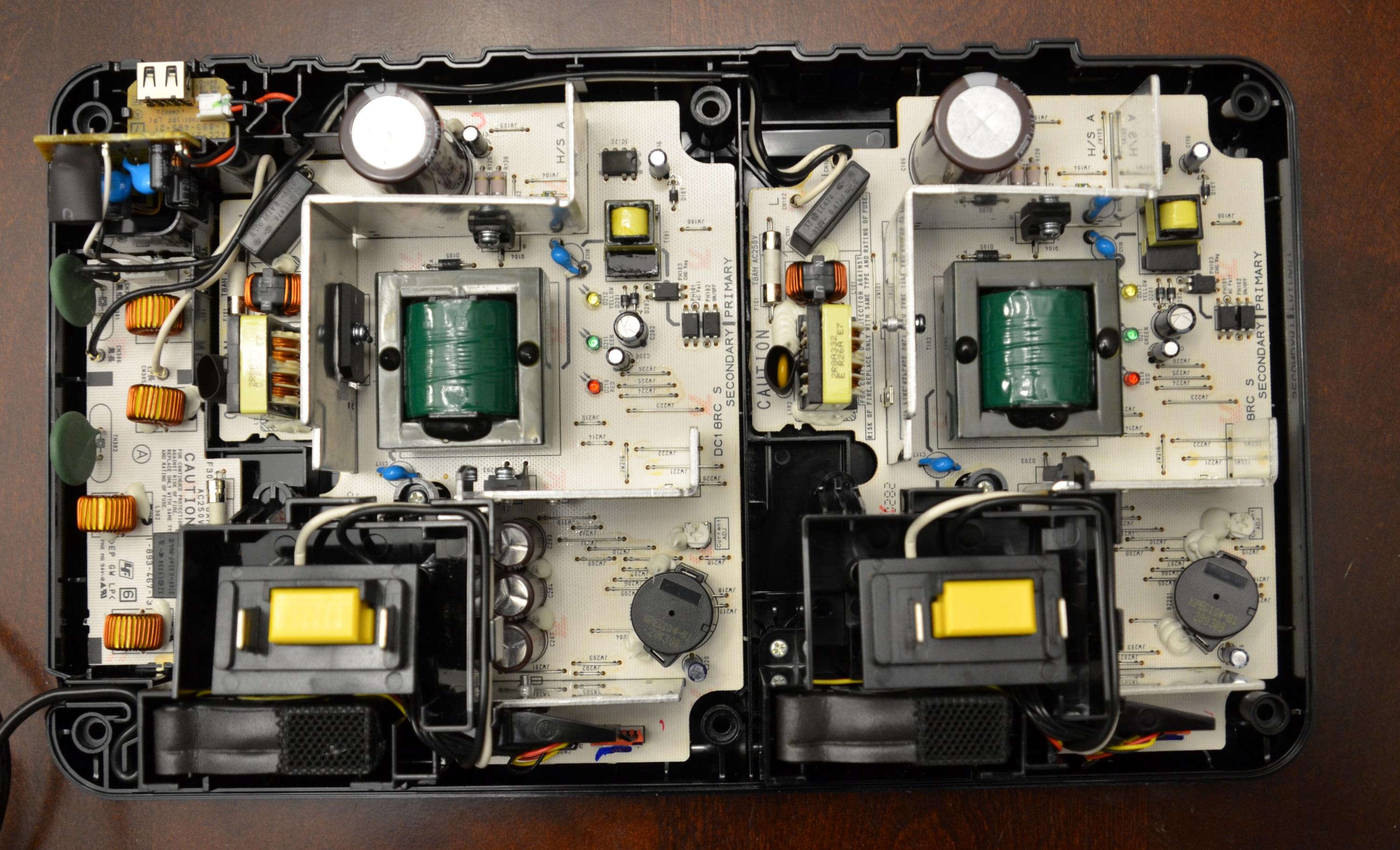

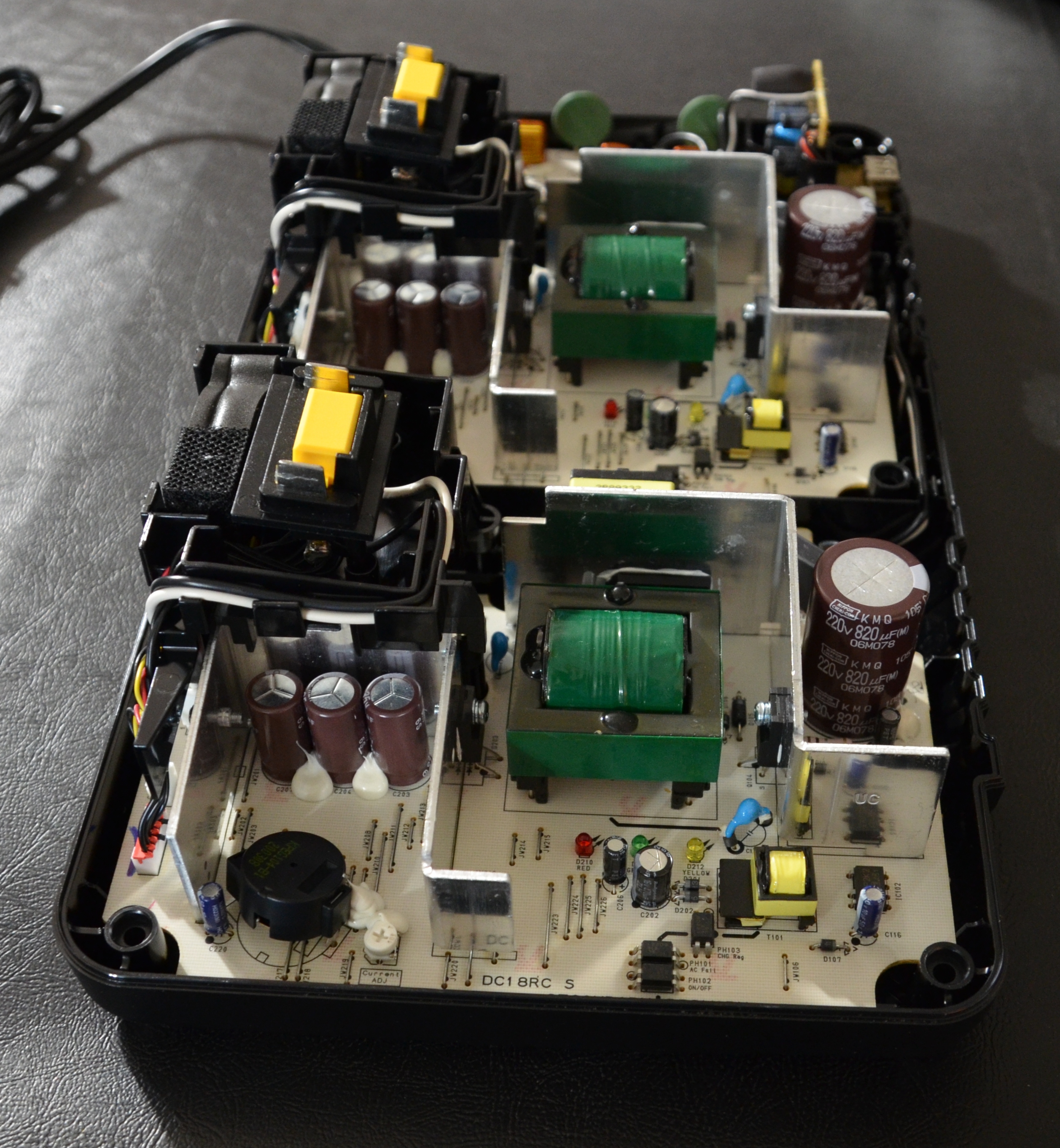

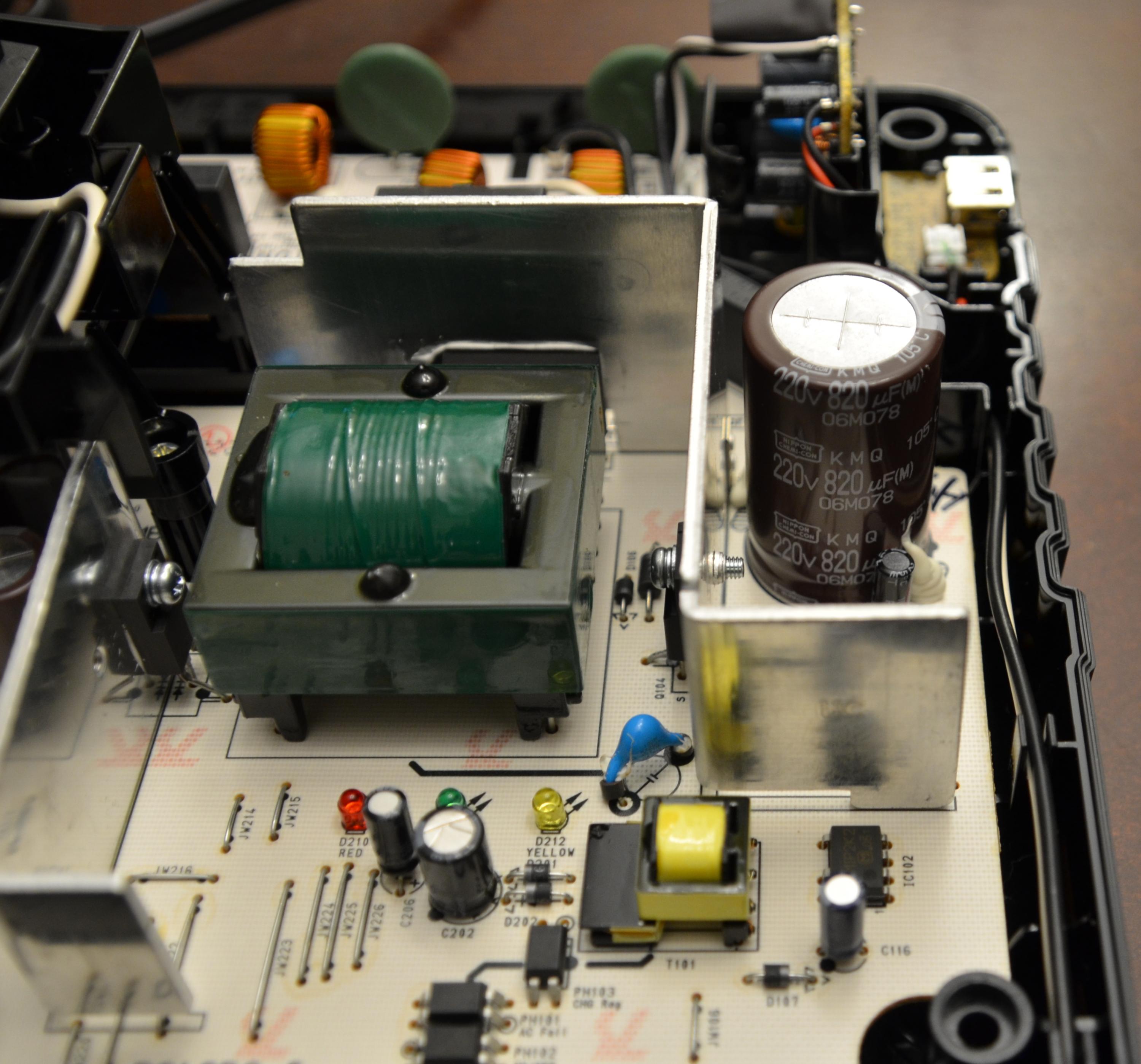

                        Even "premium" tool brands have different "grades" of tools and chargers, I don't have any Milwaukee cordless stuff (only corded), so I can't comment on if some of their chargers are better built than others, but I have a bunch of Makita stuff and 2 different models of their chargers, the standard DC18SD that they throw in with every kit (or about $35 if you buy it separately), and the "top of the line" DC18RD dual port rapid charger which lists for $120 all by itself (more than the entire $99 "entry level" Makita 18V drill kit), though I got it with one of the "deals" before Christmas last year and didn't pay anything for it specifically (included with a bundle). Which have a significant difference in both cap selection and overall build quality.
                        The Makita DC18SD "standard" charger:
                        Kind of lightly built, but it only needs to handle a 2.6A charge rate so it should be fine.
                        Caps from Aishi and Samaxon, not the worst, but not the best either

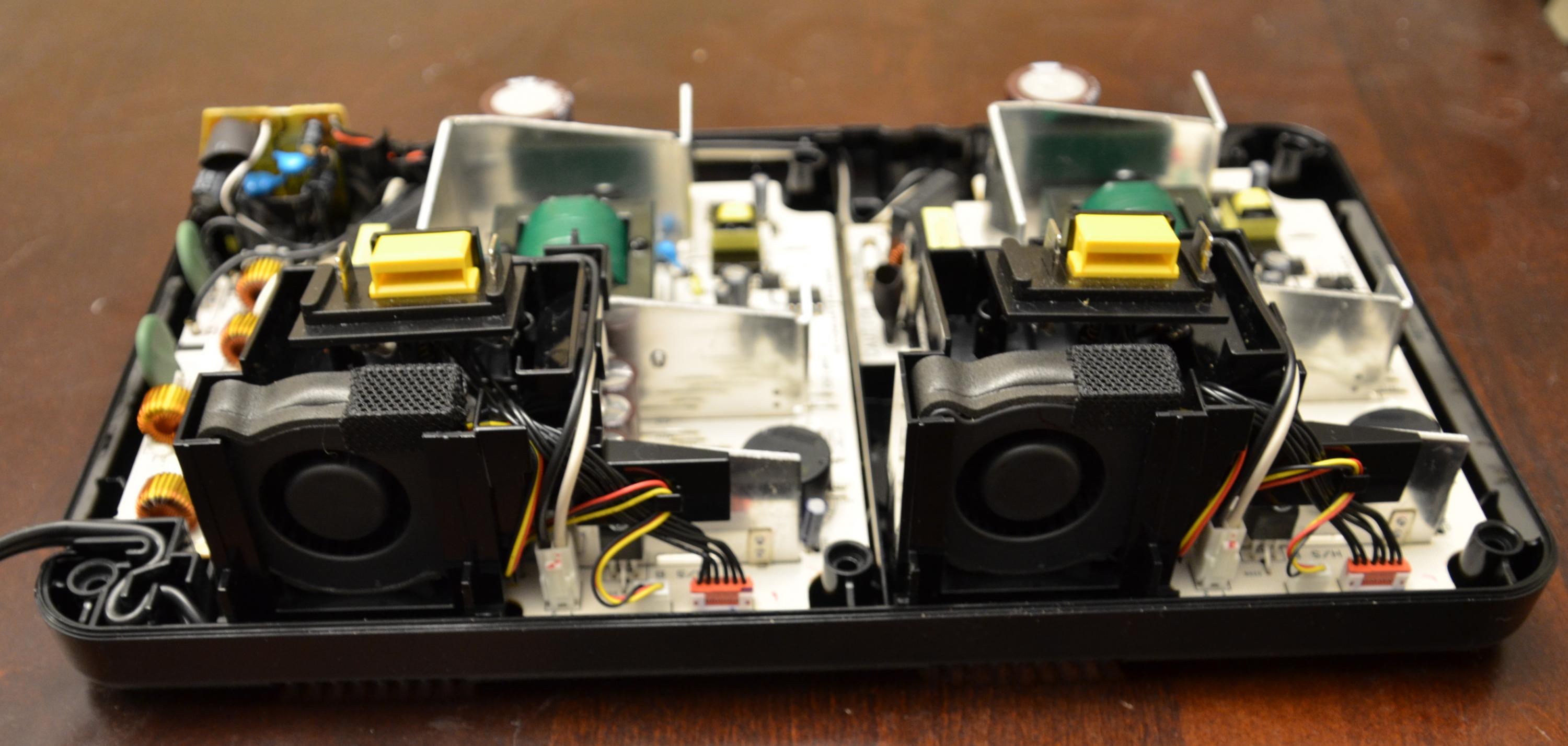

                        now the Makita DC18RD dual-slot rapid charger:
                        Much beefier, but it needs to be to handle a 9A per slot charge rate, it also looks like they just threw 2 chargers in one housing to make a "dual port" charger.
                        Caps all from Nippon Chemi Con and Rubycon
                        and active cooling as well.

                          The dual charger is not exactly the same for each side on the left side of the charger has output capacitors however the charger board on the right hand side does not have the three output capacitors
                          • dmill89
                            • Dec 2011
                            • 2534
                            They both have the output caps, they are just hidden by the battery slot on one side due to the angle of the picture. The only thing "shared" between the 2 sides is the input filtering.
                              It looks like two identical charger boards. For the $120, on a jobsite I'd say it's well worth it. The cooling fans are just over the top lol, how many watts is this, 820uF primary cap too is huge. 9Ax18V= ~162W each in a flyback?
                              You have mega-conglomerate TTI having to map out each "brand" and what quality and price niche each one is boxed into.

                                    Well the other battery charger took a shit yesterday it was telling me that the new 12 battery for the new drill I had to buy new one because the battery fuel gauge board has malfunction and all 4 lights keep blinking and the tool light will not go off by itself
                                    The battery charger would still charge the 18 volt batteries but not the 12 volt one
                                    Found a 10uf @50 volts 0.98 ESR value new 0.38 ESR value the 47uf @ 50 volts 0.68 new one 0.38 ESR value the rest of the capacitors were not quite as bad but Capton brand and a couple of them looked like they were possibly starting to leak
                                    Now the charger is charging the 12 volt batteries again WOW saved $90.00 from having to buy a new one
                                    One note the Milwaukee tools that is sold at Home Depot has changed there warranty program no other place that sells Milwaukee brand tools will no longer fix them ( now they offer a replacement plan for two years for $18.00 which I purchase because I have had issues with some tools that I had to be fixed under warranty before )
                                    I think I have one more older version still with the original capacitors in it but I do not use that charger very often but I might start using it so it can take a crap as well so it can get recapped
                                    When you buy a M12 tool the tool only has the ( M12 ) 12 volt charger only I have several of them that I only use when I not a home and do something on location
                                      I would not have replaced those based on ESR, it still looks reasonable? I measure their capacitance as well. I wonder about the bigger output caps too. Maybe the heat is too much for the smaller parts.
                                      Were the old caps CapXon brand? I had to laugh they were on the HK stock exchange and got de-listed for the usual corruption and cooking the books. Absolute garbage capacitors, across the board.
