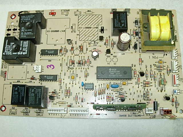

Good thread on the dim Jenn-Air clock. I had to do this repair a few years back as well. Now for another well-known Jenn-Air problem that has not been figured out (as far as I know). The same models that have the dim clock also develop quirky problems with the main controller board. Intermittently, you will get an error code that starts up for no apparent reason. Pressing the Cancel/Off button stops it and away you go.
But the real irritating problem that develops in these units is that the broiler fan starts running all the time. Actually, the fan starts up at a very low temperature, far below the 500 degrees that the manual states as normal. This fan is designed to keep the space between the cooktop and the oven cool when the broiler is turned on (or if the oven is in self-cleaning mode).
The fan is turned on by a relay on the relay (controller) board. Obviously, there is a faulty sensor somewhere that knows when broil/clean is on, and 500 degrees has been reached. An obvious place to start is the main oven thermostat, but that's not it (replaced years ago). I've been all over the controller board replacing electrolytics, resoldering, checking for leaky parts without any luck.
It is possible there may be some kind of sensing in the timer pc assembly, since that board is actually located in the space that requires cooling. Since there is already a track record of the display caps failing, I may go in for another close look at the timer. There is actually serial data being exchanged between the timer assembly and the controller board so its not so simple.
Has anyone been successful with the well-known broiler fan problem?
Thanks!
