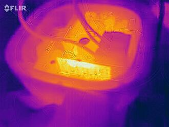

    I pulled out my thermal camera to see what i could see from the outside and the mounting base was getting hot.

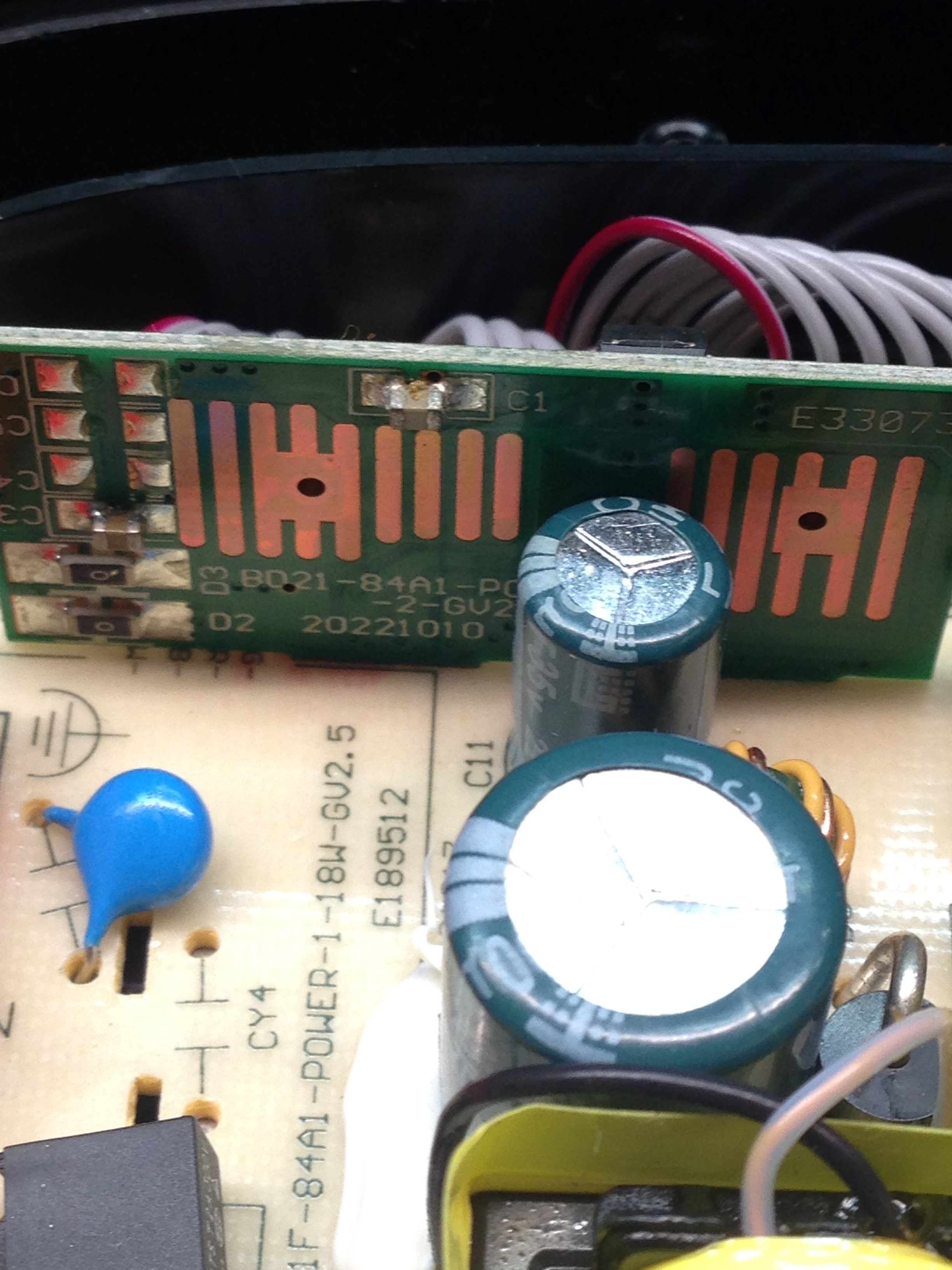

    Everything looked fine visually on the power supply.

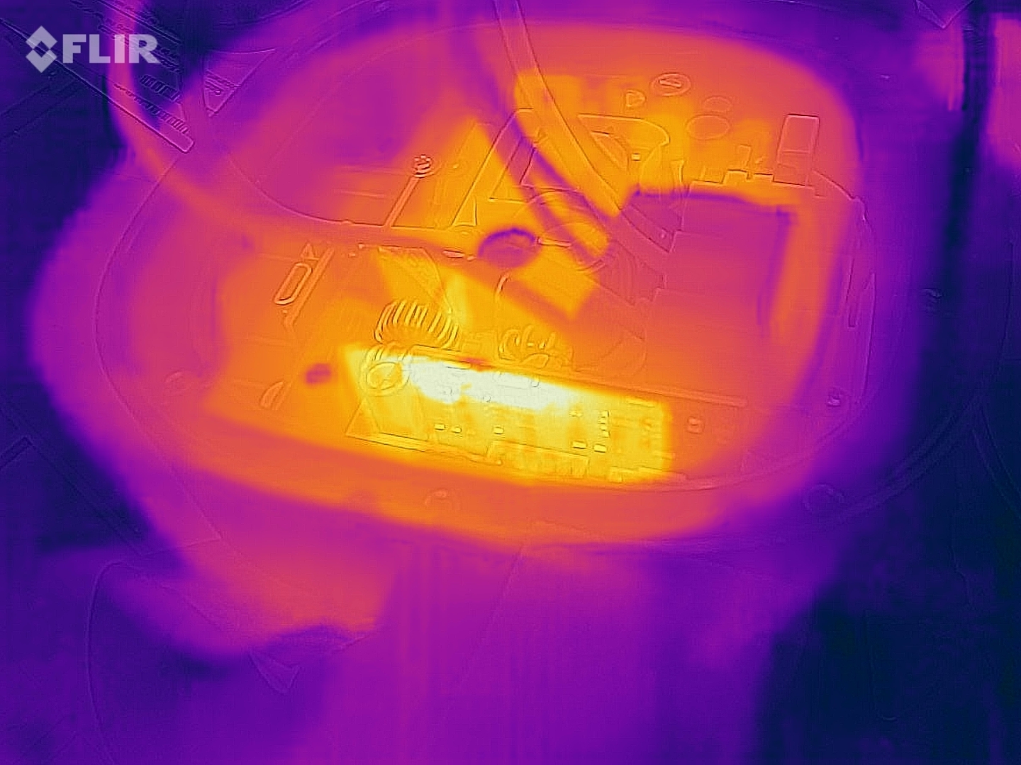

    I applied power to it and again and took a look with the FLIR.
    Click image for larger version  Name:	20240905T215103.jpg Views:	0 Size:	736.9 KB ID:	3419013
    Right away you could see some components on small breakout board (the one standing straight up) were getting very hot very fast.
    I applied IPA to cool everything down quickly and took a video trying to catch exactly which SMD was the main culprit.
    VIDEO
    temp-1.mp4
    Click image for larger version  Name:	IMG_0095.jpg Views:	0 Size:	1.33 MB ID:	3419016

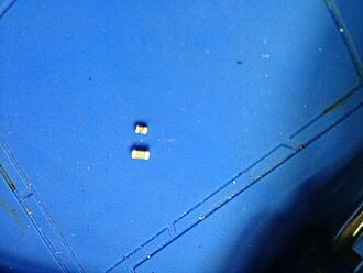

    It was a lone 0805 capacitor at C1.
    I checked it with a multimeter and sure enough it read as shorted.
    There was another cap at C3 that was nearly identical so i removed it to measure its capacitance.
    It read 1 uF.
    So i replaced the shorted one with a 1206 as i dont have 0805s on hand at the moment.
