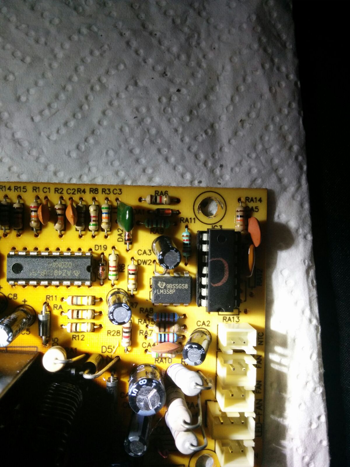

                            Hello, I cant find any TO92.
                            and I think the resistance in the emitter of T7 is my R36
                            R35 goes to the Base )having in mind this transistor is like the BUL39Q i think i found as replacement but I also wanted to know if i can change it to MJE13007 because on the same thread i found i can use both but now im not sure.
                              Re: Wine Fridge Power Board
                              This is my IC3
                                If there is no TO92, then I can't see the purpose of IC3. AISI, IC3 has a single output but no inputs, yet it controls the TL494 in some way ???
                                I understand where R35 and R36 go. I want to know where R34 goes. In the diagram it connects to B- via the transformer winding. I believe that the other end of the transformer winding should connect to the emitter of T7, not B-.
                                As for your question regarding the transistor, please tell us the pinout of the original transistors. Is it BCE or ECB, and have you confirmed that it tests like an NPN transistor, not a MOSFET?

                                  OK, let me remove the transistor to check the BCE or ECB and also my D12 to realize the D10.
                                  did you see my picture I dont have TO92, nor even the empty space for it. thanks
