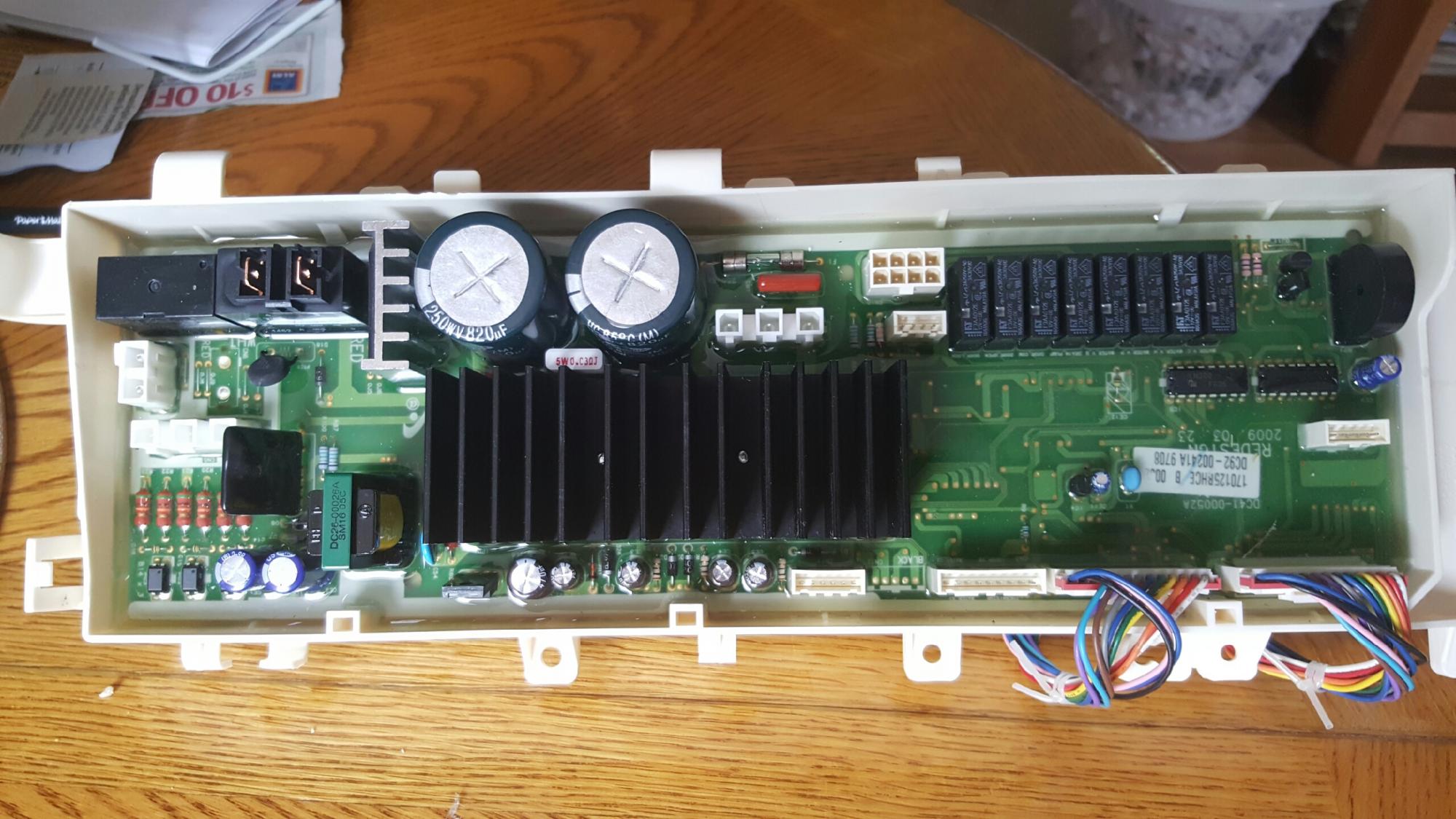

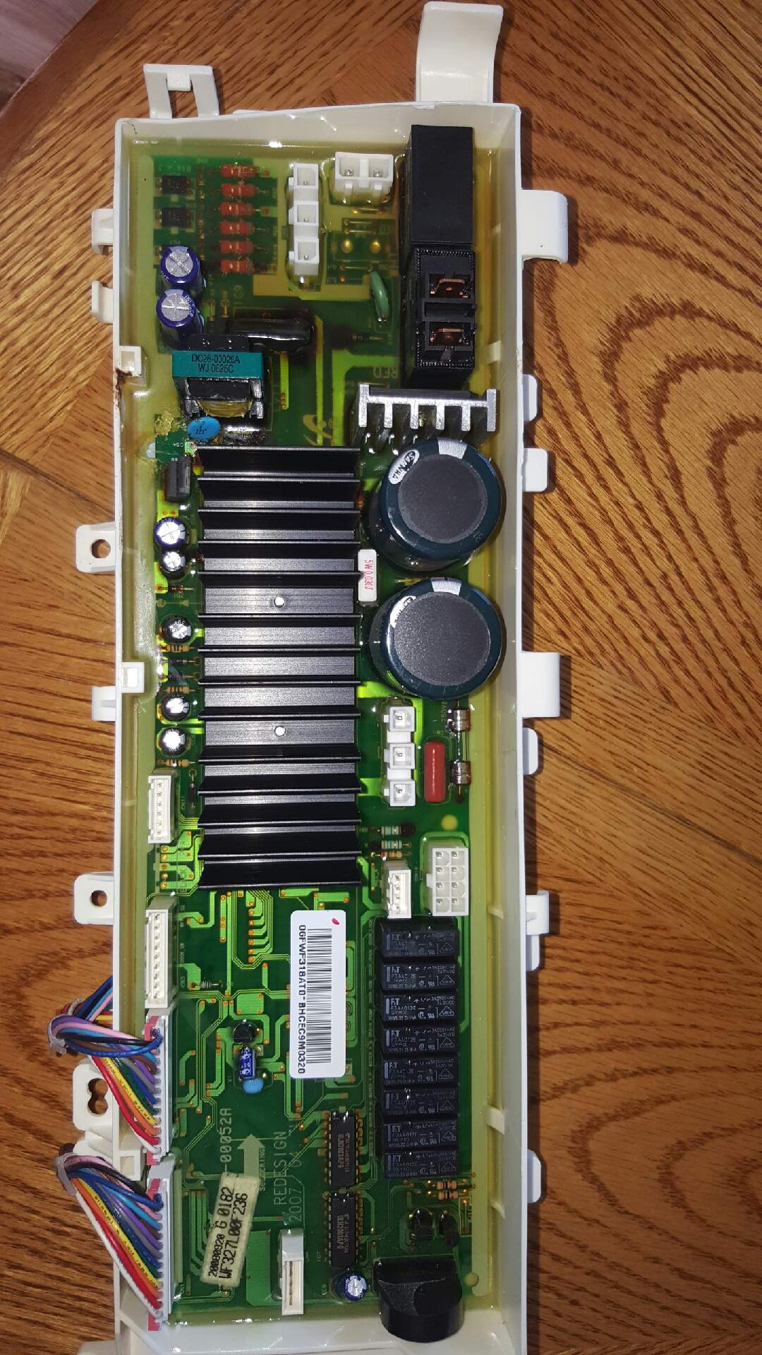

    Model WF328AAW/Xaa. Original problem is the machine will not discharge the water. No power to the pump, I can run the pump off 120v, The circuit board is encased in what looks like silicone. The look to be some scorching on the board in a couple spots.
    I have ordered what is supposed to be the replacement main controller board as per the parts people at several . I had to source it via ebay as my orders with reputable online suppliers were cancelled do to the part being NLA.
    Both replacement boards were listed as NEW, both boxes were beat to death in the mail. Both boards throw a error code E3 which indicates a motor issue (motor hums and moves a tiny amount before erroring out) but both boards run the discharge pump. With the original board there is no motor issue or E3 error. I suspect these 2 boards part # DC92-00240A are not correct for this machine even though every parts website I contacted claims they are and several also claimed it was in stock but cancelled my order for NLA.
    So, I want to try and fix the original board that won't run the discharge pump. I have a donor board from one of the suppliers who told me to keep it.
    I will attach the service manual with board schematic and a picture of the back of the original board (asap) and the replacement/donor board.
    Right now my biggest obstacle is the "silicone"...how do we remove it without destroying any parts including the plastic housing?

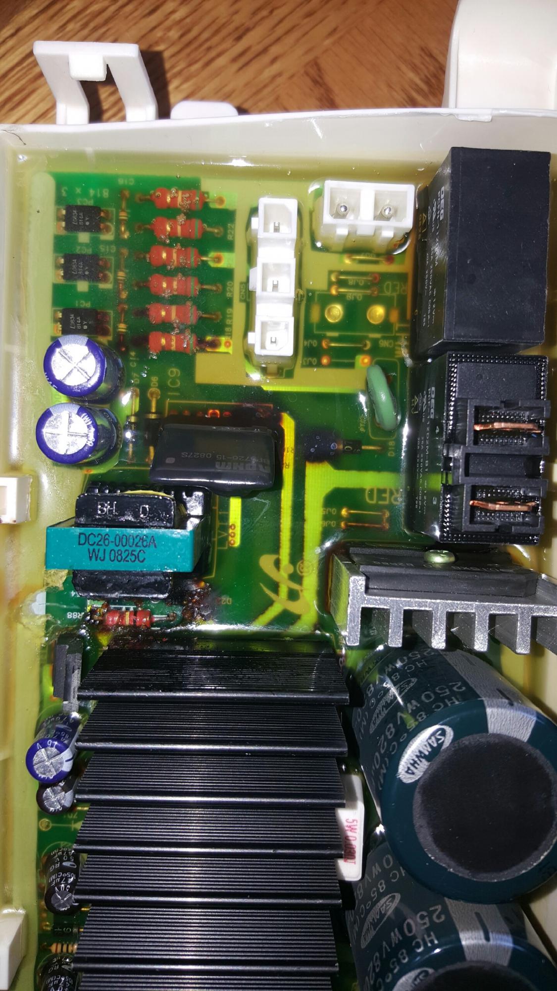

      Please take a very good photo of that area so see where that is
      What part is under the heat sink
      Can you trace where the pump wire go to get power to run also dose this pump motor have a run cap

        So what this mean is that the relay that operates the coil for the pump down is NOT getting power
        How good are following the traces on a board
        ( in the manual that you posted there is a photo of the controller board and box that shows you where the relay is )
        Here what you need to find on that relay that controls the power to the pump down valve is the COIL contacts
        See if the relay has what voltage the coil is it probably 24 volts could higher or lower voltage
        Here where you need to be careful this board also has the power for the servo motor for the machine on this board and sensor that tell the controller if motor is moving or not
        Take two wire and solder it to the coil ----->>>
        ( or you can unsolder the relay and check
        [ you need an adjustable power supply to do this test you also need a volt meter to check conditions of relay <---> contacts this should be done with a load would be better ]
        the coil and contact on the relay to see if it works the way it should )
        <<--------- on the relay that powers the pump down valve you need to make sure that you have power to this relay when it in pump down portions of the cycle if you do not then your controller has issues

          I have extracted the donor board from the plastic housing, however it is still encased in silicone.But at least I know how to get the other board out without damaging it.
          I can trace it out, I also have the schematic (it's in the service manual) and can solder use a DVOM have a scope, esr meter and more.
          The pump is small (fist sized) 120v pump with no capacitor on it. The pump runs fine with 120v connected to it. The voltage from the board at the pump fluctuates from approx 12v to 19v. The #5 relay that runs the pump says it is 12vdc/3a 250vac relay.

              the doner looks like it may have some bad solder joints that have cooked under the resin.
                Re: Samsung washing machine no power to discharge pump
                The drain pump circuit is MCU driving one relay, from 15VDC/220R series reistor to make 12V for the relay.
                It might be worn relay contacts, I would replace the relay.
                With coated PCB's a heat gun can help peel it off. Not super hot to cook/melt plastics though.
                The donor board has black spots in many places, around IC9 D18 R18 so it might be lightning damaged?
