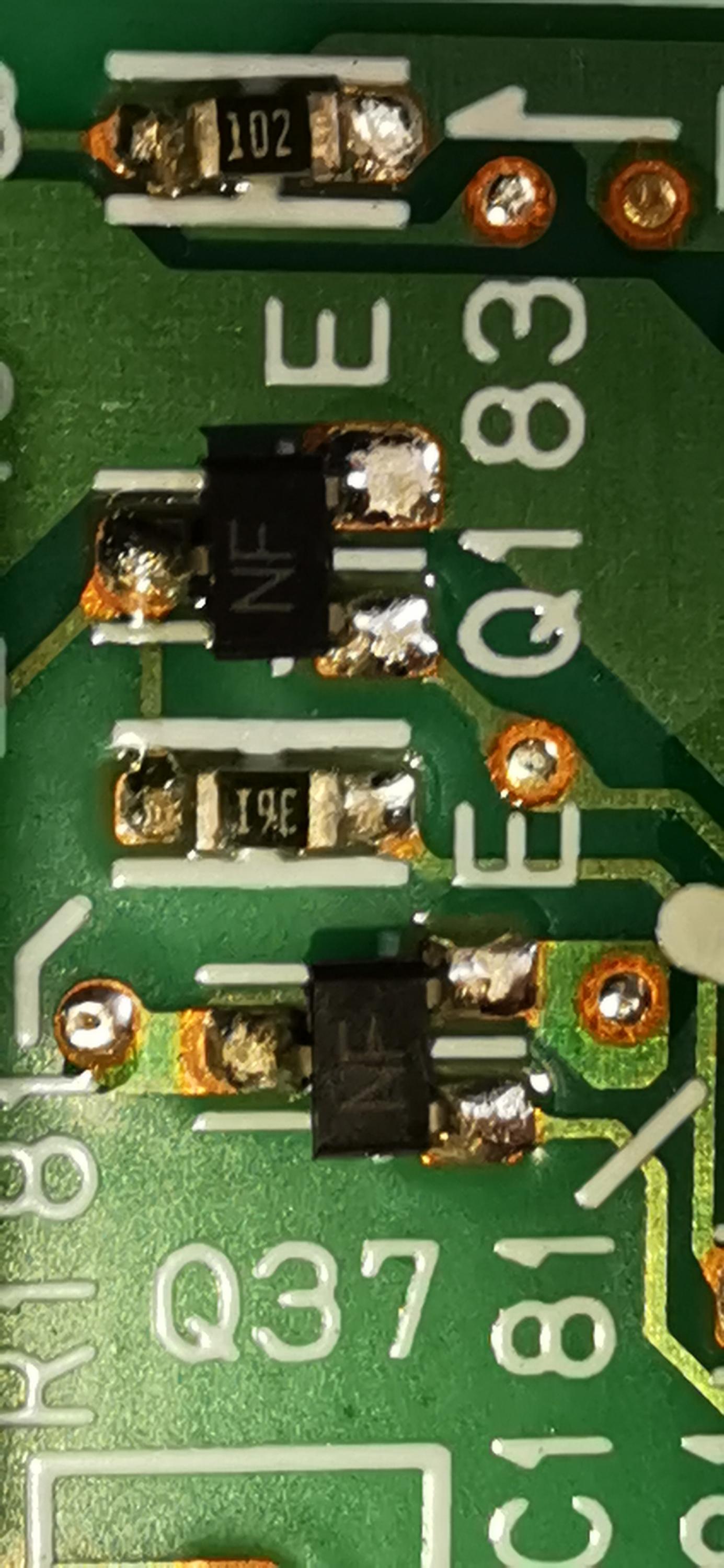

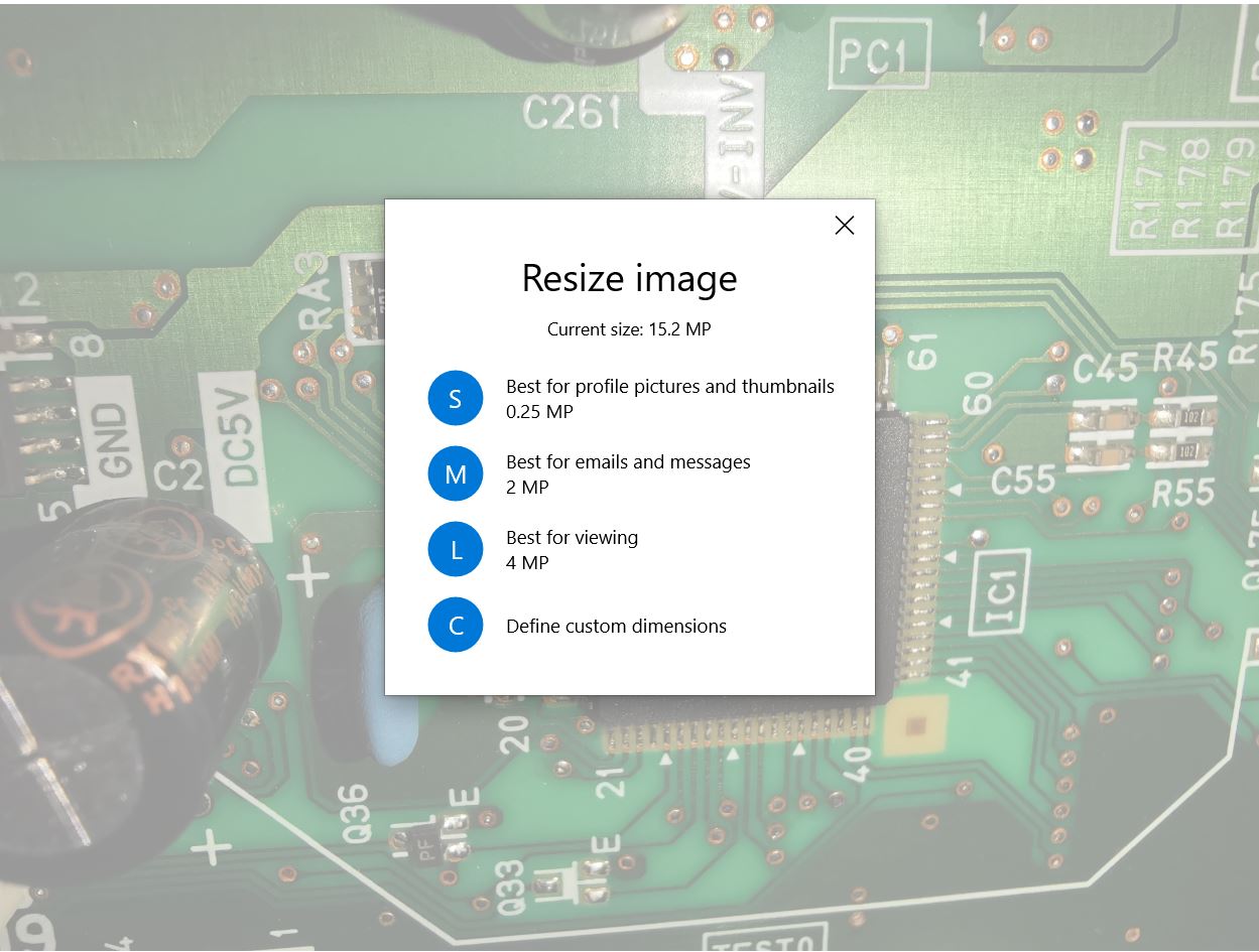

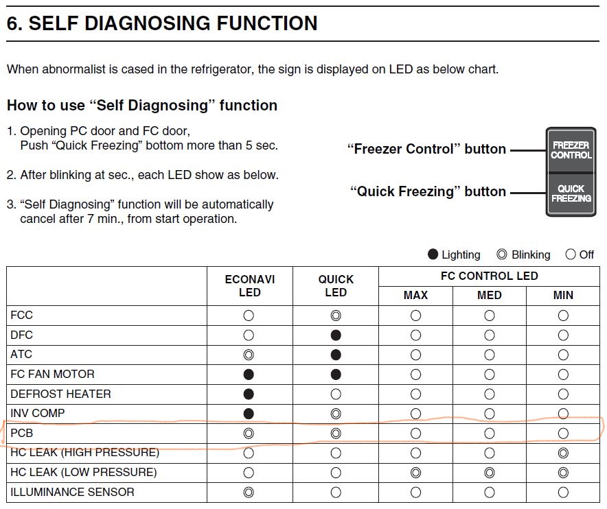

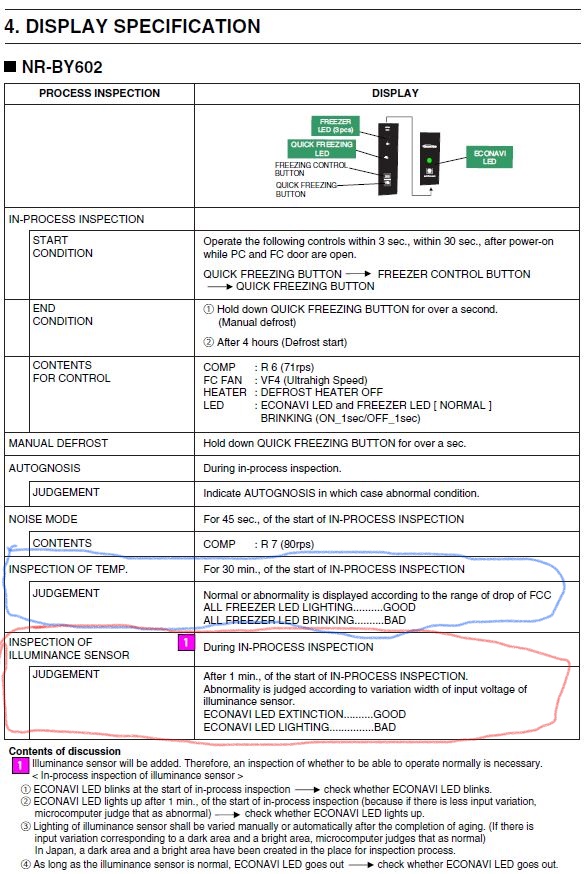

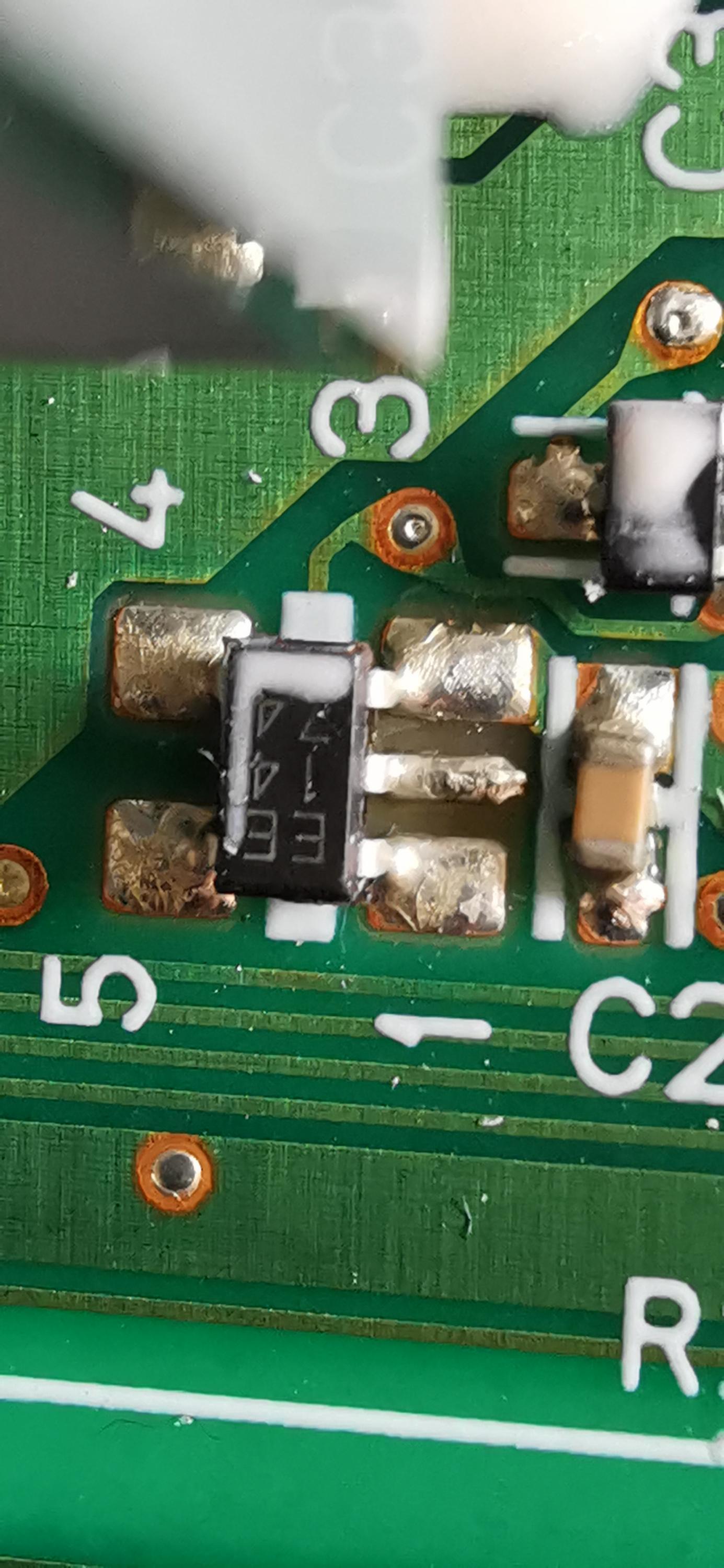

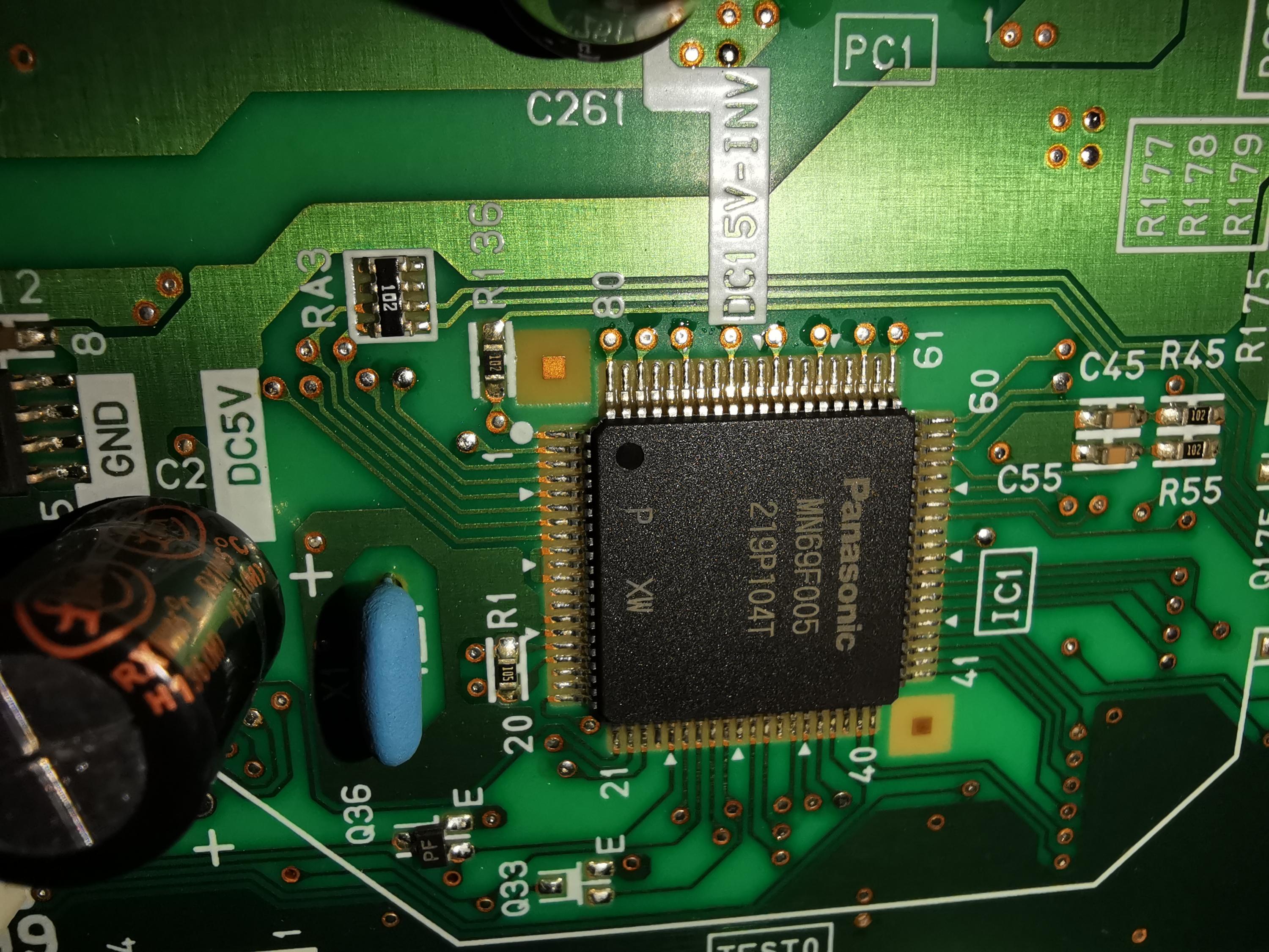

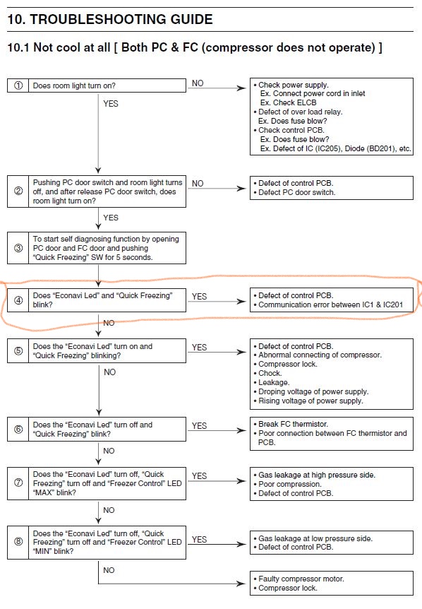

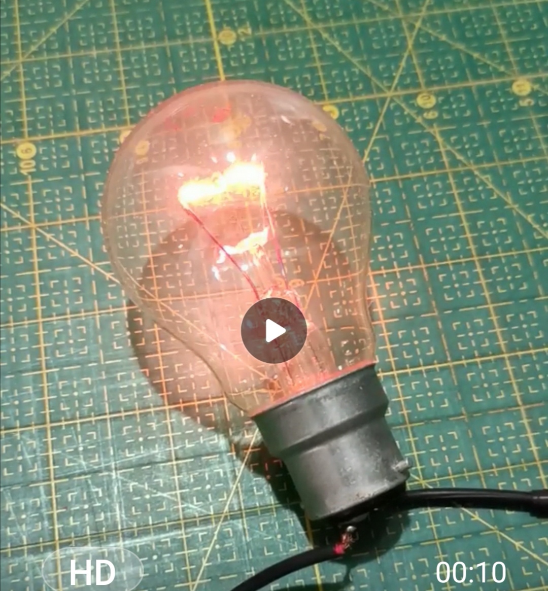

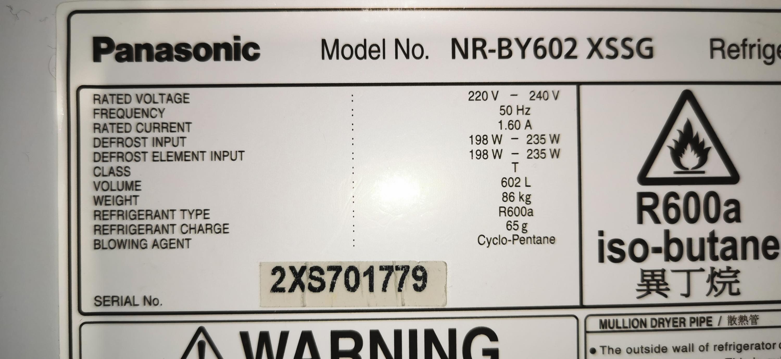

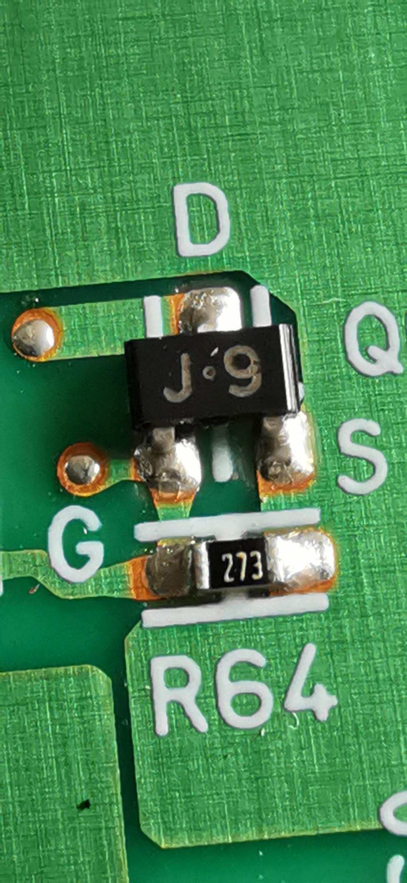

Panasonic Inverter Refrigerator model NR-BY602XS - suddenly not cold overnight
  • gurangax
    replied
    Originally posted by ajshoe View Post
    check the caps.
    alright I'll check them. thanks
    Leave a comment:
  • ajshoe
    replied
    check the caps.
    Leave a comment:
  • gurangax
    replied
    Originally posted by ajshoe View Post
    first of all - this refrigerator has a control bd that drives an inverter board that controls the compressor. The voltage coming from the inverter bd driving the compressor is 80 - 230 VAC. 1. test the compressor windings - should ohm out all the same. If all the same ohms between the 3 pins - compressor is probably good. 2. test the control bd by testing for 4V-6V volts going to the input of the inverter board - this is the voltage that drives the inverter board to put DC voltage to the compressor. Also test for 120 VAC going into the inverter bd. If no 4 VDC - 6 VDC voltage going to the inverter bd than control board is bad or a temp sensor is bad going to the control bd. 3. Look at the inverter board for burn marks.4. next I would test the amp draw of the inverter bd (should fluctuate between 1 - 3 amps) by using an amp meter on the 120 VAC input to the inverter bd - if its zer0 than the inverter bd is bad. If the amperage jumps to 4 amps and then declines to zero (this will cycle as the control bd realizes the compressor is not starting) - compressor is probably bad. 5. If you got this far and everything is good - the next test is to test the invert bd output with a phase detector (expensive piece of equipment) 6. finally either the compressor is weak or the system has a leak and is low on fluid. This is a closed system and no fluids should ever leak out. The inverter board is usually the culprit but not always. hope this helps !
    Thank you I am trying to repaird the board as the compressor seems fine. I have replaced the IPM. and blink code seems to refer to communication error between the 2 CPUs. I checked the crystal oscilattor with osciloscope and confirmed to be working at specified frequency. The IPM used is PS21961-4. Maybe you can give me some more ideas. thanks
    Leave a comment:
  • ajshoe
    replied
    Originally posted by gurangax View Post
    I have same model and about the same problem. Did you solved yours? My compressor doesn't spin. replaced with bulbs no lights. replaced IPM same problem. seems like this problem Communication error between IC1 & IC201 based on blink code
    first of all - this refrigerator has a control bd that drives an inverter board that controls the compressor. The voltage coming from the inverter bd driving the compressor is 80 - 230 VAC. 1. test the compressor windings - should ohm out all the same. If all the same ohms between the 3 pins - compressor is probably good. 2. test the control bd by testing for 4V-6V volts going to the input of the inverter board - this is the voltage that drives the inverter board to put DC voltage to the compressor. Also test for 120 VAC going into the inverter bd. If no 4 VDC - 6 VDC voltage going to the inverter bd than control board is bad or a temp sensor is bad going to the control bd. 3. Look at the inverter board for burn marks.4. next I would test the amp draw of the inverter bd (should fluctuate between 1 - 3 amps) by using an amp meter on the 120 VAC input to the inverter bd - if its zer0 than the inverter bd is bad. If the amperage jumps to 4 amps and then declines to zero (this will cycle as the control bd realizes the compressor is not starting) - compressor is probably bad. 5. If you got this far and everything is good - the next test is to test the invert bd output with a phase detector (expensive piece of equipment) 6. finally either the compressor is weak or the system has a leak and is low on fluid. This is a closed system and no fluids should ever leak out. The inverter board is usually the culprit but not always. hope this helps !
    Last edited by ajshoe; 10-01-2024, 08:09 PM.
    Leave a comment:
  • gurangax
    replied
    I have same model and about the same problem. Did you solved yours? My compressor doesn't spin. replaced with bulbs no lights. replaced IPM same problem. seems like this problem Communication error between IC1 & IC201 based on blink code
    Leave a comment:
  • beetle1303
    replied
    Re: Panasonic Inverter Refrigerator model NR-BY602XS - suddenly not cold overnight
    OK... Looks like it's praying for a kind donor, or paying for a reasonable price used unit as tuition fee.
    I have started browsing and found a few identical model, but price a little stiff after costing in transportation.
    I guess will need a little more time to catch one...
    Leave a comment:
    replied
    Re: Panasonic Inverter Refrigerator model NR-BY602XS - suddenly not cold overnight
    Originally posted by beetle1303 View Post
    OK. Let me summarize the options to move forward:
    1) Refill refrigerant - this will determine if there is leakage. Maybe worthwhile (probably not)
    2) Replace controller board - If a used fridge of same model can be found at low price. ( good idea if you can find one )
    3) Replace some of the tubing - this will determine if there is blockage or restriction. Probably too costly for a old fridge..
    3) Replace compressor - not worth the money..
    Any feedback on these options? Or any other viable options?
    I commented on your though but for the most part you are right
    Last edited by sam_sam_sam; 04-29-2020, 11:17 AM.
    Leave a comment:
  • beetle1303
    replied
    Re: Panasonic Inverter Refrigerator model NR-BY602XS - suddenly not cold overnight
    OK. Let me summarize the options to move forward:
    1) Refill refrigerant - this will determine if there is leakage. Maybe worthwhile
    2) Replace controller board - If a used fridge of same model can be found at low price.
    3) Replace some of the tubing - this will determine if there is blockage or restriction. Probably too costly for a old fridge..
    3) Replace compressor - not worth the money..
    Any feedback on these options? Or any other viable options?
    Leave a comment:
    replied
    Re: Panasonic Inverter Refrigerator model NR-BY602XS - suddenly not cold overnight
    Originally posted by beetle1303 View Post
    After 10-15 minutes, no observable difference in term of coldness in both compartments.
    How long does a normal fully working fridge takes to start feeling coldness if you place your hands in the freezer compartment?
    It should only take few minutes for the coil to start getting cold where the cap-tube is and the coil meet together
    When hear the liquid flowing like this is not a good sign and not getting cold
    There is not much refrigerant in theses units so if have a leak or a restriction it does not take it long for it not work
    Last edited by sam_sam_sam; 04-28-2020, 12:15 PM.
    Leave a comment:
    replied
    Re: Panasonic Inverter Refrigerator model NR-BY602XS - suddenly not cold overnight
    That what I thought ( “gurgling liquid flowing” ) I being to think that either the compressor ( will not run at full speed )[Controller issues] or [ compressor pumping issues ]
    OR
    You have a restriction in filter dryer ( OR ) cap-tube
    OR
    You have a gas leak
    This is where you would need a set service gauges and a specific type of amp probe to figure out what going on with this system
    Last edited by sam_sam_sam; 04-28-2020, 12:04 PM.
    Leave a comment:
  • beetle1303
    replied
    Re: Panasonic Inverter Refrigerator model NR-BY602XS - suddenly not cold overnight
    Originally posted by sam_sam_sam View Post
    Look at the end of the ( evaporator coil ) and see where very small tube is on one of coil and see if ice is forming there if so and only in one spot and does not grow then you have restriction or a gas leak
    Also remove the temperature sensor and warm it with your hand and see if the compressor will run at full speed
    There is absolutely no frosting anywhere around the evaporator coil.. I don't think the refrigerant inside the coil is cool enough to form frost/ice. Touching the coil can feel the gurgling liquid flowing, but no sense of coldness at all.
    After power up for a few minutes, I place both defrost and freezer sensors in a cup of semi-hot water (around 50degC I guessed), but cannot really tell if the compressor is running at full speed or not.
    After 10-15 minutes, no observable difference in term of coldness in both compartments.
    How long does a normal fully working fridge takes to start feeling coldness if you place your hands in the freezer compartment?
    Last edited by beetle1303; 04-28-2020, 09:21 AM.
    Leave a comment:
    replied
    Re: Panasonic Inverter Refrigerator model NR-BY602XS - suddenly not cold overnight
    Originally posted by beetle1303 View Post
    By data plate do you mean this in the pic below?
    I am just curious - if the compressor runs at whatever speed, and the inlet is slight cool, the outlet is warm (not hot), and the evaporator coil has refrigerant flowing with gurgling sound, etc, shouldn't the evaporator coil be slightly cool the the touch?
    Look at the end of the ( evaporator coil ) and see where very small tube is on one of coil and see if ice is forming there if so and only in one spot and does not grow then you have restriction or a gas leak
    Also remove the temperature sensor and warm it with your hand and see if the compressor will run at full speed
    Leave a comment:
  • beetle1303
    replied
    Re: Panasonic Inverter Refrigerator model NR-BY602XS - suddenly not cold overnight
    Originally posted by R_J View Post
    Refrigerators don't make cold, they remove heat, so the evaporator might not feel very cold. the gurgling sound does suggest the compressor is running. But the diagnostic still gives an error?
    I am actually quite uncertain about the Self Diagnostics instructions - seems to be a translation from Japanese to English, and some texts are quite unclear..
    Here's the summary of the Self Diagnostics done:
    1) Page7 - In process Inspection
    - after 1 minute: Illuminance Sensor LED is On, indicating BAD
    - after 30 minutes: All Freezer Control LEDs blinking - indicating BAD
    ** no description of what is BAD...
    2) Page 11 - SELF DIAGNOSING FUNCTION
    - based on the initial blinks (before they go off): PCD is BAD
    3) Page 15 - Not cool at all [ Both PC & FC (compressor does not operate) ]
    - based on the initial blinks (before they go off):
    • Defect of control PCB.
    • Communication error between IC1 & IC201
    4) Page 16 - Cool, not enough [ Both PC & FC (compressor operates) ]
    - based on the initial blinks (before they go off):
    • Defect of communication circuit and EEPROM circuit of control PCB.
    • Plug out and after 7 minute plug in again.
    Same outcomes in repeated tests. If these tests are done correctly, and the outcomes interpreted correctly - all seems to point to PCB Board faulty. Or possibly some setting is locked permanently like "compressor lock", or "defrost on", etc...
    Leave a comment:
  • beetle1303
    replied
    Re: Panasonic Inverter Refrigerator model NR-BY602XS - suddenly not cold overnight
    Originally posted by Per Hansson View Post
    The picture of Win10 you refer to shows the picture size in megapixels.
    I.e. resize from 15 megapixels to something smaller...
    4608 x 3456 = 15925248 or 15.93 megapixels
    Ahh.. MP, not MB. Thanks, all good now.
    Leave a comment:
  • R_J
    replied
    Re: Panasonic Inverter Refrigerator model NR-BY602XS - suddenly not cold overnight
    Originally posted by beetle1303 View Post
    By data plate do you mean this in the pic below?
    I am just curious - if the compressor runs at whatever speed, and the inlet is slight cool, the outlet is warm (not hot), and the evaporator coil has refrigerant flowing with gurgling sound, etc, shouldn't the evaporator coil be slightly cool the the touch?
    Refrigerators don't make cold, they remove heat, so the evaporator might not feel very cold. the gurgling sound does suggest the compressor is running. But the diagnostic still gives an error?
    Last edited by R_J; 04-27-2020, 08:19 PM.
    Leave a comment:
  • Per Hansson
    replied
    Re: Panasonic Inverter Refrigerator model NR-BY602XS - suddenly not cold overnight
    Originally posted by beetle1303 View Post
    This is strange - the original file from my phone camera is 4.3MB, transferred to my Windows 10, resize shown 15.2MB!
    But I have since tried loading file sizes bigger than 4MB, all OK now. Thank you.
    The picture of Win10 you refer to shows the picture size in megapixels.
    I.e. resize from 15 megapixels to something smaller...
    4608 x 3456 = 15925248 or 15.93 megapixels
    Last edited by Per Hansson; 04-27-2020, 09:52 AM.
    Leave a comment:
  • beetle1303
    replied
    Re: Panasonic Inverter Refrigerator model NR-BY602XS - suddenly not cold overnight
    Originally posted by sam_sam_sam View Post
    I see a couple of problem with the power to the compressor
    The compressor data label clearly state that the voltage is 240 volts
    Why are you only getting 160 volts number one
    Why is your amperage look low to me this might be issues number 2
    Issues number 3 is you say that when the compressor run it is not very cool and the heat comes from the condenser coil is not very hot I being to think that something might be wrong with the compressor or your meter device or you might have a gas leak
    Does this unit have a data plate on it if it does can you post a picture of it
    By data plate do you mean this in the pic below?
    I am just curious - if the compressor runs at whatever speed, and the inlet is slight cool, the outlet is warm (not hot), and the evaporator coil has refrigerant flowing with gurgling sound, etc, shouldn't the evaporator coil be slightly cool the the touch?
    Leave a comment:
  • beetle1303
    replied
    Re: Panasonic Inverter Refrigerator model NR-BY602XS - suddenly not cold overnight
    Originally posted by sam_sam_sam View Post
    IMP301 part is not a good part number
    The MIP414MD is a good part number but it a some kind-a power switching power supply regulator
    You have not found something like a IGBT module module mount in the case some where
    I found a few of these SMT type of transistors, not sure what they are.. Other than these there isn't anything familiar to me..
    Leave a comment:
  • beetle1303
    replied
    Re: Panasonic Inverter Refrigerator model NR-BY602XS - suddenly not cold overnight
    Originally posted by sam_sam_sam View Post
    How bright do the light bulb get this amperage seems a little low
    Can you do this test with 100 watt bulbs if possible
    I did some tests with a 40 watt bulb, one pair of pins (7&9, 7&11, 9&11) at a time. All results are all the same:
    - The bulb lights up for a about 1 second, then goes off, and remains off.
    - It grows from nothing to peak (about 10% of normal I guessed) and dims down to nothing all within a second, then remained off for next few minutes during tests.
    - The compressor never get turned on from the start! But the evaporator fan is on, interior lights are one, and panel indicators are on.
    Last edited by beetle1303; 04-27-2020, 03:37 AM.
    Leave a comment:
  • beetle1303
    replied
    Re: Panasonic Inverter Refrigerator model NR-BY602XS - suddenly not cold overnight
    Originally posted by Per Hansson View Post
    Sorry for the delay, I have changed the PHP settings to allow larger files to upload.
    I tested with your linked picture and it works fine now.
    But this one was 4MB, does the 15MB version upload fine too now or does it still error out?
    This is strange - the original file from my phone camera is 4.3MB, transferred to my Windows 10, resize shown 15.2MB!
    But I have since tried loading file sizes bigger than 4MB, all OK now. Thank you.
    Leave a comment:
