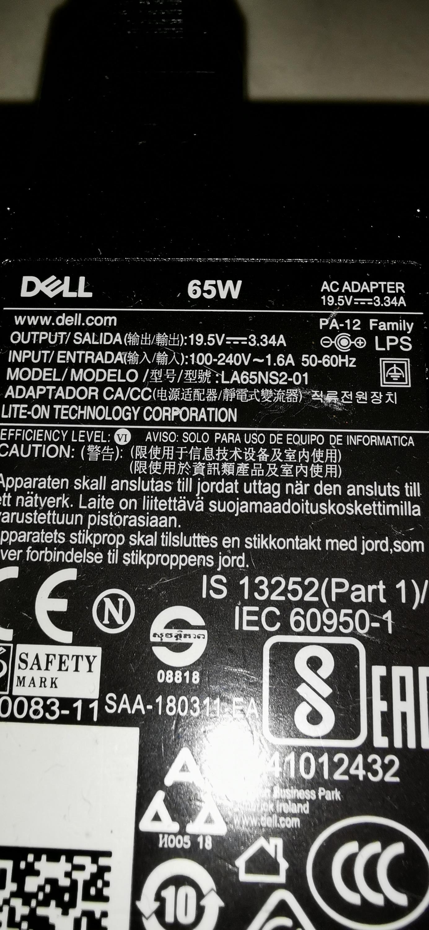

    3) To simulate the heated element leakage, can I use a laptop adapter as power source and wire a light bulb to see if it lights up?

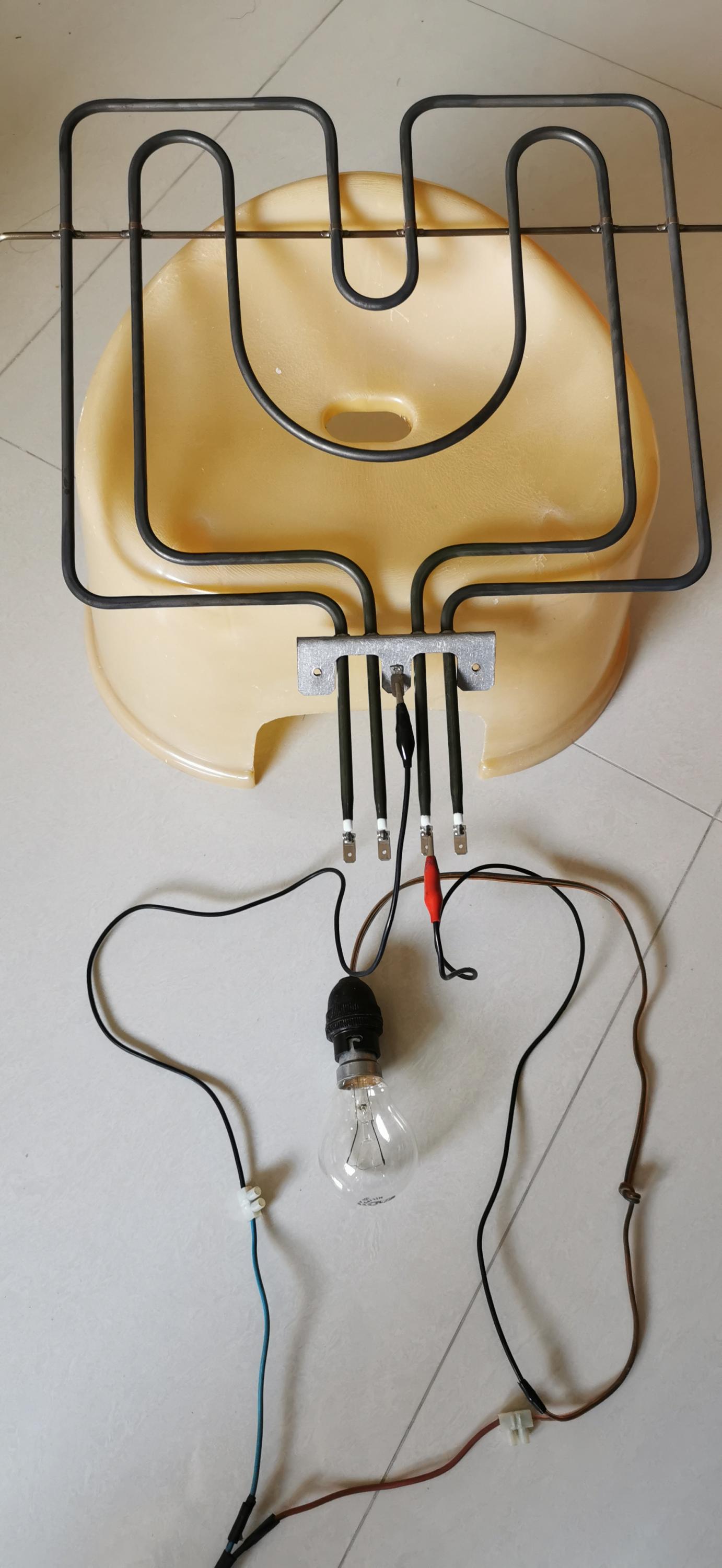

              Another way you could do it but you must be very careful doing this is the disclaimer
              Take a 100 watt light bulb and one wire to the element the other end of wire to outer case of the element and going to do this as follows
              Line side —— one wire to the light bulb — — the other end of light bulb wire to the element terminal — — another wire goes to the outer case of the element —— and then to the neutral side of the plug
              Under no circumstances should you touch any part of the element with it plugged into the outlet you could get electrical shock or worse
              PLEASE be careful doing this test I do not want to see any one get hurt doing this test
              When doing this test you should not see the light bulb light at all if it does the element is bad

                  I have done the light bulb test according to your wiring scheme - no light.
                  I am guessing it would probably only light up when the element is heated up...

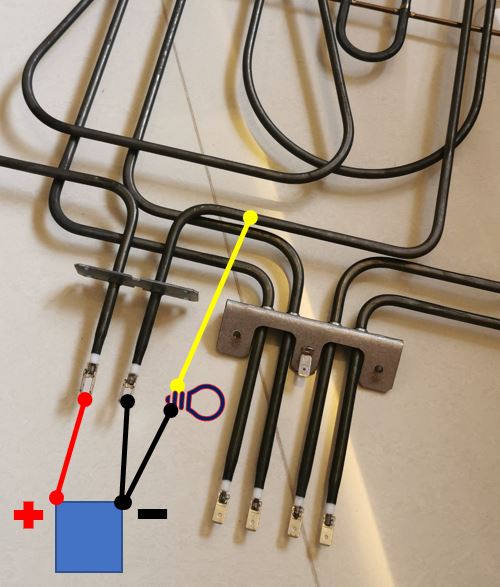

                  Is it safe redo this test by heat up the element by adding another wire connecting the other terminal to neutral?

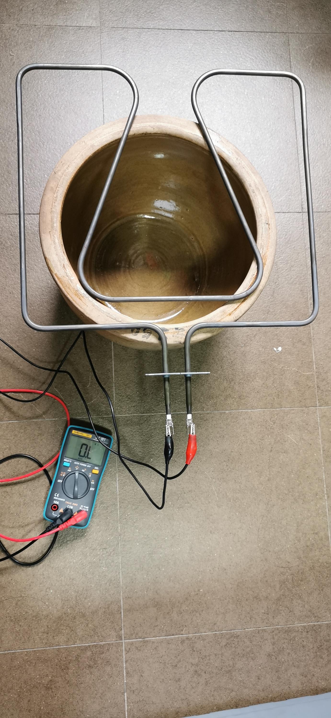

                    OK. I didn't re-do the bulb test, but simply heating the element to measure the resistance.
                    To be safe, I put the element on the clay pot on a ceramic tile floor, wore a rubber gloves and rubber shoes. I turned on the power for few seconds at first, then left on for ~30 seconds then switched it off. The element didn't grow red but can smell the heat.
                    I then measure resistance between terminal and the outer shell - it fluctuated a lot for 20-30 seconds, stabilized ~60K Ohms.
                    Not sure at this level it will already trip the power, but most likely as the temperature goes up further, it eventually will.

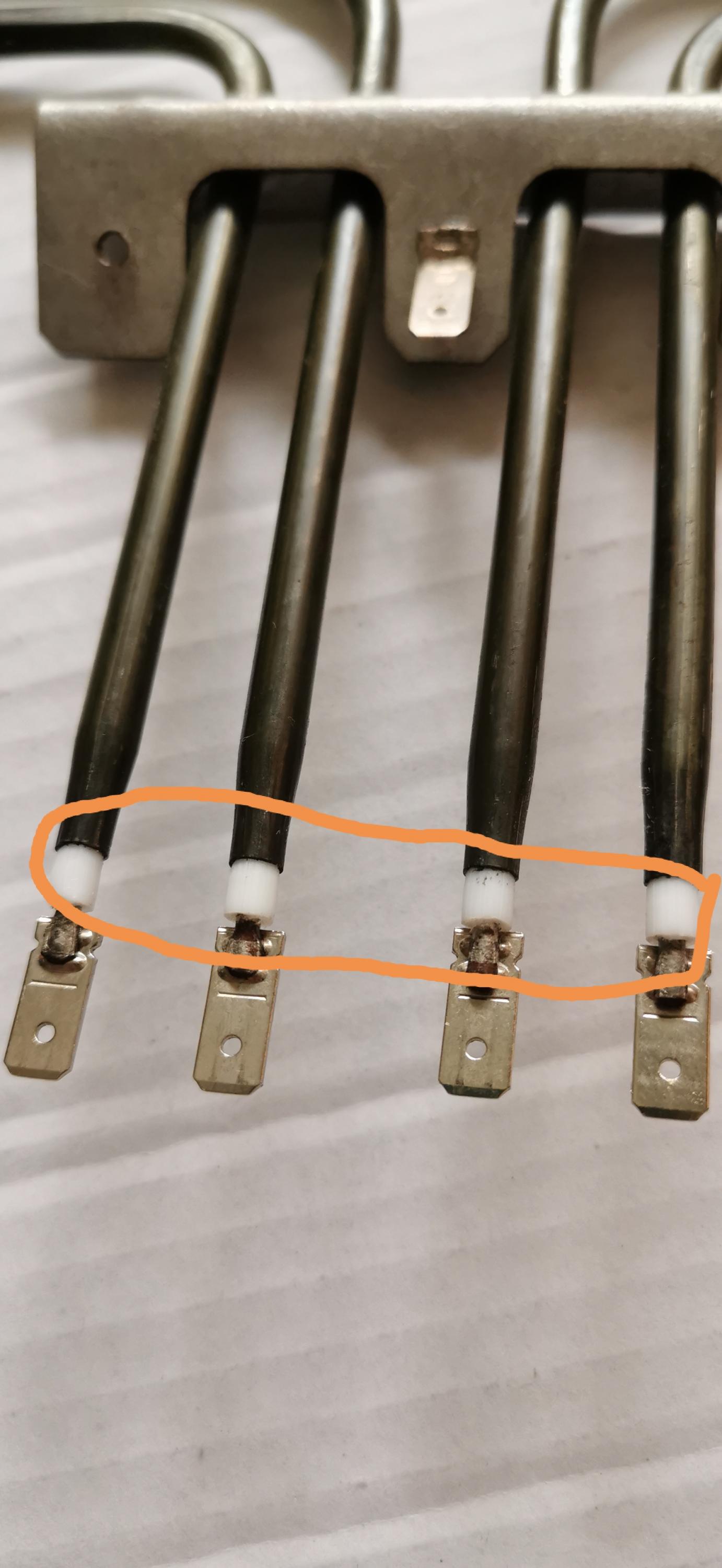

                                  If you look at the element ( every inch of it ) with a magnifying glass you might see a place where there is a hair line crack or pitting in the outer shell this caused by hot liquid spilling on the element
                                  This is also an indication of the element bad or going bad
