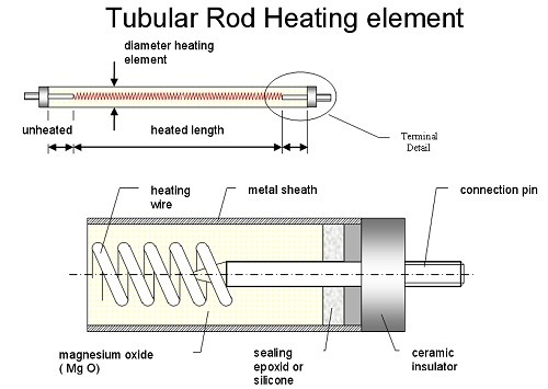

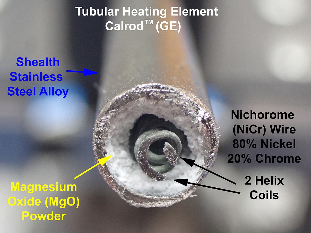

          I think there is a ground-fault within one of the heating elements.
          Oven heating elements are in a metal tube with magnesium oxide powder for the insulator. The ends have a silicone seal.
          The humidity reasoning is an old wive's tale. It's raining in everyone's oven? Even then, the element stays dry inside and cannot give high leakage current.
          If the wire heating element pushed aside the MgO powder, it would cause a hard short once hot and then vanish after cooling down when the wire contracts.

            When the oven is sit idling for a long time, significant amount of moisture sipped in and absorbed by the magnesium oxide powder via the terminals, or some minor cracks along the outer shell. The moisture does not 'wet' the powder uniformly, and caused some part of the evenly packed power to deform. The 'wet' part expanded and pushing the coil nearer to the edge of the shell. When heated up too quickly, the 'wet' part of the powder expended further and releases gas/vapor at the same time, pushing the already no longer centrally packed heating coil arced nearer or touched the shell, causing the earth leakage.
            This, apparently, also happened to brand new ovens during long shipment via ocean, or brand new oven sitting idle in the showroom.
            The suggested remedies are bake-out: put the elements in another ovens at medium temperature overnight, or passing low voltage over the element.
            Do you think this is a plausible cause and remedies?

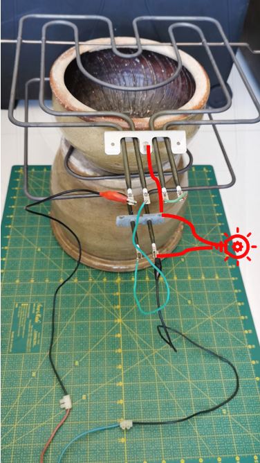

                I was doing a "slow bake". Each element is about 50 Ohms, and drawn about 5 Amps when power up independently. I feel the current is too high, so I connected them in series, total resistance ~150 Ohms, and drawing about 1.7 Amps.
                The elements heated up slower and all is fine. But I can't tell if the elements are drying up well or already shorted...
                So in order to "see" if the elements are still shorting when heated up, can I connect a light bulb between the element brackets and neutral so I know when to stop the baking when it leaks?
                Can anyone help to confirm if this will work, and if so would a 40W incandescent bulb work?
                If this is bad ideas or wiring is wrong, how else can I do this?

                    It has become clear that the element coil touched the outer shell when heated up, and back to normal when cooled.
                    The hypothesis is: the centrally packed coil must have been exposed to moisture, and the magnesium oxide powder that packed it must have been deformed due to moisture (and probably still moist), and allows the coil to bend when heated and touched the outer shell.
                    The test is: to bake the element in order to dry up the powder, and hopefully the dry out powder will once again hold the coil centrally to prevent shorting to the outer shell.

                                    Here's additional test outcomes:
                                    1) In a condone off corner of my living room (in from of my TV and laptop) , I wired up the elements: 3-element-in-series, 2-element-in-series, and 1-element-only.
                                    2) I tested them one at a time, with live, neutral and earth all connected to wall socket.
                                    3) I ran the 3-element-in-series for 1 hour, stopped for 10 min to cool, and repeated one more time. I repeated the same with the 2-element-in-series. All good, no power trip.
                                    4) I then repeat with 1-element-only, but only for 10 minute since it would have tripped in 3-5 minute. As it turned out: the single loop lower element and the inner of the double loop upper element both OK after 10 minutes. The outer loop of upper element tripped in ~3 minutes!
                                    So I have a working lower element, a half working upper element. And a more or less conclusion that baking the long idled elements for 1-2 hours won't fix the issue. I am guessing that baking longer hours might not help either.

                                      I wouldn't do that. Now that you know the bad coil, reassemble the oven with the good coils. Put the bad coil in and bake a low temperature. Obviously don't connect the bad coil, put it on a rack or don't attach the wires.
                                      Edit: make sure you tape off any bare ends so they don't contact the case or anything else.
