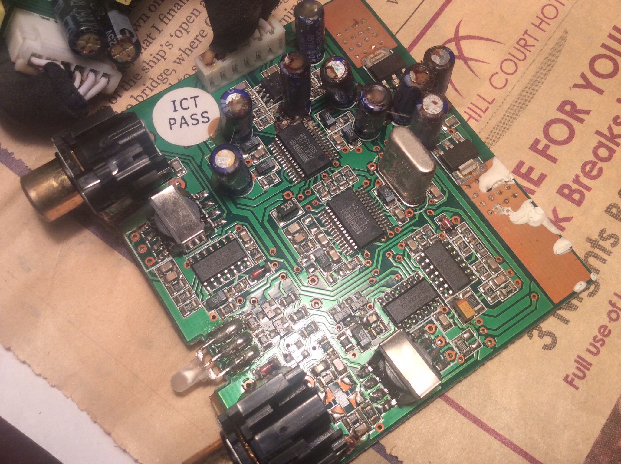

                                    • waveform
                                      • Mar 2016
                                      • 5
                                      • Ireland
                                      #78
                                      Re: Tannoy Reveal 6D
                                      Thanks a lot for this thread Midibob!
                                      I'm also embarking on my adventure to repair my Reveal 6D.
                                      It was making crackling sounds every so often until one day it got worse and the power LED went off.
                                      I'm wondering if you had to desolder any components to clean the brown glue underneath them i.e. Between the component and PCB?
                                      If anyone has suggestions on how to tackle my board from the pics, i'd really appreciate it, especially on how to clean caps with brown glue on top, or if i should replace them.

                                        #79
                                        Trying to upload multiple images from an ipad is never a good idea! Here they are:
                                        • waveform
                                          • Mar 2016
                                          • 5
                                          • Ireland
                                          #80
                                          Too small, 3rd time's the charm!
