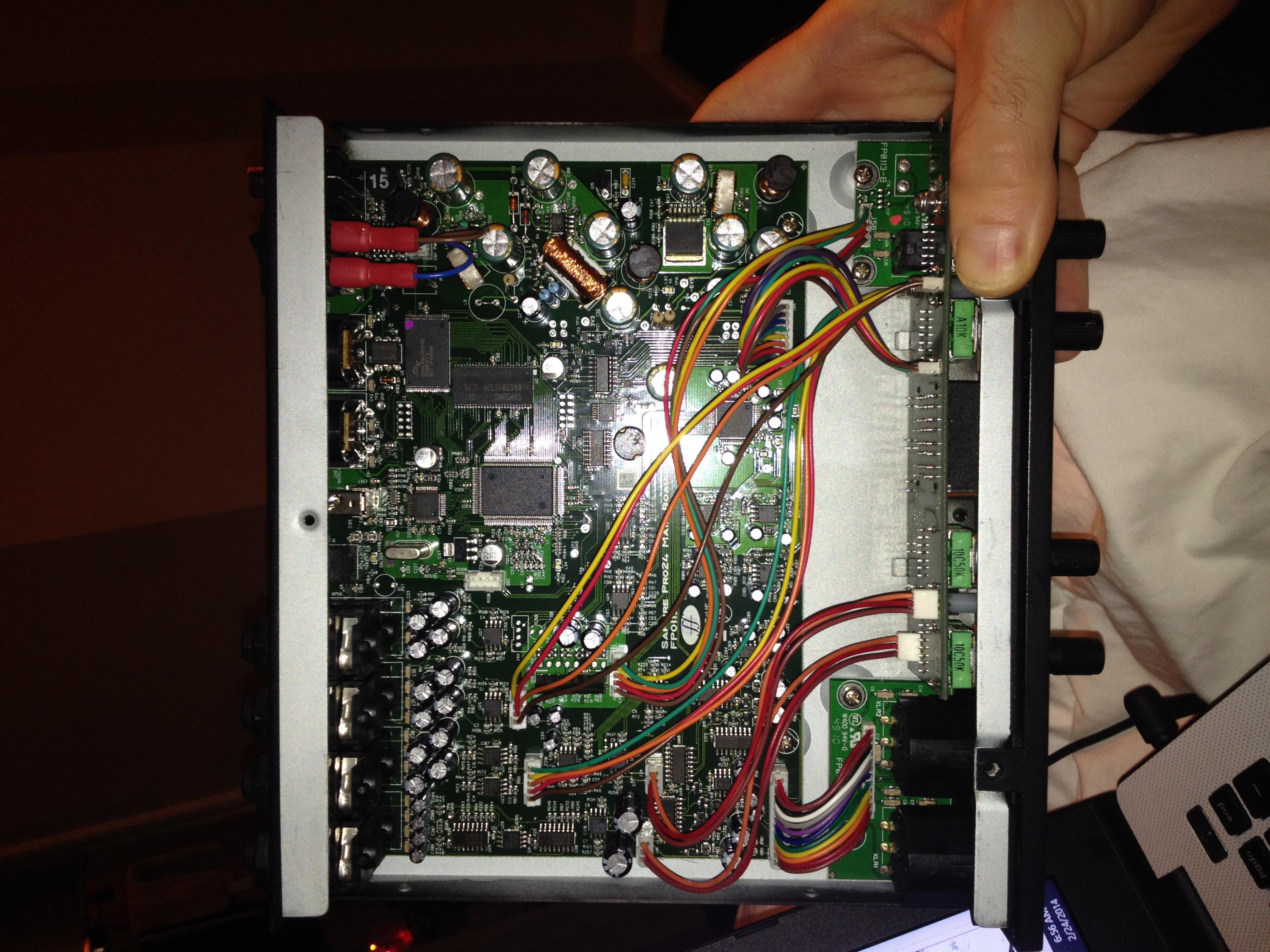

                                #55
                                Re: Focusrite Saffire Pro 40 re-cap
                                everyone, this is my first post here. I have a Saffire Pro 24 that has the same OpAmps you guys have in the 40.
                                I'm planning on doing the mods. Is there any BurrBrown chips I could use for the opamps that would fit instead of the LM? I know BLA mods the Saffire and they use BurrBrown chips.
                                I also checked out the AD/DA chip.
                                Also noticed the CapXon caps, those are coming out!

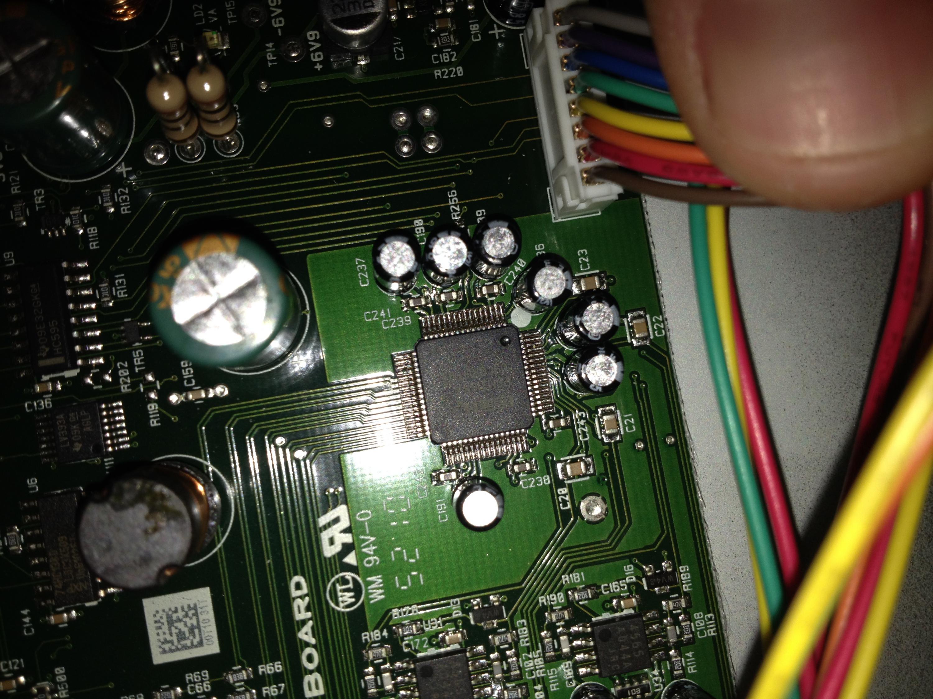

                                          #60
                                          Here are the caps around the AD/DA chip. They are all 10uF/16V.
                                          I'm wondering what I should change these to?
