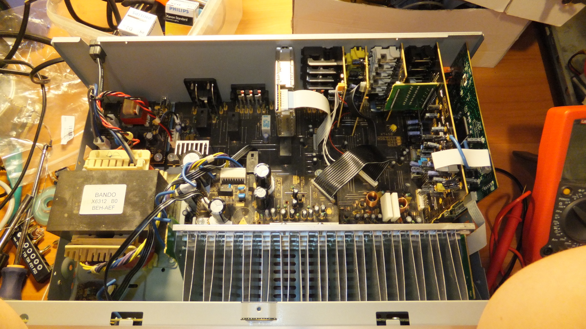

    I got this amplifier, it turns on, lcd displays for a second or two and then relay clicks and it turns off. Clearly goes to protection mode.
    I got to diagnostics mode and it says "DC PRT 100% E" which means "DC output of the power amplifier is abnormal." aka overvoltage.
    "Turning on the power without correcting the abnormality
    will cause the protection function to work 3 seconds later
    and the power supply will be shut off."
    Can anyone help me with troubleshooting this? Any common faults in these models? Thanks in advance.
    I have ESR meter, soon two oscilloscopes (just waiting for probes to come in mail) and multimeter ofcourse. Just not too much hands-on experience.

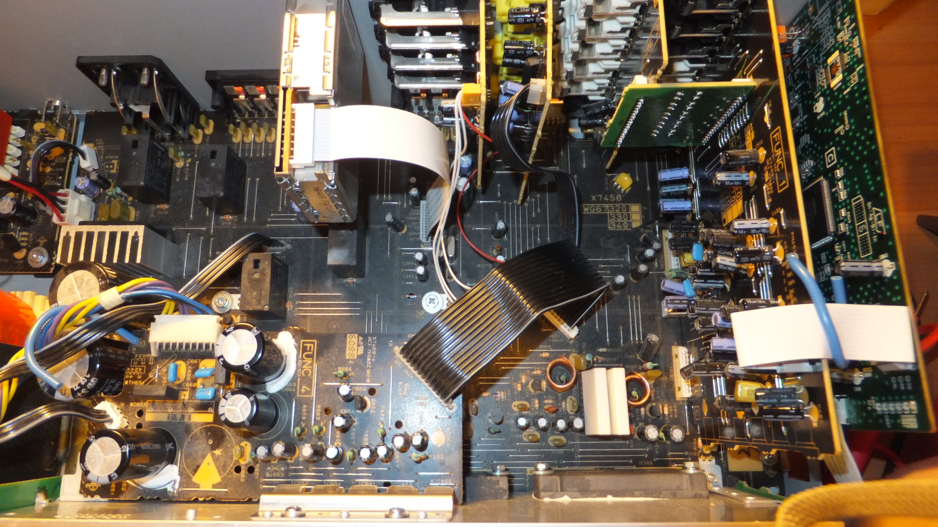

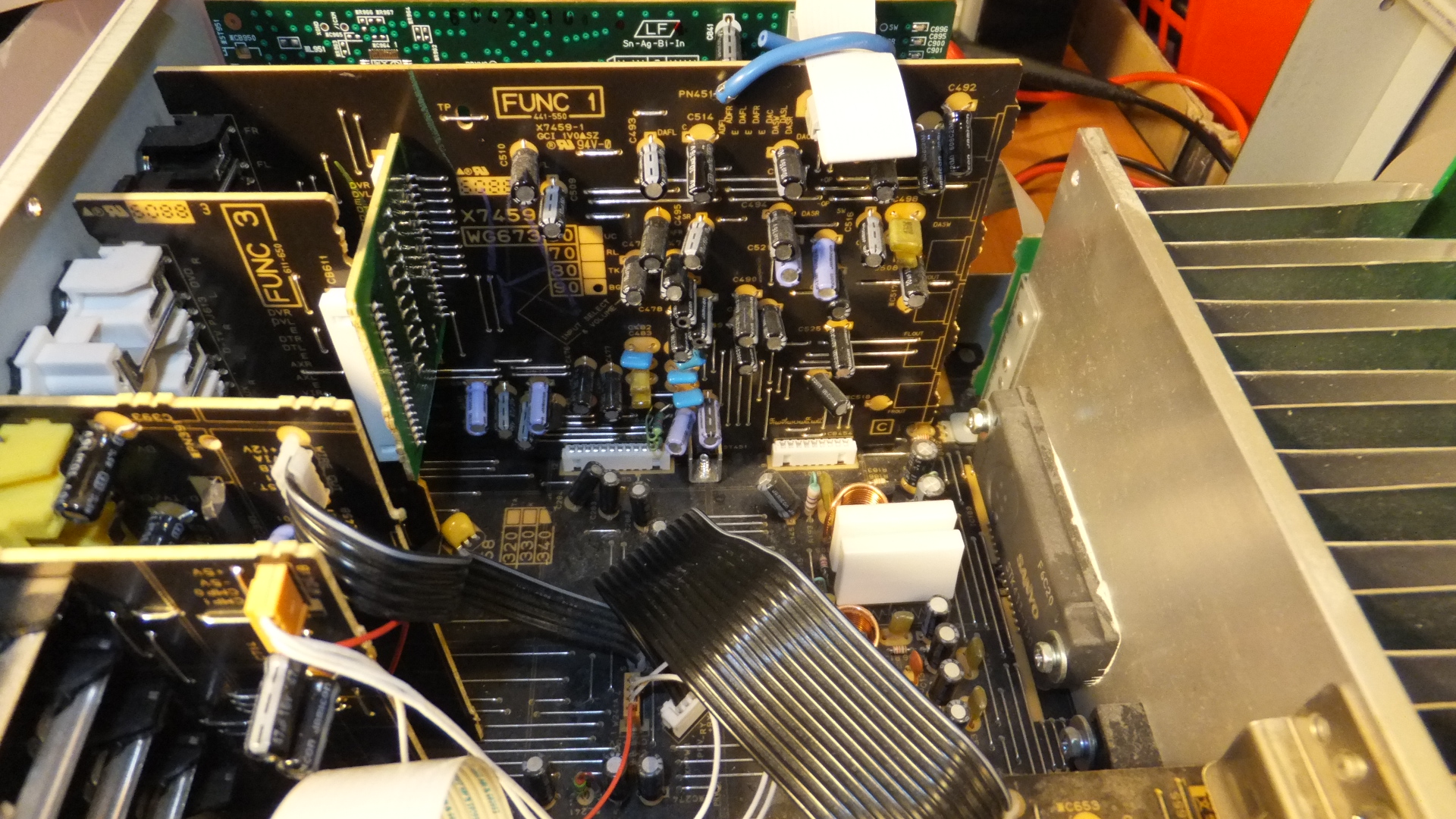

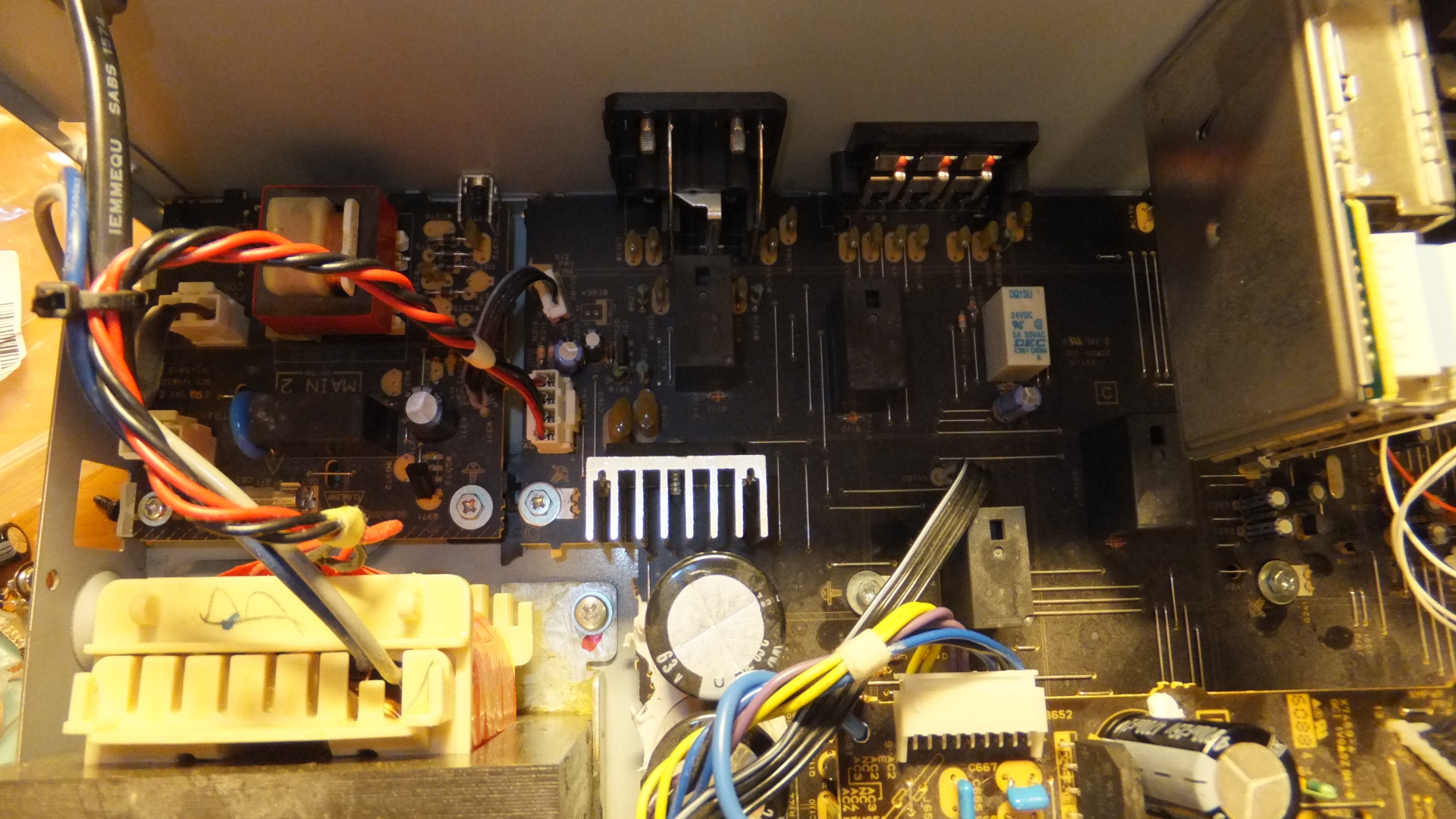

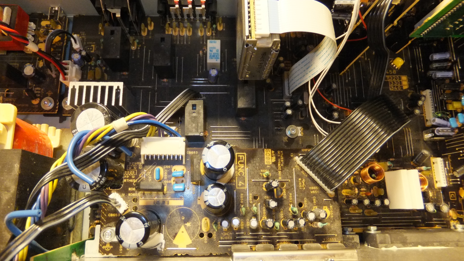

    Some pictures.

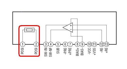

                              Re: Yamaha RX-V359 troubleshooting, turns on and off
                              Do the input pins read 2V too?
                                So this is what I measured:
                                Pin 1: 0,4V
                                Pin 2: 0V
                                Pin 3: 1V
                                Pin 4: 2V
                                Pin 5: 0V
                                Pin 6: 0,6V
                                Pin 7: 12V
                                Pin 8: 3,1V
                                Pin 9: 0,9V
                                Pin 10: -52,3V
                                Pin 11: 52,3V
                                Pin 12: 2V
                                Pin 13: 2V
                                  Pin 1: 0,4V
                                  Pin 2: 0V
                                  Pin 3: 1V
                                  Pin 4: 2V
                                  Pin 5: 0V
                                  Pin 6: 0,6V
                                  Pin 7: 12V
                                  Pin 8: 3,1V
                                  Pin 9: 0,9V
                                  Pin 10: -52,3V
                                  Pin 11: 52,3V
                                  Pin 12: 2V
                                  Pin 13: 2V
                                  I would expect pin 6 to have a much higher voltage. Check for a resistor applying rail voltage to it.
                                    Input pins 3 and 4 should not have any d.c. voltage on them. Pin 6 is missing the -49 volts (check Q109 and R144. Pin 8 is high. Check Q106 and R119. Is it possible that traces cracked during IC replacement? Assume that the stray piece of wire took out a number of other parts, which are directly connected to the output IC.
