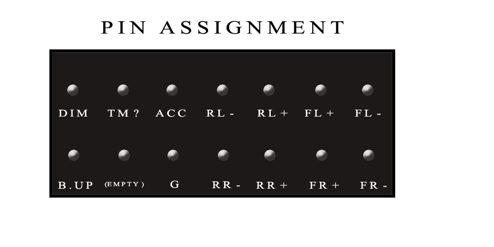

    Now what I would like to do is test the unit in my house but IOT do this I need to power the unit. I was thinking of using a 12v lawn tractor battery and was hoping for some instruction in how to do this safely.

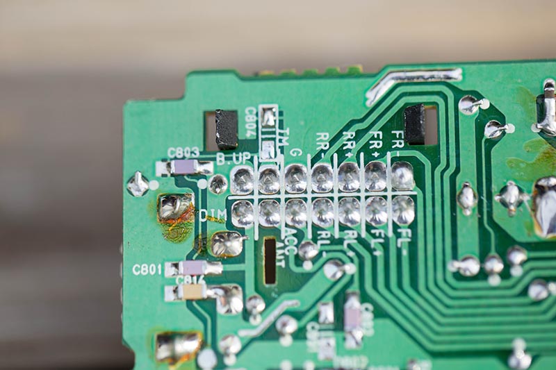

    I managed to find the pin assignment on the back of the PC Board (Yeah!!). If anyone knows what TM means please let me know.

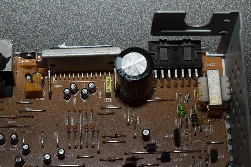

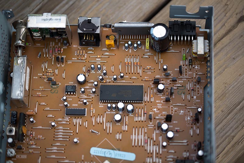

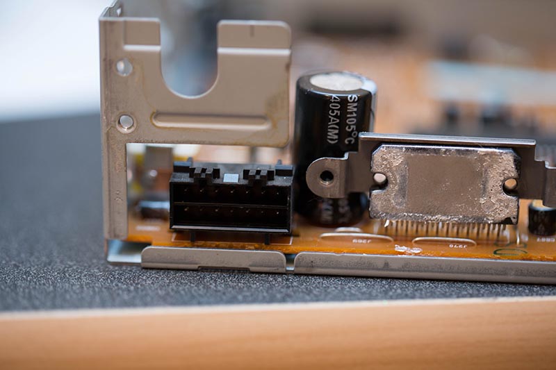

    Here are some pics of the stereo unit.
    My questions are:
    • How do I connect the 12v power supply to the power pin on the stereo? I cannot find a connector that I can use. Is there somewhere to purchase a proper connector?
    • Where do I ground this to complete the circuit?
    • Is there anyway to test the speaker outputs without powering the stereo?
    • Which pin is power I thought ACC but I read somewhere that ACC = Accessories?

    You won't be doing any testing w/o a heatsink, I hope.
    Ohm out the four spkr ckts by measuring at the connector that plugs into the stereo.

        There's a large multipin IC with 4 small caps next to it. I suspected that it was a 4 channel BTL audio power amp. But with those readings, I'm not sure at the moment...
        If it is a power amp, you'll have to put it back in its chassis so it won't over heat.

            Hi Kaboom,
            This is a pretty basic stock radio (Clarion HCD5064) from a Hyundai Santa Fe 2003. Its rated for 100 Watts max - 25 W per channel. Actually the space by that IC is covered by a CD player which I removed to be able to see the board. So I'm guessing heat isn't a problem.
            Do you get a reading from any of those eight "speaker" leads to the body of the automobile?
            I would have to put the unit back together and stick it back into the auto. So what you want me to do is put all the wiring back to normal and then stick one of the VOM probes into a speaker output wire from the back of the stereo and touch the other probe to the car chassis - measuring Ohms or Voltage? Does it matter which probe goes where?
            Also, if the amp is working properly, you'll have 6-7VDC from both speaker leads (at the speakers) to chassis GND.

                Re: Help With Troubleshooting Car Stereo (Speaker) Problem
                Hi Kaboom,
                I will try that tomorrow.
                Would you know what the pins marked B.UP and TM means?
                  B.UP is likely fed from a constant 12V supply (hot w/ key off) for the clock and memory power.
                  TM may be a switched 12V or signal, active whenever the radio is on, for "power antenna" or "amplifier remote-turn-on" purposes. I can't tell for sure...
                  That tabbed device most certainly is a power IC. There's remnants of thermal compound.
                    Originally posted by General_T View Post
                    I measured the outputs for the 4 speakers
                    You measure the pins on the board, didn't you?
                    All 4 speakers showed 122 ohms.
                    I think you measured this on the board, not by probing the wiring harness.
                    Get some clips and small wires that fit into the harness and measure the four pairs of speaker wires. Have the meter set for voltage first, in case you accidently transpose your connections! At least one of those pins has power at all times.
                    You want to measure the speakers, not the amp at this point. Ring out all four speaker ckts, right from the 14-pin plug.

                      Hi Kaboom,
                      Yes, your right I checked the resistance on the PC Board vice the vehicle.
                      I did as you suggested and measured the resistance at the cables in the truck and as you were thinking there is an anomally.
                      3 of the 4 speakers measured 4 ohms but the suspect speaker (Front Left) measured around 2 million ohms. Is this a pretty good indicator that one or both of the wires are grounded out somewhere in the vehicle?
