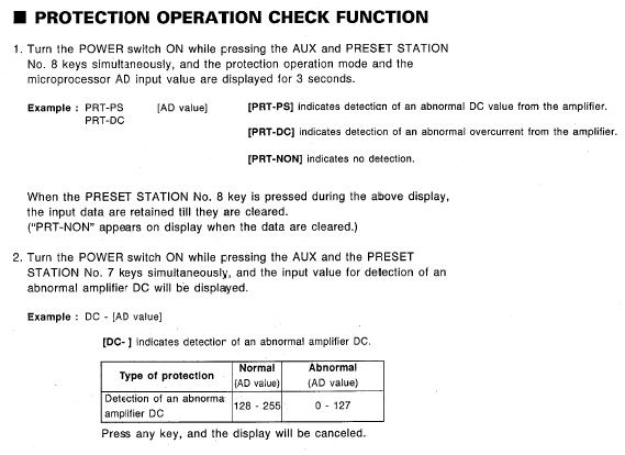

    Diags: trying out the Protection Circuit check steps from the manual....
    Holding AUX, Preset 8, and Power shows code: PRT-PS
    (indicates detection of abnormal DC value from amplifier)
    Holding AUX, Preset 7, and power shows code: DC-000
    Is that telling me the main transformer isnt putting out any DC?
    Not sure what to/do check next.

            BTW, the PROTECTION OPERATION CHECK FUNCTION has to do with AMPLIFIER DC at the outputs.
