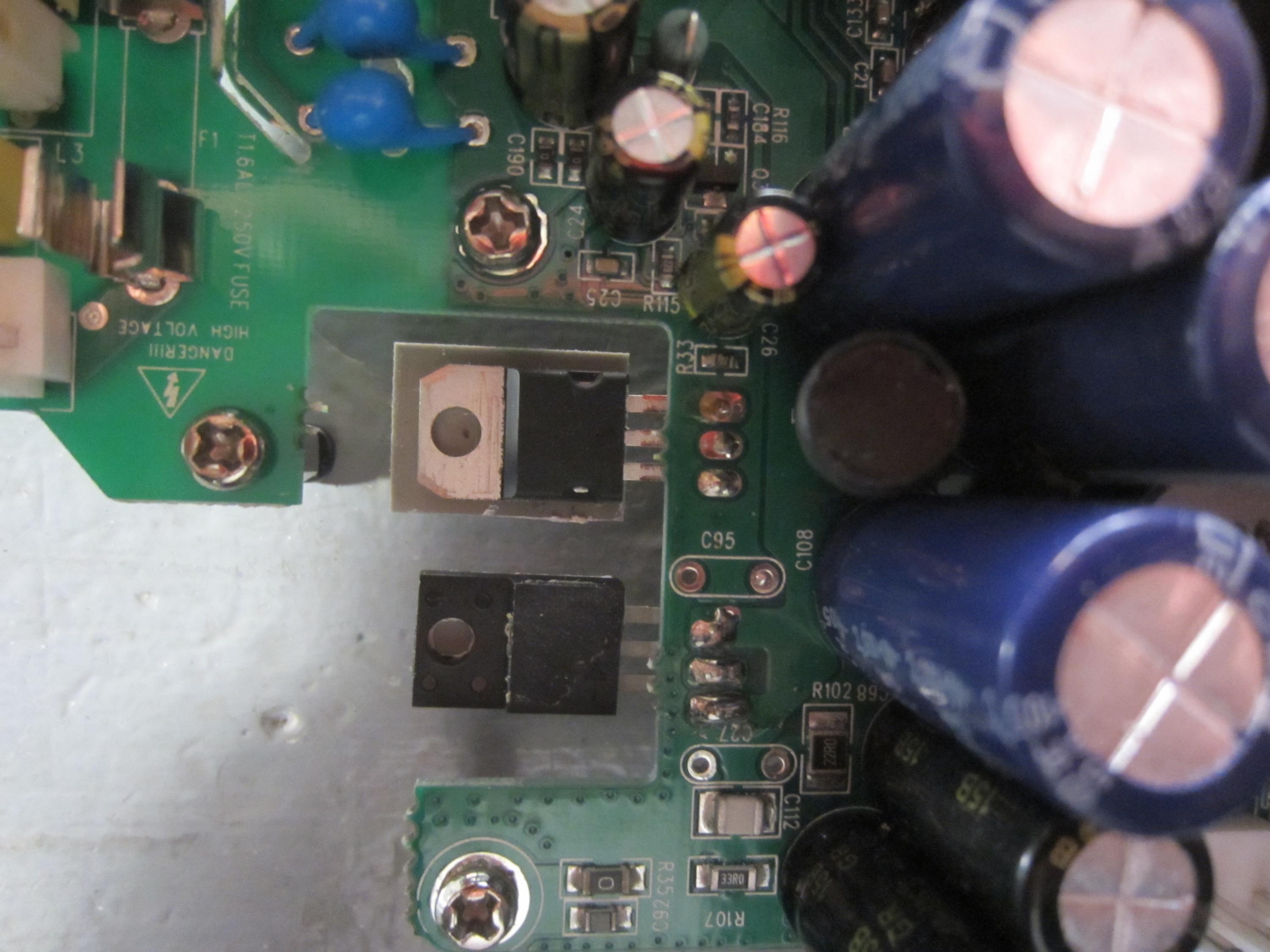

    Originally posted by ZOrd_Z
    It's a smd close to the primary big cap.
    That diode is D5, is labeled S3M and its marking strip is on the right side as in your picture, away from the transformer. I can post a picture tomorrow.
    Somewhere back on this thread, someone posted a partial scheme and the diode is on it, also marked S3M.

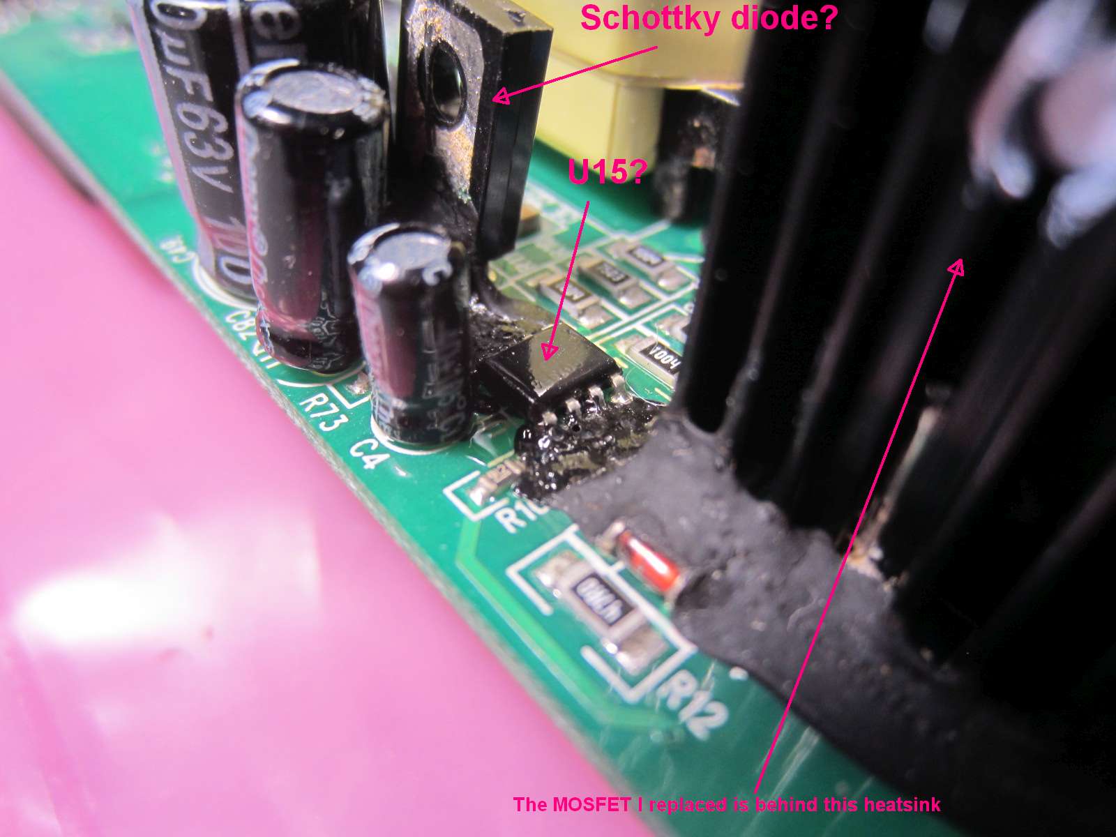

        Originally posted by nekken
        i have tons of resistors and capacitors that have been shorted due to U15 blowing out (and so did the bridge rectifier, the shotkey diode right near it).
        I feel with you.
        As I posted last fall, my pcb blows fuses and I found that the MOSFET (10n60nz) on that big heatsink is shorted. I replaced it and when I powered up, the fuse held and I wanted to check if I am actually sending power in past the fuse and went to touch one meter probe to the solder point under the power connector and just as I touched it, it blew like if you short 120V AC. But it wasn't my doing, that replaced MOSFET blew up, shorted again. My hope for the board lasted all of one minute.
        Obviously something else is at fault and from your post, it looks like it may well be the U15 and or the diode. Are those the parts I indicate on the picture I just took? There is U1...(the rest is under the goop) next to that flat 8legged thing, it could be that U15 you mentioned.
        I am not too good at repairs like these, identifying parts or measuring on pcb when under power to find out what is wrong. Even the MOSFET I had to look up how to measure on it.
        I suppose I could remove and check the Schottky diode (if I identified it correctly) but I doubt I'd want to attempt to do anything with that U15 part, except maybe measure resistance on its legs. You can see the goop it sits in.
        I make a stab at fixing this board once in a while, if only for the education value LOL (I used to be radio amateur in my teens, tubes and later transistor era, but my practical circuits know-how ended when integrated circuits came in sometimes in 1970s , I lost interest)

          So I checked your picture and U15 is the amplifier board that is underneath (with the heatsink that goes to the back of the chassis) what you are pointing is U1 which is the PWM controller. I don't have a diode as you on my board it is a small Zener Diode the shottky diode was in D15 just near the AC Bridge.
          For my board I now know it is officially dead, i have removed the PSU components to replace the AC Bridge and to my suprise when the bridge blew out it destroyed the 2mm copper pathway. I can't repair this anymore and i am thinking removing all the components (except SMDs) and scan the board so it could help you guys out.

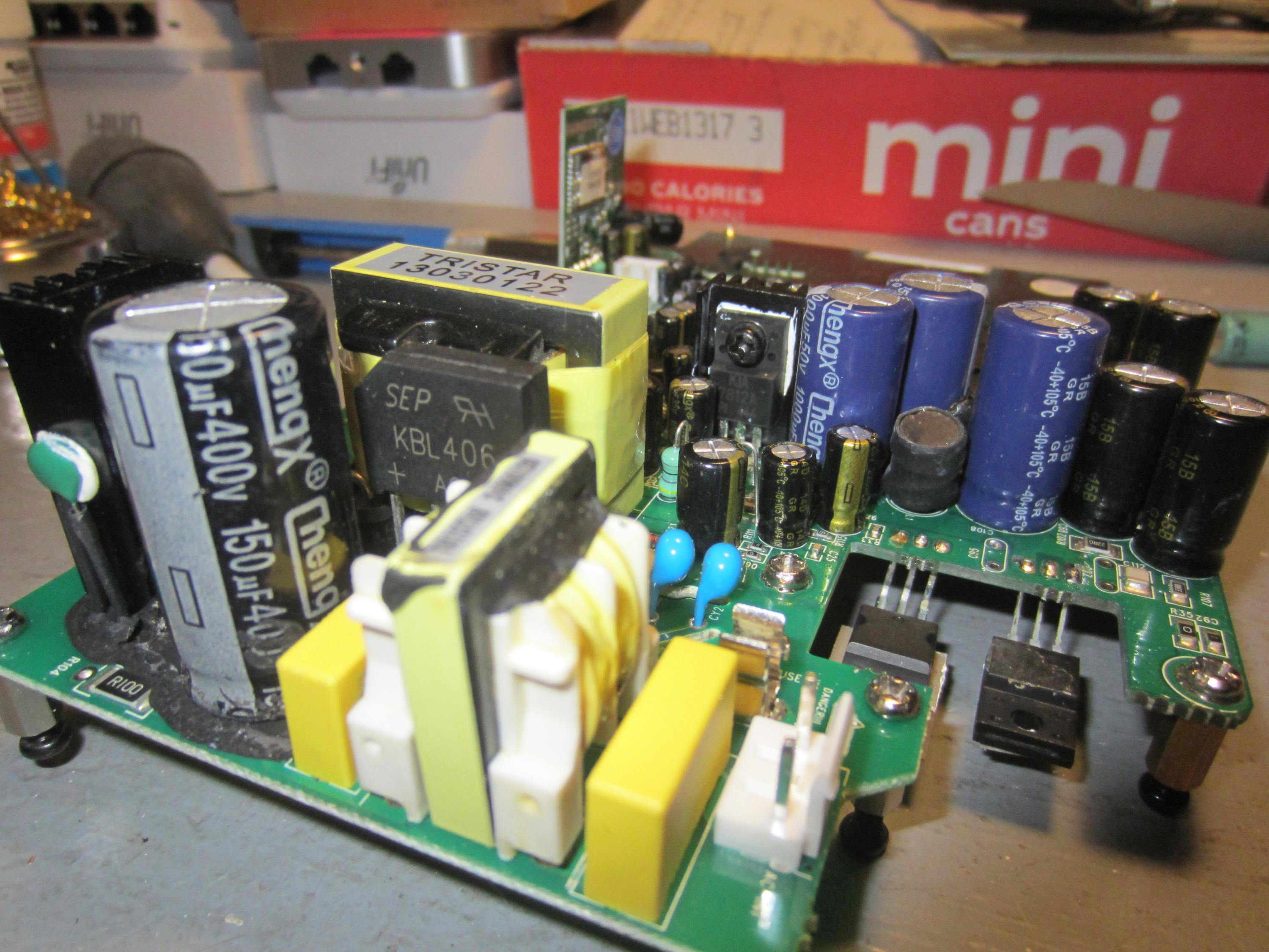

              i have a problem with this marshall stanmore, after repair his power supply and restore 30V i can't read PWM output voltages from TAS5508..i've tried to change it because it's original was burnt and also the PCM1808 but nothing change..can you help me? Vdd and PLL voltages are present..
              Thank you so much
              • Revenge89
                • Nov 2020
                • 3
                • Italia
                #87
                Re: Marshall Stanmore Repair
                Problem solved, i found that PWM IC TAS 5508 didn't work because Master clock MCLK was missing and it was generated by BB DIR9001, changing this one it worked!

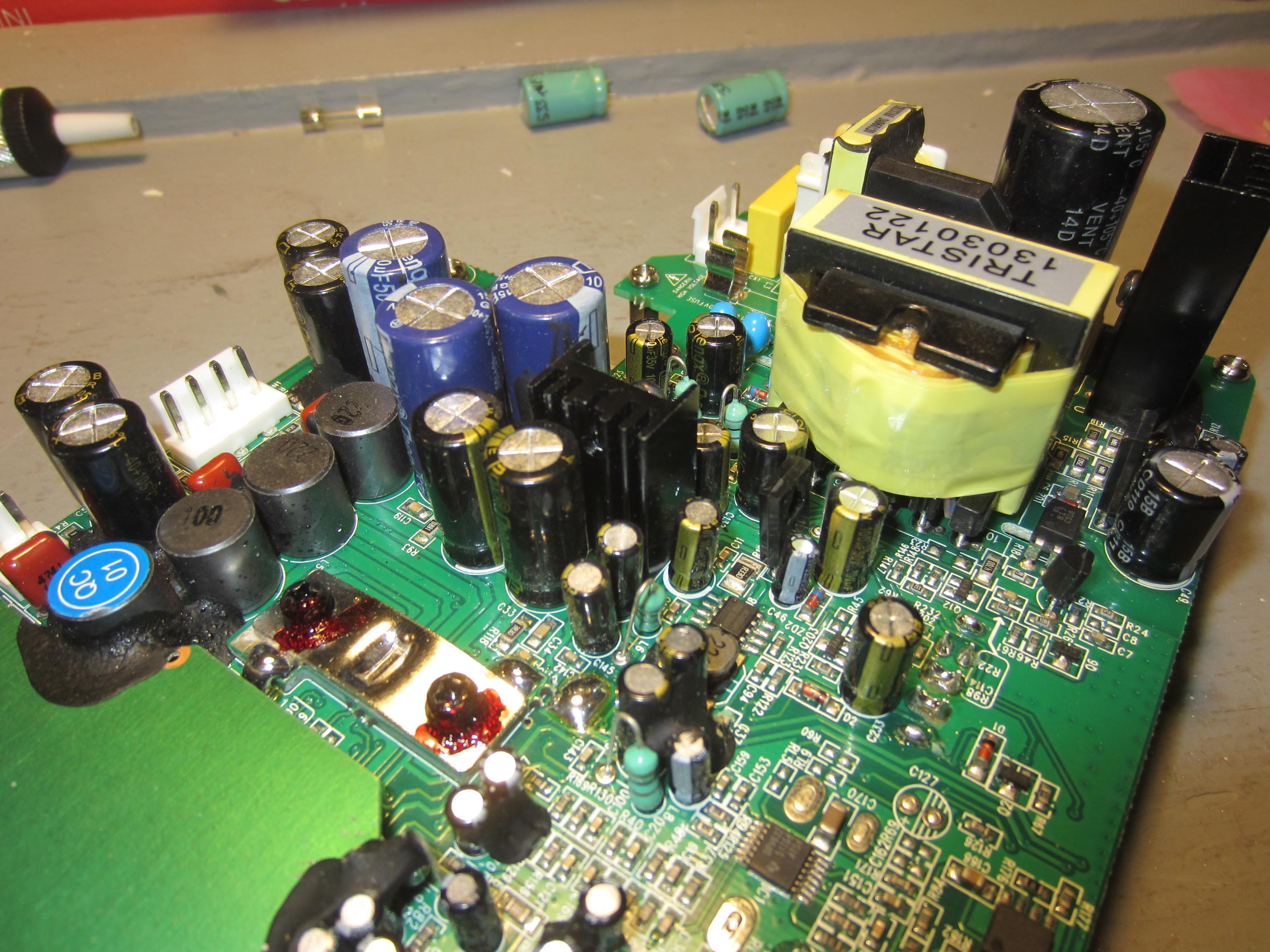

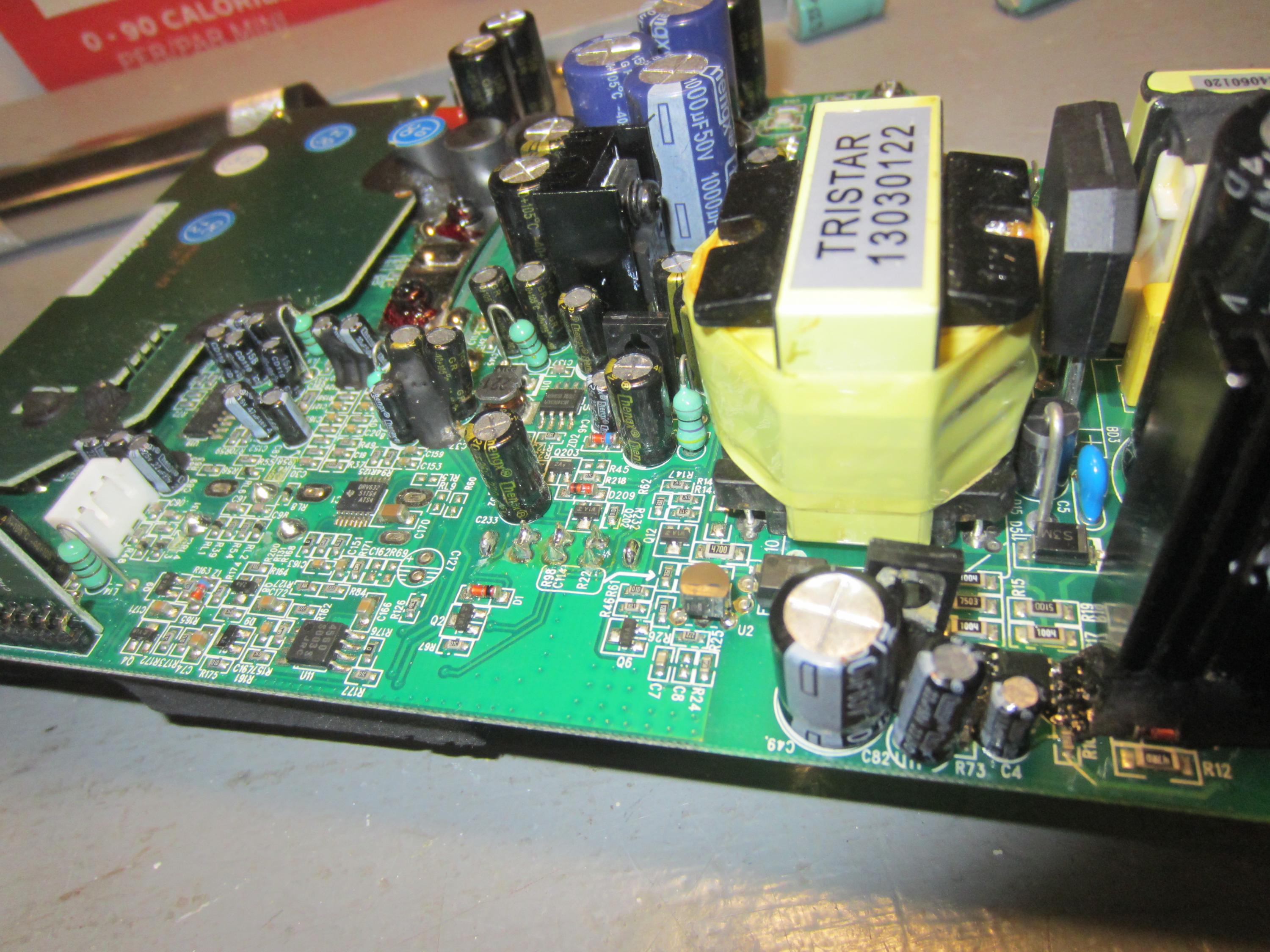

                    I’ve fixed the 31V by replacing the flyback diode (d5?) and the overvoltage protector (d15?). The 7812 does not give any output so that is next. Anyone who knows which dc voltages that are needed. 5V for bluetooth U8?, 3,3 for uC. What is the lm317t for?

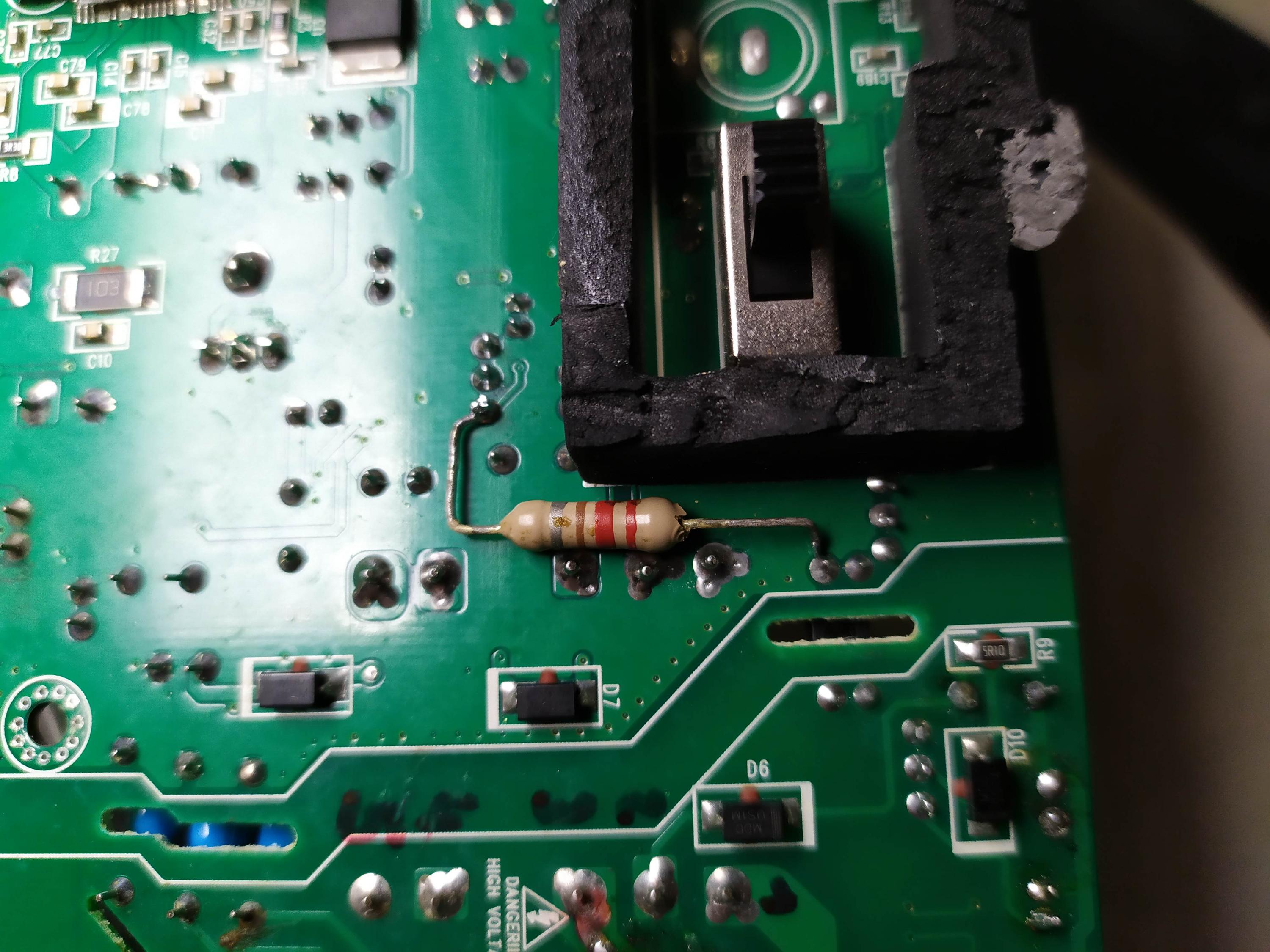

                      #90

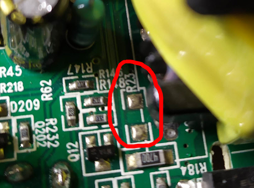

                      It's done !!! Yeahhhh, I've fixed my problem and the Stanmore plays again.

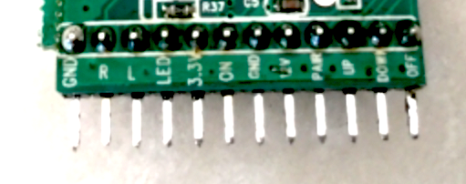

                      First, it's important to distinguish which model you have, for me it's the european one, with the switch "PowerSaver/Standard" at the rear of the box. The importance is that on this PCB, there is no resistor R23.
                      So, as wrote Chris J in the post #62, I put a resistor R23 (220 Ohms) as he did (see the post #62). What a miracle !!!
                      Please, don't replace any other component before soldering this R23 and test.
                      Before I find my solution, with the big help of this thread, I've replaced several components : the diode bridge, Caps C36, C49, the MC34063A, the LM317T and FMG23S, but I'm almost certain it was not necessary.
                      Just add the R23 and see.
                      My symptom was the n°4 explained in the post #1.
                      I really thank Chris J and Hann for their explanations, and hope this will help for many other people.
                      Michel.

                        #91
                        Originally posted by Chris_J
                        Interesting thread. I have replaced the burned R23 (220 ohm) with a bigger resistor underneath the PCB. I have attached a picture so you can see how I have done it.
                        I have also a picture for you who have problems finding the 3.3 uF capacitor.
                        PS still broken but faultfinding is still in progress.
                        Hi. Look like you put resistor to wrong pin on D669AC. Must be on middle pin...

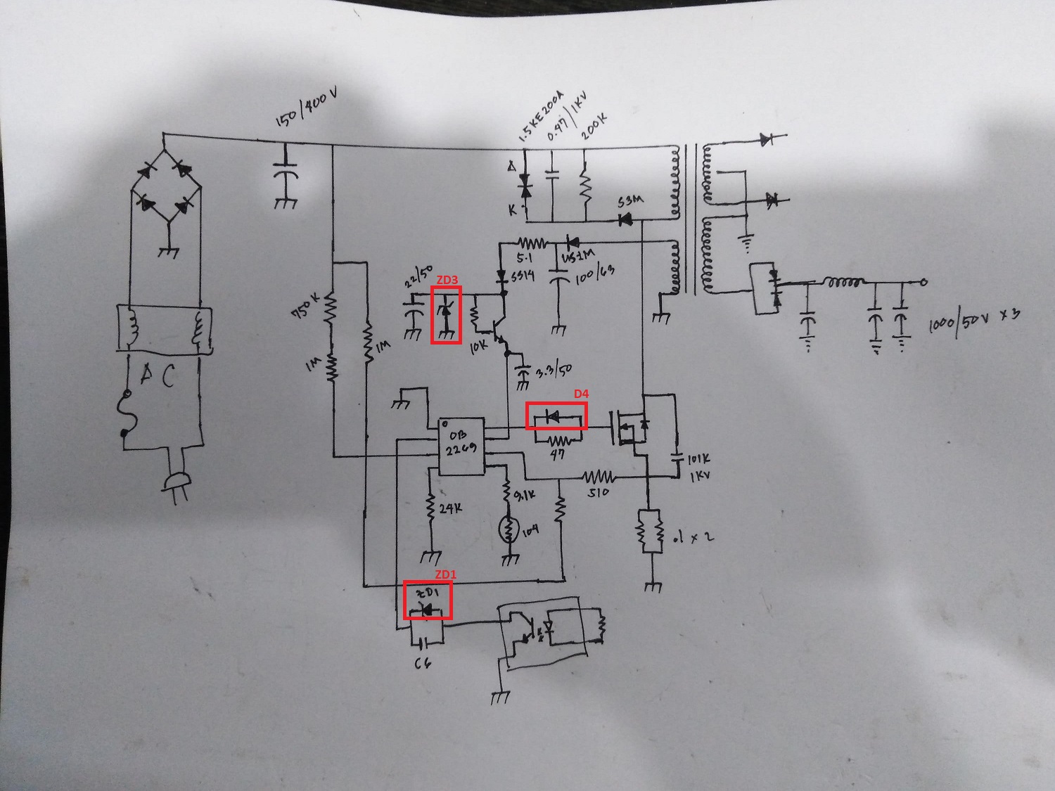

                              Could you please help me identify the following diodes? All of them are shorted. I have also marked them on the attached schematic.
                              ZD1
                              D4
                              ZD3
                              Appreciate your help!

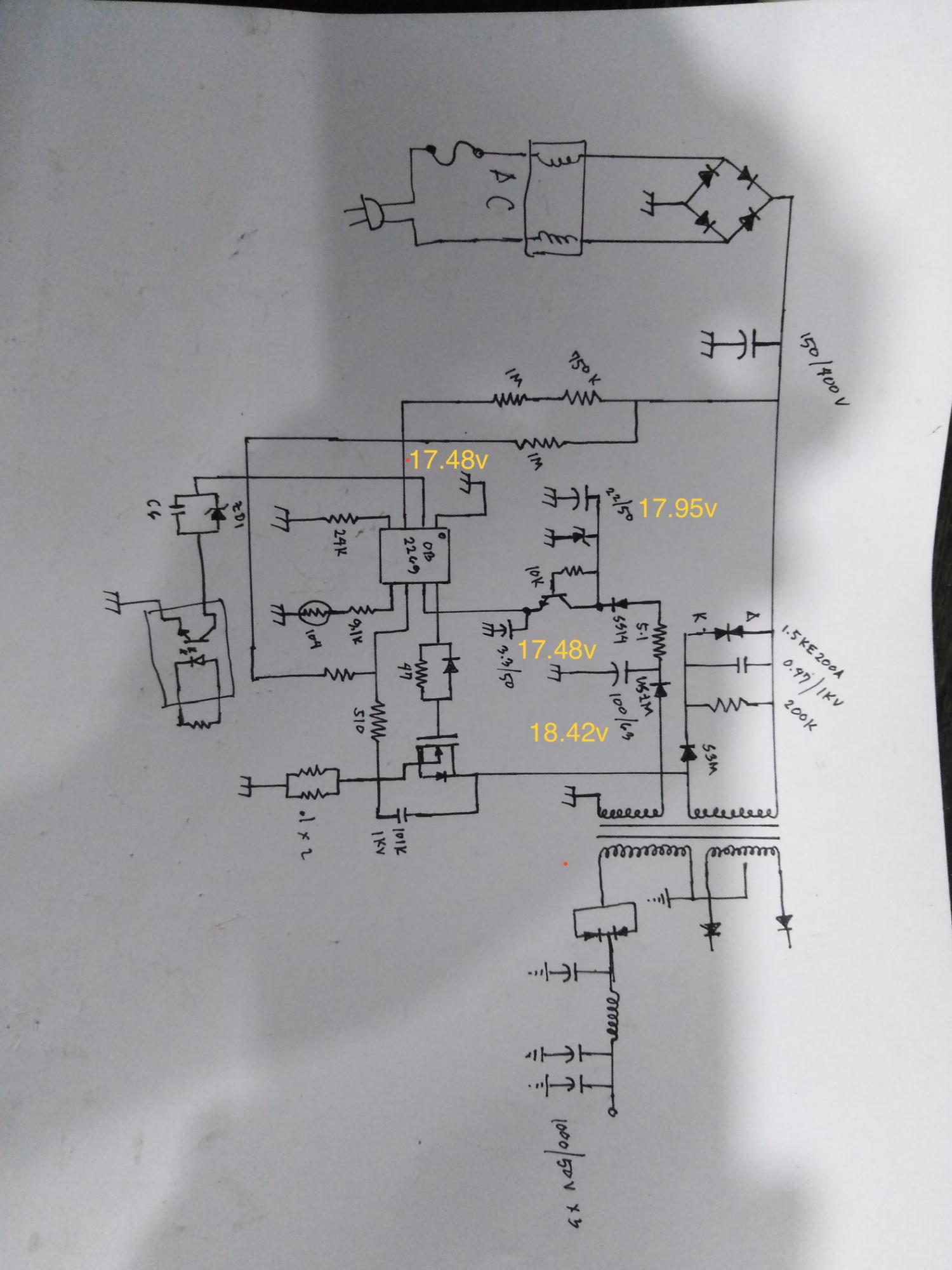

                                #95
                                Old thread, I know..

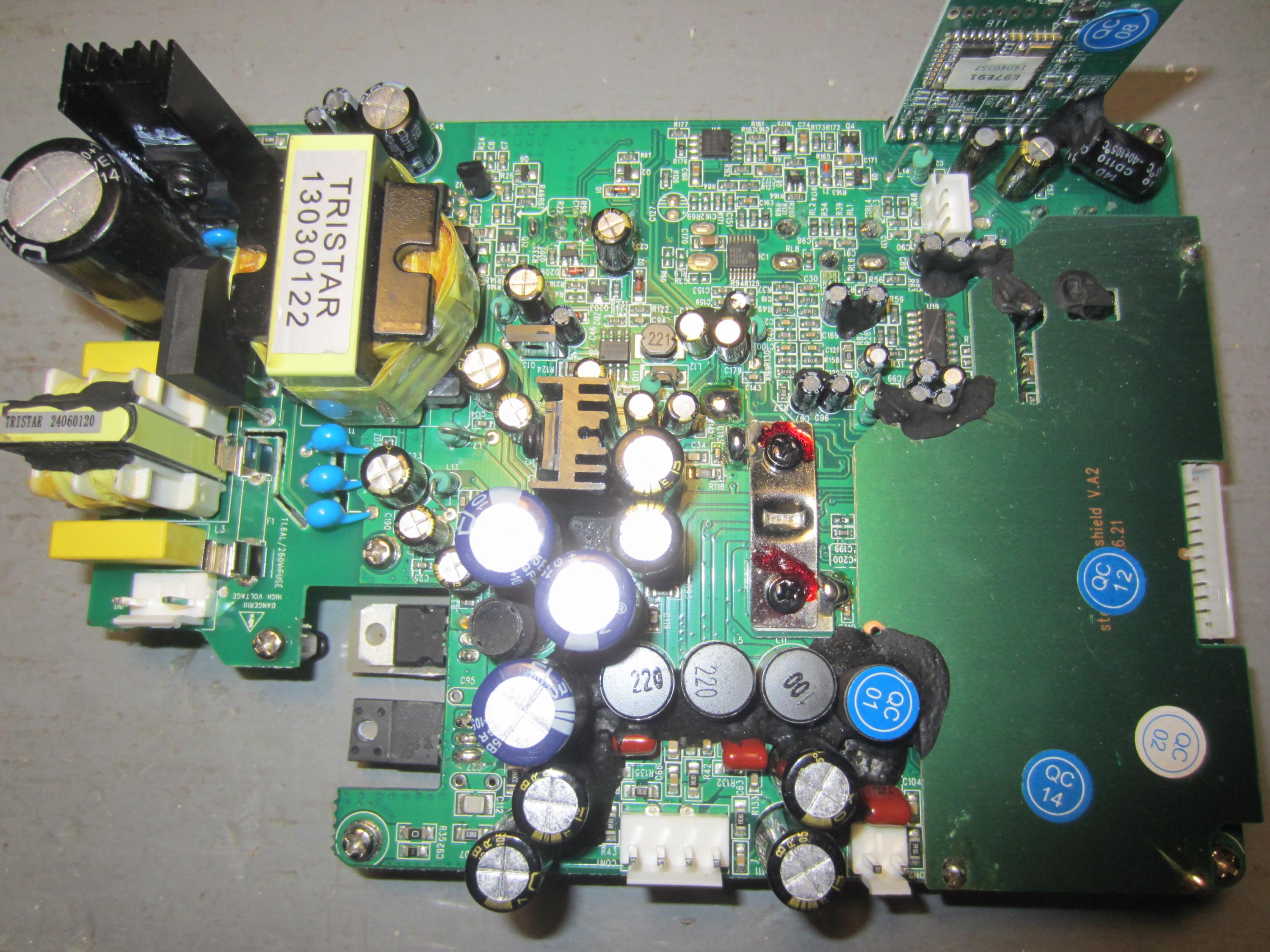

                                I have one of these speakers on my bench.
                                Previous owner said it doesn't power up anymore and last time it did, it took a long time before powering up and then worked for a while until it died completely.
                                I did some measurements like shown on username hann's schematic and found out that 100/63 cap had only 12.3 volts, 3.3/50 had 11.5v, 22/50 had 12.0v and OB2269 pin 3 had 16.68v. Fet drain had full B+ 325 volts. OB2269 looked a little suspicious so I decided to change that and also 3.3/50 cap.
                                Unfortunately it didn't power up after these changes, 'chirping' noise could be heard after switching it on though. Voltage on 100/63 got up to 18 volts, but not the mentioned 30 volts which it should have?
                                So I measured some more and accidentally slipped the probe and shorted Q7 fet! Well… Both .1 resistors burned, fet shorted, ceramic cap 101k shorted, fuse blew and OB2269 shorted. All other components seemed to be/measure ok.
                                Now I've replaced those burned components and also 100/63, 22/50, 3.3/50 and 150/400 caps. Voltages are a bit higher, but still it doesn't power up.
                                OB2669 pin 3 17.48v
                                C4 3.3/50 17.48v
                                C28 22/50 17.95v
                                C49 100/63 18.42v
                                Could it be a faulty transformer? How do I check that?
                                Any help would be appreciated!

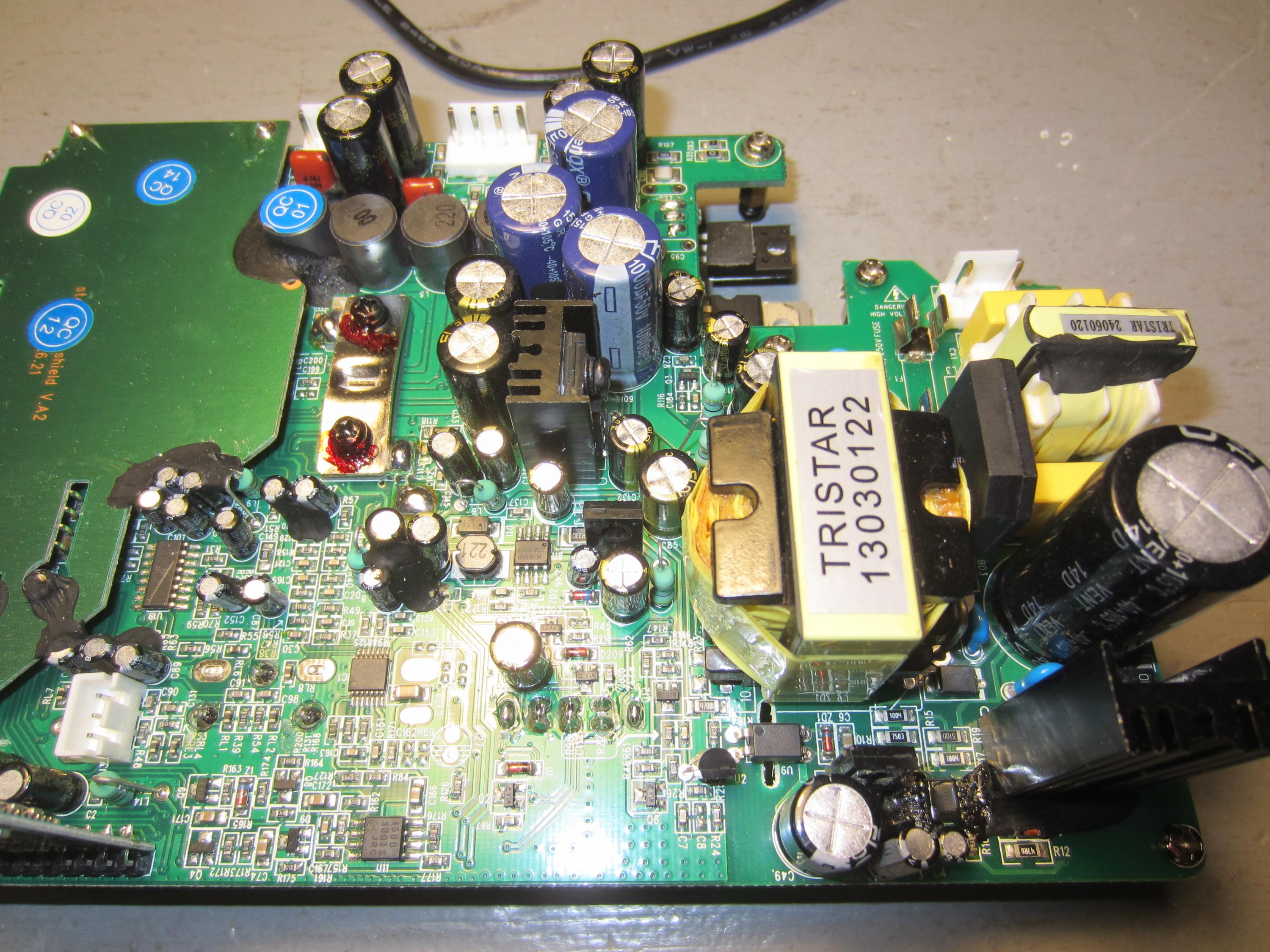

                                • sessingø
                                  • May 2022
                                  • 3
                                  • Danmark
                                  #96
                                  Hi everyone.

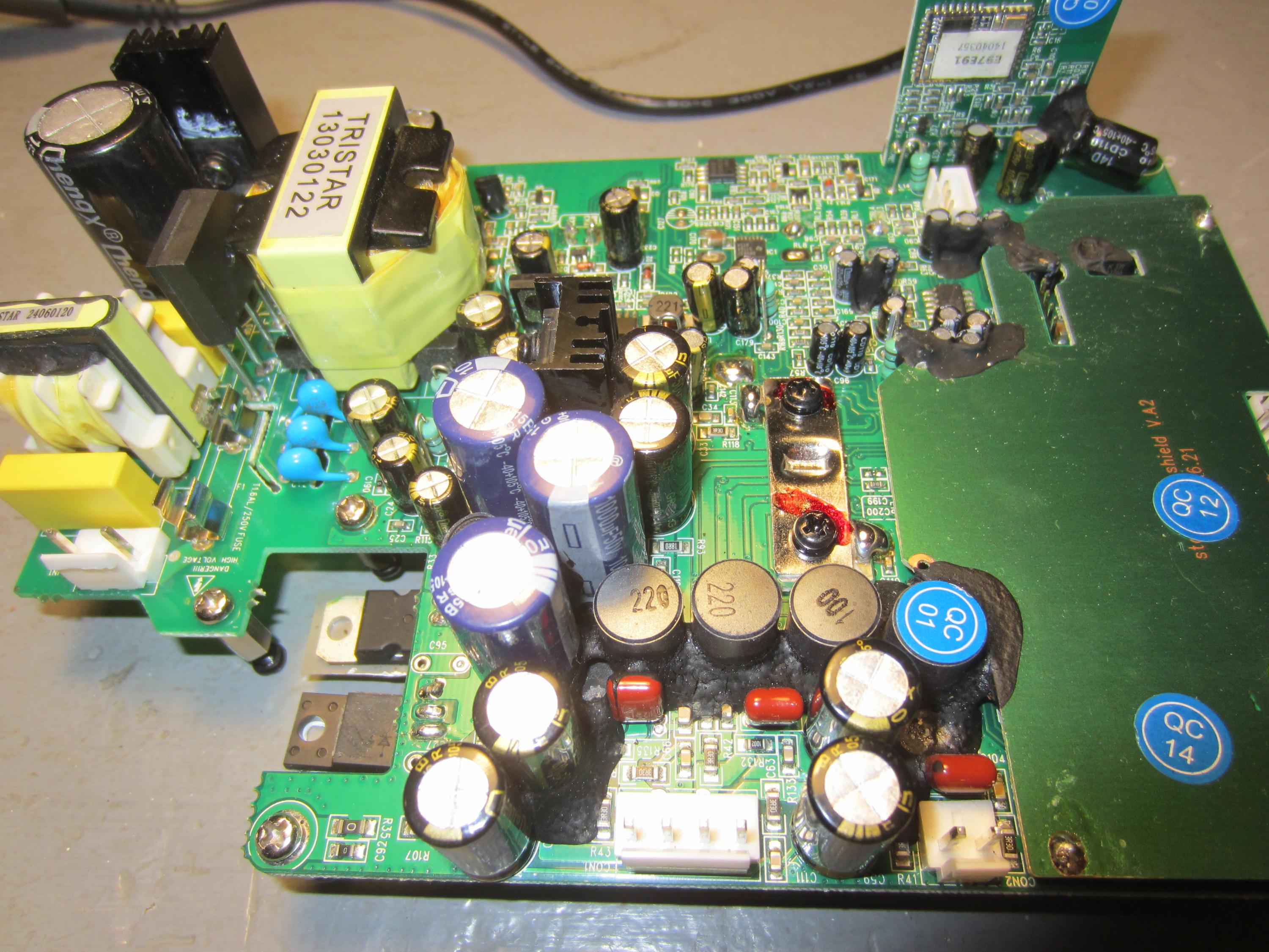

                                  Great thread! Just picked up a marshall stanmore that has a weird problem. It powers on - but every 5-6 seconds a loud static noise comes from the speakers. Volume doesn't seem to work and each time the noise is present the led indicator light will dim like it doesn't have enough power.
                                  I've taken it apart and can faintly hear the noise on the board with only the power connected. It's hard to pinpoint but i think it's coming from one of the transformers or on the hot/power supply side.
                                  I can see two capacitors are bulging at the top c23 and c85 (50v 220uf). I've ordered some up and will try to replace them.
                                  Is there any way to power this unit with a bench power supply. I can't seem to find the correct voltage specs anywhere and i want to make sure im doing it right so i don't create more issues. Where would be the best place to inject DC voltage and bypass the power supply? This way i can be certain the issue is in the hot side.
                                  • sessingø
                                    • May 2022
                                    • 3
                                    • Danmark
                                    #97
                                    I suspect my transformer is bad too. I was thinking about injecting voltage directly into the cold side and bypass the power supply/hot side. Not sure how the best way to approach this is and can't find any information on the TriStar transformer.
                                    • sessingø
                                      • May 2022
                                      • 3
                                      • Danmark
                                      #98
                                      Hell Yeah! I fixed mine by replacing both 220uf caps that was bulging and the 3.2uf capacitor on the hot side. Also added the 200 ohm resistor like recommended by others as my board had the resistor removed from factory.
                                      The board is a pain. Was struggling removing the soldering from the capacitor holes. Found that using hot air and solder sucker worked best for this thick board.
                                      Make sure the connector to the control board is pushed in correctly, the gunk can make it look like it's connected. This was the reason I had no power and NOT the transformer, spent hours pulling out my hair and it turns out the connector wasn't seated properly.
                                      Have a nice day everyone and thanks for the detailed help.

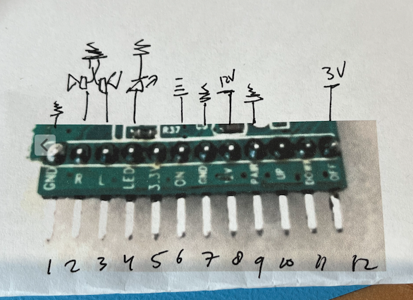

                                          Today I am trying to fix this one from work that has the problem that the bluetooth source is on for a brief moment and then goes off. Everything works but bluetooth.
                                          After Googling, poking around and doing measurements I discovered that the pin mentioned by Jeff should be 3.3V and not 5. That pin leads directly to the bluetooth breakout board and also to MC34063A. That pin on the breakout board is labeled as 3.3V.
                                          I found this site: http://www.sicken.ch/pi/en/Marken/Au...0-e224772.html and after desoldering the bluetooth module I saw exactly the same pinout:
                                          Next step was to see if the module would work standalone so I used a bread board and started playing around:
                                          And lo and behold: it works. I had to connect On to ground (active low obviously) and Off to 3V. Put 3 and 12V to the proper pins, attached a LED and the LED was flashing when powered on. Then I connected Pair to ground (clearly also active low) and on my iPhone I saw the STANMORE speaker in my list! I connected succesfully, the LED stopped flashing and I streamed music. Then I hooked up a speaker to one of the output pins (Left or right) and... music!
                                          So, the next step is figuring out why it doesn't turn on when inside the Stanmore. It looked like the pins received the proper values but now that I know how it should work I can check again when I put it back in the device.
