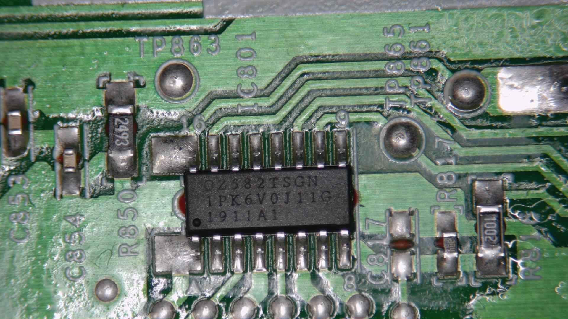

    Hello everyone!
    Please help me to find the equivalent of an IC (LED driver) in monitor BENQ GW2480-B.
    Unfortunately i can't find any datasheet of it.
    the IC number is: OZ582TSGN
    Help me please
    Thanks in advance
    I have same issues with same model of monitor Benq, and no reference about this IC
      BTW i repaired this monitor by removing ic and replaced by two mosfets (one for brightness signal and other for on/off signal) and it worked normally.

            Originally posted by Admin View Post
            I recognize this part series coming from o2micro. I've attached their product catalogs to see if they can give any clues. No exact datasheet is there. I would say to also look at their website on the "Web Archive" to see if any old datasheets exists. https://web.archive.org/
            Unfortunately not listed and no similar ic
