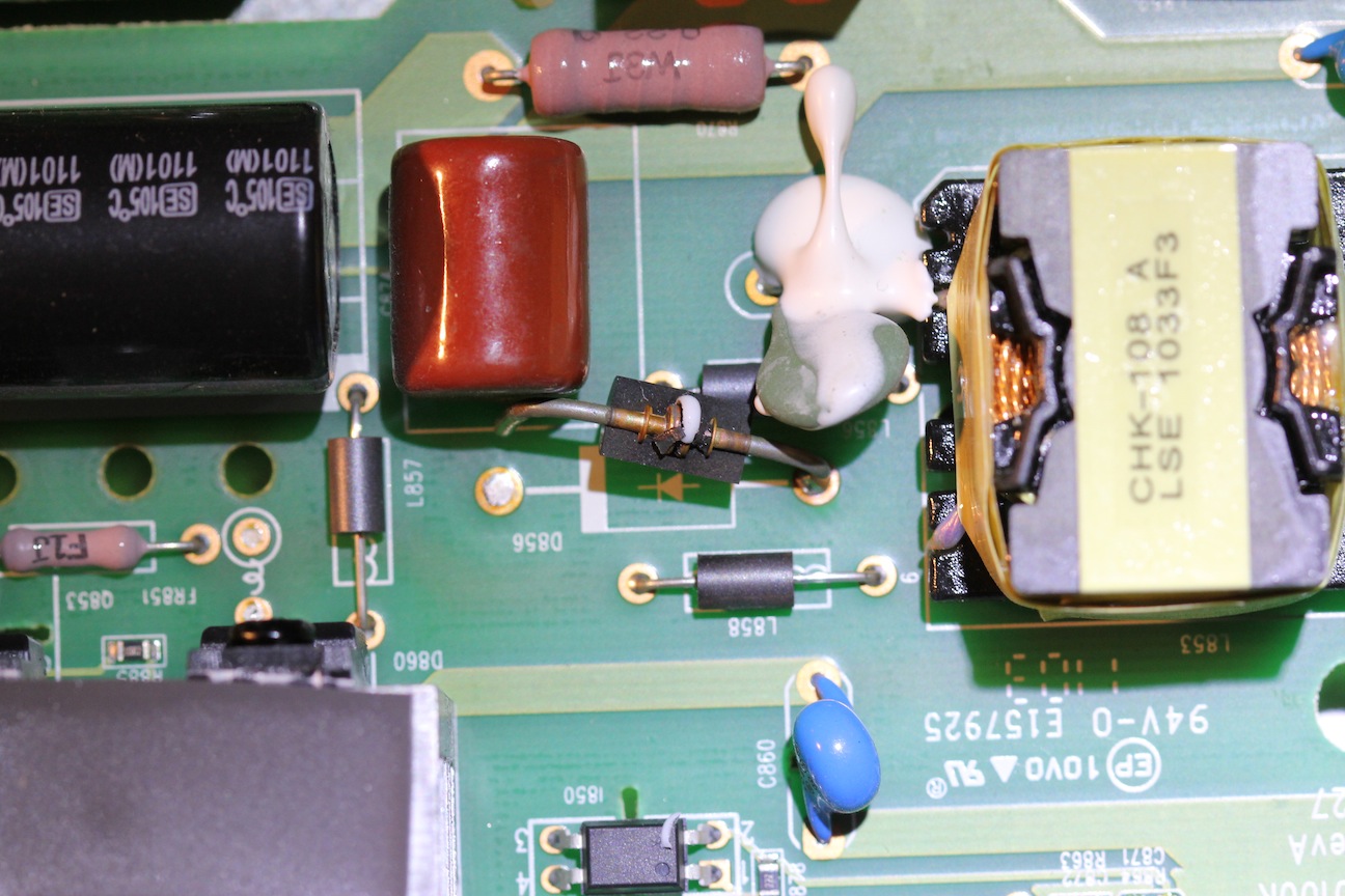

                      Starting my monitor during normal usage (front button poweroff), a short loud humming sound ended in a bang and black smoke.
                      The only casualty I can find (looking at the non-component side) seem to be diode D856.
                      From pics and the remains I pieced it together as an 1N5406.
                      A) Does any of you think this is caused by a broken component elsewere that I should replace so that it does not happen again (or something worse does)?
                      B) Any quality issues I should consider when I pick up a new 1N5406?
                      I have a basic understanding of electronics, but most of the electronics design here is beyond me at this point.
                      Hampus
                        #51
                        Re: No Power Dell U2410 Monitor
                        Check to see if RT851 is OK, then check the resistance on the Catode side and the primary Ground ref which is the Neagtive pin of C854 to see if the Load connected to the PFC Voltage booster is shorted. Might as well check the the FR851 (Value), Q853.
                        You may also have a shorted MOSFET that drive the 19V SMPS transformer.
                        https://www.badcaps.net/forum/attach...4&d=1351220450
                          #52
                          Thank you budm for the quick reply!
                          Here are my results. Are these fine and is there anything else that may be bad like the PFC IC (I851?)?
                          • RT851 shows ~3 Ohm
                          • There is residual V over C854 (from other capacitors?), so no short over the PFC if I understand the question (to check R between "Catode side and the primary Ground ref").
                          • FR851 is ~1 Ohm.
                          • I am unsure of what to do with Q853. I couldn't get an R measurement, but it seems both S and G are ~grounded and none of the pins shorted (I guess there could not be any short w/o power connected anyways).
                          All probing was done w/o mains connected.
                          Can I check Q853 somehow, or just replace the D856 diode and return power? Check anything (Q853) at that point?
                          Thanks a million
