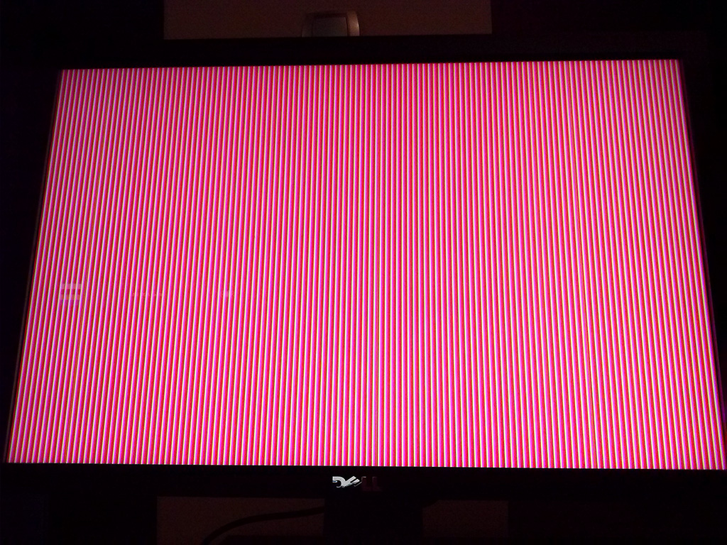

    I now had the time to do some tests.
    There is a board to which the panel is connected via two flat flex cables (T-Con-board?). I disconnected one of them and took some pictures of the monitor when powered on.
    What I can see is, that half of the panel (the one which is not connected) is light grey while the other half shows a static striped image. That image changes with powering the monitor off and on again but not while powered on. I conclude that the panel is not broken but something that handles the signal.
    I took a picture of the corner of the panel while the menu is being displayed. You might see that there is something on the monitor behind the stripes.
    What could I do next in order to narrow down the possible reasons for the stripes?

        I heated up the main board near the BGA-package, especially those CAPS and the image on the monitor changed considerably. Colors went completely towards green/blue, away from red. I even had some regions that went black and which showed the image of the "no signal" thing when it passed by. What can I conclude from that? Could it be worth replacing some of the caps?

          I have a similar problem.
          Dell monitor 2709W. Initially, they were horizontal stripes, colorful beacons in several places on the screen. Currently, the entire screen filled with vertical stripes. Is my monitor is yet to recover?
