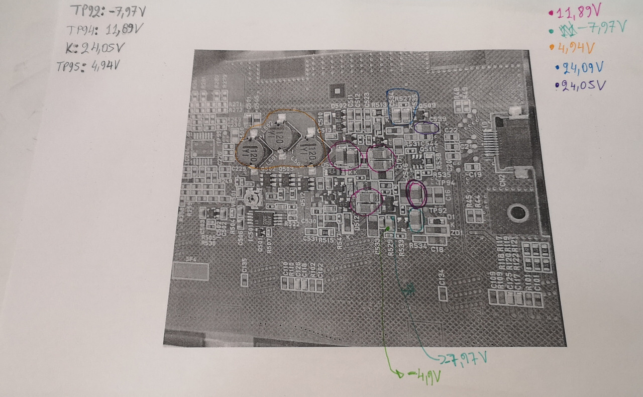

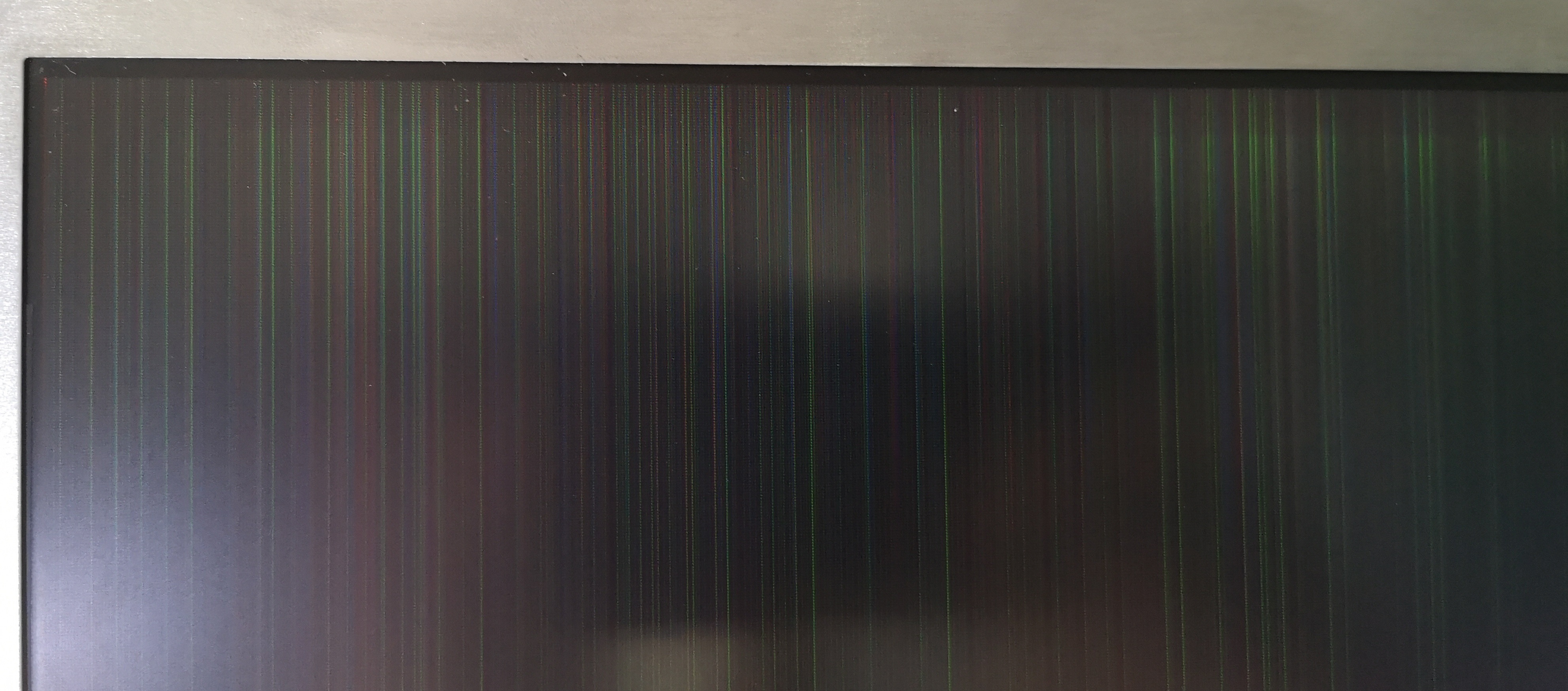

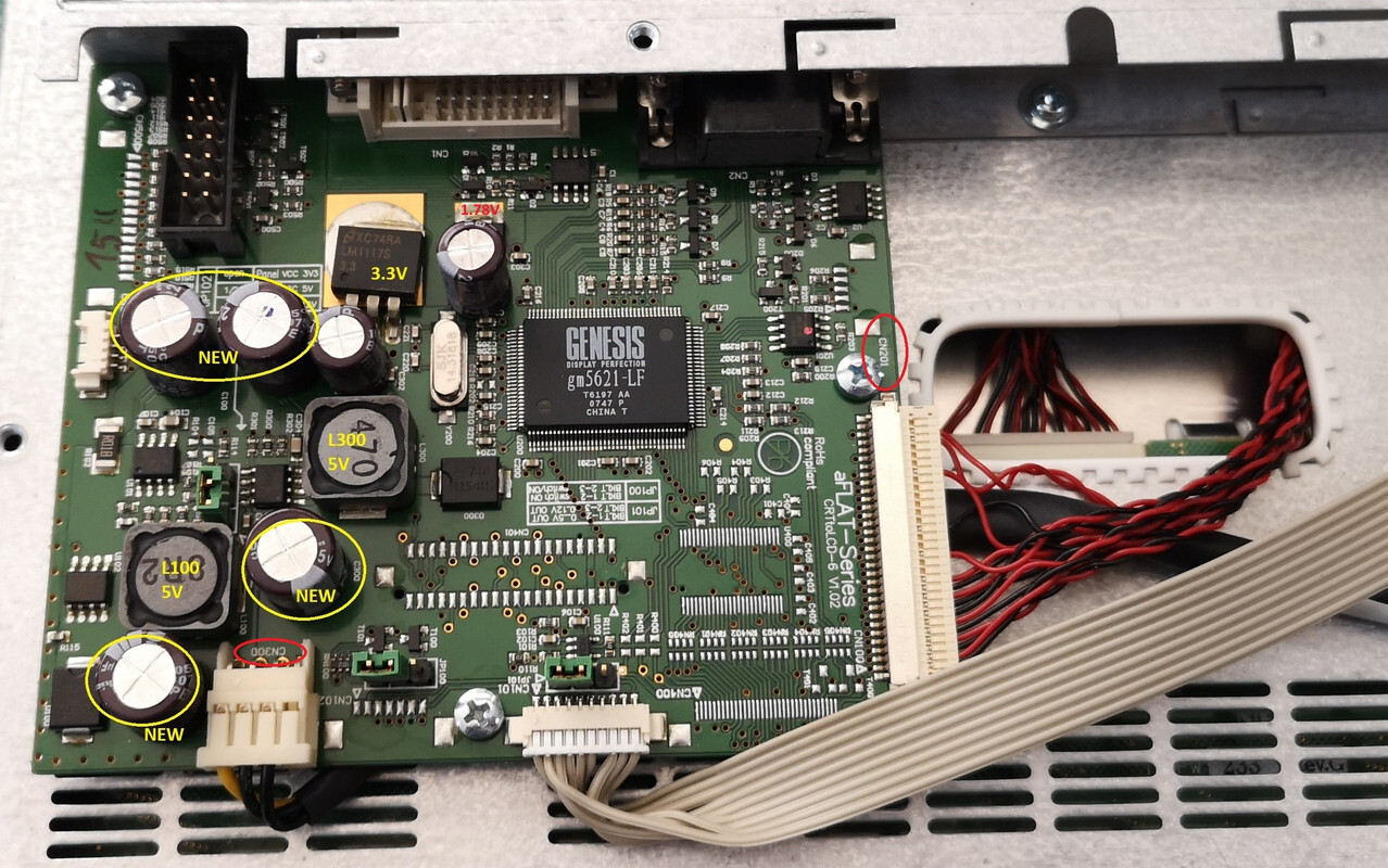

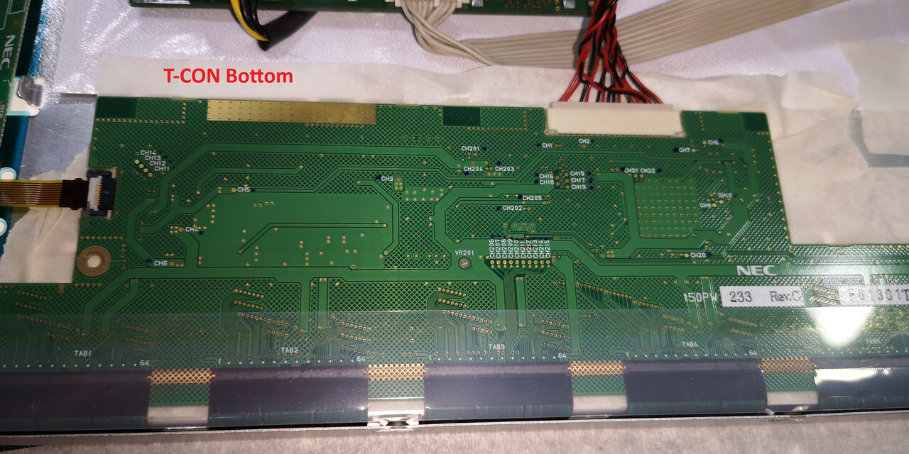

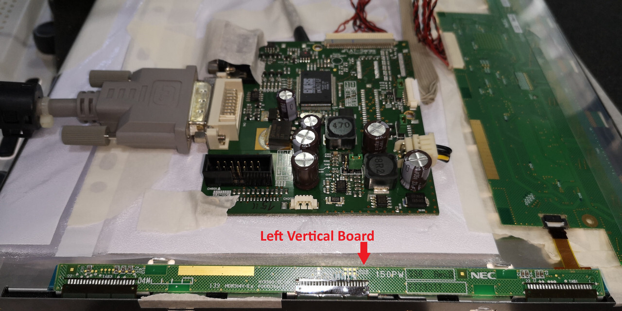

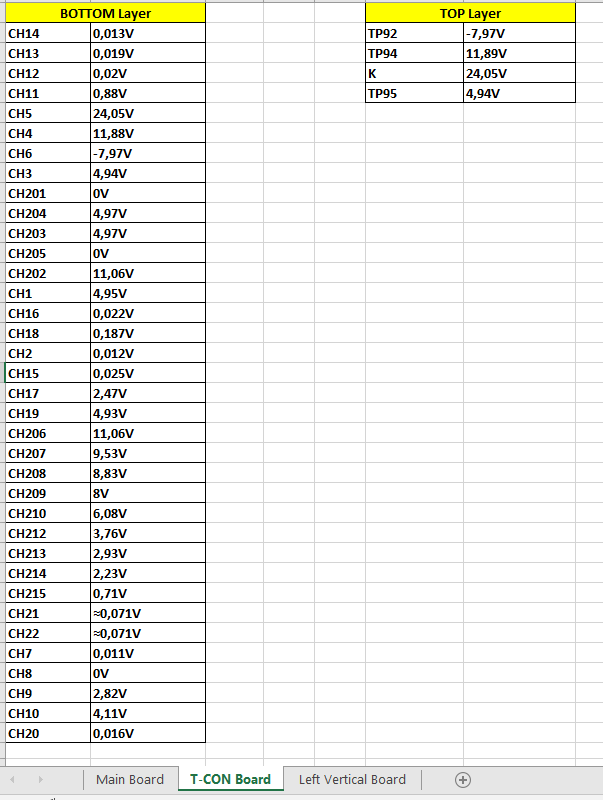

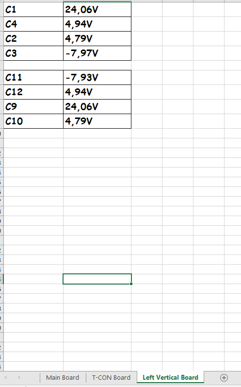

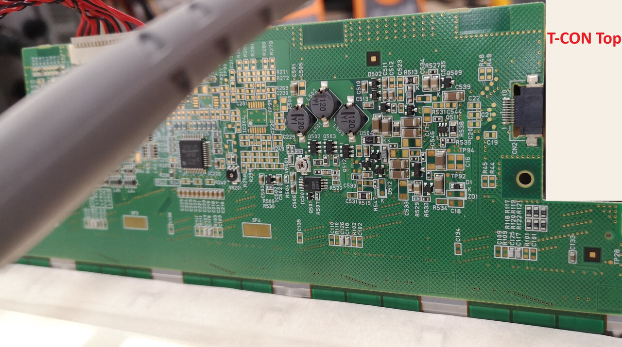

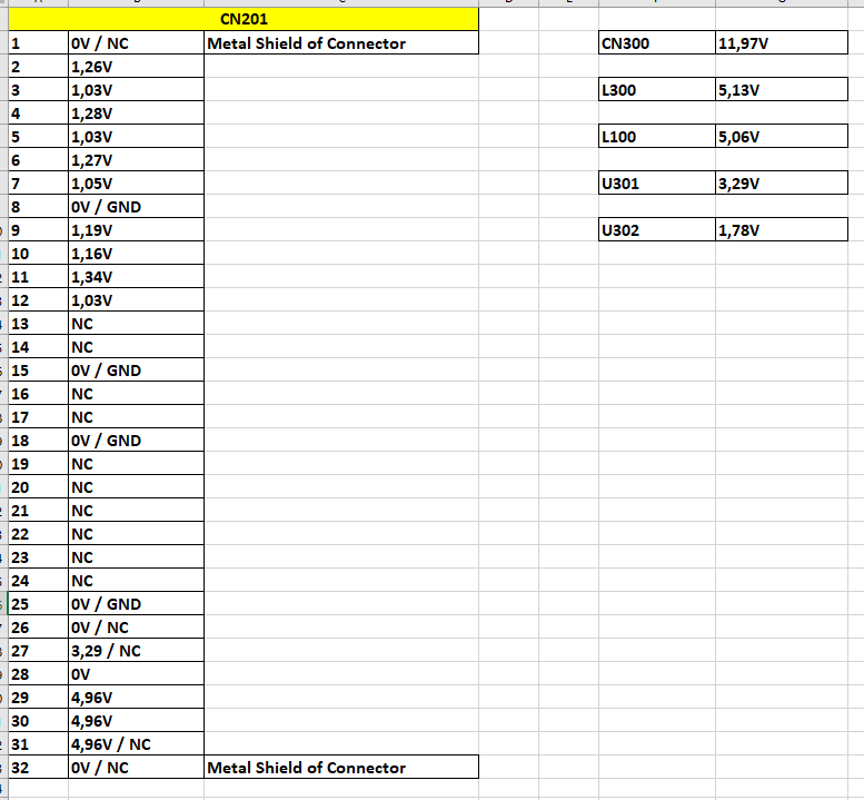

Hello, I have a screen in where sometimes when I open it pop-up vertical multicolor lines (I would say the most of them are green). If I tun off and turn on the screen the lines dissapear or if I leave open the screen after approximately five minutes the lines gone. I measured the below voltages on the main PCB and on the T-CON board and the voltages are the same when it doesn’t display the vertical lines and when it displays the vertical lines. Also, I cleaned all the connectors very good with IPA. I moved back and forth the connectors and the COF tabs but the vertical lines didn't displayed with any movement. Have anyone an idea if this problem is a component failure or it is the panel where I can’t do anything to save the screen?
