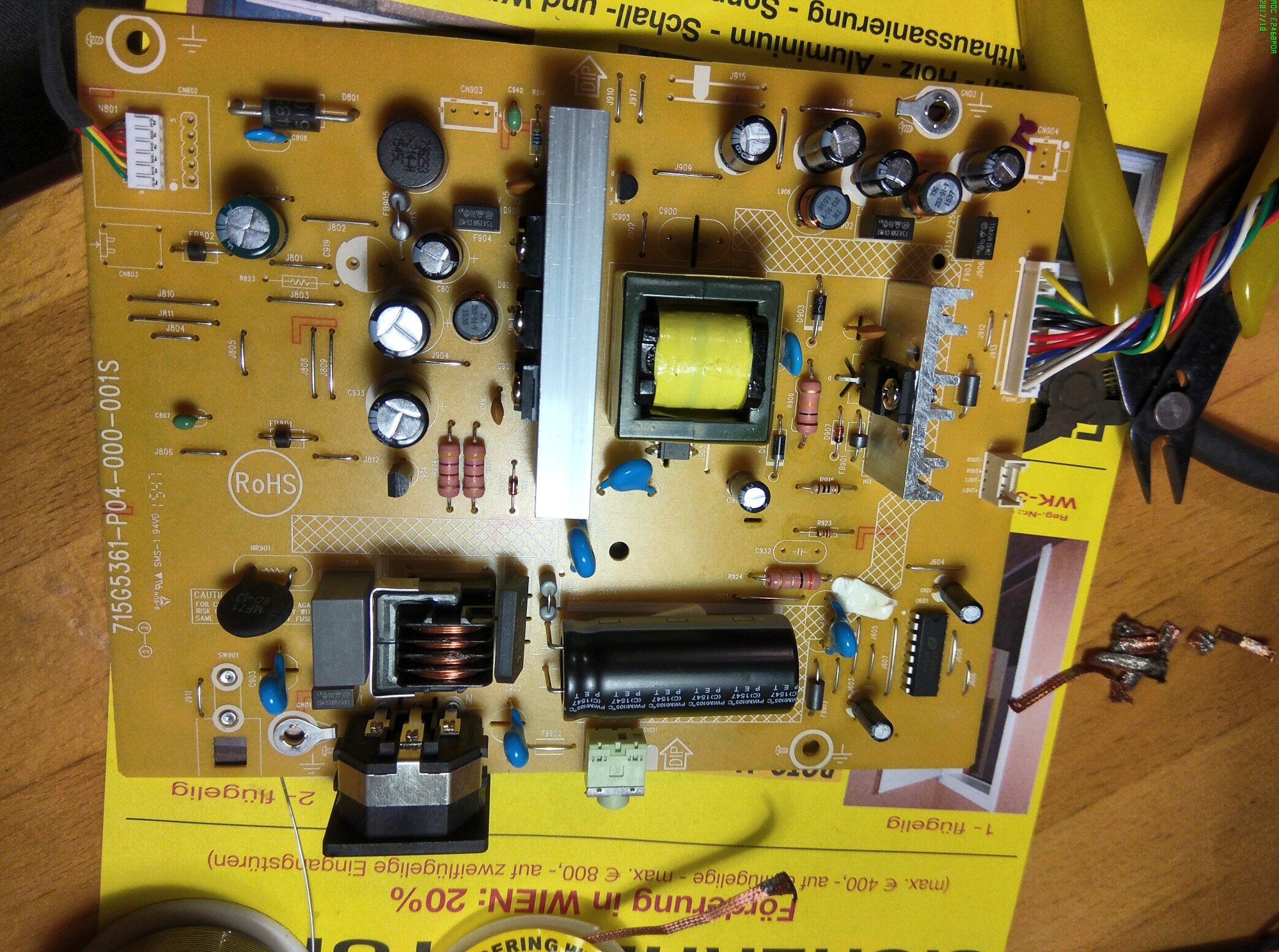

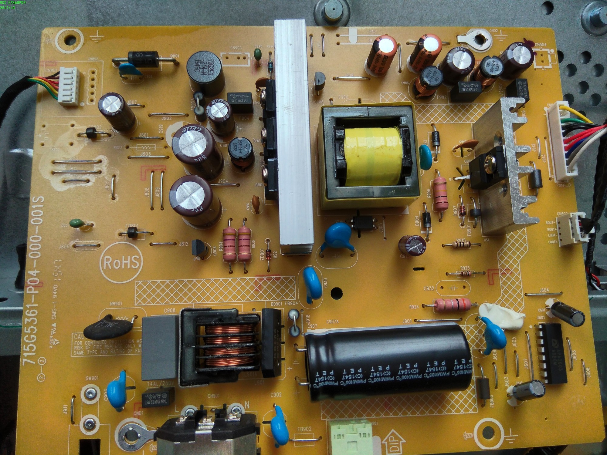

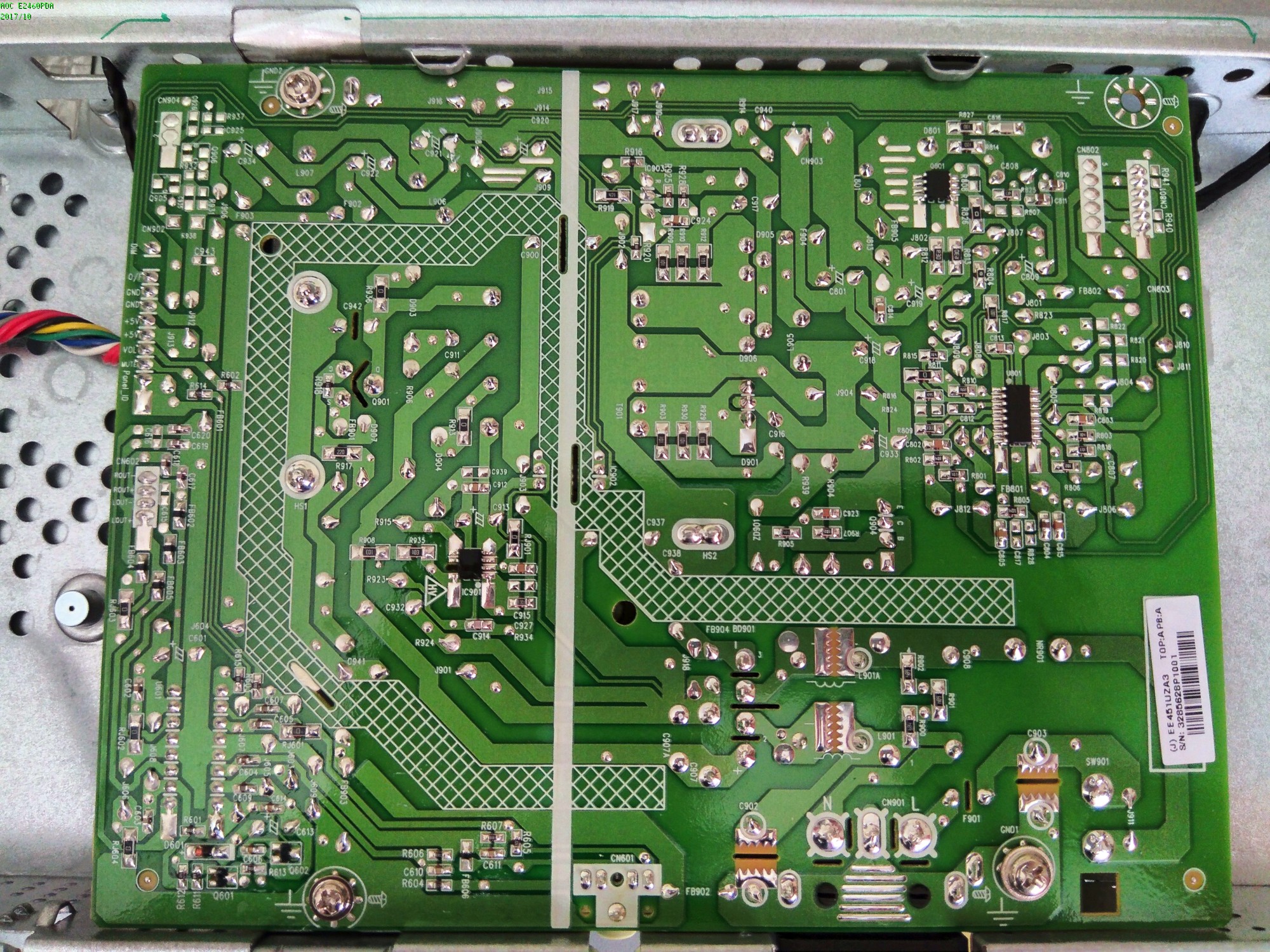

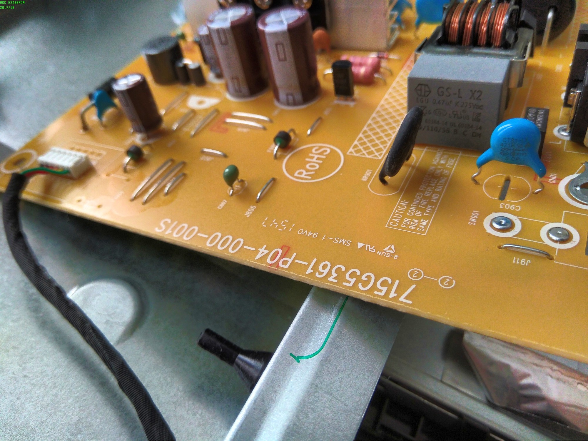

    I have a AOC E2460PDA LED-backlight Monitor (built 2012) which is giving me troubles. I am not an EE, however am competent enough to solder an replace caps (as I did with my trusty HANNS.G HG281d). Any pointers would be appreciated!
    The device
    Symptoms
    Monitor goes black after a while; the power indicator LED is going off as well. If I press the power button, nothing happens (everything stays black).
    But in this state, the monitor is still recognized by the OS as if it was working.
    If I replug in the mains cable again, the picture is coming back without any problems, until after usually ~20 minutes, the monitor starts going dark again.
    Picturewise, there are no troubles at all; if the monitor IS showing a picture, all's very crisp and steady (both from DVI & VGA)
    Pictures

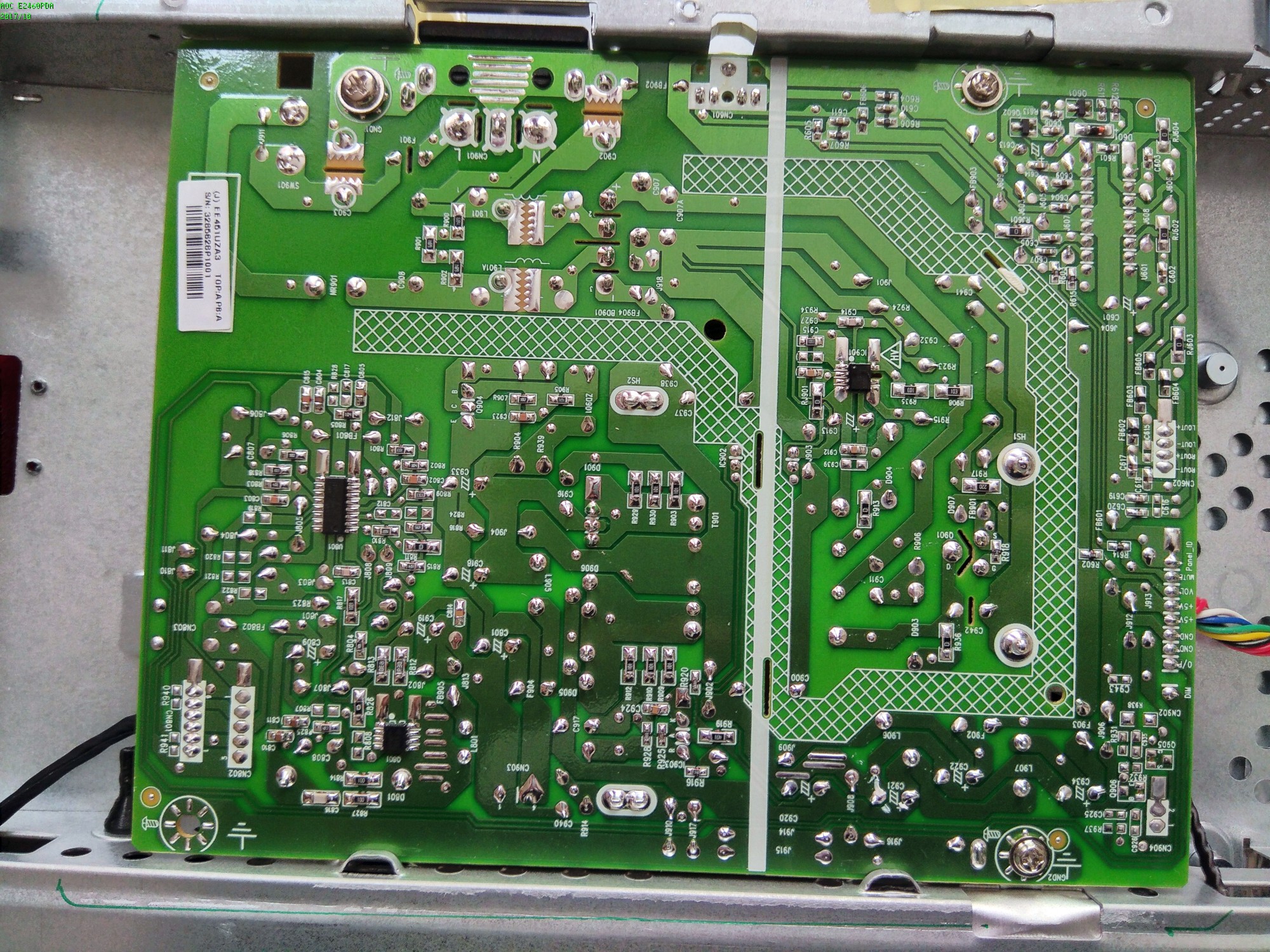

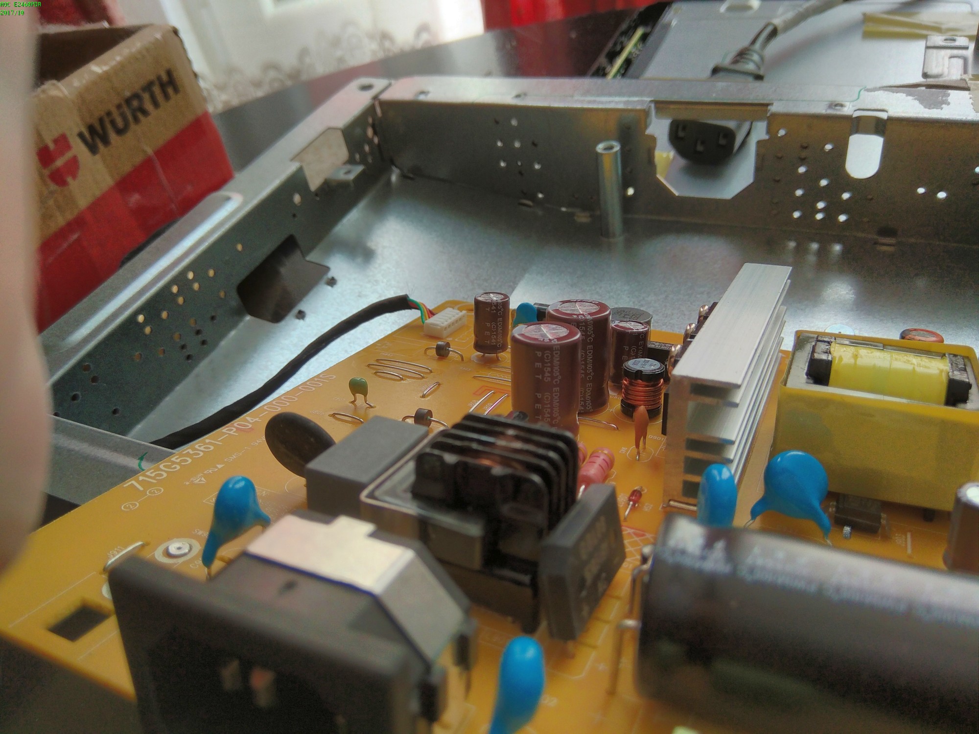

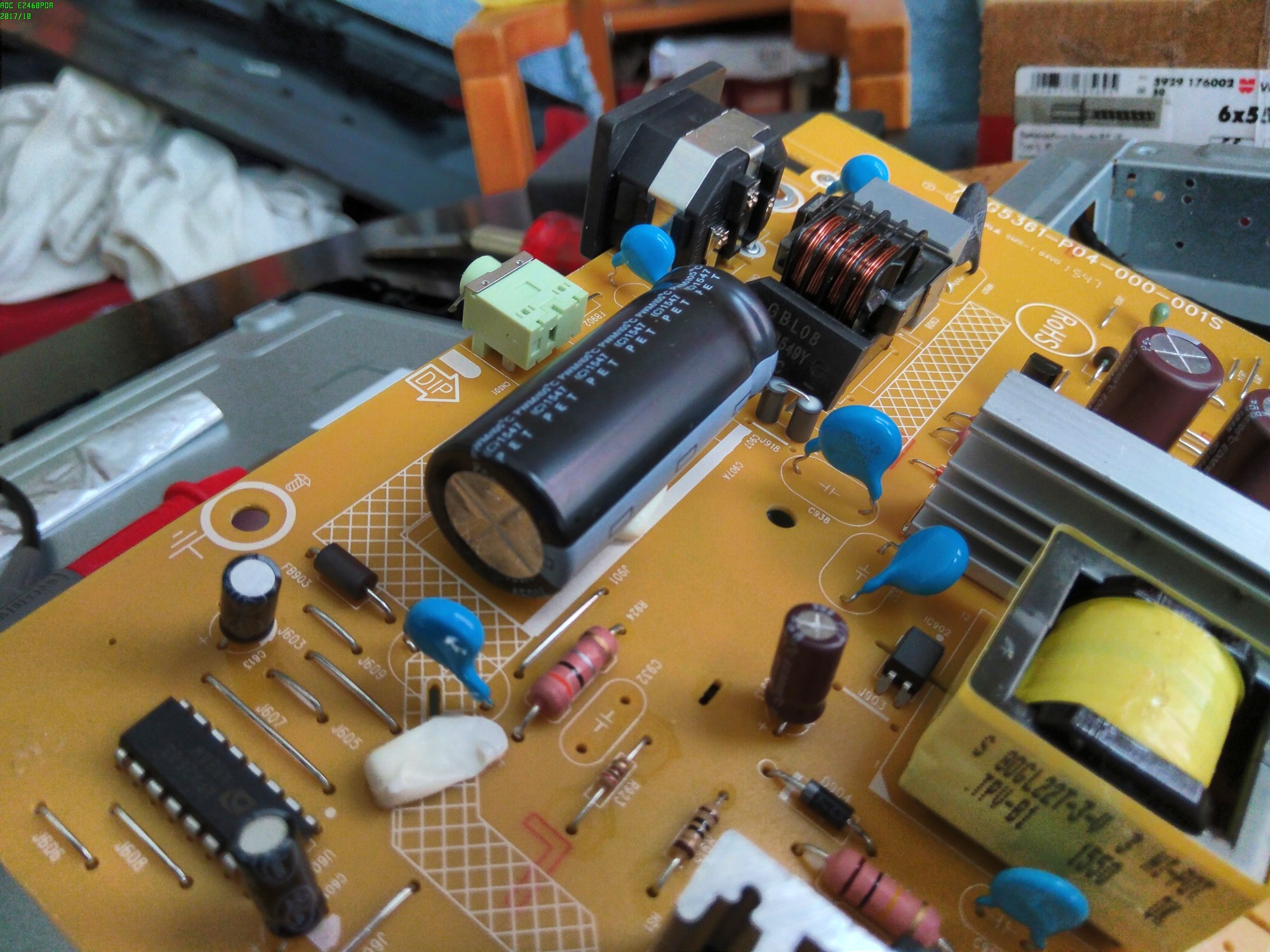

    I took pictures of the power supply (PN 715g5361), I did not see any bulged caps (most of them are Elite branded). After turning the power off, the voltage on the big cap decreased rather quickly, I don't know if that's okay.

    Re: AOC E2460 PDA with PSU: 715g5361 - Monitor turns black
    With the monitor appearing to die only after a while (with the power ON LED turning off as well), I'd be more inclined to think there are bad caps on your video/logic board. Could you post some pictures of that? The video/logic board is the one that has all the video inputs.
    That said, the next thing on the list would of course be the Elite caps... though I doubt they are causing the issue you are currently describing.

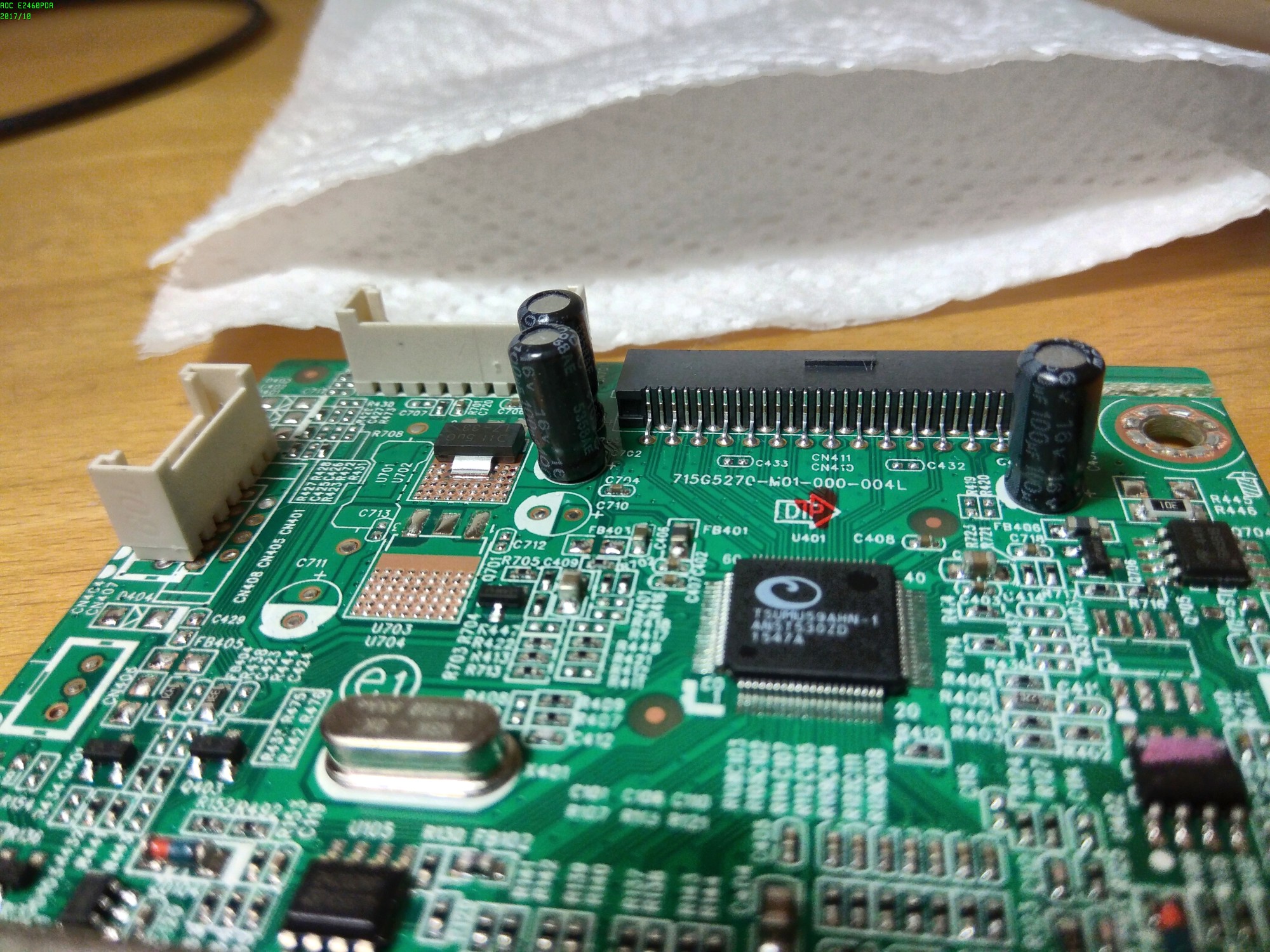

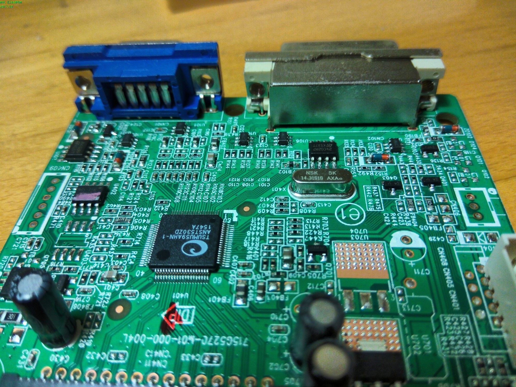

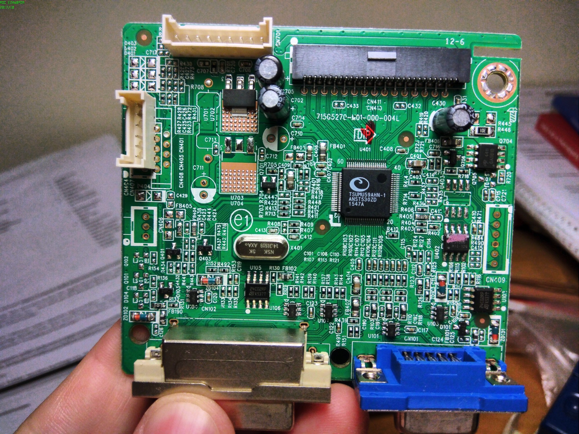

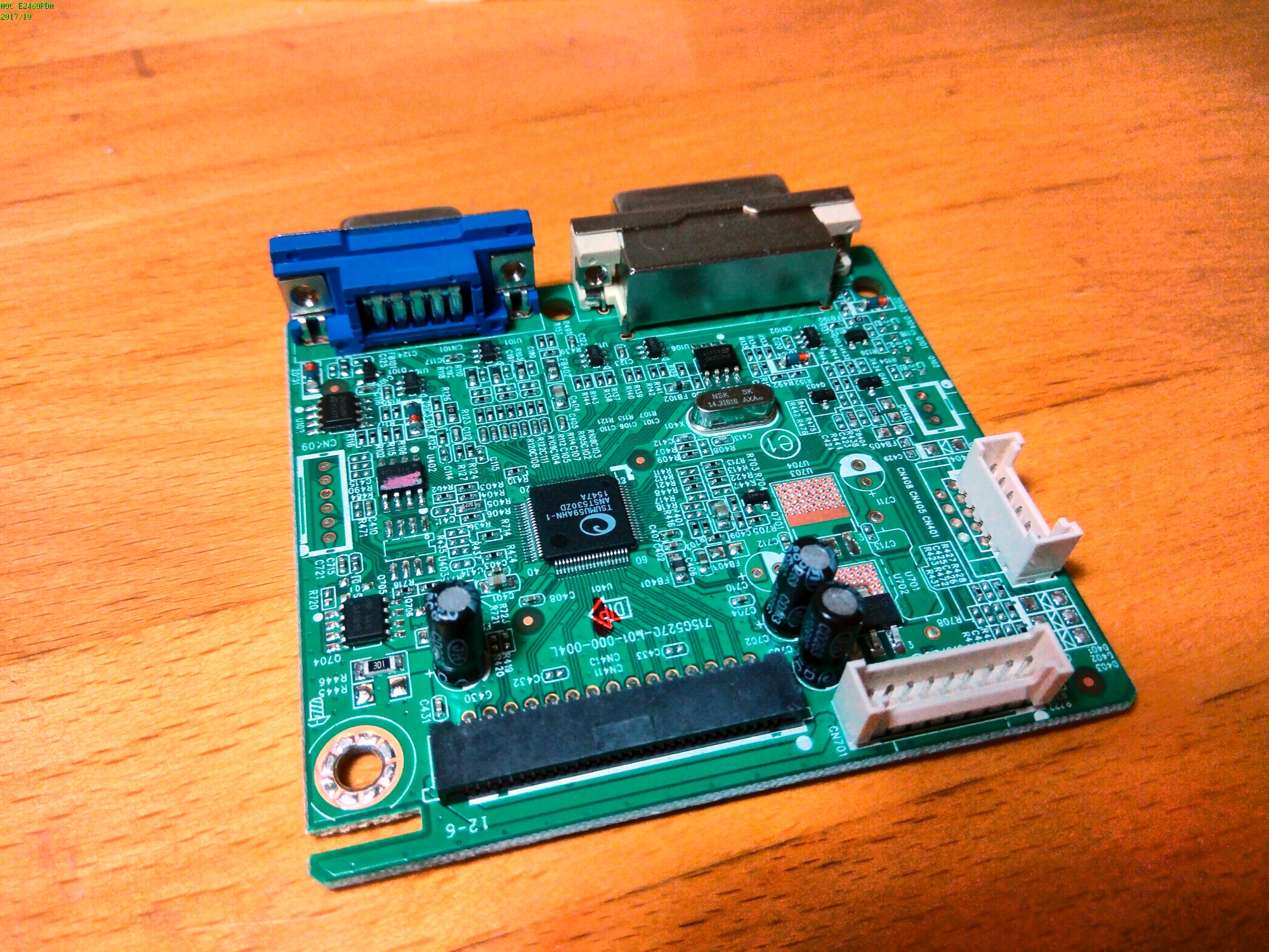

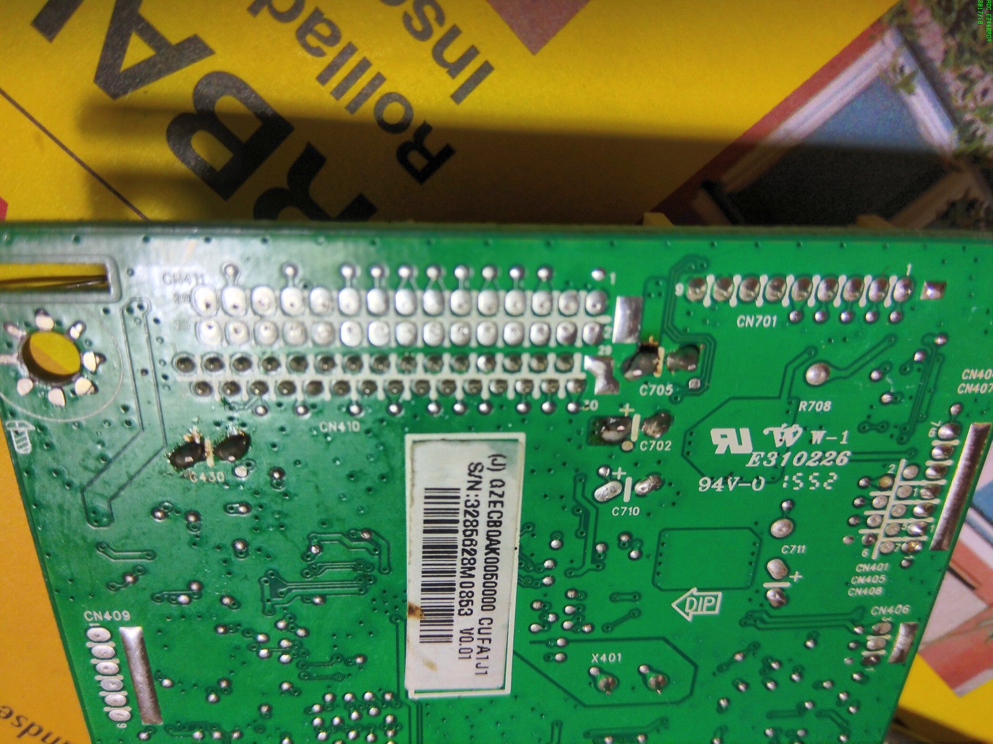

      Okay, I took out the logic board and spotted 3 electrolytic caps, all of them "JH" branded and without any visual defects.
      All three are rated 100uF, 16V 105°C, as stated in the service manual
      I know it's in circuit, however I did some measurements with one these cheap Ebay component tester to check for capacity and ESR (after shorting the leads before measuring).
      C705: ESR=0.88 Ohm, Vloss=7.2%, Cap:116uF
      C702: ESR=24Ohm Vloss=17% 127uF
      C430: was not recognized as part (maybe the culprit?)
      There is another small PCB for the switches and another one fixed to the screen itself.
        C430 might not be recognized due to in-circuit measurement, but it might be dead too.
        However, C702 has a very high ESR so make sure you're making good contact. If the ESR is still high, it's bad. You should replace the 3 caps.

            After de-soldering the three caps from the logic board (a PITA as always...), I measured them out nof circuit now:
            C705: ESR=0.67 Ohm, Vloss=2.1%, Cap:101.4uF
            C702: ESR=0.64Ohm Vloss=2% 104.3uF
            C430: ESR=0.7Ohm Vloss=2.6% 100.6uF
            (again, all three are rated 100uF, 16V 105°C)
            Measurements are to be taken with a grain of salt, since I didn't use professional equipment, just a LCR-T4 component tester.
            However, I think these caps are not to blame?
              Yup, they look alright on the ESR meter. For small caps like that, typically up to 3-4 Ohms ESR is not considered bad.
              That said, let's try the following approach: try measuring the output voltages going from the PSU board to the logic board when the monitor is working and when it isn't. That should be the 5V rail on pins 6 and 7 on connector CN902.
              This should help us narrow it down if the PSU is shutting down due to a fault or if there is something else wrong, perhaps with the logic board. I see only a single transformer on your PSU board (minus the inverters), so that means the PSU is always-ON, regardless of the state of the monitor. Thus, the 5V rail on pin 6 and 7 on CN902 should never go out.
              If the 5V rail indeed never goes out, then try measuring the voltage on regulator U702 input and output pins when the problem occurs and also when the monitor is working fine.
              Alternatively, you can try tacking the issue by removing the caps on the PSU board and see if there are any bad ones there.
              Or just order new caps and replace everything if you think that is easier, so that we can rule out bad caps as the cause of the issue.

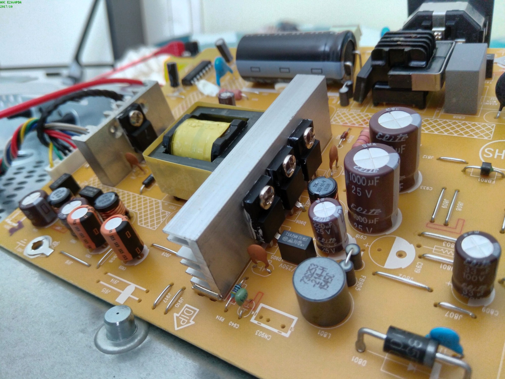

                Sorry for the long time since my last post.

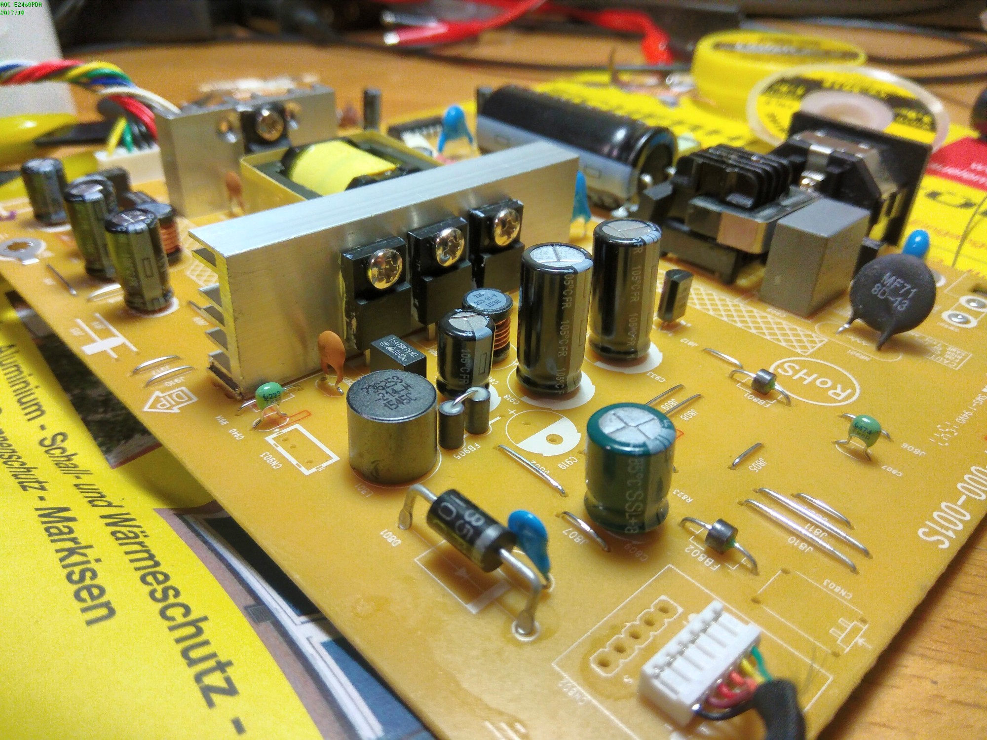

                I desoldered all capacitors for both the logic board and the power board and measured their values:
                Logic board 715G5270M
                Code:
                CAP   MEASURED*        SHOULD BE
                C430  101.4μF 0.67Ω 2.1%   100μF 16V
                C702  104.3μF 0.64Ω 2%    100μF 16V
                C705  100.6μF 0.7Ω 2.6%    100μF 16V
                Note: MEASURED format: Capacity InternalResistance VoltageLoss
                Power board 715G5361P
                Code:
                CAP   MEASURED        SHOULD BE
                C601  105μF - 0.43Ω - 1.1%  100μF 16V
                C613  105.9μF - 0.39Ω - 1.4% 100μF 16V
                C801  223.5μF - 0.26Ω - 0.6% 220μF 35V
                C809  30.89μF - 0.29Ω - 0.5% 33μF 100V
                C913  45.3μF - 0.5Ω - 0.8%  47μF 50V
                C918  911μF - 0.1Ω - 0.6%   1000μF 25V
                C920  770μF - 0.09Ω - 2.0%  680μF 10V
                C921  778μF - 0.09Ω - 1.7%  680μF 10V
                C922  332μF - 0.26Ω - 0.9%  330μF 25V
                C933  942μF - 0.11Ω - 0.8%  1000μF 25V
                C934  333μF - 0.26Ω - 0.4%  330μF 25V

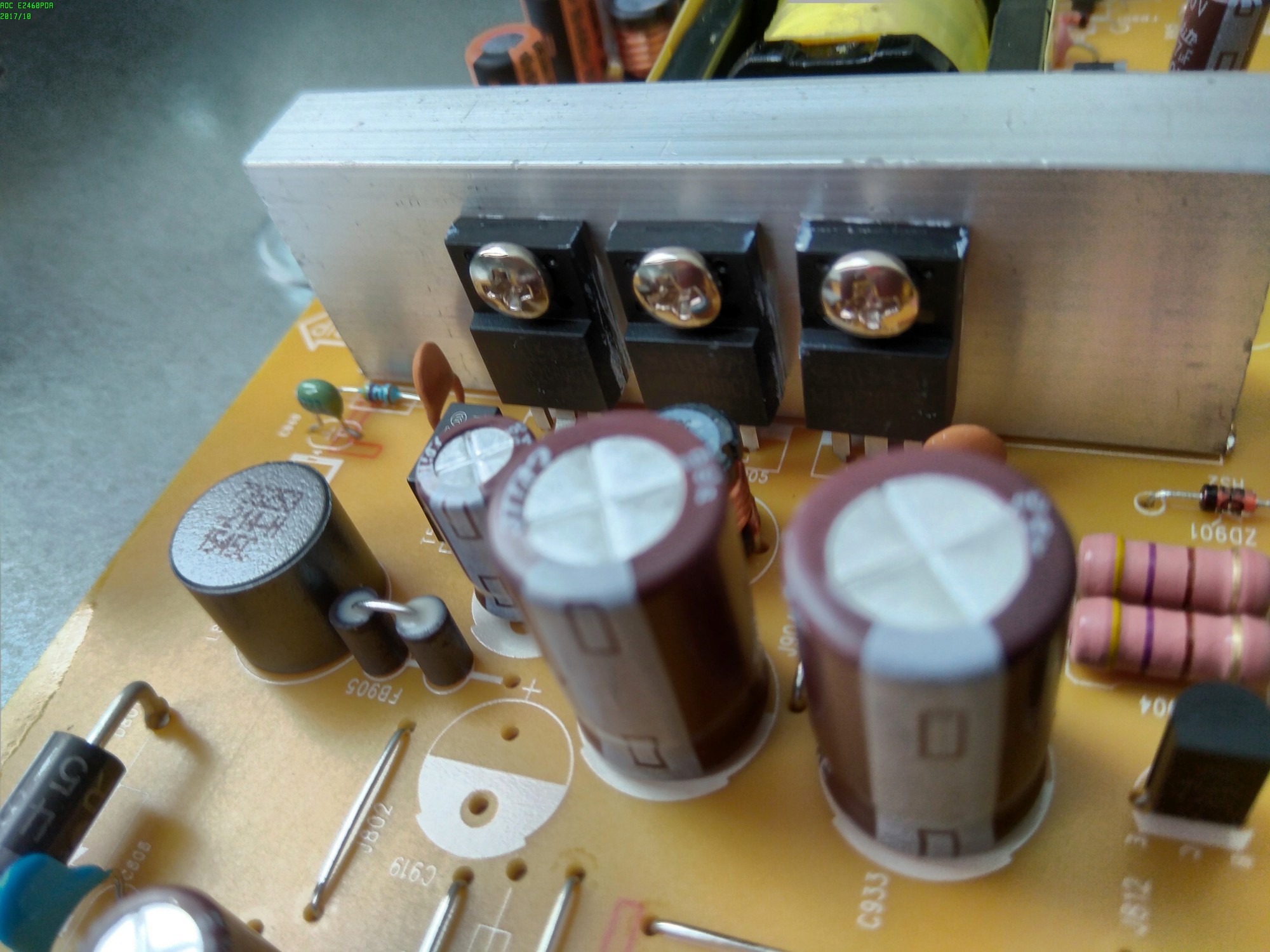

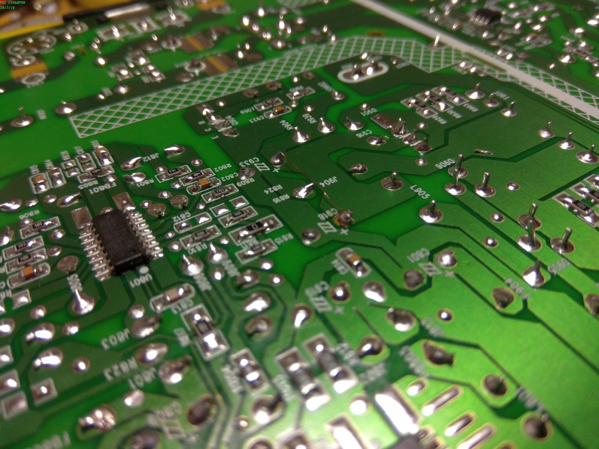

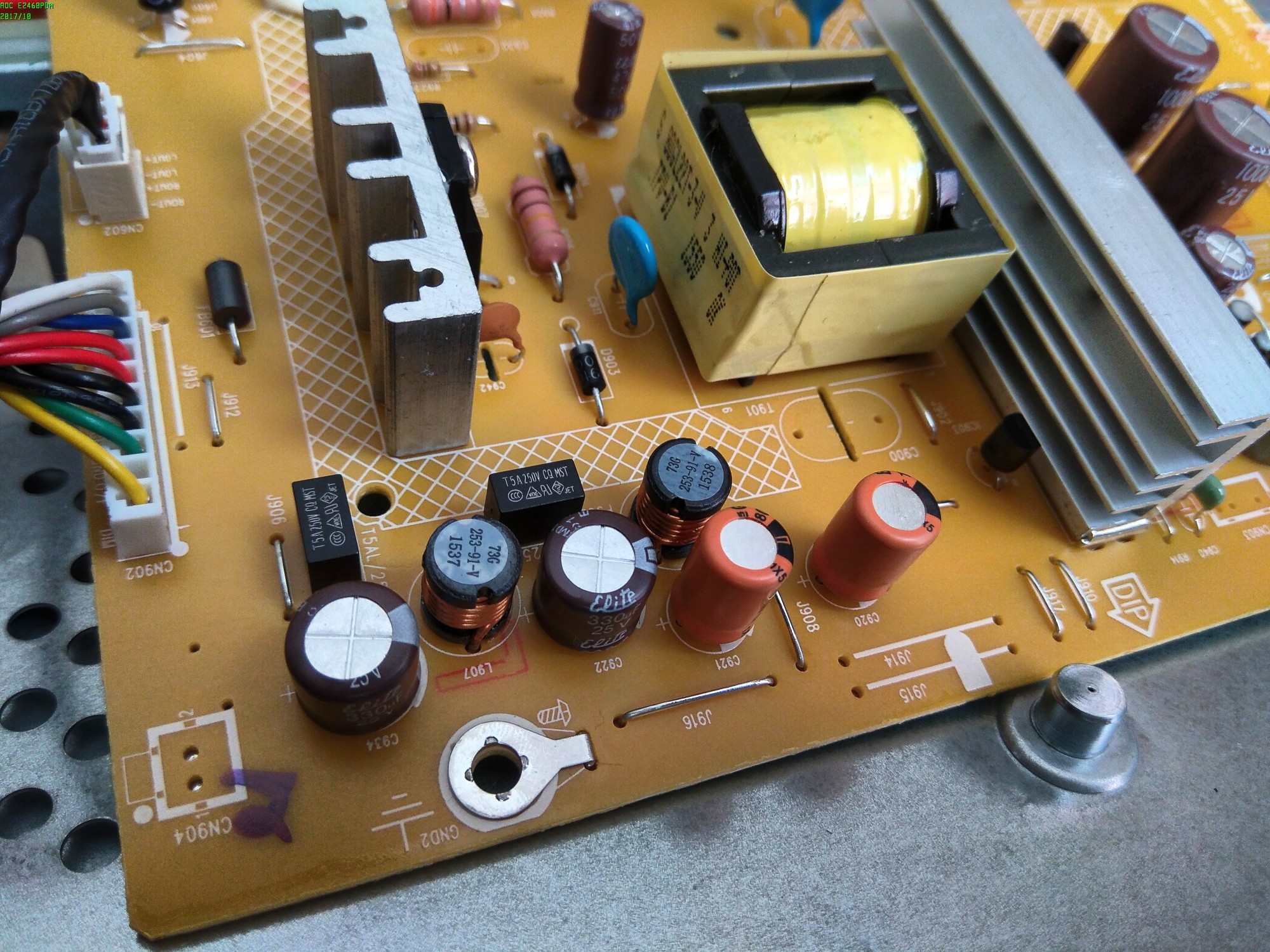

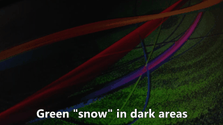

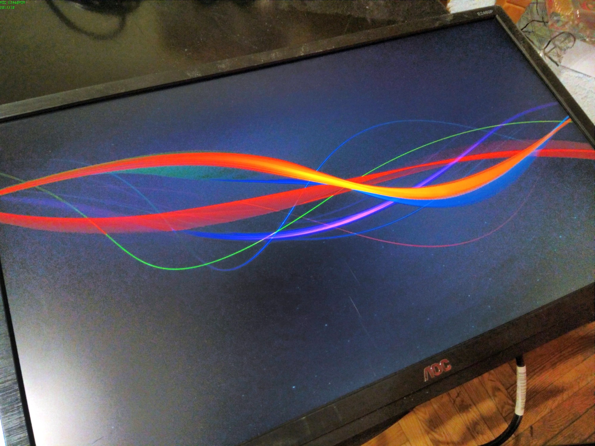

                Although none of the values were too far off, I ordered Panasonic FR series caps to replace them all. With one exception however: for C809 I used a "SSL" branded capacitor rated for only 85°C, since the store didn't have a FR series in stock with these specs. I'm not sure if that's alright?
                Unfortunately, the solder pads came off for C702 and C933 (I used some bodge wire, C933 is in parallel with C918 anyway).
                After powering the monitor on, there was quite a lot of green noise in dark areas (see gif), but after 3 minutes or so, the picture became stable. I am not sure what was the reason, perhaps because I cleaned the board with Isopropyl and water?
                The screen is running for an hour now without any issues. Recapping apparently solved the problem it seems for now - if there are problems again, I'll keep you posted

                  That "SSL" capacitor is actually Samsung SSL series - very old caps. I'm surprised it didn't pop, as that is a NOS cap that probably sat in storage for over 20 years. Also, it's only a general purpose cap and only rated for 85C, so it may not last very long in the monitor. I definitely suggest to keep the original cap, just in case this one doesn't last too long. I'm not sure what C809's function is, but if it's just filtering for an output rail, I would replace it with whatever is the next closest higher capacitance. And if the voltage on it is much lower, I would use a lower voltage cap too. That way, you would have more choices rather than looking for an odd-ball value.
                  Just keep this in mind: manufacturers don't always use the "most optimal" parts during assembly. A lot of times, they just use whatever is the cheapest at the time that is closest to what they need. So you do have some "wiggle room" to play with the capacitor's capacitance and voltage rating, usually. The only cap I would not mess with (as in, keep the same capacitance and voltage) is the startup cap. For your monitor, that appears to be C913.
                  Yeah, that's not a very good way to do it. The long wire increases the effective ESR of the cap and also puts more noise in the power supply.
                  You can just scrape away the solder mask next to the lifted pad instead and solder the lead to that. A small flat heat screwdriver works well for scraping away solder mask. Just make sure to scrape down to bare copper. Then heat with you iron and apply solder. Once there is enough solder, just bridge it over to the cap lead.
                  Nah, the Isopropyl/water cleaning wouldn't have anything to do with that.
                  Does the monitor do this every time it is cold? If yes, you may have excess ripple/noise from the PSU. In which case, my guess is that it could be either the Samsung SSL cap or perhaps the solder wire bodge job.
                  Otherwise everything else looks good. Congrats on the repair.

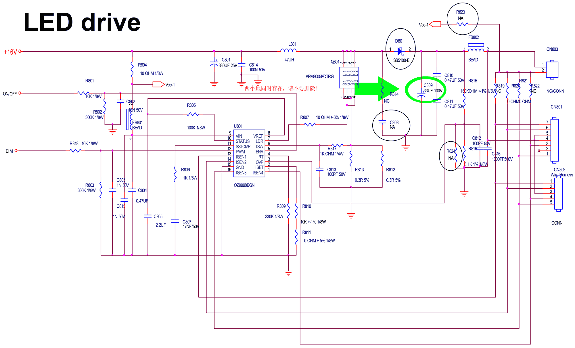

                    On C809 33μF 100V
                    Interesting, since the store is actually one of germany's bigger electronic stores (Reichelt, link to the article page; the picture shows a Samsung cap, the datasheet is for Yageo - I guess they sell "whatever" for general purpose caps).
                    I'm not an EE, but the schematic says it's part of the "LED drive" (for backlight control?). I've linked the schematic as attachment.
                    I still have the original capacitor around, I wonder if it is better to keep the new one or to put in the original one.

                    On the noise issue
                    I could not reproduce the noise after the first time I plugged it in - perhaps the plug didn't make proper contact. The monitor has been running without issues yet for some hours (also after cold starts).
                      On C809 33μF 100V
                      I guess it doesn't matter too much, as long as the capacitor is working and doesn't go high-ESR or open-circuit. Looks like C809 just filters the output of a buck-boosted rail for the LED backlight, so its capacitance can likely be increased a little, if that helps with finding a replacement cap easier (50V/100uF is a pretty standard value).
                      What about if you completely disconnect the monitor for the wall for several hours or overnight? I'm just curious. You don't really have to do this, though. I guess if it's working, then let it be.
                      Strangely enough, I have a Gateway 19" monitor here that always displays gray/white garbled screen for several ON-OFF cycles, if I take it apart and happen to disconnect either the PSU board or the logic board. After that, it "fixes" itself and always works fine - even if I leave it unplugged for more than a year (it's a spare monitor I have). I never figured out what caused this, because once it starts working, it's fine. Similar issue to your noise issue? - I don't know. It could be.

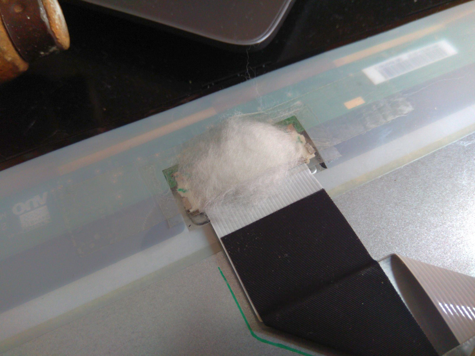

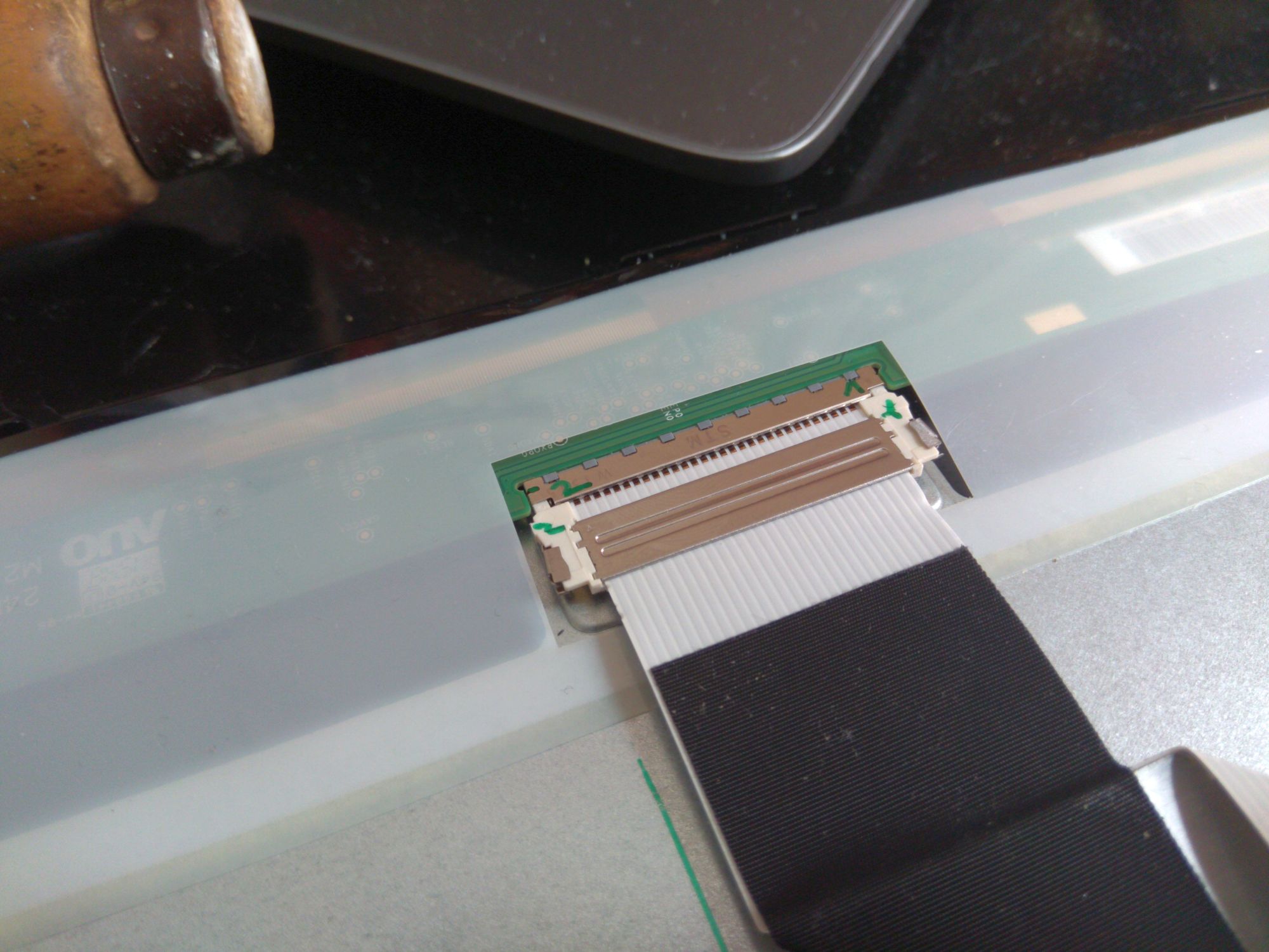

                        The monitor started to turn off after a while again, so I exchanged the last capacitor (C809 - 33μF 100V) as well:
                        But after replacing it and turning the monitor back on, there were horrible color aberration (see first image).
                        After a while I discovered that the culprit was the flatflex cable connected to the panel - when I pressed it down manually, the color was fine again.
                        So I ghetto-fixed it by using some cotton wool on the connector to constantly apply some pressure.
                        So far everything works well again - I'll post here if there are problems again...
