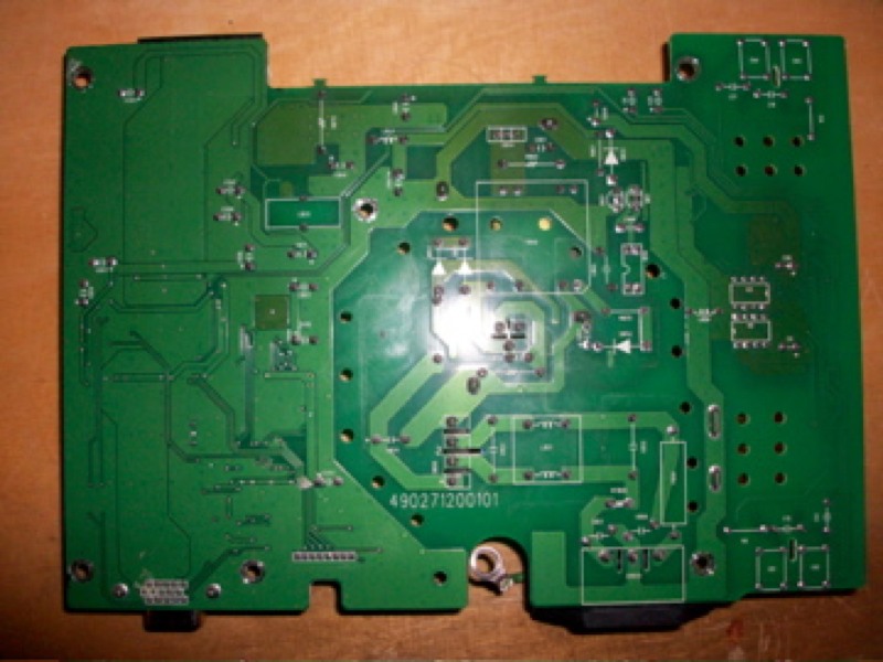

    I have the monitor listed above. Nothing will come on the screen but i have a green light when its not plugged in and a orange light when i have it plugged into a computer. I have read through past forums and checked the srf10-10 diode and it seems to be fine.

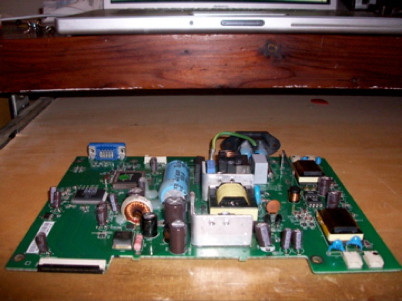

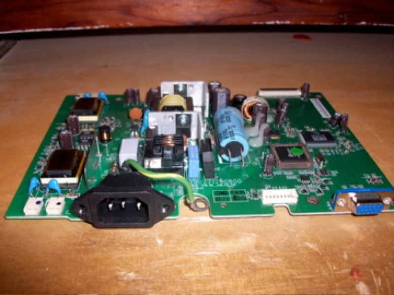

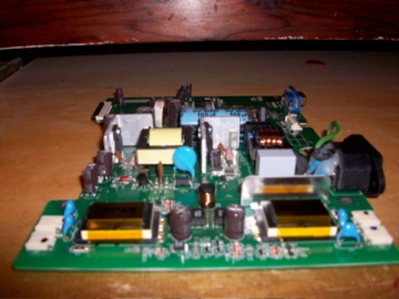

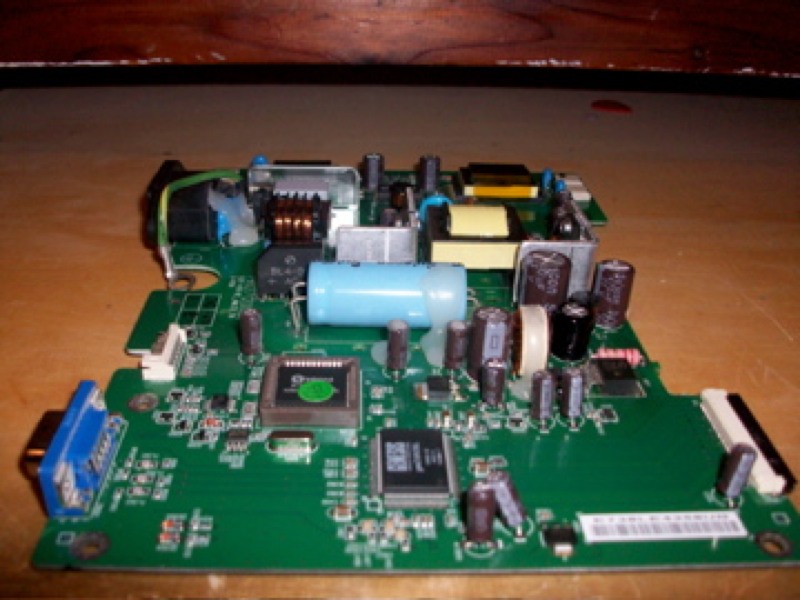

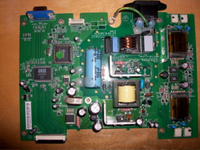

              Re: Dell E173FPf
              Here are the pictures for the board

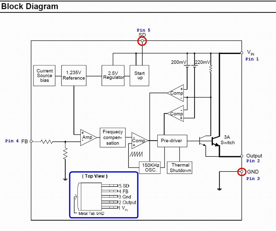

                Hello again Darkstar
                Got my answer from Eduardo, not what I wanted to hear, looks like our IC 1506- 50 = AP1506 is kaput, it will pay you to read the whole thread that has Eduardo's answer in it, to make your own judgement, but also so as you can see problems with replacing this part,
                The thread is
                https://www.badcaps.net/forum/showthread.php?t=6533
                You may have already read it, I have an idea how to get over some of the problems with some improvisation, I will get back to you on that, in the meantime, I have a load of various working monitors here, that i have repaired, and I am going to open them up until I find one with this IC and check it out, because I feel there is something that doesnt add up, so that, it will confirm to me one way or other, let me know what your thoughts are on it after you read thread and Answer
                thxs bob

                  Guys, I don't want to mislead anyone. The questions Boobdee made yesterday are still going around in circles in my mind. So I went ahead and tore apart a working Planar Monitor that I remembered had the same IC.
                  ** With my analog MM:
                  (-) on pin 3 (GND) I got:
                  330ohms to pin 5
                  335ohms to pin 4
                  335ohms to pin 2
                  Nothing to pin 1
                  (+) on pin 3 I got
                  Nothing to Pin 5
                  100,000 to Pin 4
                  500,000 to pin 2
                  Nothing to pin 1
                  with the DMM, on diode test mode:
                  (-) to pin 3 (GND)
                  No lectures
                  (+) to pin 3
                  691 to pin 5
                  660 to pin 4
                  700 to pin 2
                  nothing to pin 1
                  The bad I have has a reading of 0.9 ohms both ways between pins 1 and 3 *tested off circuit*. That's why I deducted it was bad (among other things) in the eMachines I have. It had the input DC pins reversed and died.
                  What I suggest is that you desolder the pins and test it that way, because if something forward the IC is shorted, you'll read short/low resistance between the pins, even if they are not shorted inside the IC itself. Seeing the block diagram below, I don't think that the IC should have that low resistance between pins in my particular case.

                    Hello Bob,
                    I went back and read his post and from what I gather he said, is that I should not have continuity between pins 1 and 3 which I do not. If I have the power hooked up I get 12v off of the 1 and 3 pins but I do not get any volts off of the 3 and 5 pins. The 3 and 5 pins also read 0.3 off of the ohm meter. I'm still not sure if that is right or low. I think it might be kind of low if his was reading 0.9 I figure mine should be somewhere close.
                      Re: Dell E173FPf
                      That is your Input Voltage (1) and Ground (3). That is normal.
                      .... but I do not get any volts off of the 3 and 5 pins
                      From 3 to 5 you should get voltage only if the signal to "turn on" the IC is received (SD is the start/shutdown as far as I can understand from the Datasheet). If there's a problem and the signal does not get to the SD pin, it will not "awake". I guess it is normal that you, in the condition the monitor is, don't have any V reading between 3 and 5.
                      And for the 0.9ohms reading on my IC, I don't think that is normal : Pin 5 (SD) has Voltage and pin 3 is ground, and there should not be that kind of low resistance between them. Is like if you take the two wires from a DC adapter (+ and -) and wire then together : not good, right?
                      I guess we should (all the three of us) wait, or ask for the help of one of the senior members like PCBONEZ, Davmax, and other people around here that has worked with electronics more in deep. Toasty had given me some good advice too.
                      But even if they don't confirm the IC issue (in my case), there's no way that, off circuit, those two pins have so low resistance between them, both ways.
                      As I said before, you should (if you suspect your ICs are bad) lift the pins and test them that way and see what you get. Maybe your problem is different and you are looking in the wrong place.

                        I am not sure yet if I want to lift those pins. I don't want to do something and not be able to put it back. Is it difficult to solder those pins back on? My experience is guitar cables, pick ups, input jacks, and wires. Nothing really that small, so I am still debating.
                        So I put everything back together to see if I could see any kind of flash or any kind of light on the screen and now The green LED is not coming on. So I think i am moving backward here.
                        I guess i was also thinking, could it be back lights in the monitor? Do those go out? And is there a way to test for that kind of a problem? Or am I complete wrong in this area?

                          Yes, the lamps could go. They are like regular fluorescent lamps, just smaller.
                          You can test them on another known good monitor, make a tester like the one I made from an internal neon kit for a case, or just put known good lamps in your inverter, but if you just have one LCD, it would be difficult. And if you are not sure about the pins, don't do it. I wasn't quite sure the first time, and you can see what I did to a good IC, so if not sure, don't do it. As for the green light gone, well, you have to see what have you done so far to the LCD and see what went wrong. I've seen other threads with this model of LCD.
                          And now I am positive that my faulty IC is not either your or Bobdee's case. Your problem is different.

                            Re: Dell E173FPf
                            Ok, Well thank you for the help I will keep reading. I don't know what would have caused the green LED just to shut off. I haven't done anything but check ohms on things that i have been reading about.
                            I think i have another suspicion. That would be the diode above the yellow transformer on picture to up there. I read a thread that said to check the SRF10-10 and that one seemed to work fine but the other one i can't get an ohm reading for it. The numbers on it or 27611 or 1l I'm not quite sure about the last 2. Then below that set is another set 430036.
                            Thanks Justin
