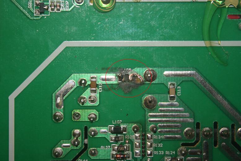

        Re: Issue with Westinghouse 19" LCD Monitor (large pics)
        I am working on a Westinghouse TV with board DAC-19m015. It has a nice little burn spot where L105 used to be. Can anyone tell me what is supposed to be there? Thanks in advance. :-)
          L105 => L => inductor.
            Agree. L is for an inductor. You can see one in one of your pics ...
              That's what I thought, but I wanted to make sure. :-)
              Since L105 is gone is there any way to find the correct inductor to replace it? Any ideas are welcome.

                I had thought of searching for the service manual for the monitor and other monitors that use the same power supply. The I realized that a considerable amount of current passed through that inductor to destroy it AND damage the circuit trace next to it. There is certain to be additional damage.
                  Good Point. Thank you. I will probably look for another board.

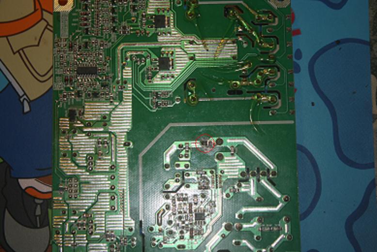

                            Another question about my DAC-19M015 power board.
                            On the solder side, to the right of the CE103 cap (1000uf, 25 vdc) (with the cap positioned to the top), there's a small black square labeled ZD100. It appears to be cracked.
                            Can anyone tell me what kind of component it might be, and the value?

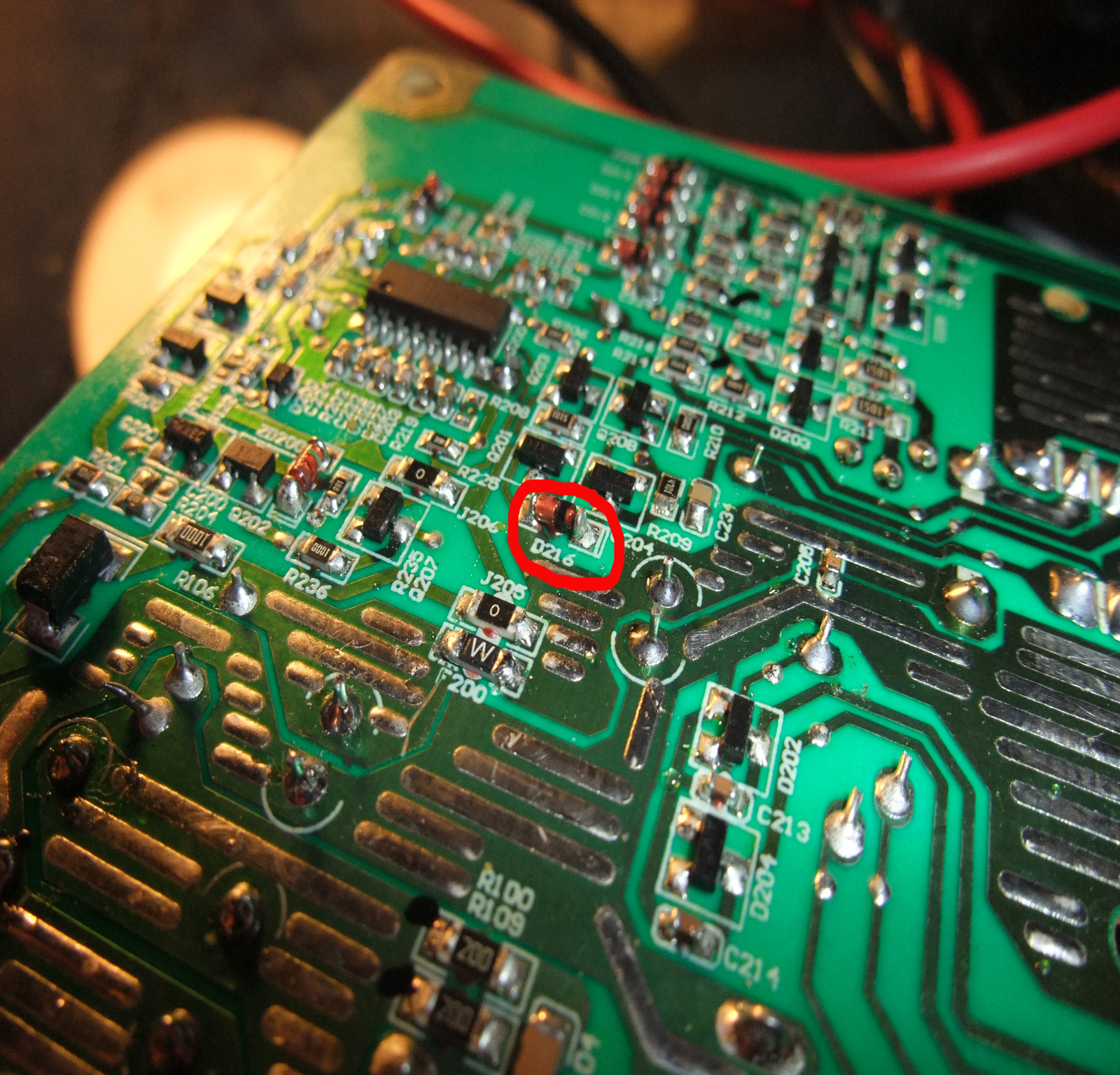

                                Could someone help me identify this diode? I have a couple of these that are shorted. I've replaced all the capacitors, 40T03GP MOSFET and checked all fuses. I found several SMD resistors that had very high resistance (0.2 ohms -> 1.9 megaohms) along with these shorted diodes.
                                I believe these are LL4148 diodes, but I would like someone who is familiar with these to verify. Thanks
