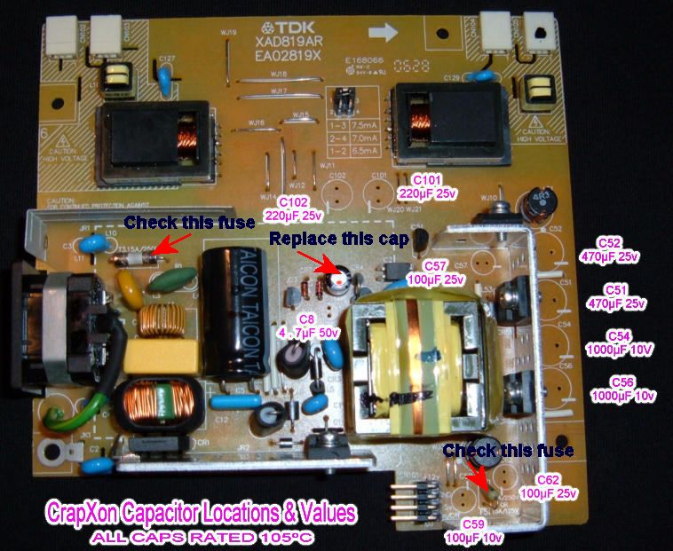

    • Toasty
      • Jul 2007
      • 4171
      Re: Dead Power Supply(XAD819AR) for Acer AL1706
      See attached pic.
      Toast
          Originally posted by Toasty
          See attached pic.
          Toast
          I am not familiar with checking fuses on power supply boards, what am I looking for when checking these fuses? Do you know the rating on the cap you suggested I change? What is the reason you are suggesting replacing this cap? The last question is just so I can learn. I will post some pictures of the board in roughly 15min.

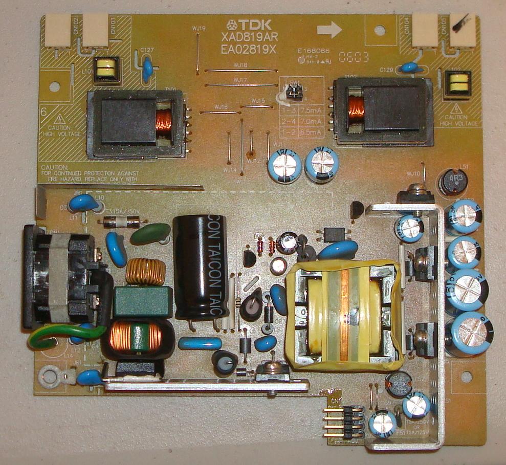

          • IRShifty
            • May 2009
            • 78
            Triple post, oh man. I don't see an edit button though. Here is an image of the board.

                • Toasty
                  • Jul 2007
                  • 4171
                  You're looking for continuity through the fuse(s). No resistance - zero ohms. Most likely one is blown, that is why no indicator light.
                  >>Do you know the rating on the cap you suggested I change?<<
                  No. My psychic abilities can only do so much. Perhaps reading the cap markings would help...?
                  >>What is the reason you are suggesting replacing this cap? The last question is just so I can learn.<<
                  The reason for replacing the cap is that all the others where replaced, why not do this one too. Think of it as having a 6 cylinder engine in your car and only changing 5 of the spark plugs on a tune-up. Why does it run rough...?
                  >>RadioShacks 4.7µf capacitors are rated at 35v. Would this change pose a problem if it took the place of the 4.7µf 50v CapXon one?<<
                  You can NOT replace a higher voltage cap with a lower voltage cap except in very few instances. You CAN replace a lower voltage cap with a higher voltage cap in most instances.
                  Toast

                              • Toasty
                                • Jul 2007
                                • 4171
                                What were the original cap values and series? One side has the brand name, capacitance and voltage values. The other side has the series letters such as GL or KF then the temperature rating. Report back with all the original info and we can guide you for the order.
                                >>its a bitch to see without removing it.<<
                                Welcome to our world.
                                Toast
                                veritas odium parit
