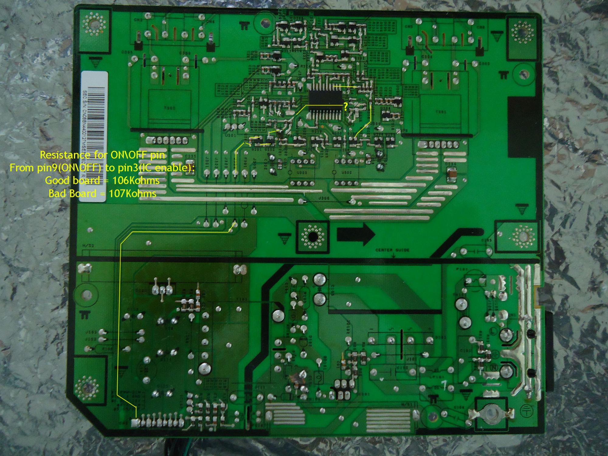

                        Re: Samsung SyncMaster 226BW
                        I probably didn't clean it well after spilling too much of it.
                        I cleaned the board by scrubbing it with an old soft toothbrush (works good actually) and then dried it but the 1-2 seconds to black problem still happens, so its probably something else now.
                        I monitored the ON\OFF pin coming from the signal board (pin 9) and enters the inverter IC at pin3 (after going through many resistors and transistors).
                        I was unable to monitor that pin near the IC because of limited access and the pins are so close together and i might short something out so i monitored the ON\OFF pin as it enters the board from the signal board.
                        Bad power supply board:
                        Monitor off = 0.0V
                        Monitor on\backlight on = 3.94V
                        Monitor on\backlight off = 3.94V
                        During pressing the Source button to turn on the backlight (for 1 second) i've seen the voltage drop to about 2.0V for less than a second.
                        Good power supply board:
                        Monitor off = 0.0V
                        Monitor on\backlight on = 3.93V
                        (Unable to monitor with backlight off because this board works)
                        Awaiting your ideas
                        Thanks,
                        mastertheknife.

                          You know, you can always solder a thin wire to wherever you need and clip that for probing. Anyway your description shows an inverter problem, the logic board is fine (which we already knew since another power supply works). First thing, resolder the inverter transformers.
                          If it still doesn't work check the inverter IC for any protection that could be operating, post a link to the datasheet if you find it and don't understand it.

                            I traced the pin's way and measured the resistance gained on the way on both boards and it seems unlikely to be the problem, its probably the inverter controller shutting down for some reason.
                            The chip is OZ964GN and the datasheet is here:
                            http://www.alldatasheet.com/datashee...2/OZ964GN.html
                            I resolded the inverter transformers, no luck.
                            As far as i understand the datasheet, there is an overvoltage protection but im not sure yet how this all works.
                            Thanks,
                            mastertheknife.

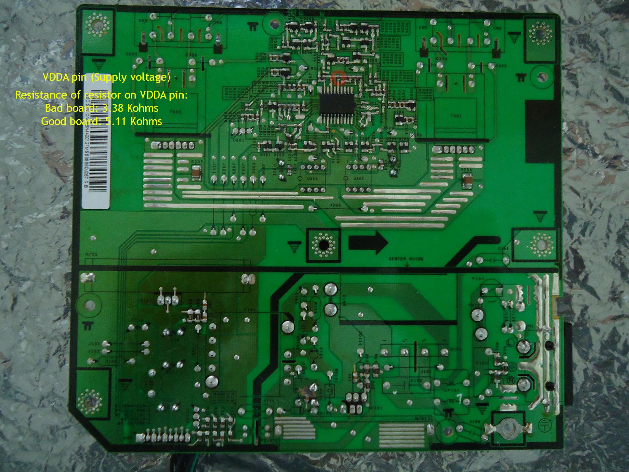

                              Okay this looks a lot like what i have on my NEC. The chip has three protections which go as follows:
                              • Overvoltage (pin 2). If this goes over 2 volts the inverter shuts down.
                              • Open lamp protection (pin 10). If this goes over 2.5 volts the inverter shuts down.
                              • Current feedback (pin 9), for protection against aged/shorted CCFLs. No clear description given in datasheet. Check against working unit, measure voltage across the resistor that goes from ground to the 51k resistor (R15 in the datasheet schematic). On mine it sits around 0.74v.
                                    I will try that right away.
                                    So far:
                                    Open lamp protection - not likely, the lamps work with the other board.
                                    Overvoltage Protection - likely, i just measured the resistance between pin5 (VDDA - "Supply Voltage") and +13VDC.
                                    Good board = 6.0 Kohms
                                    Bad board = 4.3 Kohms
                                    This seems to be because of a resistor on pin5 (VDDA) just before it enters the IC.
                                    Thanks again,
                                    mastertheknife.
                                        Hi Th3_uN1Qu3,
                                        I suppose you refer to a resistor from pin9 (feedback control). There is a resistor next to it but its not 51kohms but rather 56kohms. Its other side is connected to ground (0 ohms). To check the voltage on the ground side of the resistor or on the pin side?
                                        Also, i measured VDDA (Supply voltage) and it jumps between 4.6V to 5.0V which seems to be OK according to the datasheet.
                                        EDIT: I just re-read one of your previous posts. In the meanwhile, i will solder wires to pin2 (overvoltage feedback) and pin10 (open lamp protection)
                                        Thank you,
                                        mastertheknife.
                                          Maybe they changed it a little - all i can tell you is follow the datasheet. In your case it's best to just measure the voltage between pin9 and ground and compare to the other working supply. But before that, what do pin2 and pin10 measure?
